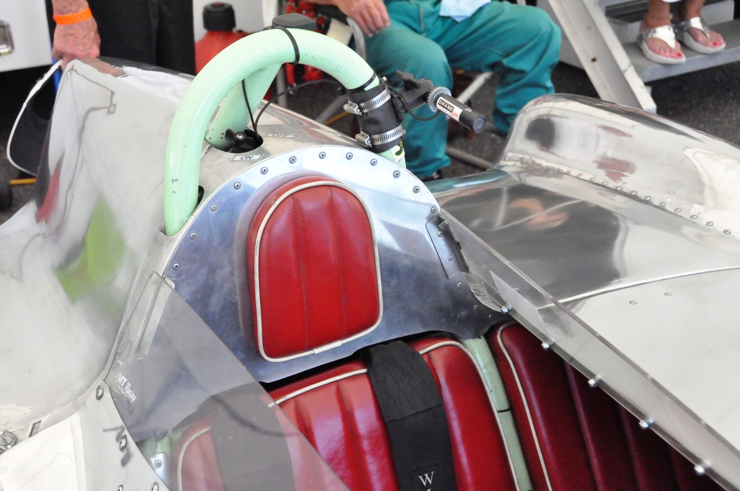

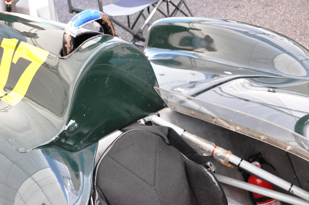

[attachment=2]ktr_1b.jpg[/attachment]Dear W11 Members,
3 days after delivery of my new/old W11, I drove it to Lime Rock Park for their annual Historic Racing Festival.
The Lotus club was kind enough to let me park with them and participate in their parade laps (rather than being relegated to the Austin Healey group). It was a horrible 2 long days getting this W11 into safe driving condition. Just about every subsystem on the car was dangerous, broken, or near breaking (other than the engine). I don't know if this is attributable to the fact that it's a kit car, that it was built without much attention to detail, or if previous owners had questionable shops work on it. Anyway, it's drivable, reliable as I could make it in 2 days (still needs many parts replaced very soon such as the transmission ... which was reported to be in excellent condition by a shop that did the pre-purchase inspection).
There were quite a few real Elevens racing, and I've added some pictures of some interesting bits (no full shots as the web is full of great Eleven racing pics). I was primarily interested in roll bars, rear fairings, and underhood air management. As my W11 has the non-LeMans rear shell, I'm happy to see that all the Elevens that were racing at Lime Rock had add-on rear humps. I think I'll go with the Dzus method of attachment as shown on the silver car. I also included a picture of a lovely old Lotus 9, as this was the grandfather of the Eleven. It's clearly been thru a lot over the past 60 years, but still soldiers on at the races!
FWIW, I really enjoyed the 270 mile drive in my needy W11. Despite all the problems with it, it still handles really well compared to my well sorted XK120 OTS, and I believe that with enough time and money on each subsystem the W11 has huge potential to become a great track-day and short-distance touring car.
Anyway, I'm honored to be part of this crowd. Adam, Eric, you two seem to have achieved the ultimate (turning your W11's into real race cars), and I'll be stealing ideas from you as much as you let me.
John Feng
Boston, MA
no forward brace
no forward brace
rivets galore
rivets galore
Dzus attachments
Dzus attachments

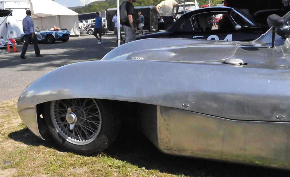

more pics
lovely old Nine
lovely old Nine
