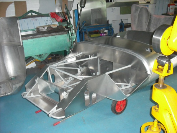

I suppose we'll just have to wait and see what the answer is from WSC's original supplier.
I'm assuming that it is a reworked scuttle panel that sits on top of the rear firewall? In other words, a one-piece affair.
If not, then perhaps you need something like this:
http://www.andywiltshire.com/web%20site ... 20page.htm
I can think of a couple of people who would be able to do this sort of work to the highest standard.
