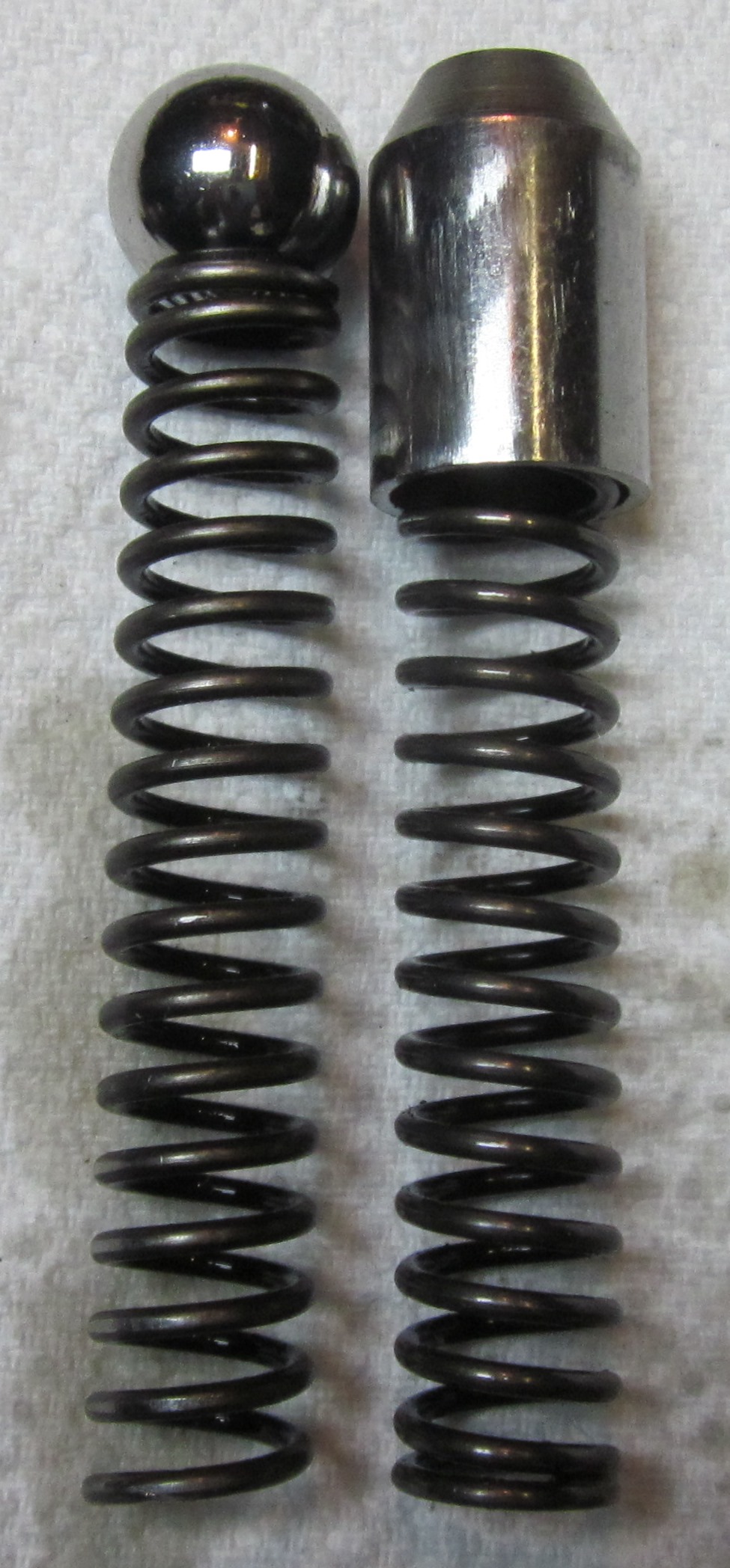

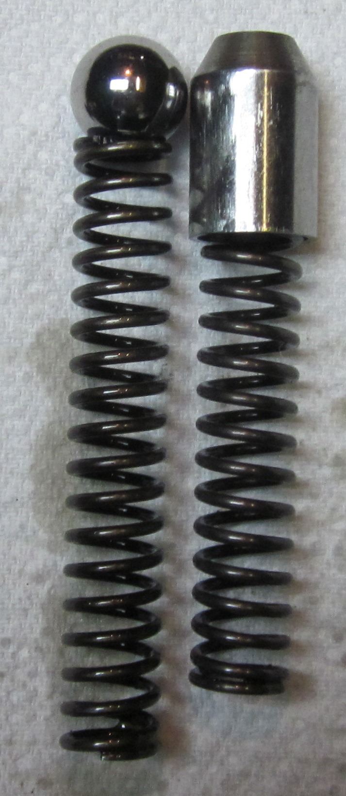

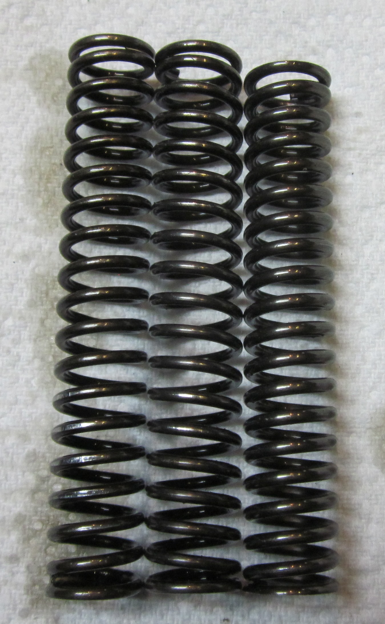

Here are the spring pics:
MG, MG, Mini
[attachment=2]IMG_5024.JPG[/attachment]
Ball on MG spring
[attachment=1]IMG_5025.JPG[/attachment]
MG, MG, Mini Springs
[attachment=0]IMG_5026.JPG[/attachment]
Posts: 1022
Re: Winged Sump
MG with ball, MG with plunger
Two coils removed (wear eye protection then you do this!!!!)
Re: Winged Sump
I don't think that you have a problem, other than the plunger is stuck again.
Having the oil pressure track RPM is not really a problem. What you are looking for is the maximum pressure, usually reached around 2000~2500 RPM.
MAX Oil pressure should be 60 psi HOT. No more, NO LESS. My engines run at 60~62 at 80~90 C oil temp (20w-50 Valvoline Racing). I have an oil cooler as the ambient here is often around 34C and higher during the summer. Hotter at the desert race track. In the winter, when it is cold, it often takes a while for the pressure to drop below 75 psi as the oil warms. Once the oil reaches coolant temp, the pressure settles down to 60 psi. A little extra pressure is OK, but you are wasting HP producing excessive pressure when the engine is hot.
Having the starting oil pressure exceed 90 psi on start up with 20-50 oil is normal. It's the hot pressure you are looking for.
Remove the plunger and clean everything out again. Make sure that the seat is clean as well. Add a couple of washers or shims to your last spring, to raise the oil pressure a bit. 55 is too low.
I polish the plunger if it needs it. The ball should solve the problems provided that the bore and the seat are in good shape.
