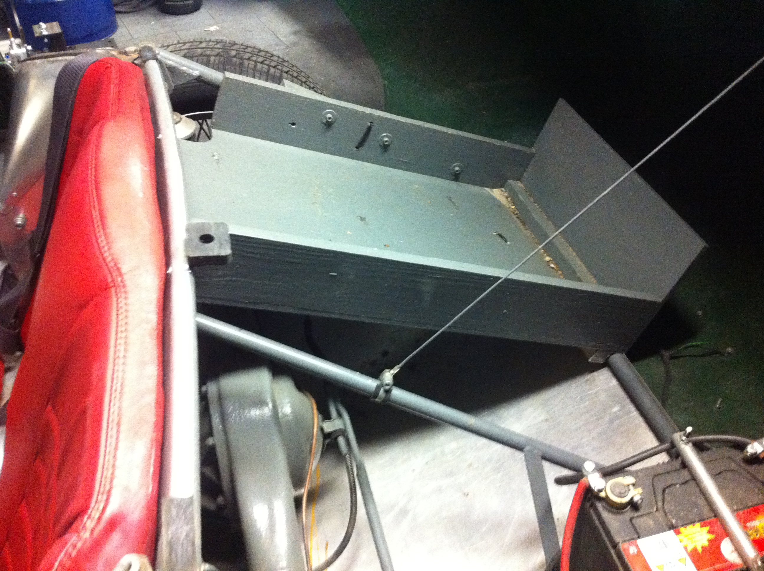

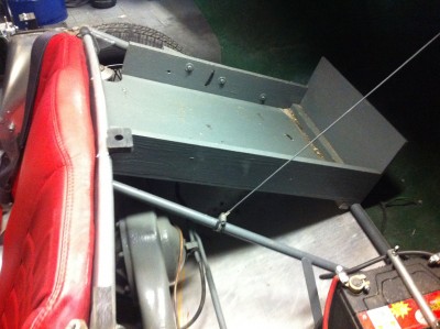

Re: Luggage Solutions - Le Mans Classic 2014
the luggage coffin I made for my le mans trip.
Going this year with my son, no idea what we
are getting in to....
A large luggage bag fits in there under the rear hood.
If we go racing i can take two helmets and the rest of my stuff in there.
Any suggestions for the le mans trip, as where to park, stay, sleep....
regards Cor
[attachment=0]bagagekist.jpeg[/attachment]
