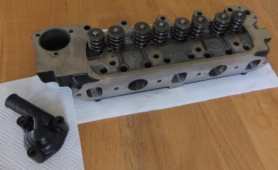

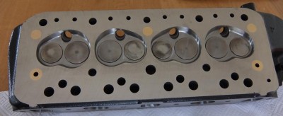

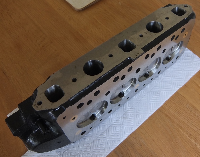

I've got around to painting my head. No, not that one...
This one:
This one:
- Posts: 1023
Re: Bottom End Wear - Engine Out Job
I used Granville Engine Black (satin). Goes on really nicely in a single coat. Brush finish is pretty good and it cures on the car with running.

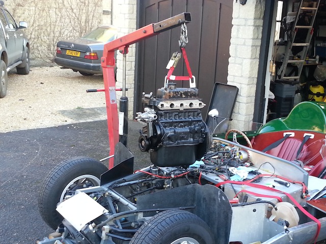

I can't actually believe that I had the head back and painted in July, but only put the engine back in yesterday!
Not very impressive work at all!
On the upside, the install went well (Thanks to my mate Chris' help), I've learned loads during the process (and more to come, no doubt) and might actually get to drive my car again after such a long lay-off. Just thought I'd update - gives a bit of motivation!

Looks good, but I have a suggestion...
Why not run the fuel line across the inside of the scuttle, rather than outside the frame, in front, where it might be cut by a shard of fiberglass if you should hit something, or should something hit you? Running the fuel line across the firewall, or inside the scuttle would keep it out of harm's way. I am (temporarily) running a soft line on my LHD car from the tank to the pump, to an inline filter and a pressure regulator, across the firewall to the carburetor. The plan is for a steel hard line across the scuttle shelf, with new hose ends and push on Aeroquip or Goodridge -6 hose. My RHD car has a stainless hard line across the scuttle floor, with barb ends for Aeroquip or Goodridge push on hose at each end. This was very clean and easy. Since the barbed push on hose fittings are good for 150 psi, they have been working fine for years at 4 psi with no need for clamps. I also used the push on hose for the cooling system's small diameter vent and secondary hoses, as well as for the oil cooler.
Also, you might run the radiator vent line inside the frame as well.
I have seen a few cars lately with the fuel line right up front, outside the frame, where it could be cut if the radiator and the top mount are displaced, or the bonnet is shattered. I am a firm believer in putting fluid lines inside the chassis where ever possible.

A very good safety point, Jan.
