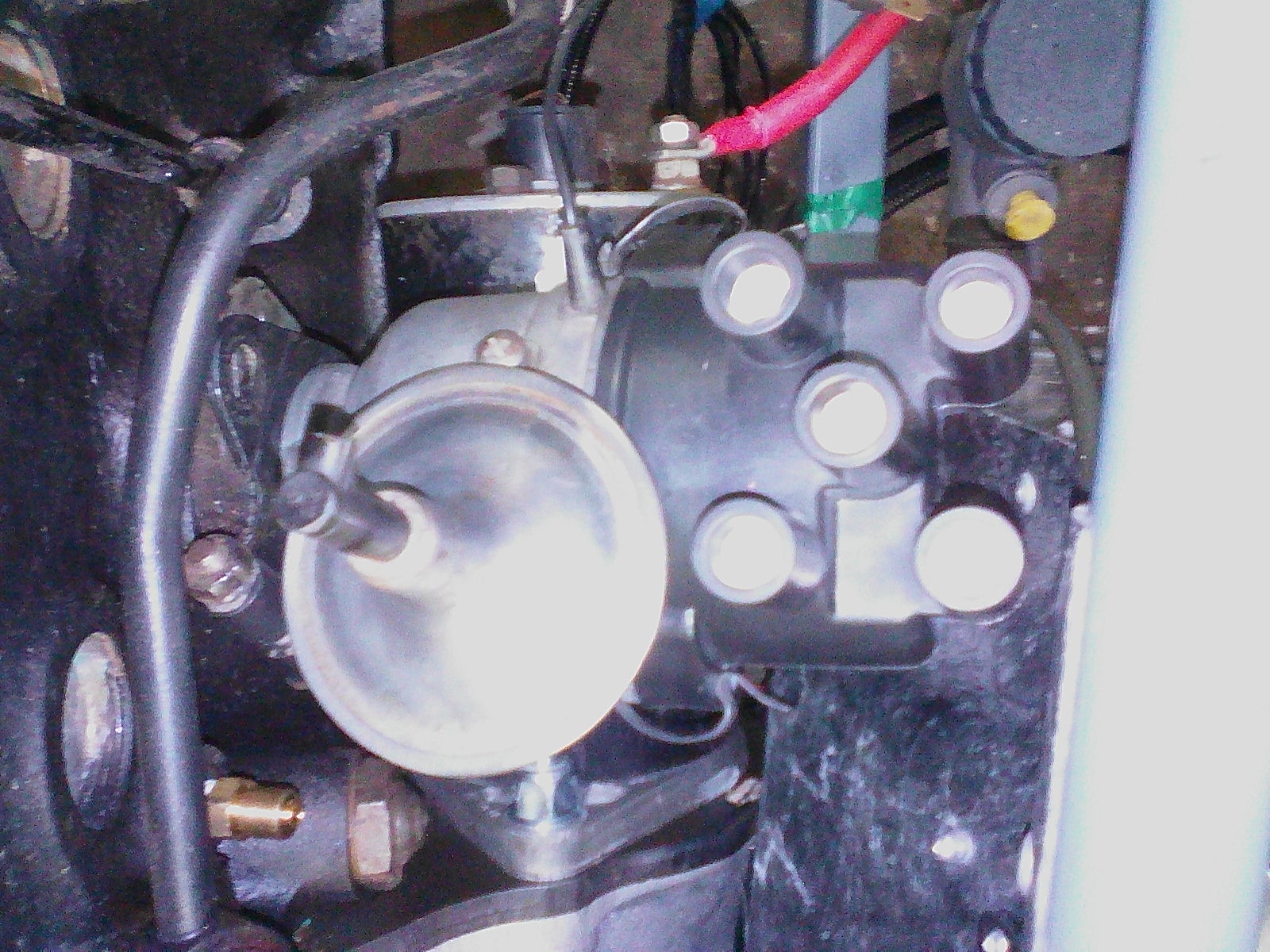

distributor cap fitting - did you have t cut the footwell?
Re: distributor cap fitting - did you have t cut the footwel
The side exit cap, as Splat and Jan mention is the one you need. I found that if I rotate the dizzy in its mounting, then the cap will come off. Reverse is true. It's tight but does work. Don't forget to Tippex the dizzy and mount with a dot to indicate correct position for reinstallation.
So, why not turn your distributor around so that the correct side lead cap fits, then plug it in to the engine? Set the engine to TDC first. Then plug in the distributor and rotate the shaft until it engages. Install the rotor and then determine where the new #1 lead will plug in. Doesn't matter where the rotor falls. It goes in a circle. Make sure that the hold down clamp is loose.
If you can't fit the distributor because you have the brake lines in the wrong place, re locate the brake lines. It's not as though you have a choice. I certainly didn't, and reinstalled them for more distributor clearance.
You don't want to cut holes where none are necessary, then have to fabricate a new cover, rivet it into place, and have it leak CO into the cockpit... It's easy enough to fix the lines (especially when you do the second installation. I know from experience). Anyway, the tubing is cheap, and you can pick it up at the local auto supply, flared with the B nuts in place, just like the ones that came taped to the kit... Sometimes, you will have to do things twice.
Like I did when I found that the distributor would not fit, and had to relocate the brake lines...

SO... Yes, on initial installation, I found that the distributor didn't fit the RHD chassis, until it did. I used a side exit cap, rocked the engine around (and yes, I do use washers under just about EVERY bolt and nut) finding a couple of millimeters additional clearance. The brake lines needed to be relocated slightly. Finally, the distributor went in without the cap, no problem (but still a tight fit) and the cap was wiggled into place, with nearly a cm of clearance.
Cheers all.
Sorted with no cutting (yet) new cap, re-route of cabling and re-bend of brake pipes and the confidence that it would fit I got from everyone elses builds ( dizzy does come in and out with engine in place now ).
if there is a handy build tips page I would add that routing of the brake pipes and cables should avoid the dizzy area. it maybe "cheap" to redo the lines but it is a pita
Well done. I think that somewhere along the line we've collectively buggered-up every possible aspect of an Eleven build, so someone here always knows the fix! It's sometimes frustrating, but ultimately an enjoyable and fulfilling process and the end result is well worth the effort. And once built the car is a joy to work on and tinker with as it's both so uncomplicated and you know it blindfold by then......
