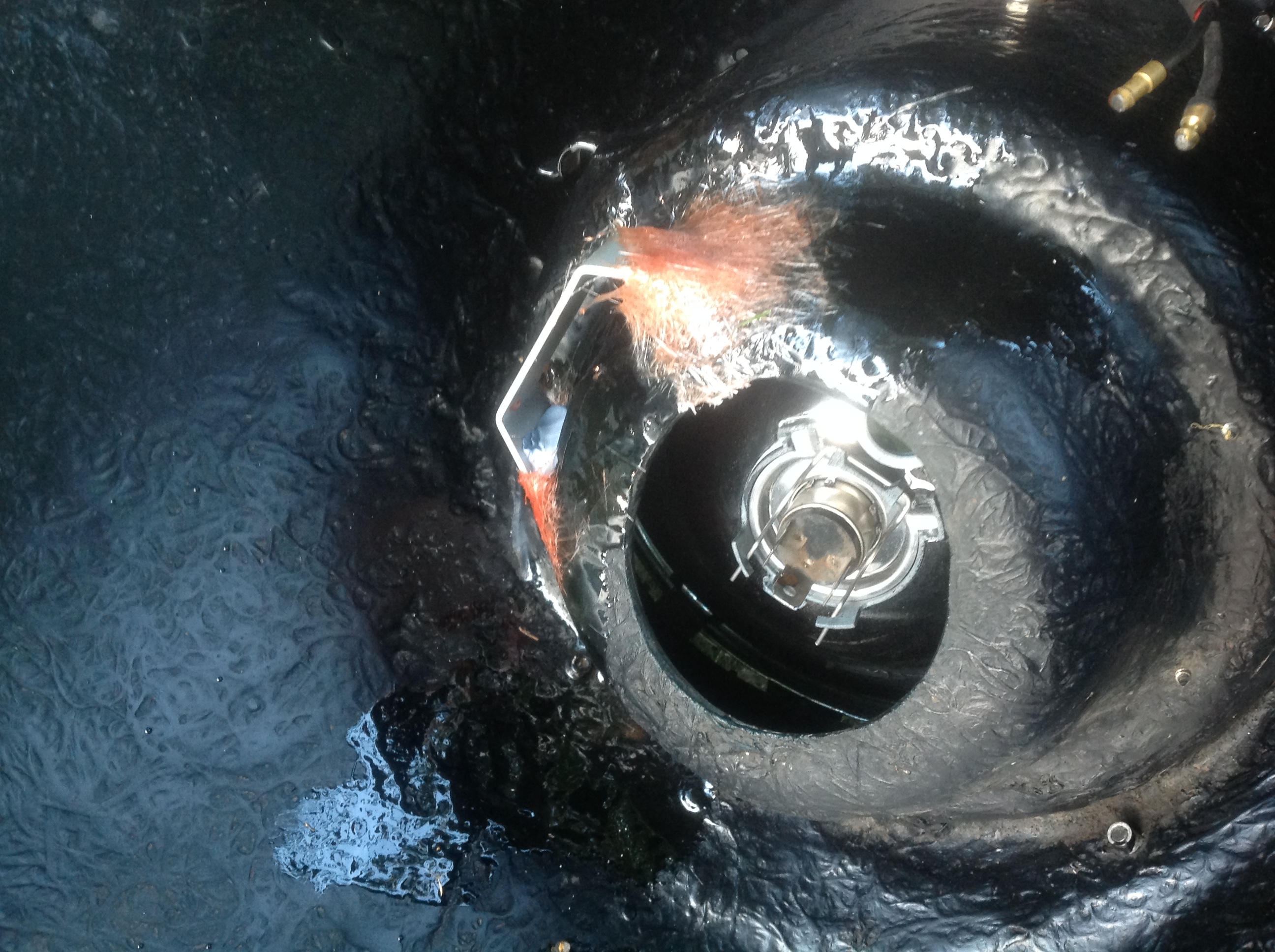

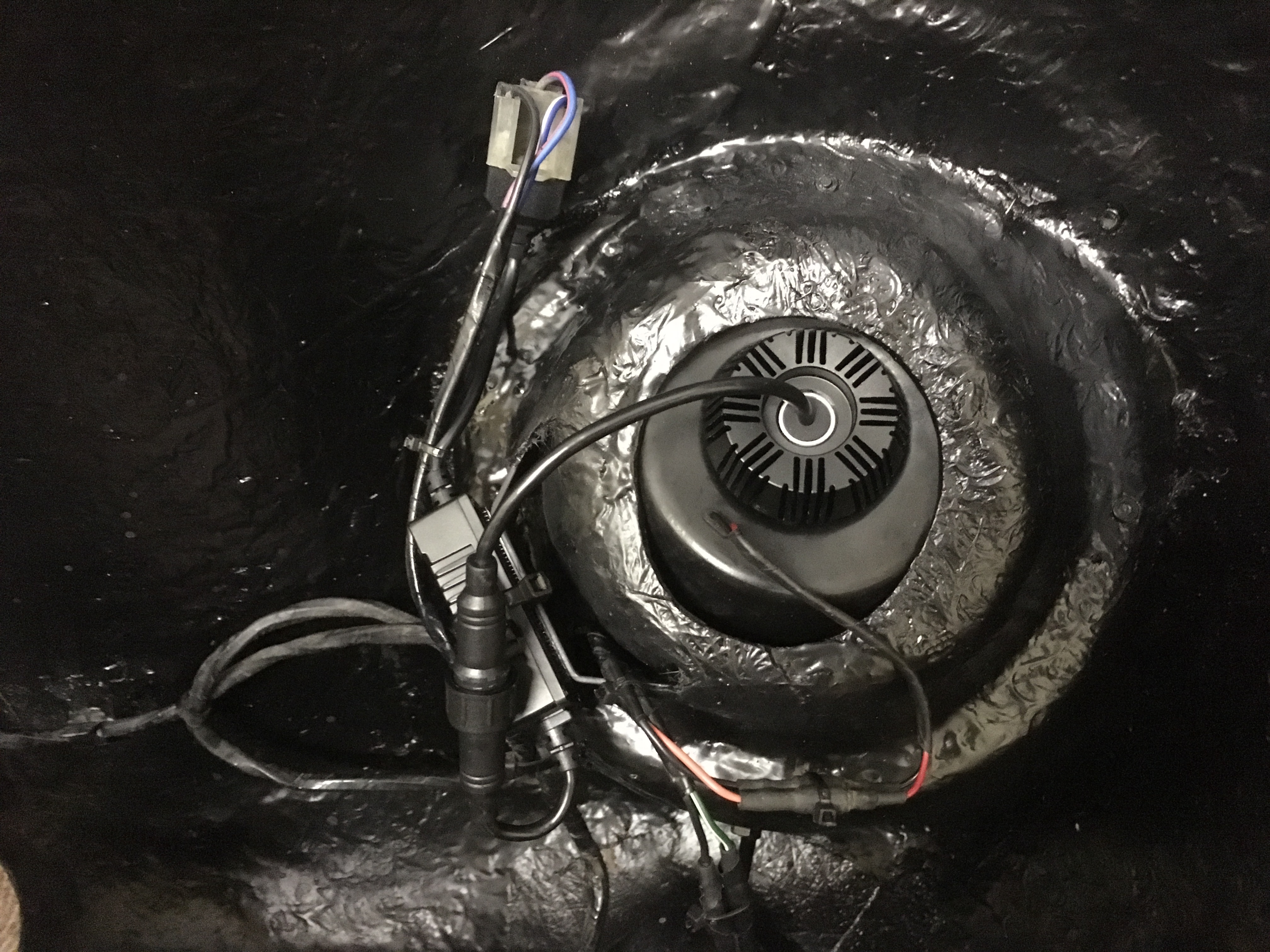

Whilst I awaited delivery (2days) I made a guesstimate of the size of the drivers and fabricated a pair of very simple brackets to mount them on.

These were then loosely held in position inside the bonnet with blutac whilst I glassed them down:
- Posts: 469
Re: LED HEADlighting.
I know! I know! You've seen more attractive dog's breakfasts. Well, nothing a bit of paint can't sort out:
