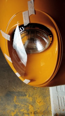

before I ruin the plastic headlight covers "trimming" them to fit are there any handy tips or recommended tools? Looks like there is quite a bit to trim off but probably only one side on each cover (the inner side on the photo). c

Switch them left for right, and check the fit again. Turn them as well.
Some are fitted as LH and RH.
I have installed about a dozen sets, on both the early and late cars, and have not had to trim any of them. Some of the pairs came from Westfield, others came from a local US supplier, making a direct fit replacement.
If you are worried about trimming the covers, find a plastics supply shop. They should be able to handle the re sizing for you.
But... I don't think that there really is a problem that switching sides or turning could fix.

We have been around this buoy before as we were looking into making replacements for our own use. The WSC supplied items to require some trimming, as I recall from the Manual. To be honest, if the front clamshell mouldings are all the same, then why an accurate headlamp cover can't be made.... Oh, hang on.... It will have to be trimmed by someone!
Ok, there is plenty of guidance out there for trimming and flame polishing Perspex and polycarbonate. I'd love to get our own tooling sorted, as we could all do with a spare set in stock.
Goes without saying to mark up very carefully and go steady. Not too much speed, or you will melt the plastic as you go.

The locally made parts come from the US Distributor, Manik Technologies.
The cost is high, just like the ones from Westfieid. Around a couple of hundred USD a pair.
Tooling is easy to do. All you need to do is make an accurate mold.
The parts get cut to size by the manufactrer, to match the mold.
Production is pretty simple. The soft plastic is draped over the mold, cooled and trimmed.
It is likely that there is a plastics fabricator or supply local to you that could make the mold from an undamaged, properly fitted pair of covers.
You can also try aircraft windshield fabricators, who also do some motor racing windshield fabrication. The Vintage race guys all need special plexi windshields and headlight covers.
Then, all you have to bother with is price. It wont be inexpensive, but the supply may be more reliable.

One company local California is Aircraft Windshield Company www.aircraftwindshield.com
They can make anything you need (they do full windscreens for Lotus 23s, 11s, and everything else in vintage racing). I could coordinate the creation of the molds as I have some fitted covers here. It could be that they already have the covers for Lotus 11, and they might be a close fit needing only a trim to fit our appertures.
