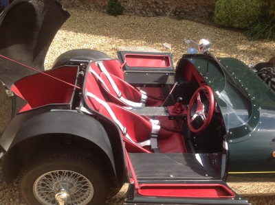

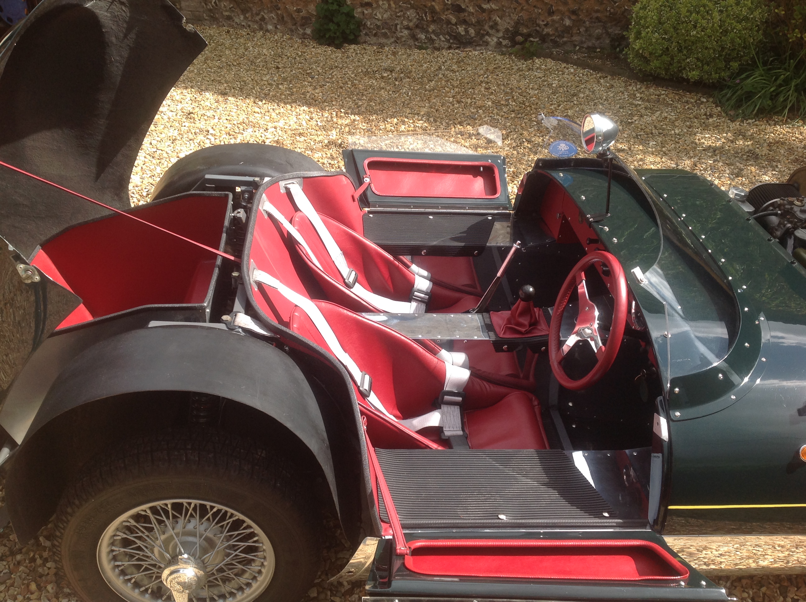

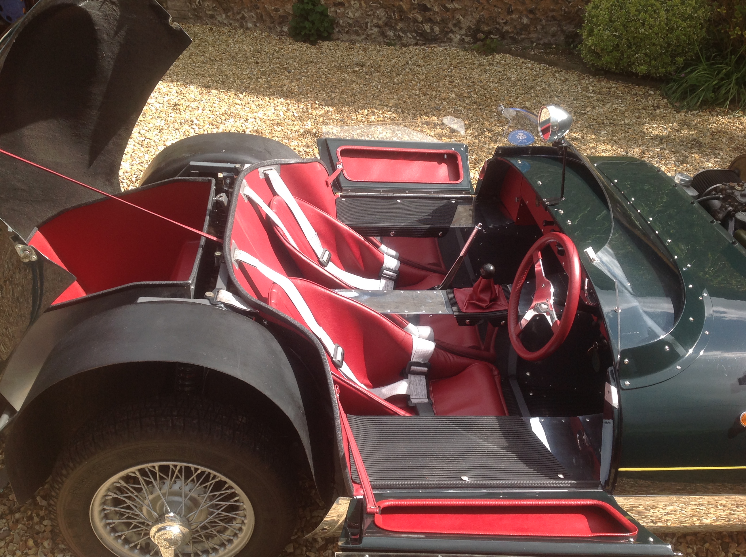

Like Simon I've just had mine pass the IVA on the second attempt, there will be frustrations along the way and things that won't fit or aren't quite right but it means you get to put your stamp on it and guarantees no two Elevens are the same. I've loved every minute of my build and now the real fun begins as its now time to lose the bug eyes and the other bolt on bits to make it look like an Eleven.
There's loads of great tips and advice on this forum and plenty of experience that's always there should a question arise. Although it's not complete yet there's a link to my build site below, if nothing else there's lots of pictures which you may find useful and a link to the wiring diagram to save trying to get it from the factory.
Just incase you've ordered the Moto-Lita steering wheel, make sure the factory know what steering rack your going to be using as it appears Westfield cut my midget steering column end too short (apparently the fat rack I've fitted is an unusual one
) so I've had to buy a spacer so that it fits as my steering wheel was almost touching the scuttle. I think they would of resolved the issue but it would of been a right pain in the butt and would of taken a while to get it sorted. Sorry if this is negative but it might save you some grief.

The fat rack makes no difference to the steering shaft length. If the shaft was too short, it was too short, period.
The length of the column is controlled by the length of the stub shaft that goes into the rack coupler, and where you do the weld. The coupler should be cut off from the donor car steering shaft and bored to a press fit onto the Westfield stub shaft. The amount of engagement of the stub shaft into the coupler sets the length of the shaft, along with the angle of the secondary shaft.
I install the steering shaft, secondary shaft, stub shaft and coupler, then set the distance from the steering wheel to the instrument panel. I then mark the stub shaft to indicate the penetration into the coupler. The coupler and secondary shaft are then TIG welded at the correct length.
Also, there is some adjustment at the quick release as the spline adapter can extend the steering shaft another inch or so, as well as the aforementioned spacer behind the steering wheel.
The steering wheel should be around 8" from the instrument panel.
