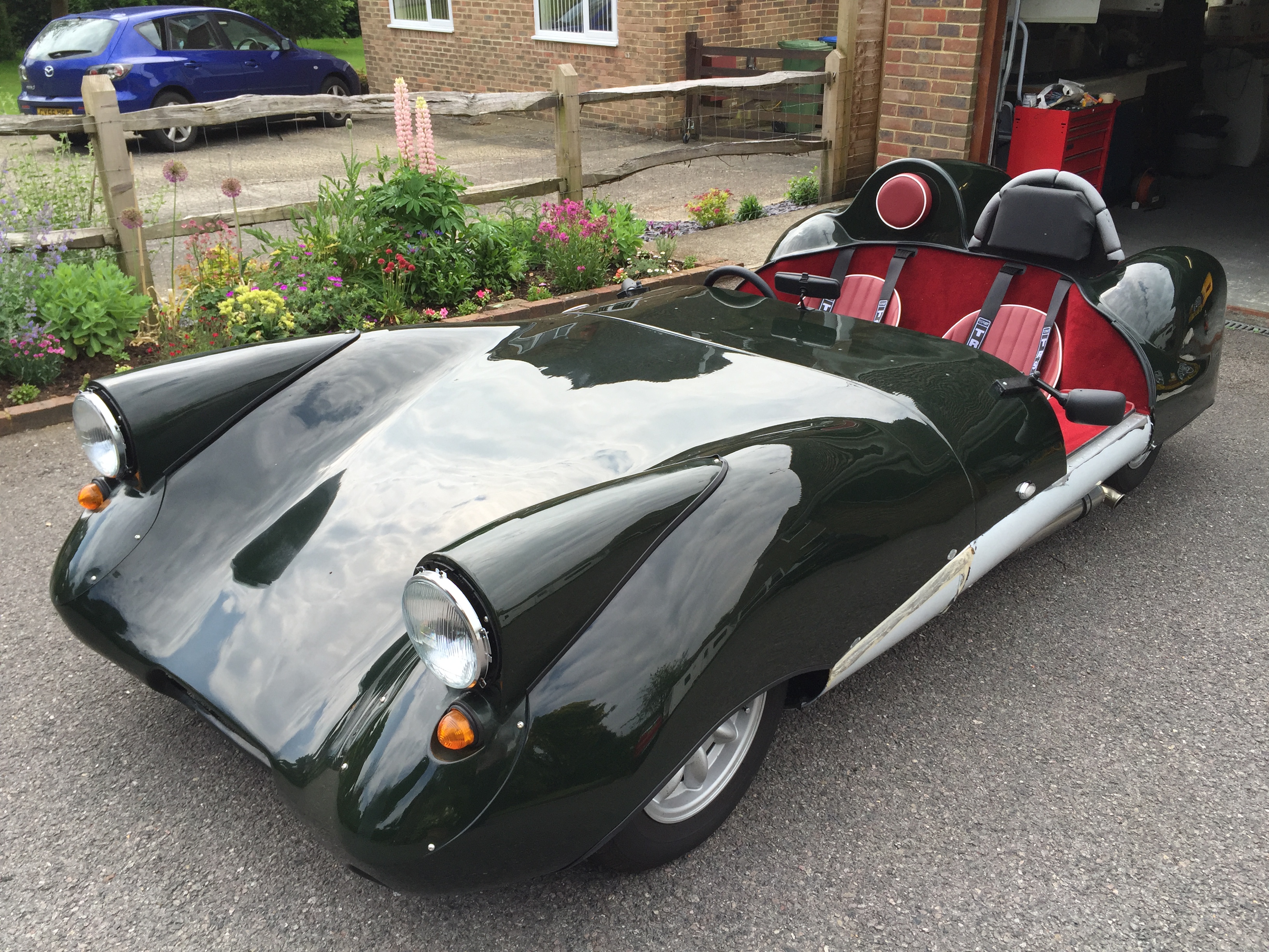

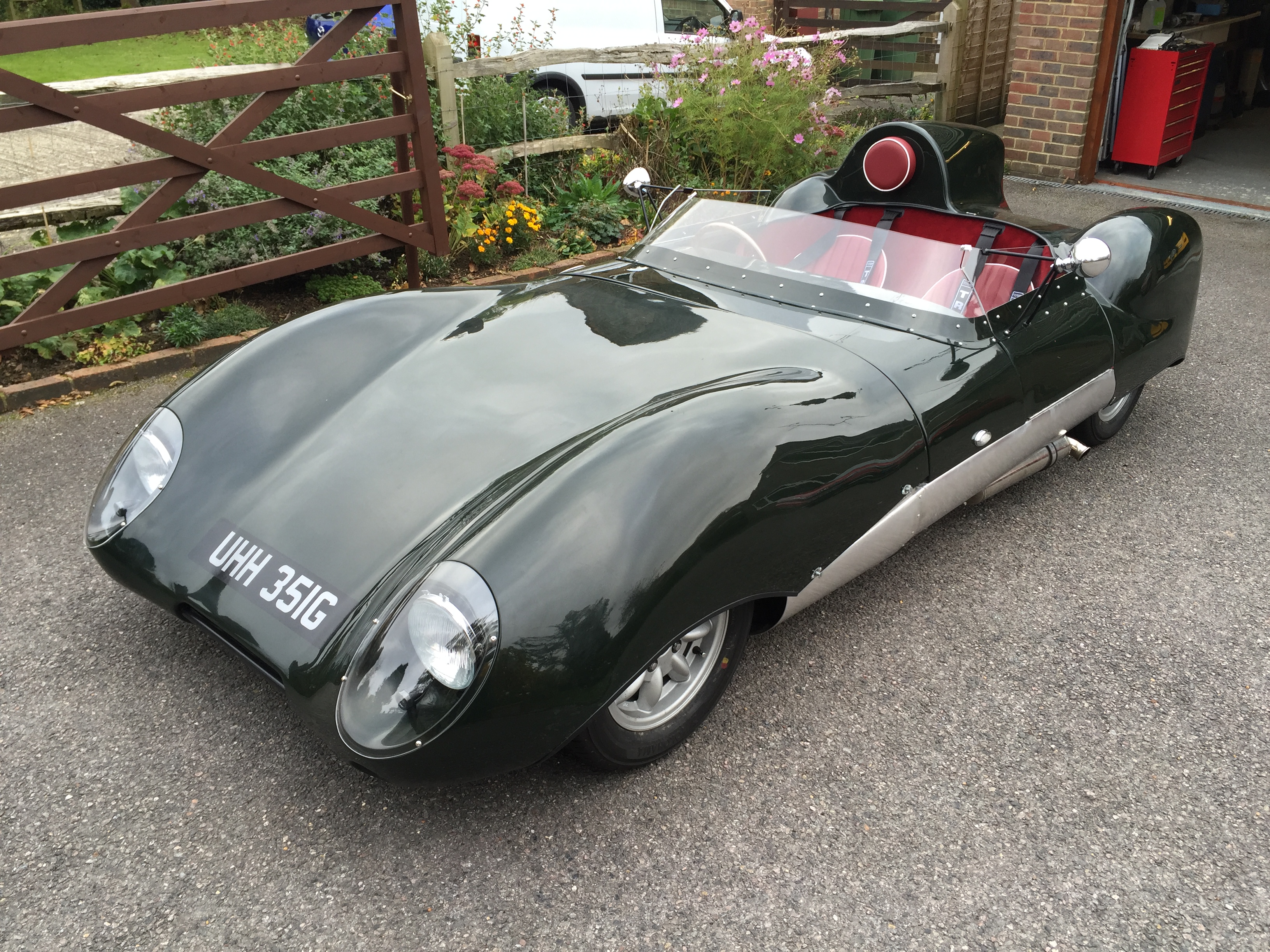

The IVA compliant car.
Take it down!!
Please!
For the love of God, take it down.......
Take it down!!
Please!
Re: IVA Test forms sent
There is something only a mother could love about the IVA-compliant car... oddly, I find it quite interesting.
Reminiscent of a Frogeye... if you squint!!
