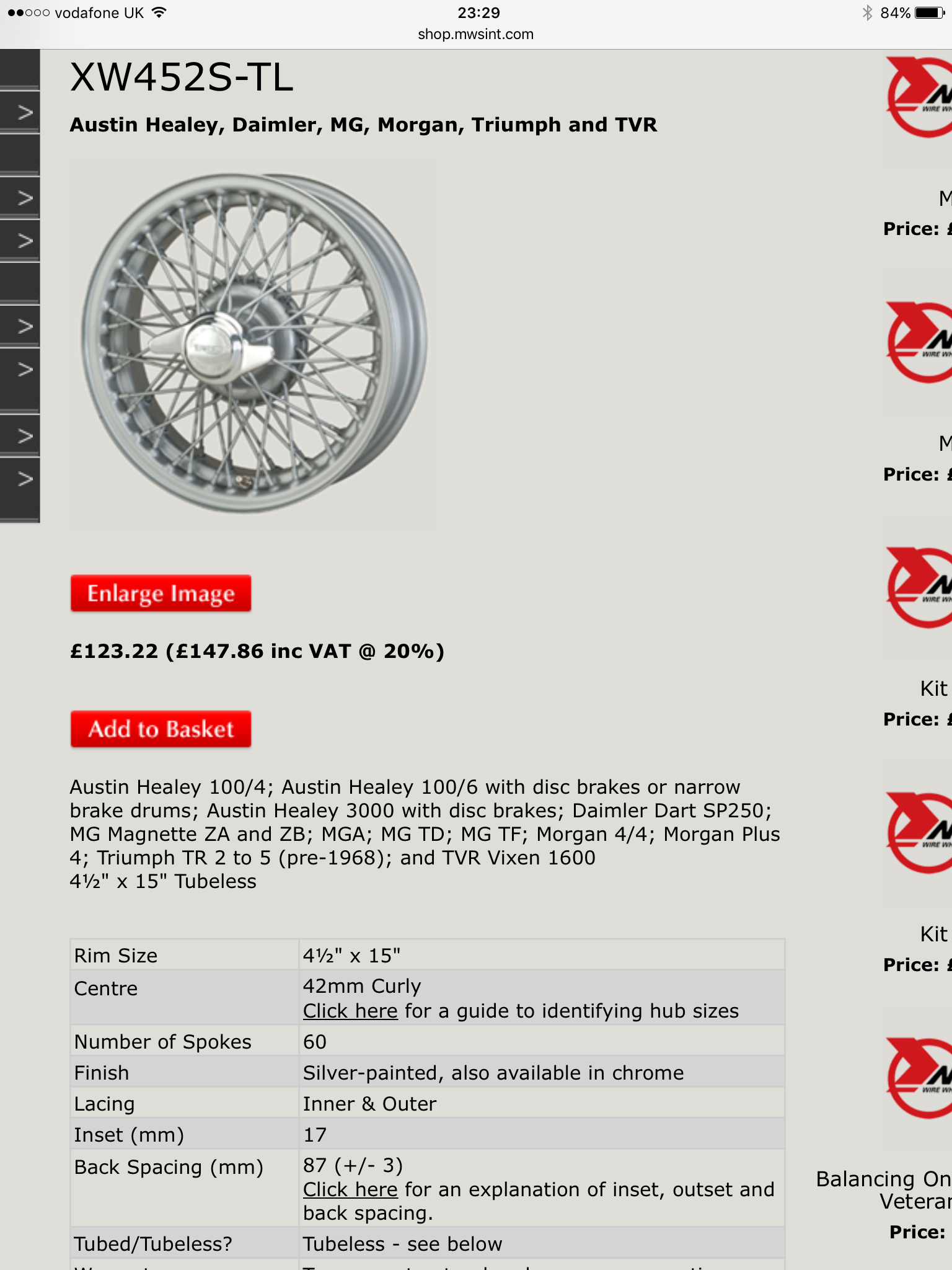

So, if the XZX is a comparable size to the Dunlop, what wheels to mount them on? The front is suited to a 4"-wide rim, with a maximum permitted width of 5". The rear is 4.5", maximum 5.5"
I run Spridget splined hubs with 9" discs and MGB callipes at the front and the 1"-wider-than-ideal disc-wheel rear axle with hybrid disc-wheel half-shafts/Spridget splined hubs at the rear (how many hyphens in one sentence?) So, proper splined hubs front and rear, not bolt-on converters.
I presume that the more spokes a wheel has, the greater the loads it can bear and the longer it'll stay in true for? But the Eleven doesn't exactly overload it's wheels, I don't do that many miles per annum (almost 3000 last year was exceptional!) and...... I prefer the cosmetic look of the lower spoke-count! And for that same reason, I'd like to keep the same spoke-count and lacing front and rear, which probably means picking one wheel to serve at both ends.
I think that the two most likely candidates for off-the-peg wheels from MWS are these two. I suspect that the one to go for is the 4.5" width, given that both inset and backspacing are so similar and the tyre will end up in a very similar place. But, as I said at the start, I'd really appreciate the thoughts and observations of others!

Original Lotus 11 cars ran wire wheels in 4" width, 60 spoke, same as the Elite and the 7 America. I still have one original W11/7 series 1 America wire wheel from my old '57 7 America.
I'd run 72 spoke wheels as they are a bit stronger, and will require less maintenance as they will remain true for many years on the light W11. Also, they are easy to source if you bend one.

And, unlike the 4.5", 60-spoke wheels, MWS have a 48-spoke wheel available to be used for trial fitting to cars. So I've ordered a single Michelin XZX 145SR15 which I'll take over to MWS for fitting. They're on the eastern edge of Slough, so I can pop in either before or after work one day. Although I've leave coming up, so it might not be until mid-March, unless the tyre is delivered particularly quickly.
