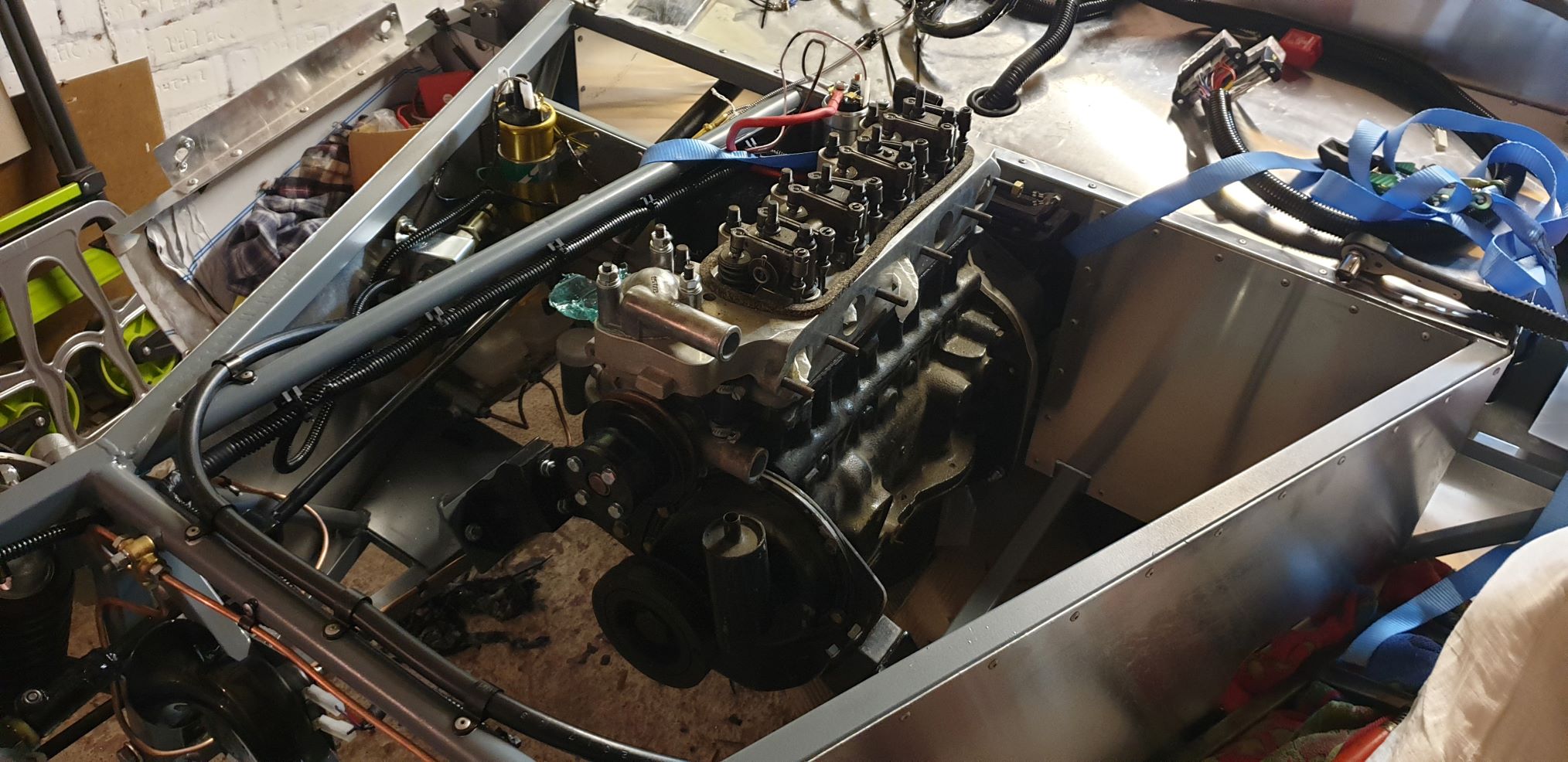

Well the engine is in but the fit leaves a lot to be desired. There are a couple of very close points. The engine will need to come out again to make the changes..
[attachment=0]engine in.jpg[/attachment]

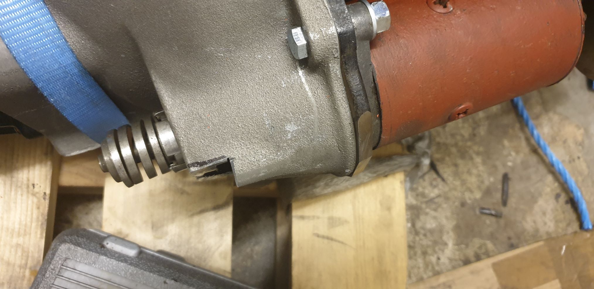

Well the engine and box are back out of the car. I've taken some metal off the side of the plate which goes between the engine and gearbox, also taken a piece out of the bell housing where the starter bendix goes through. Photos are worth a thousand words.....
[attachment=0]bellhousing 2.jpg[/attachment]
[attachment=1]bellhousing 1.jpg[/attachment]

I think the factory need to move the engine mount forward 2" and the problems go away.
Anyway the engine is back in and has the necessary clearance.
[attachment=0]back in.jpg[/attachment]
