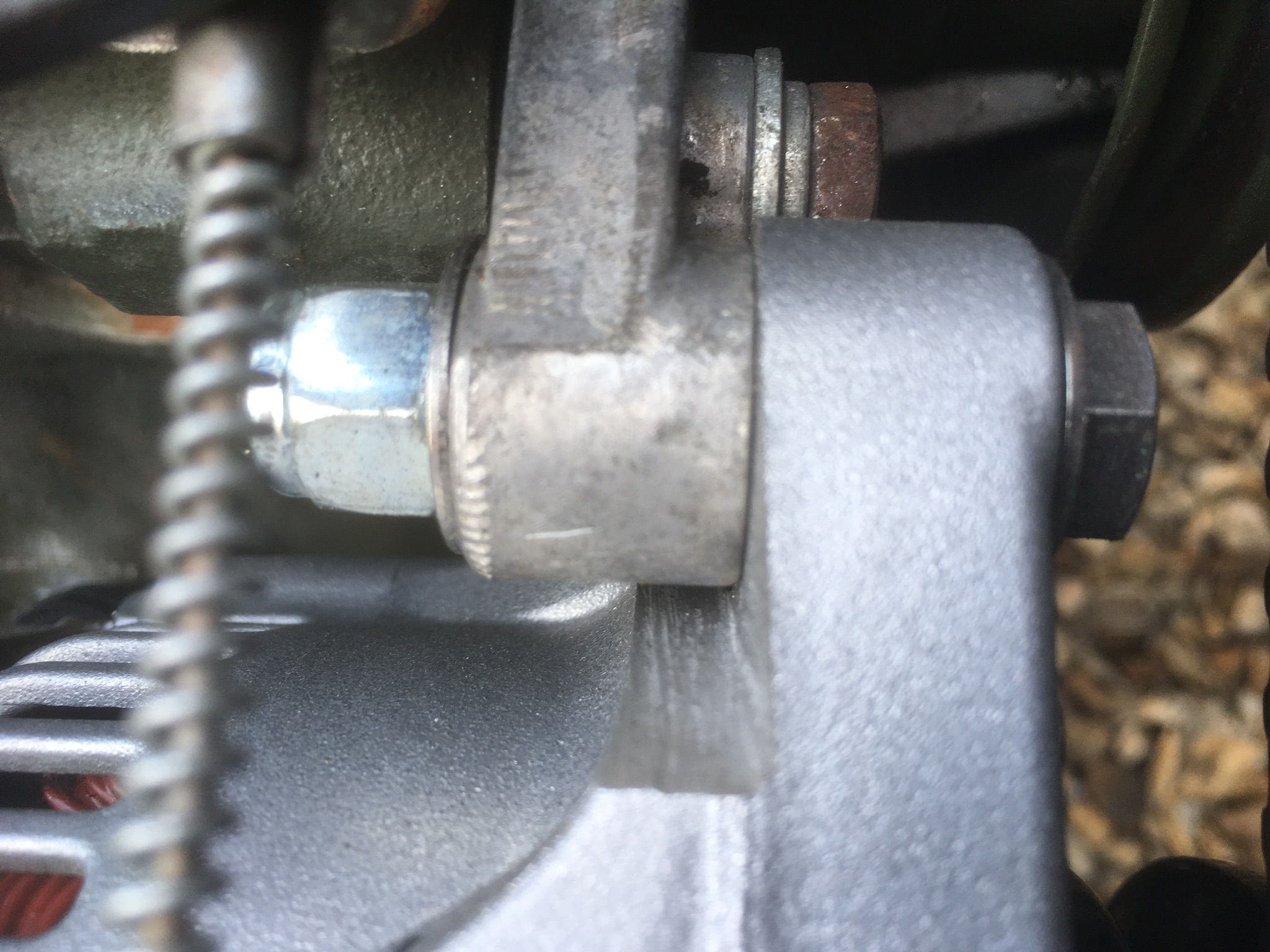

Altering the Denso alternator case to fit it to the A-series:
It’s well known that you have to remove metal from the Denso alternator to allow it to be fitted to the A-series. But I found that I had to remove metal from two places and I was surprised by how much!
Unlike the Lucas alternator, the Denso is much smaller and doesn’t require an aft mounting. Instead, the Denso unit has just two mounting lugs. The main lug is drilled for an M10 bolt. The lower lug is threaded for an M8 screw.
To bring the alternator pulley into line with the fan belt, you will have to thin the main lug by quite a bit. However, out of the box this lug is very thick. So, after modification, the lug remains thick enough to do its job. I simply used a hacksaw to remove the bulk of the lug, and then a flat file to finesse its thickness. This lug is bolted to the corresponding lug on the water pump. The Lucas alternators use a 5/16” bolt here, so I drilled the water pump lug to 9.5mm to accept a 3/8” bolt. (Recall that the lug on the Denso alternator is drilled for an M10 bolt.) I used a bolt of 2” length.
I didn’t take a “before” photograph, but if you click on these “after” photos, you can easily see how much metal has been removed to bring the pulley into line with the fan belt.
[attachment=1]90BD441A-CA65-4DF3-944B-10B68D5E7E03.jpeg[/attachment]

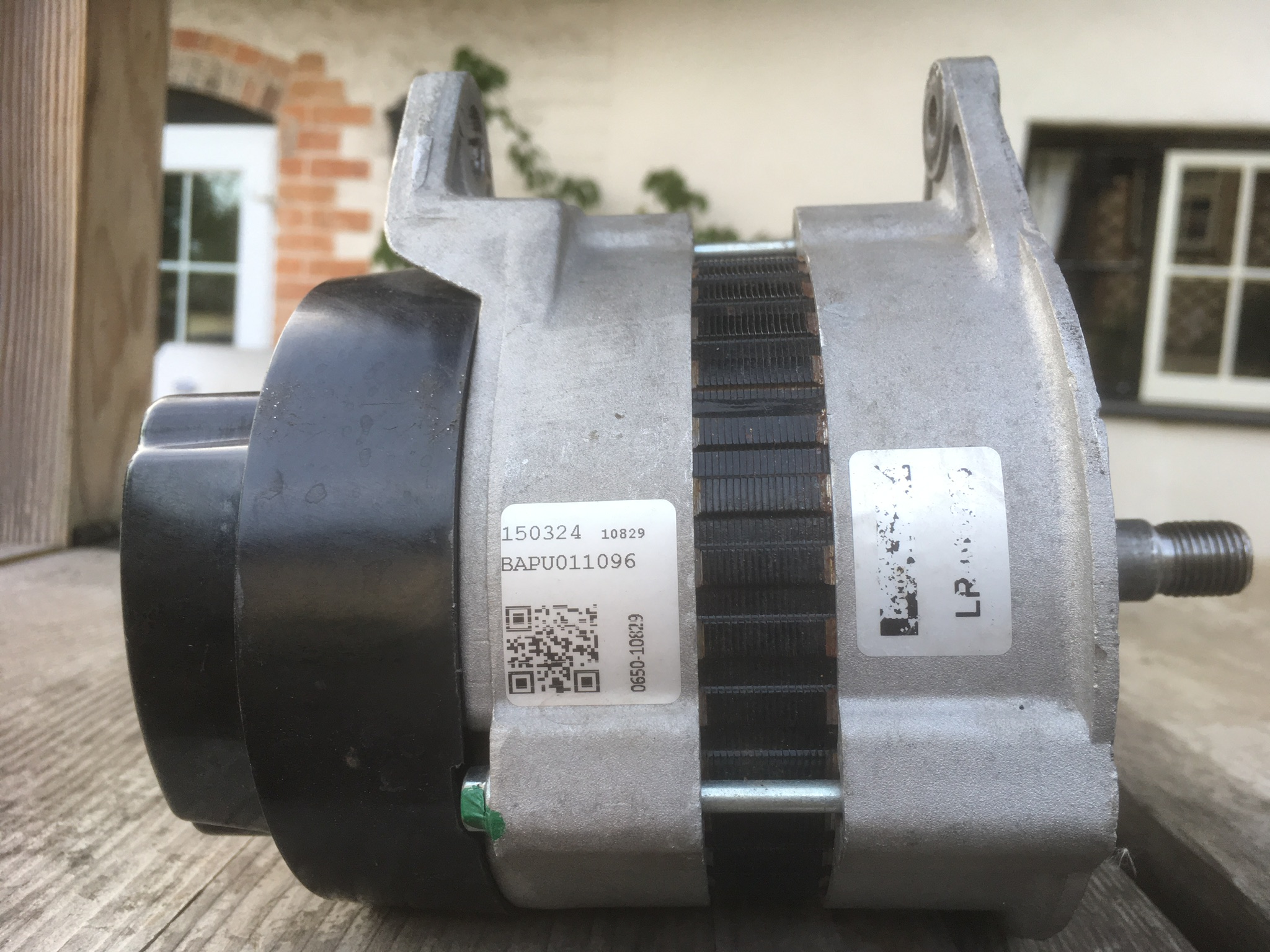

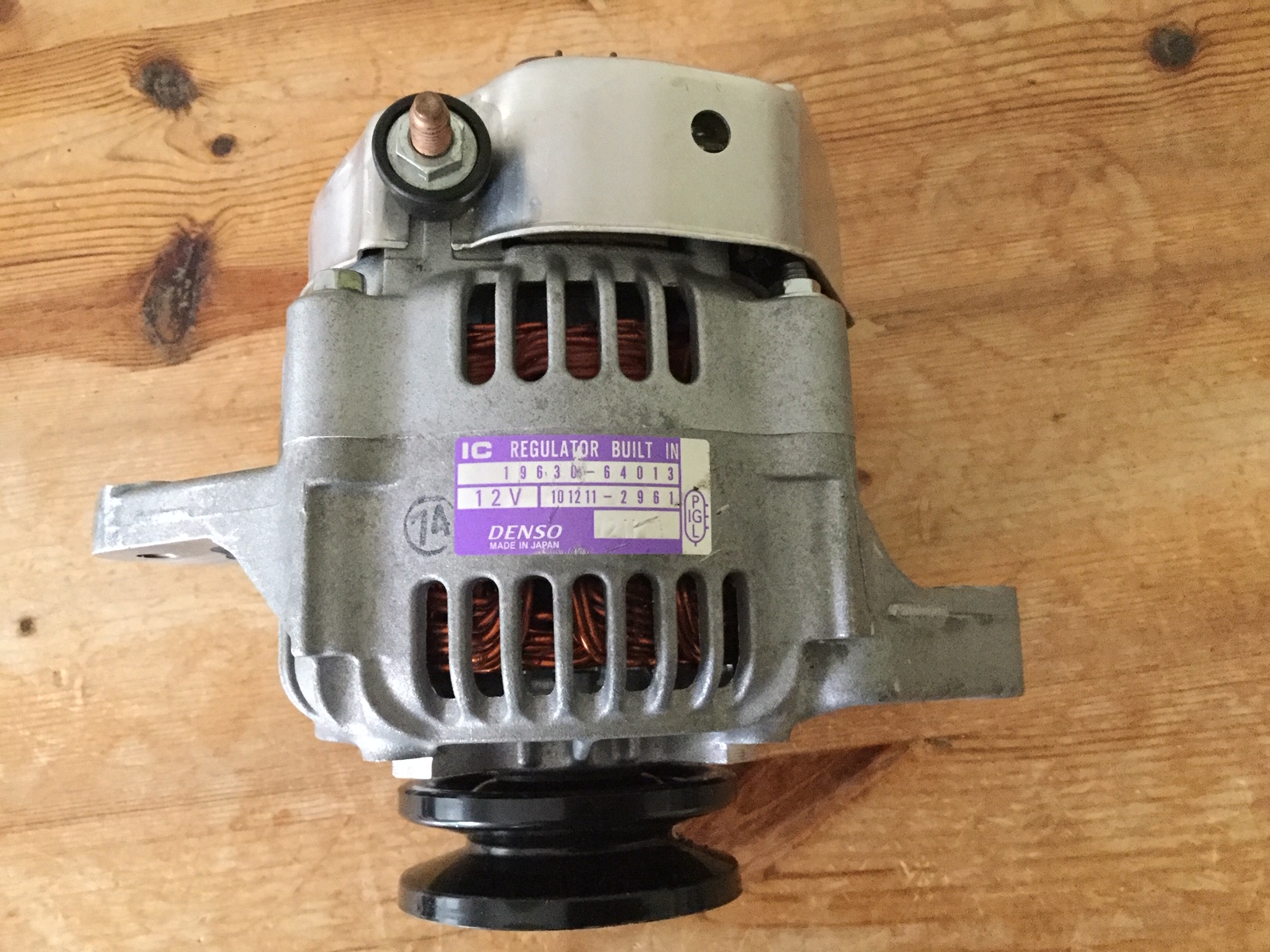

Like others, I used a turnbuckle-like adjuster to connect the bottom lug to the engine front-plate. And this is where I was forced to remove metal from a second area of the alternator case.
The problem is with the orientation of the two mounting lugs. The two lugs on the Denso alternator are situated opposite each other; ie at 180° apart. The corresponding lugs on the Lucas alternator are only about 120° apart.
Here are the two alternators, viewed head-on:
(The photo of the Denso unit was kindly provided by Jon C. Note that he took the photo with the alternator mounted on a block, though I don’t think that it’s an original MOWOG part
Also, his casting is ever-so subtly different to mine, being a Chinese knock-off sourced from the States.)
[attachment=1]27727CAE-B7D6-40AE-955B-A04241B8C3B1.jpeg[/attachment]
[attachment=0]906DD7B8-B370-44FE-A152-51BDEDA0D9BE.jpeg[/attachment]

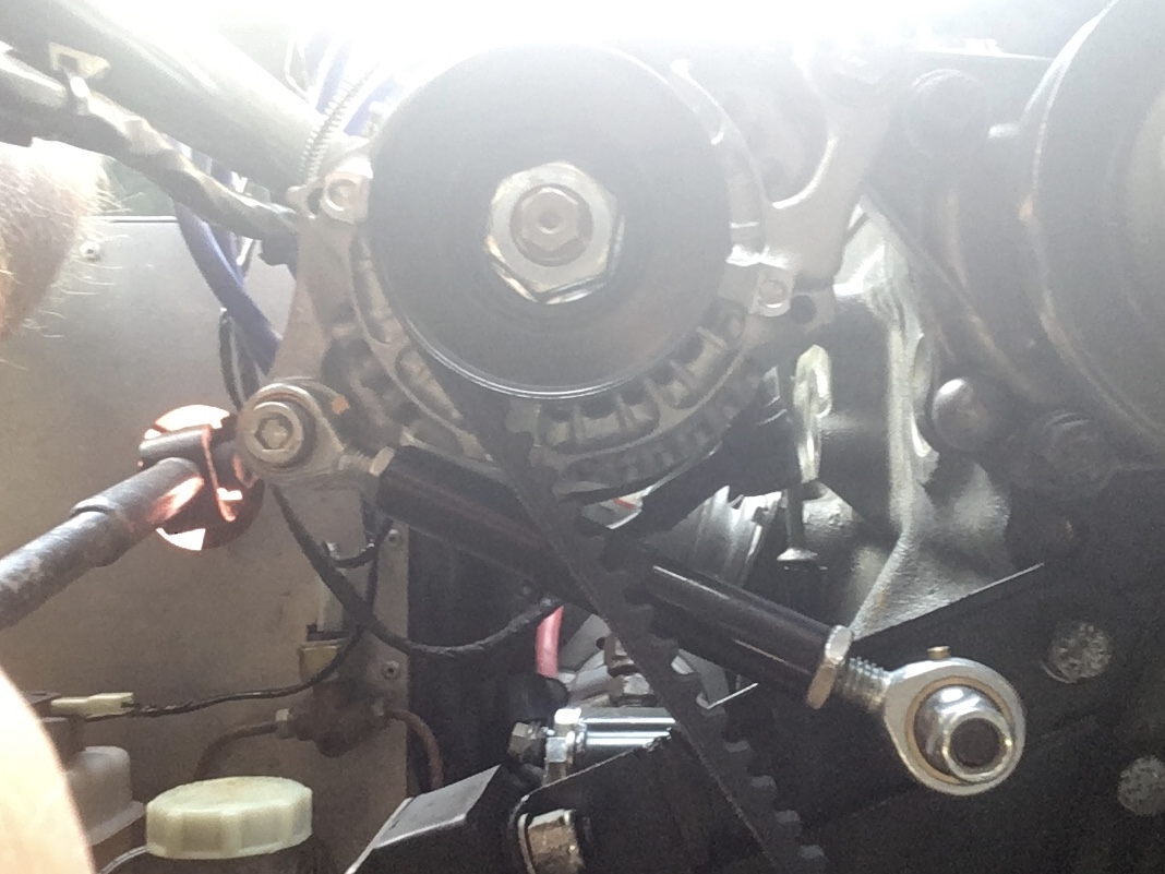

Again, I failed to take “before” photographs, nor any “after” ones before I fitted the alternator. Trying to show what metal was removed is difficult with the unit fitted. Hopefully these photos are good enough?
One shows the Denso unit in place, with the turnbuckle adjuster fitted and correctly adjusted. The second is a rather crude attempt to show what was removed. The red arrow points to the visible end of one of the four threaded bolts that hold the alternator together. I had to remove all of the metal that this screws in to, making this bolt redundant!
[attachment=1]A1CFCB82-E011-453B-BB1F-630ED1EBF0F4.jpeg[/attachment]
[attachment=0]3226858D-C37B-4D47-ACD1-9BC5C2F130BD.jpeg[/attachment]

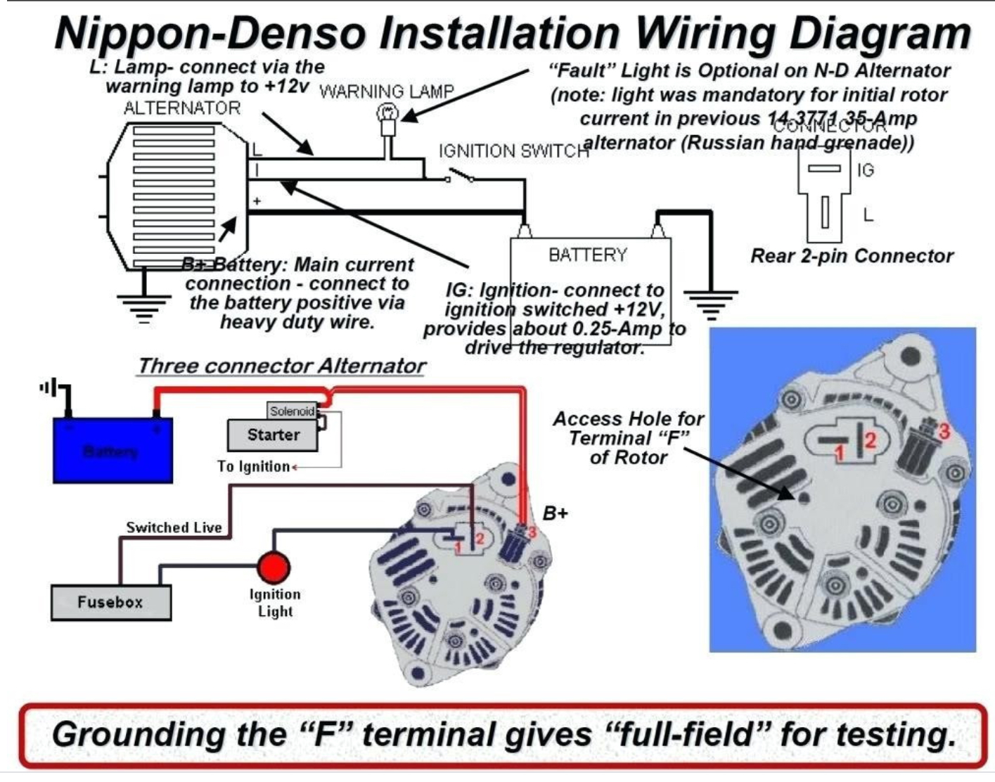

Here is a pic of my Denso. It is an original, and is the same as the one here:
https://www.ebay.co.uk/itm/Denso-Kubota ... Swexlc2pSK
Mine has the three pin connector, and the pin-out is shown in the pic.

A cropped version of Splat’s wiring diagram.
