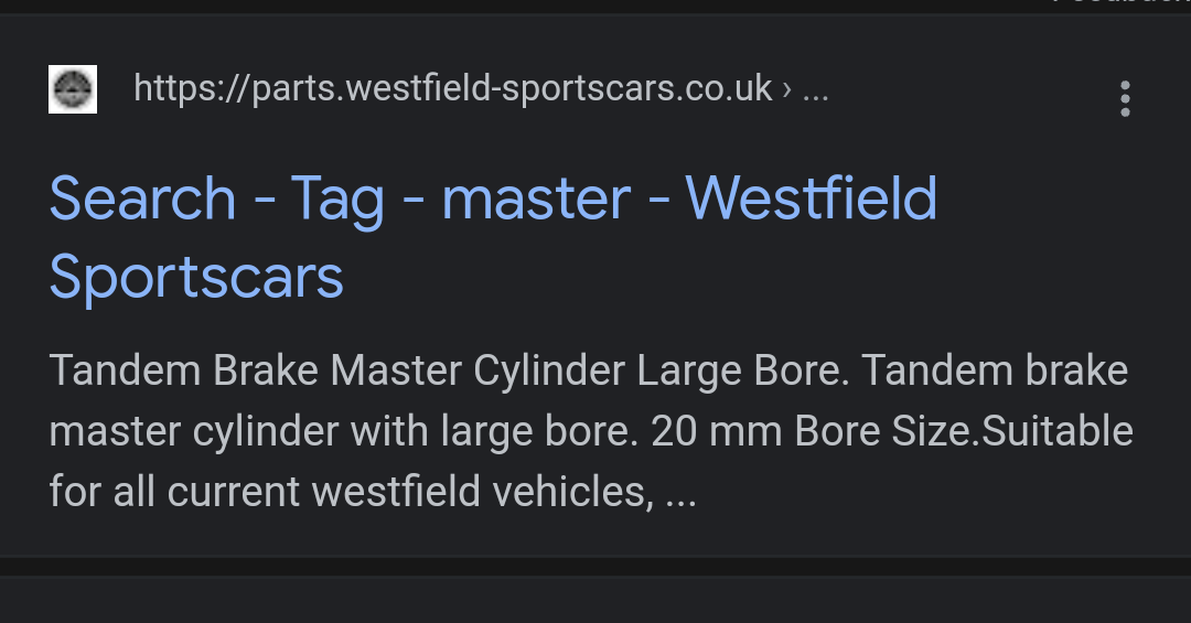

At least I now know that the bore is 20 mm, but £300+ for a new one.......? Would be nice to have remote reservoirs to save digging down past numerous pipes/ cables to reach it in its current position.

Ah ha thank you, I don't think that specific one is sold now but the equivalent may be this one as fitted to Caterhams (if I can upload a screen shot). Being a cheapskate, £365 is a bit on the steep side though for me.
