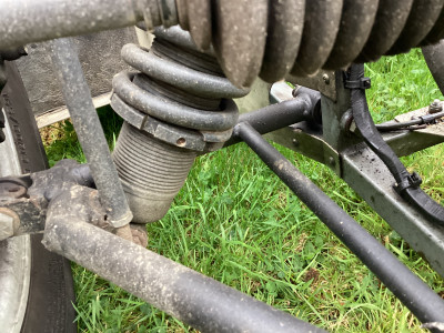

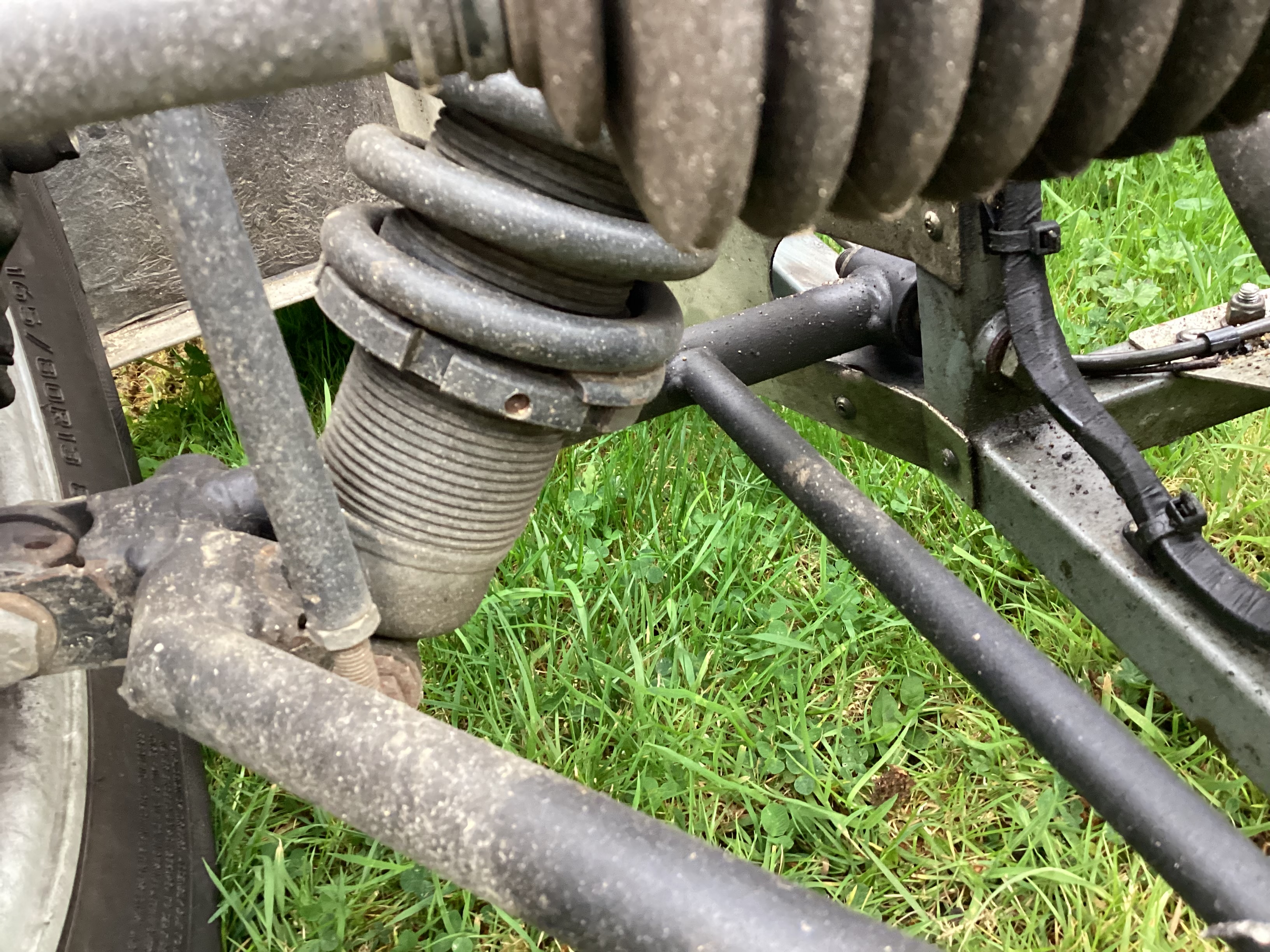

Splat dropped round a couple of C spanners yesterday (thanks, old boy!). I’m back onto this mini-project.
Thanks for your short instructions, Jan:
“Set the ride height, empty at 6” front, measured from the frame down, 7.5” empty in the rear, measured at the frame, under the axle. Subtract 3/4" from the passenger’s side measurements. You will know that you have it about right when the difference left to right, unladen, is about 3/4”~1". This should put the corner weights about right, with the diagonal LF~RR, at about 50%, or zero wedge. If you are around 180 lbs, give or take, it will be nearly spot on. The chassis should sit level, with the driver i the seat, at about 5” front, 7” rear. Any adjustment will be easy, as the setup will be very close. Clean the threads on the damper body, and if possible, grease the spring seats for easy adjustment. Done properly, you can twist the spring to make small adjustments. These are the settings that I have on my early car. My later car builds used the early car damper and spring lengths (which means that the later car rear dampers go in front… The rears replaced with longer ones, but I don’t have the precise numbers in my head. Have to look them up.”
I’m not sure why I thought my dampers were Spax. Maybe confusing them with my previous SEiW? They are black, and adjustable. I’m thinking Gaz. Mostly because of the locking grub screw, rather than the more usual locking ring.
