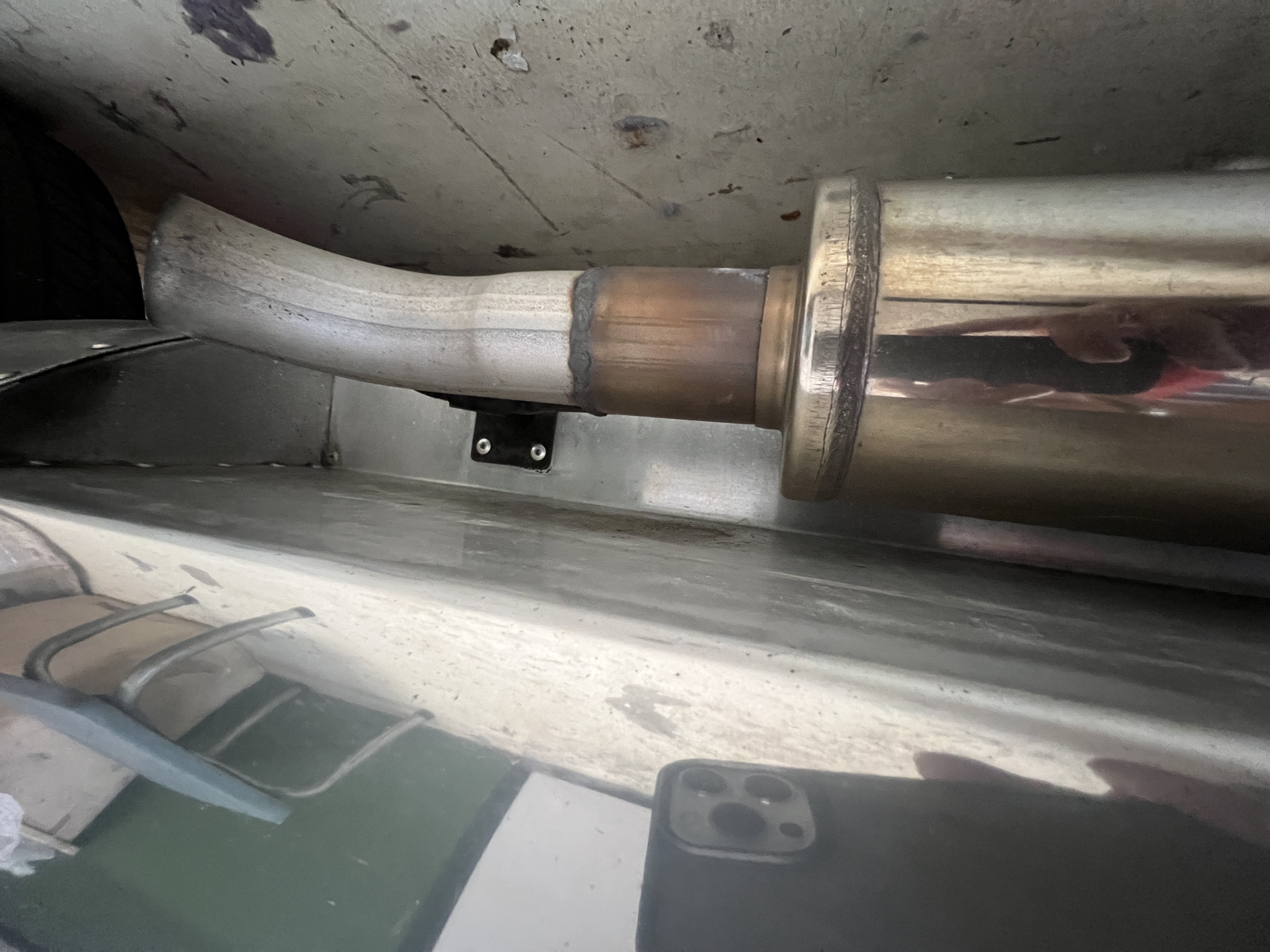

In road driving (new to me car), I noticed a clanking over bumps from the lhs. On investigation it's the silencer hitting the aluminium panel above it. It's slightly loose. At the front end the clamp is slightly loose. At the rear end it all looks a bit flimsy. Like a very big P clip round the silencer and bolted to the body.
I can nip up the clamp at the front, but I don't think it'll cure the problem. I need to make the rear "clamp" more capable somehow.
Also silencers ought to have some movement.
Any thoughts on the silencer mounting and whether it banging against the aluminium is normal/acccepted?
Thanks

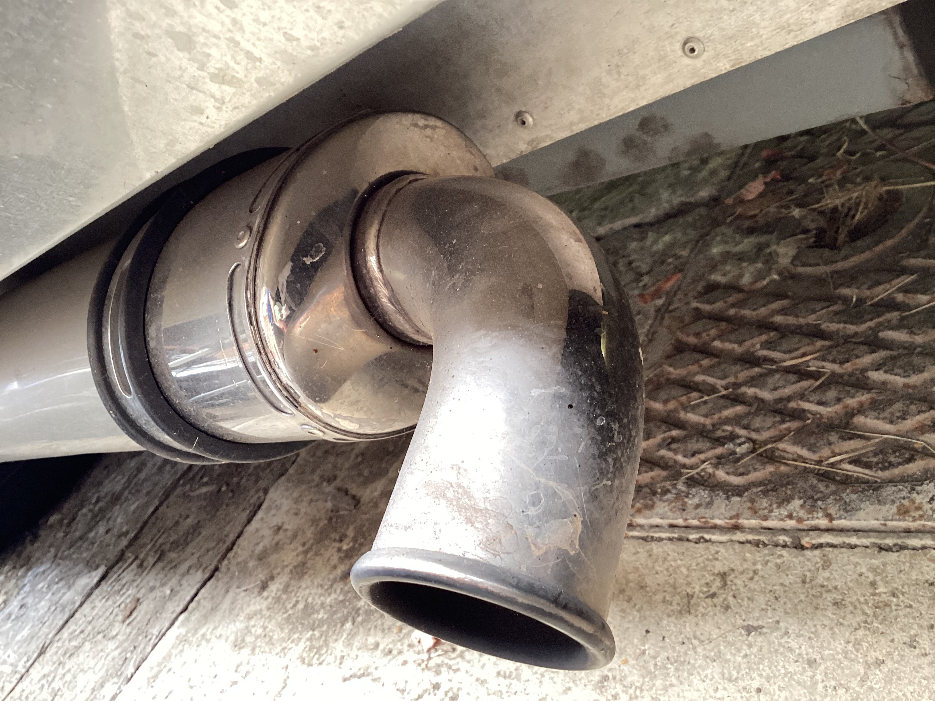

My most aft muffler mounting is attached to a rubber vibration isolator, screwed into the chassis. Properly done, this is all that is needed.
This example of Westfield 11 is a flat alloy floor model, with over 55000 miles.
Shown is the muffler, side view and view of the welded on exhaust pipe bracket and the vibration isolator and chassis fitting riveted into the chassis. The riveted plate has a nut welded to the back side so that the vibration isolator is easily replaced. This isolator os 15 years old, and is in fine shape.

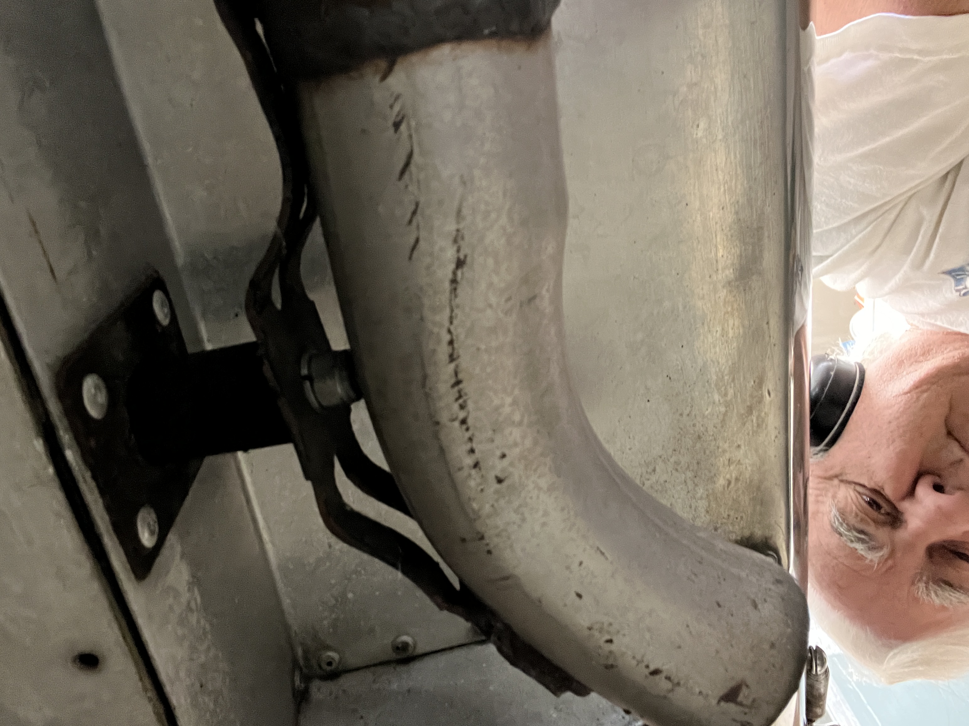

Here’s mine - standard fit. No clattering!

And I’ve seen the horrors on the underneath!

Yep, that's the fitting I have, I'll just need to get under and investigate,jonclancy wrote: Mon Sep 08, 2025 1:47 pm And I’ve seen the horrors on the underneath!![]()
What horrors Jon?

The tab on my car broke off. I replaced it with a flat plate and a nut welded to the backside. A hole was drilled to accommodate the nut, and the part riveted into the chassis. The stand off is a vibration isolator. I forgot what the length was but the thread is 1/4" or 5/16".
The bracket on the exhaust tip is a bit of a bother, but I do have a good muffler shop that has reasonable rates. I just took the muffler down to the shop and had them weld on the bracket from the old exhaust.
