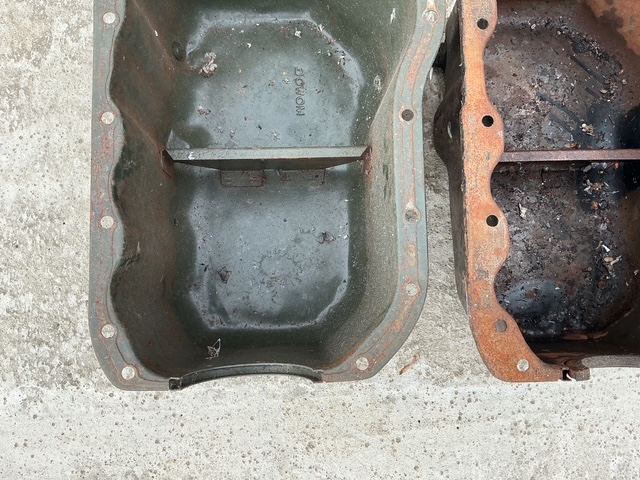

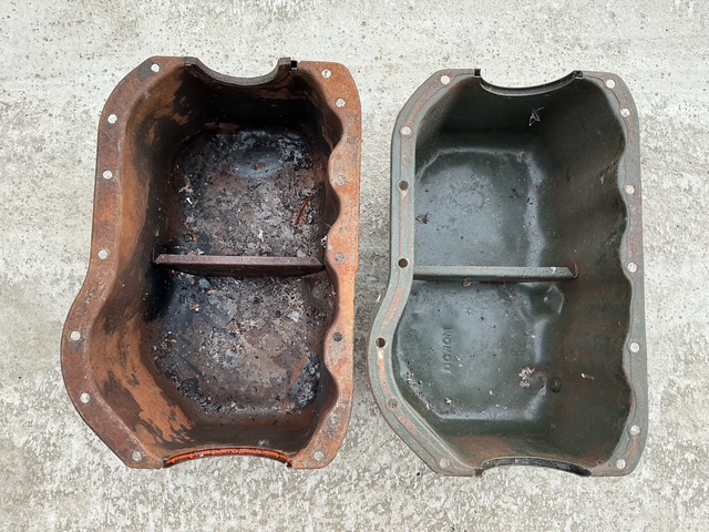

It was fitted to my car, but some loose blast media inside the sump (probably encapsulated within the powder-coating) wrecked the oil pump. I had the engine refreshed and new cam fitted at the same time. There was no discernible damage to the bores etc, but I replaced the winged sump with a standard item. They are relatively cheap, easy to fit, and protect the engine backplate if you ride over a speed bump, rather than hitting the exposed backplate with the winged version.

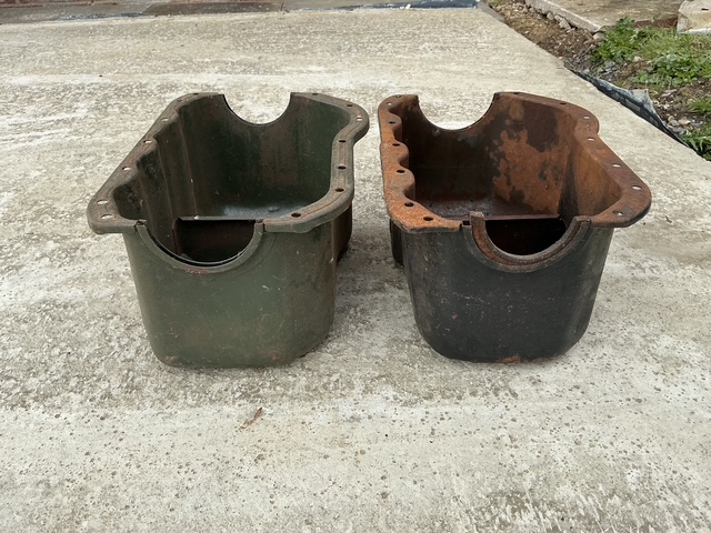

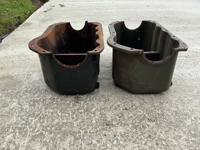

I have a motley collection of sumps, but thought that it may be worthwhile pointing out that earlier sumps are subtly different from the later (1275) models. You may have heard of the thin and thick flange blocks. In this case, the 1098 sump flanges are a little narrower than the 1275 sump in a couple of places, and the 1098 sump has a bead running on the top surface. 1098 bearings a apparently smaller than the 1275 ones, too. I’ve not checked that.

Finally, as a pic is worth a thousand words, here’s a few:
