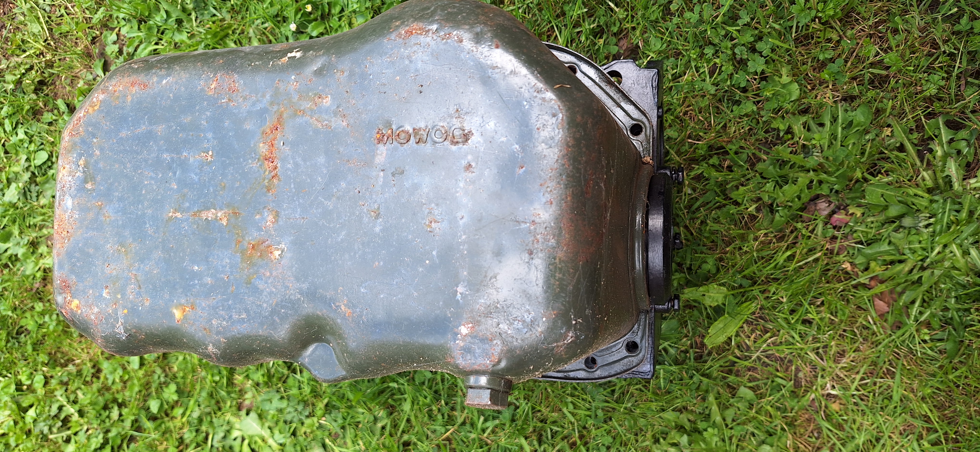

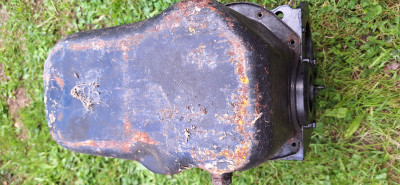

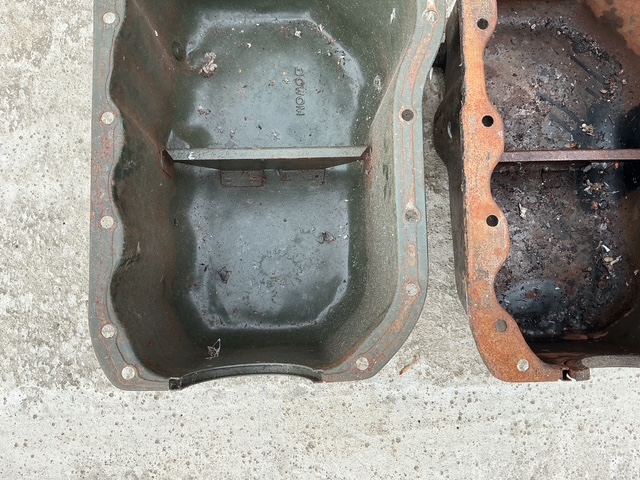

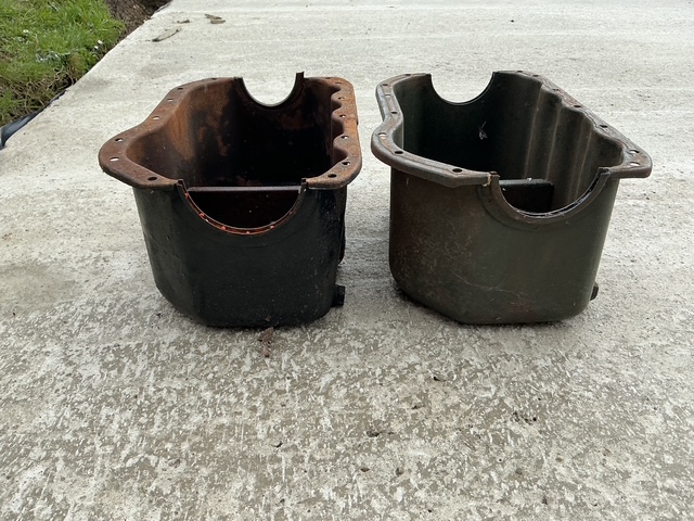

I have a motley collection of sumps, but thought that it may be worthwhile pointing out that earlier sumps are subtly different from the later (1275) models. You may have heard of the thin and thick flange blocks. In this case, the 1098 sump flanges are a little narrower than the 1275 sump in a couple of places, and the 1098 sump has a bead running on the top surface. 1098 bearings a apparently smaller than the 1275 ones, too. I’ve not checked that.

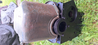

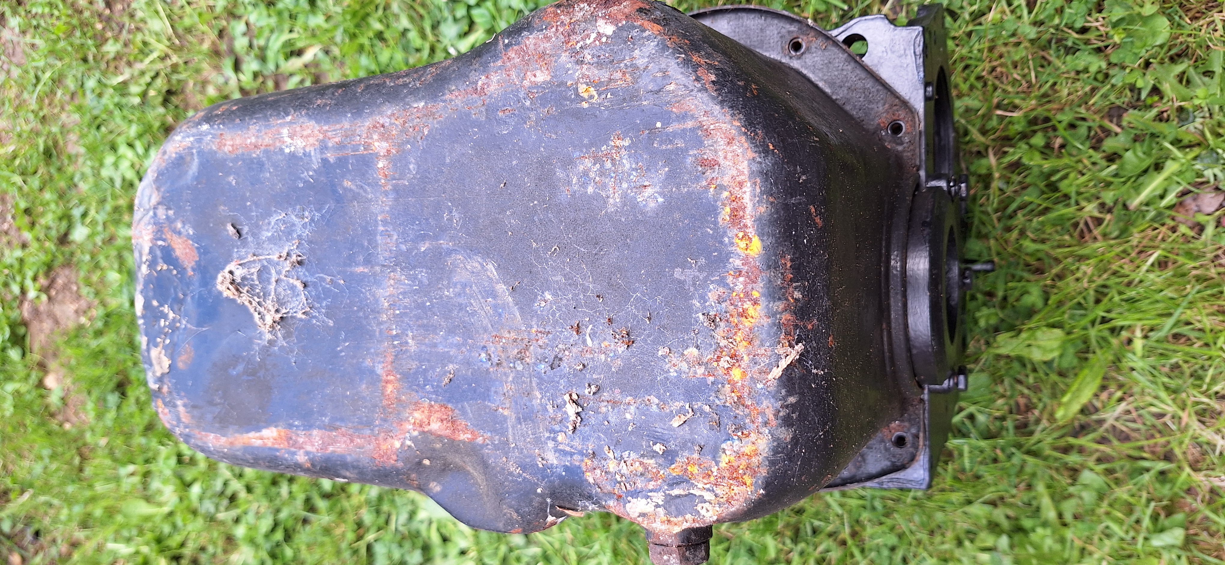

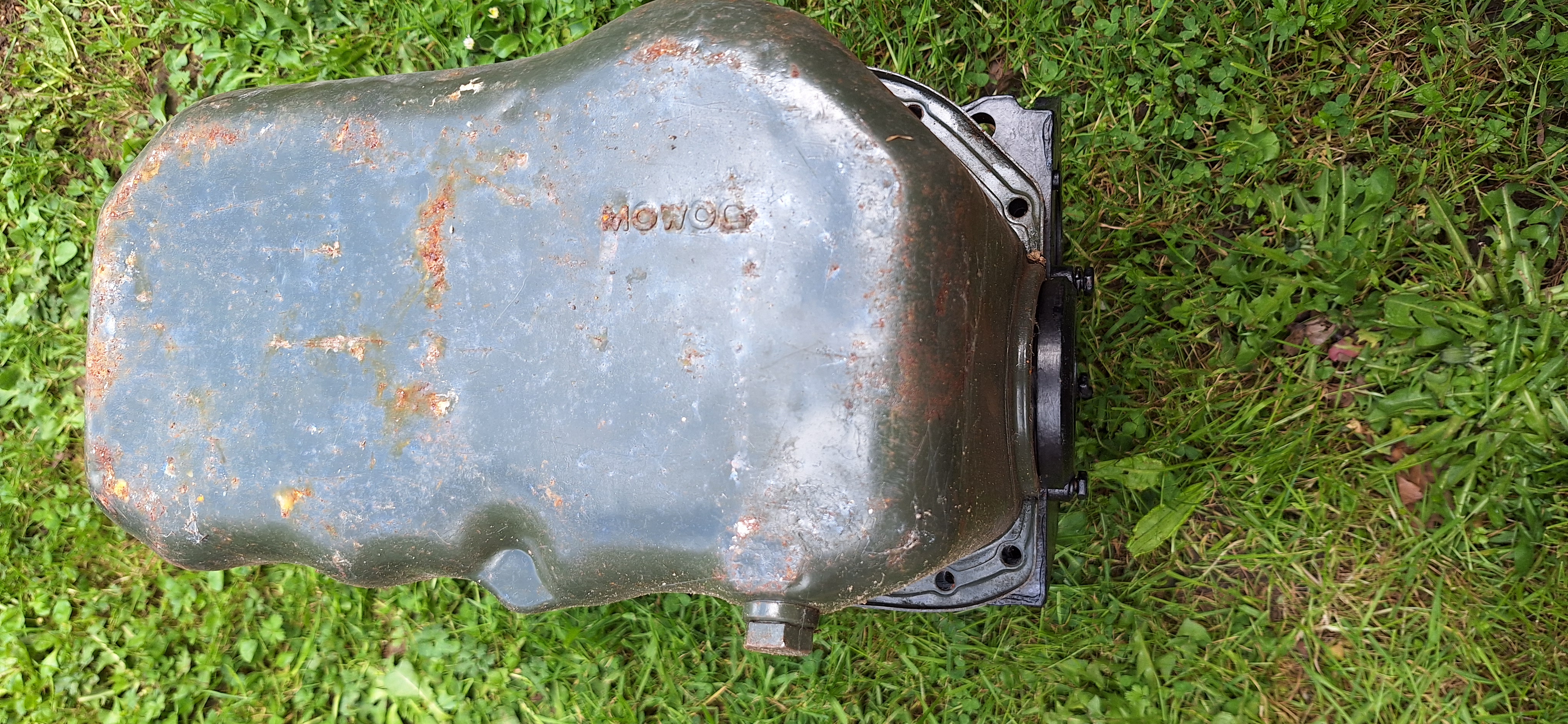

Finally, as a pic is worth a thousand words, here’s a few:

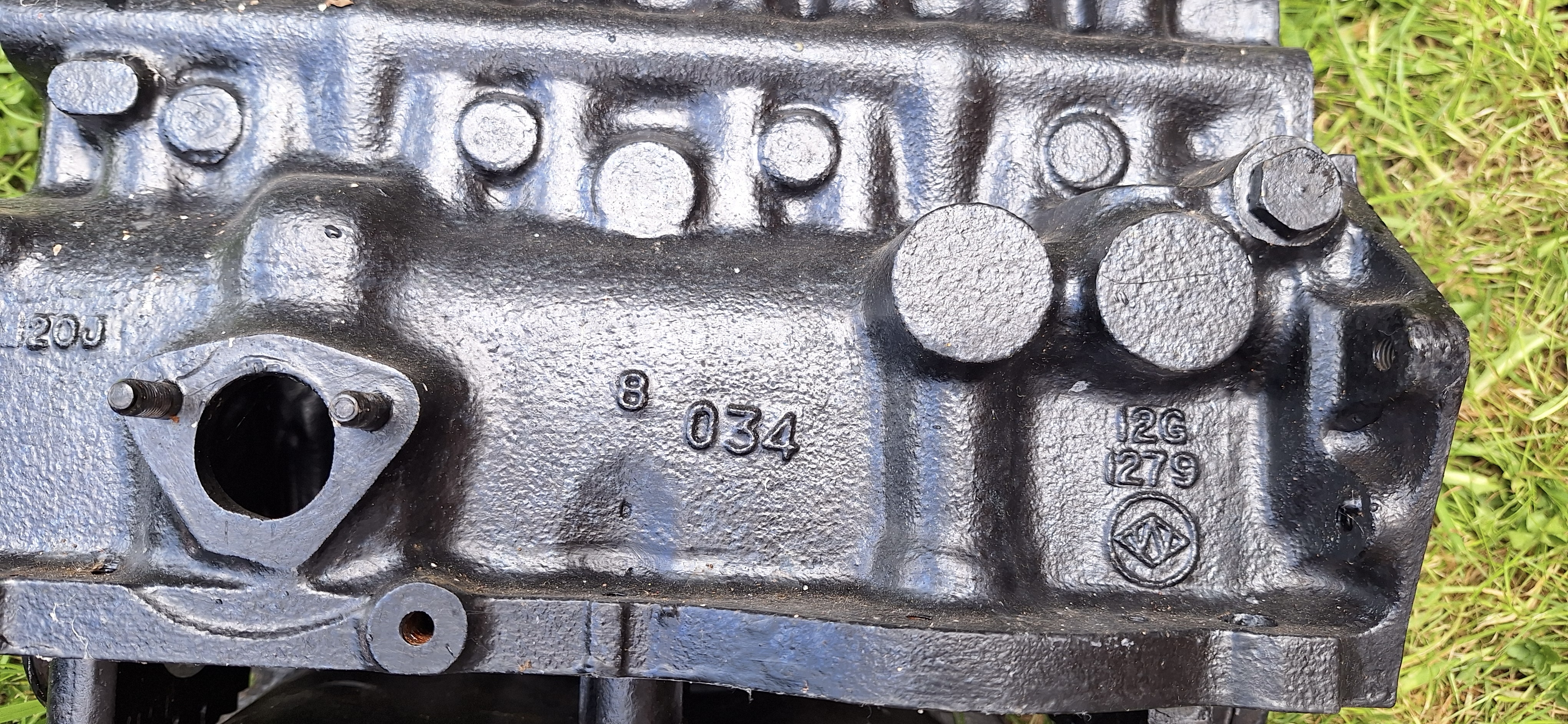

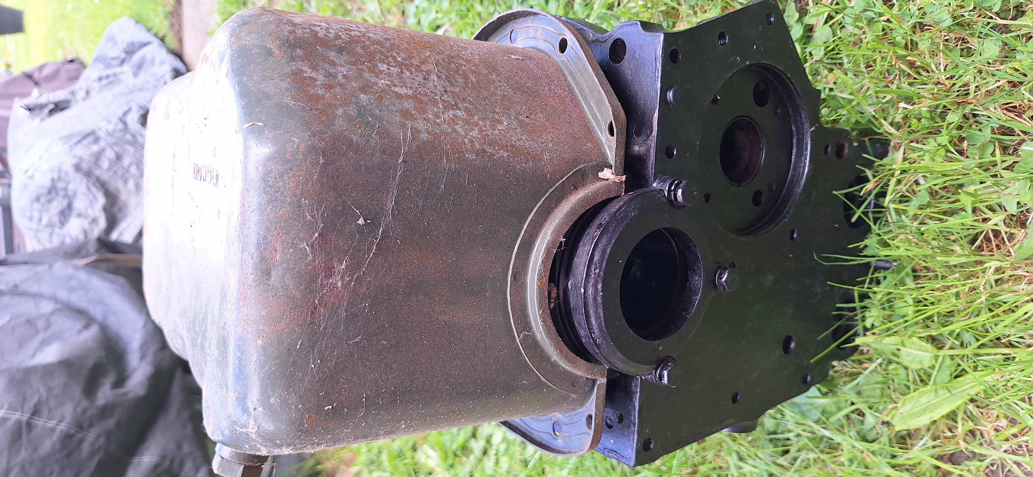

An the proof of the pudding is…

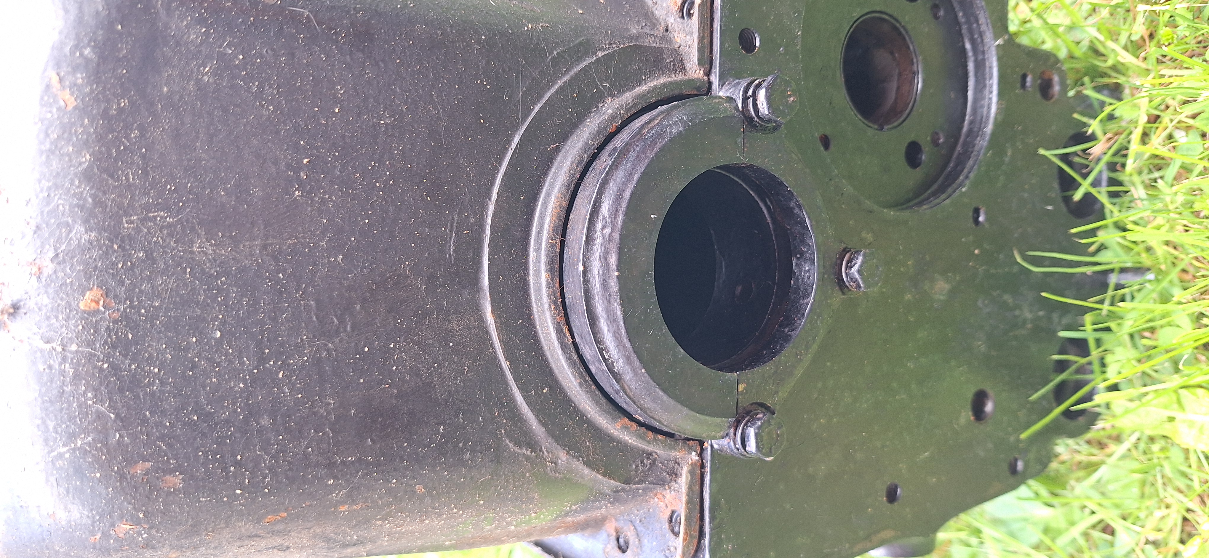

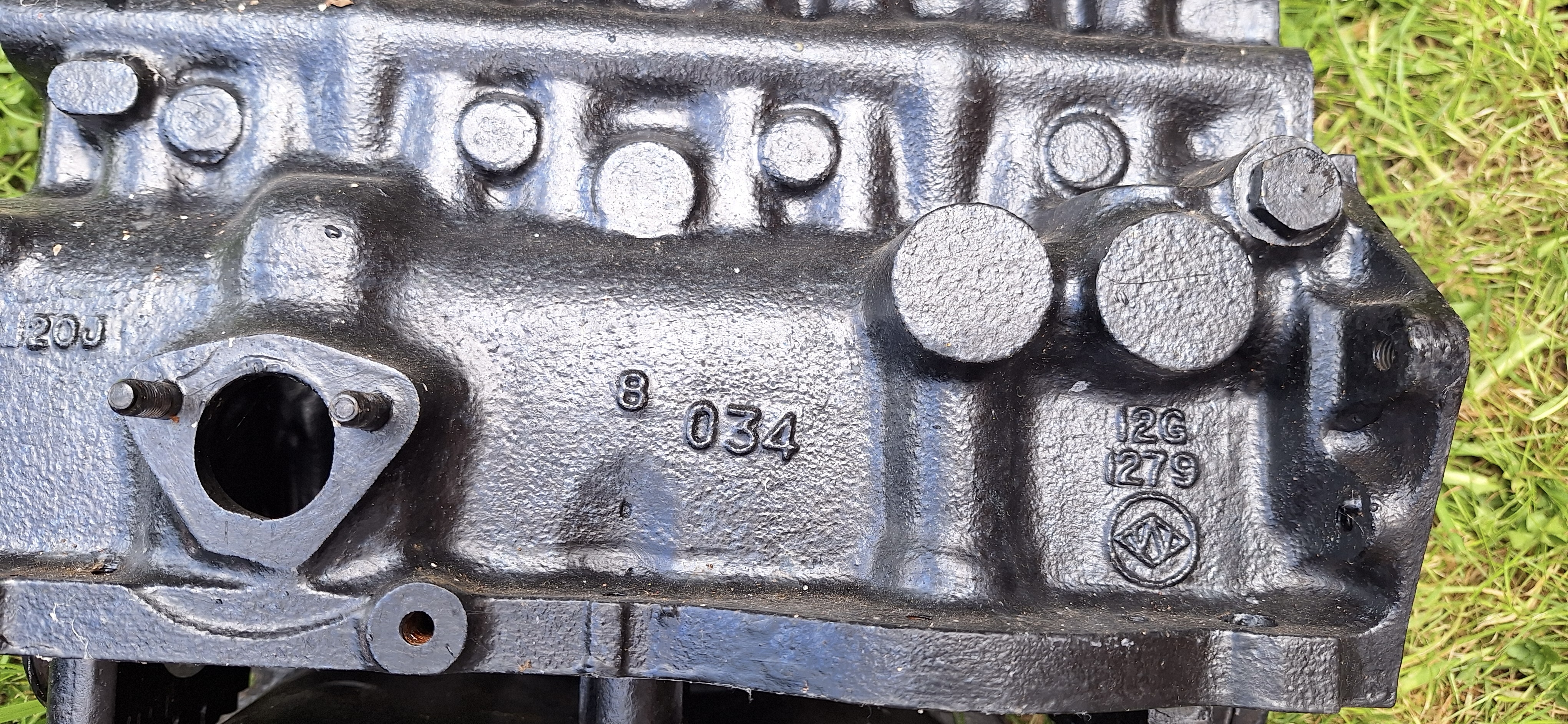

Earlier sump (Morris Minor or 1098?) laid onto 12G1279 1275cc Midget block.
Posts: 1045

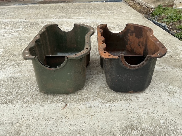

Re: Sumptin’ ‘bout Sumps

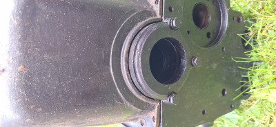

And with the correct sump. I’ll edit in the rear main bearing diameters later.

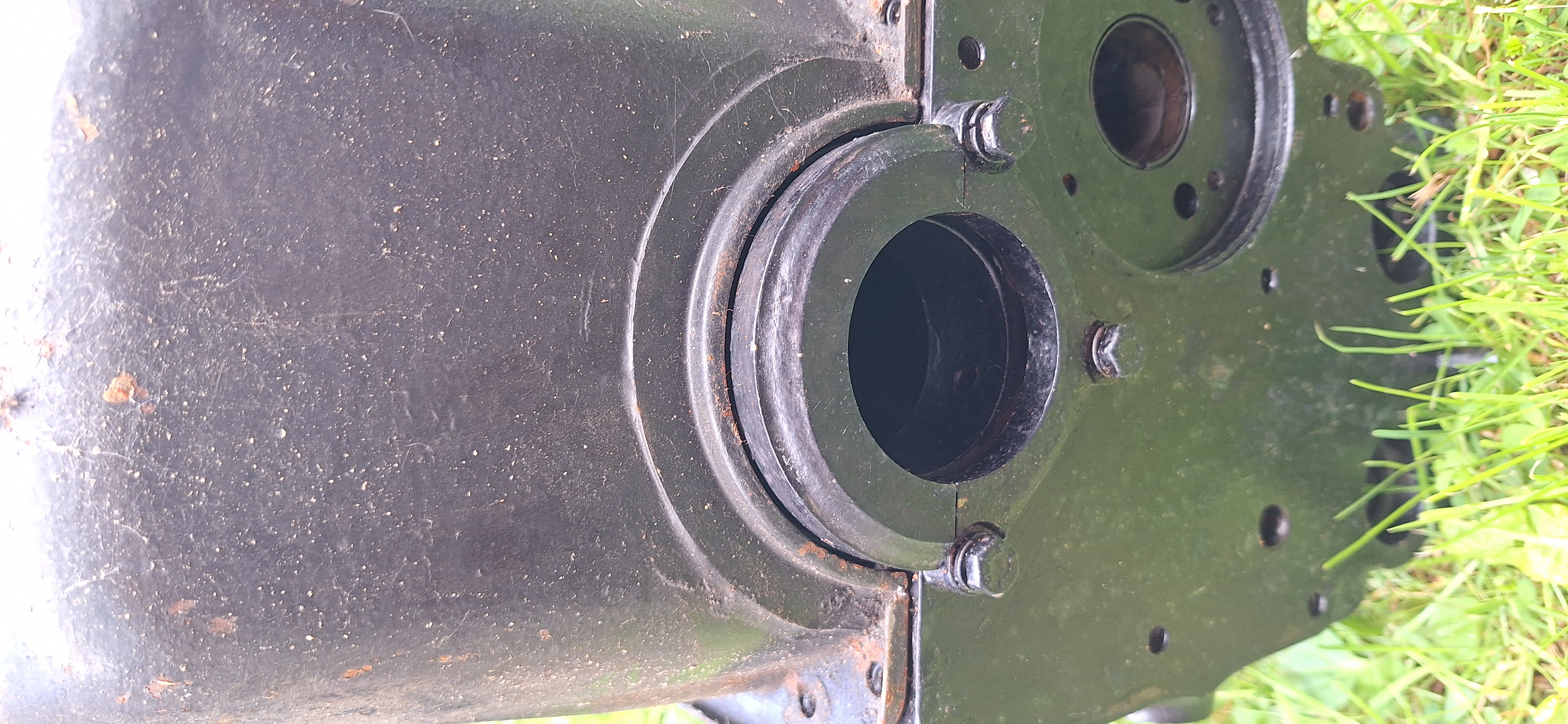

Results are in:
On the MOWOG sumps, both front and rear bearing housing diameters are 94mm.
On the 1275 sumps, the front bearing housing is 94mm. But the rear bearing housing is 102mm.
So, even without a rule, you’ll be able to spot a 1275 sump on eBay etc visually. No more buying useless sumps!
