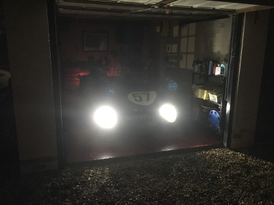

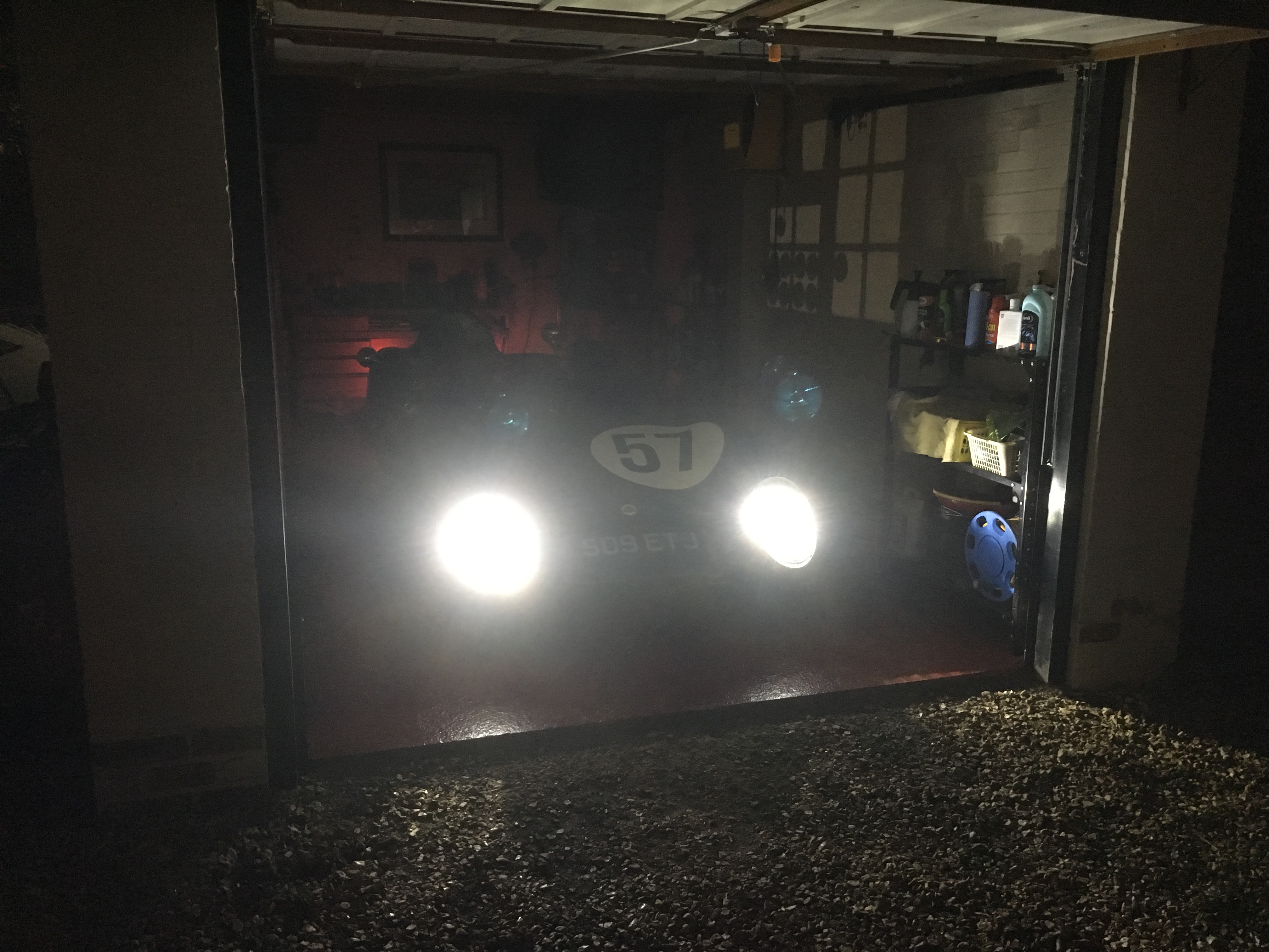

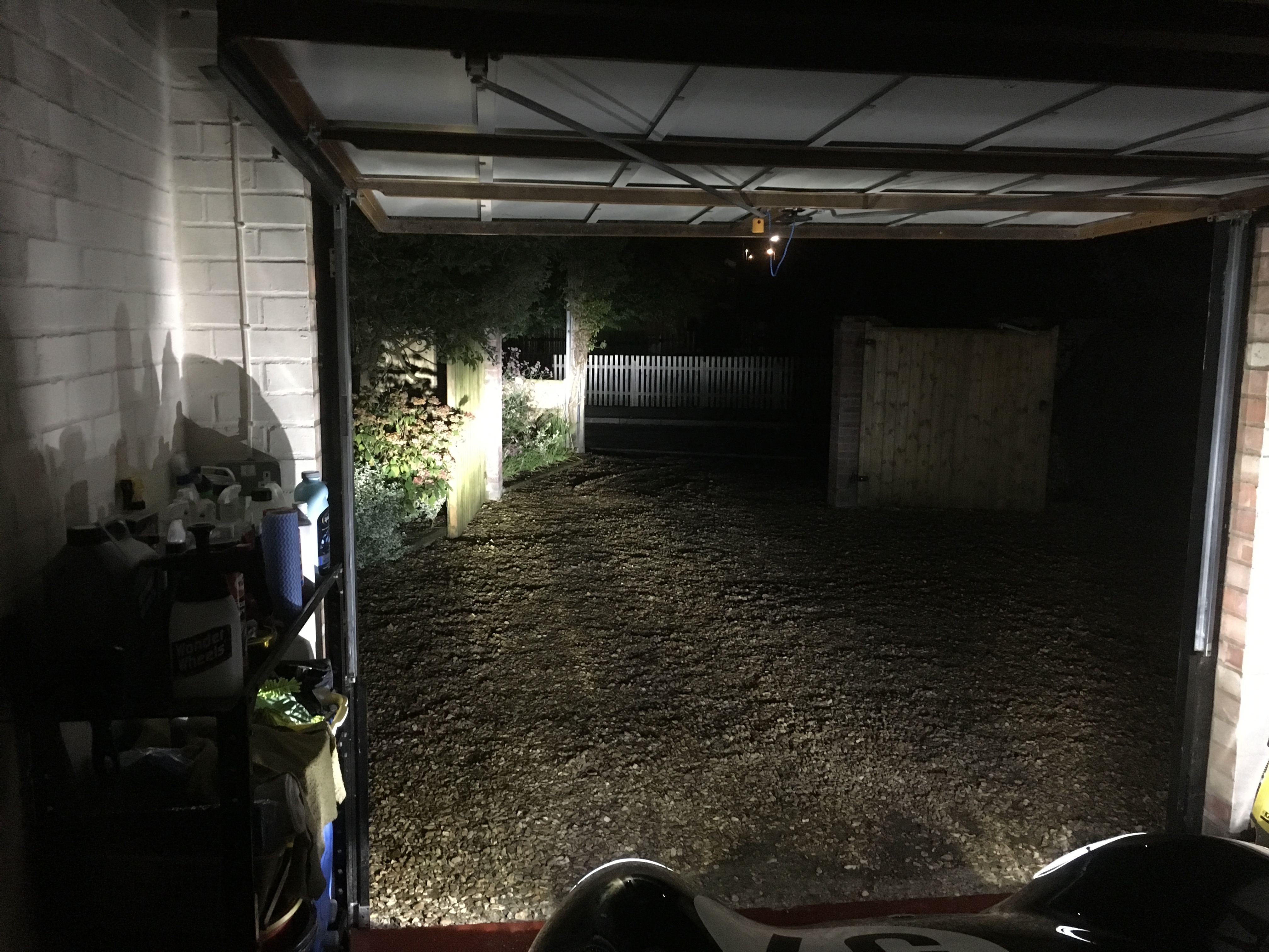

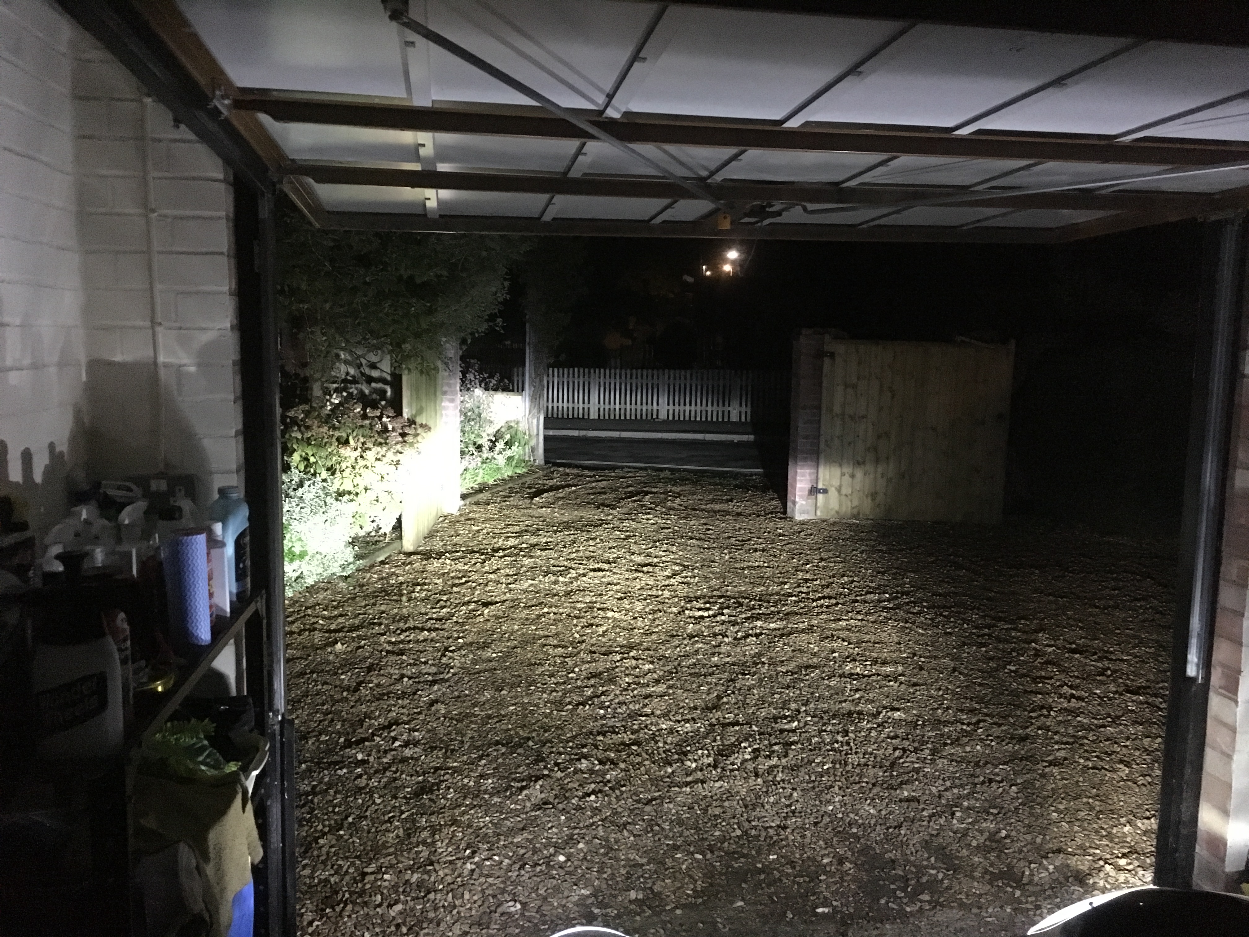

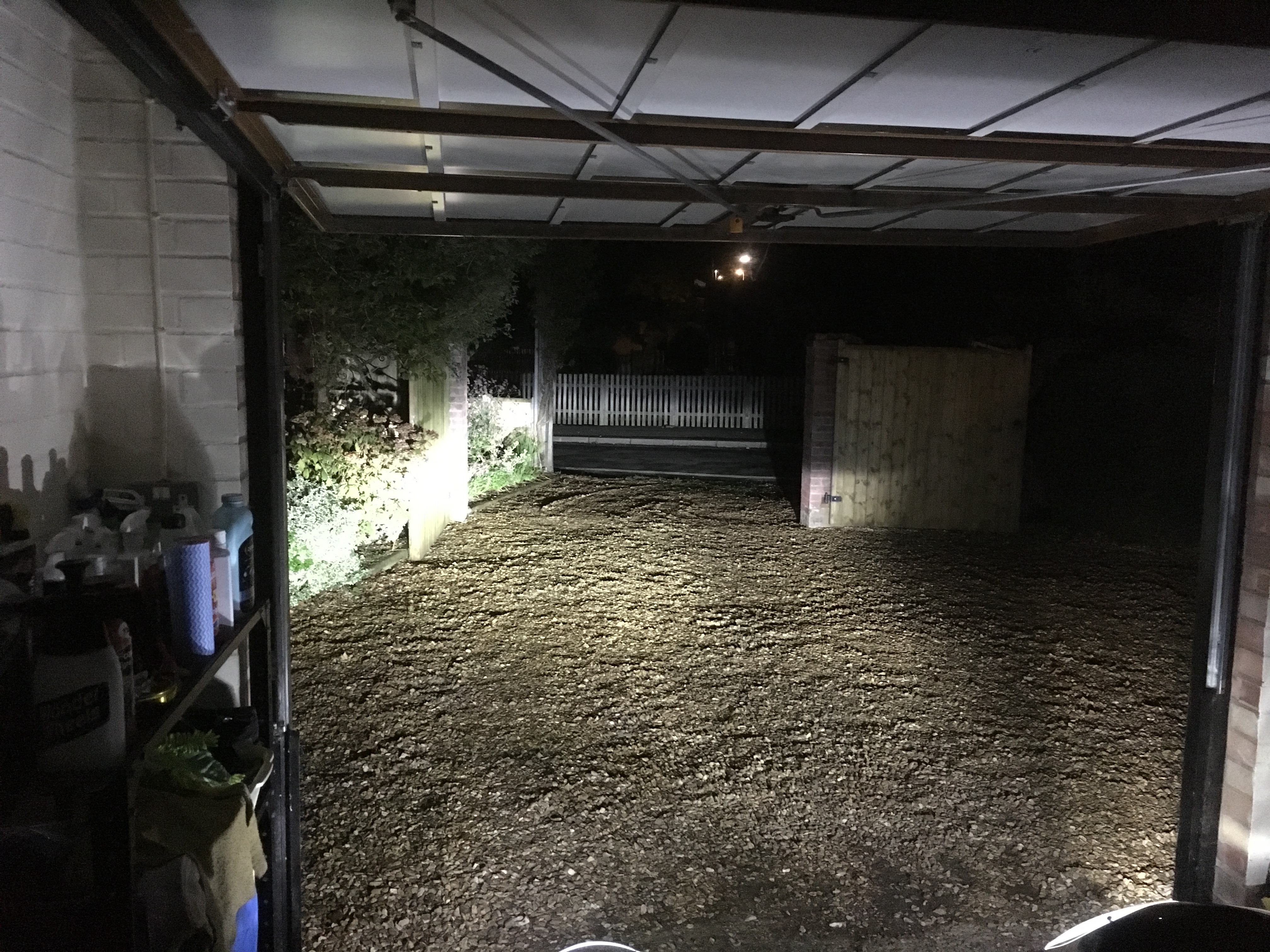

I took the time to tack a dust sheet to my gates and adjust the woefully ill-adjusted lamps (the dipped-beam cut-off should fall 3" below the centreline of the lamps at a distance of 25', etc).
Here we see the lights, dipped beam and main beam (engine off):
