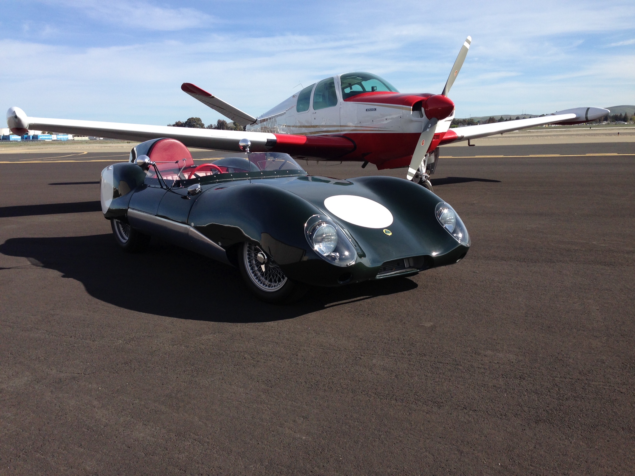

BTW, the Westfield 11 that is in my build album on the westyxiownersbuildersdrivers site is going to be up for sale.
This is the finest W11 that I have ever seen, and it drives beautifully. Everything from a 125 HP engine to the LSD and Protech double adjustable dampers. CR SP components 5 speed, custom rad and competition front spindles with Timken bearings, with a dual master cylinder, bias bar brake system, double bearing hub rear axle with Peter May axles, all on 15" wire wheels with vintage race Dunlops. Fully sorted and serviced. 4500 miles.
This one is not inexpensive, with a build cost of around $60,000 USD. However, a good deal can be made.
Unfortunately, the enthusiast owner is unable to drive.
There is also a lovely 1950 Beachcraft Bonanza available, fully updated.
I can send a picture of both if anyone is interested.

Both pics here for us lot, please.
I like the sound of the Bonanza. What'll it rev to, Mister? :D (About 2650, I reckon).

The W 11 is the same one that I featured in my build album.
1380 with AE pistons, Longman 11 stud cylinder head, SPVP3 cam, 10:1 compression
Balanced rotating assembly
1.5:1 roller rockers
45 DCOE, properly jetted
6" Maniflow intake
Fidanza alloy flywheel
Custom Maniflow exhaust header
Med Engineering crank damper
Hitachi mini alternator
Pertronix ignition sysgtem including distributor and spark box/rev limiter
Custom double pass radiator with ductwork, metal surge/fill header tank
SP Components T9 "Long 1st" CR 5 speed gearbox with short throw shifter
Rear axle assembly with TranX LSD and Peter May spline hub axles
Double bearing hubs
15" wire wheels 5X15 front and 5.5X15 center laced rear
Dunlop Vintage race tires 4.50X15 front and 5.00X15 rear
New RHD steering rack
Huffaker front race spindles
Timken taper wheel bearings with shims
Custom electrical harness using Lucas wire code and Painless fuse box
Fully sorted (driven by the owner from my garage in Thousand Oaks his home in Concorde, CA , a trip of 400 miles) and used for long tours through the wine country.
Here is the '50 V Tail and the RHD W11

I'll take both!! :D
