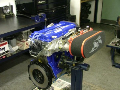

I have one of these in the workshop on a stand. :lol:
