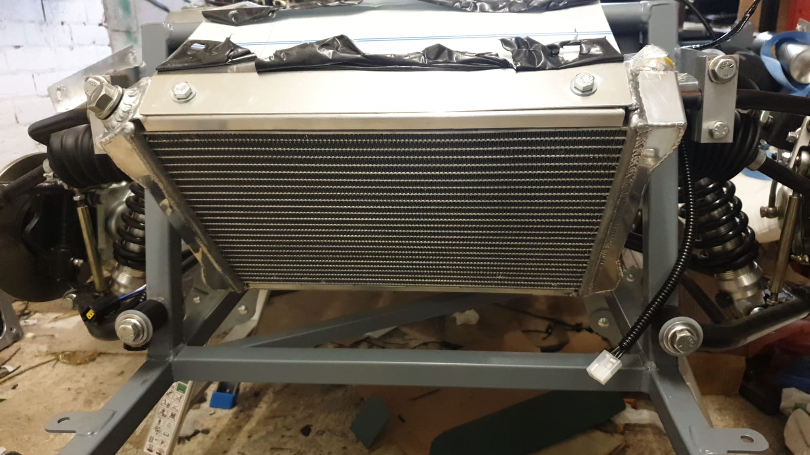

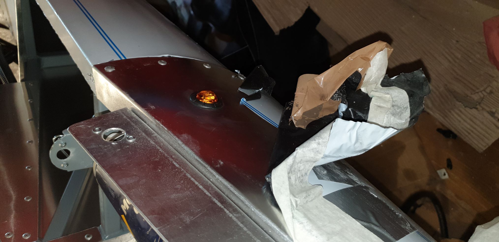

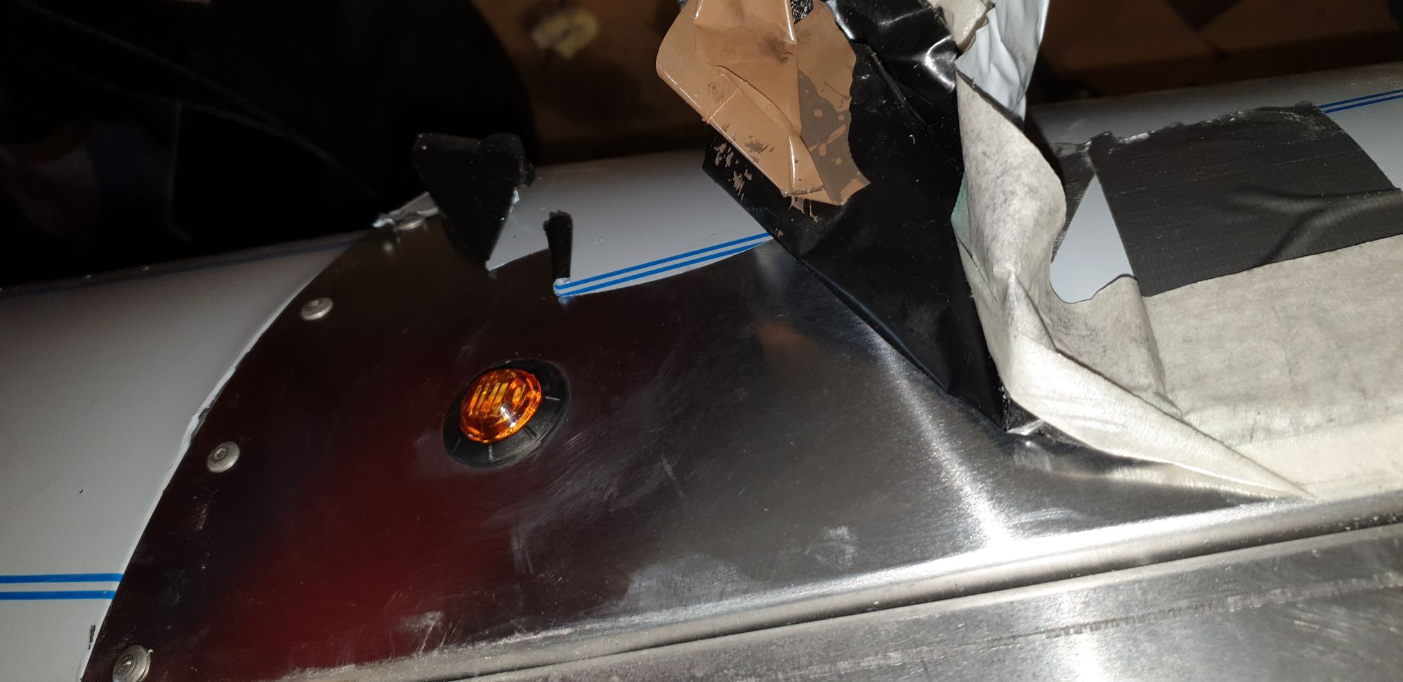

A couple more bits added. The radiator and the indicator repeaters.

I have been mounting the radiators slanted to the rear as the air flow goes in the front and out the bottom of the car, as did the original 11.
This may be complicated with the cooling system hoses, but the results are worth it. Make sure that your hose runs are within the chassis, and not below.
You should fabricate a duct to keep the air flow through the radiator, and make sure that there is a floor in front of the radiator, regardless of which way you mount it.
And don't use the supplied fan mounting. Keep the fan behind the radiator as a "puller". This will ensure cool running.

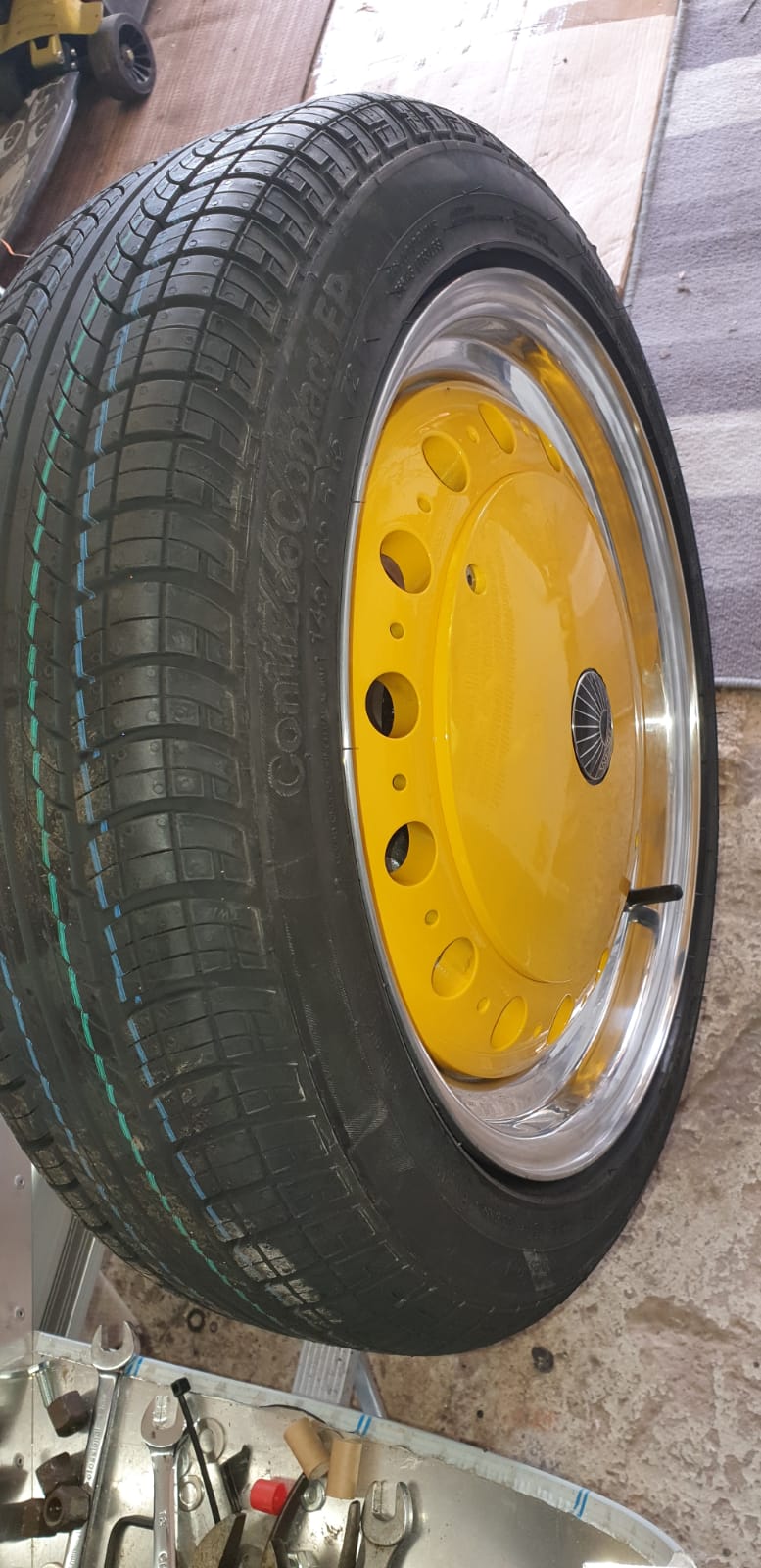

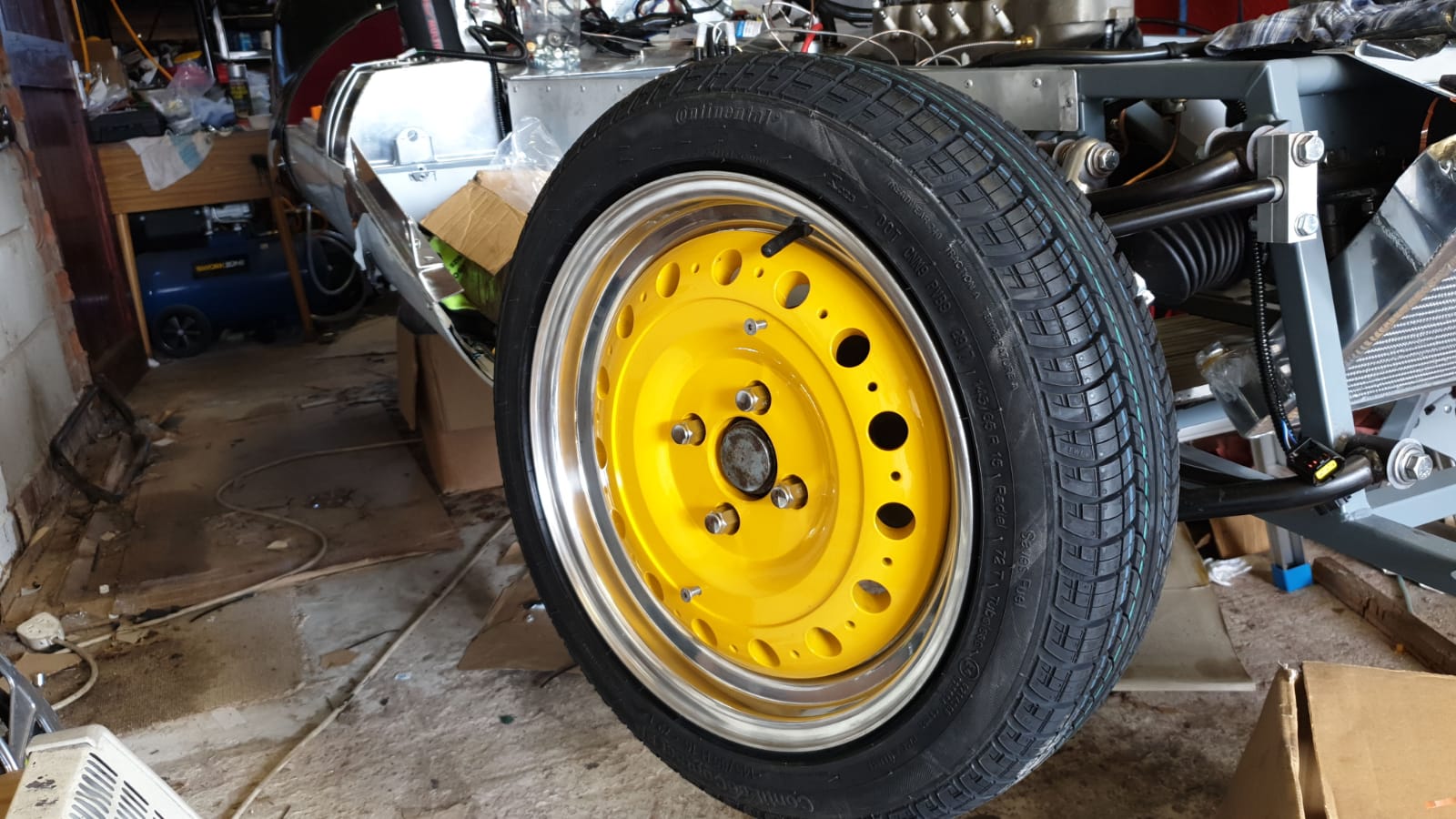

and a question for you all..
With hubcap or with out hubcap?

With. I think. Reminds me of early Lotus Seven...

Without.
My early series 1 Lotus 7 had 15" wire wheels, from the factory.
Do those tires fit under the bodywork up front?
Also, drill the middle of the anti sway bar block for a zerk fitting so that you can lube the bar. It will lap in nicely and not squeak or grind.
