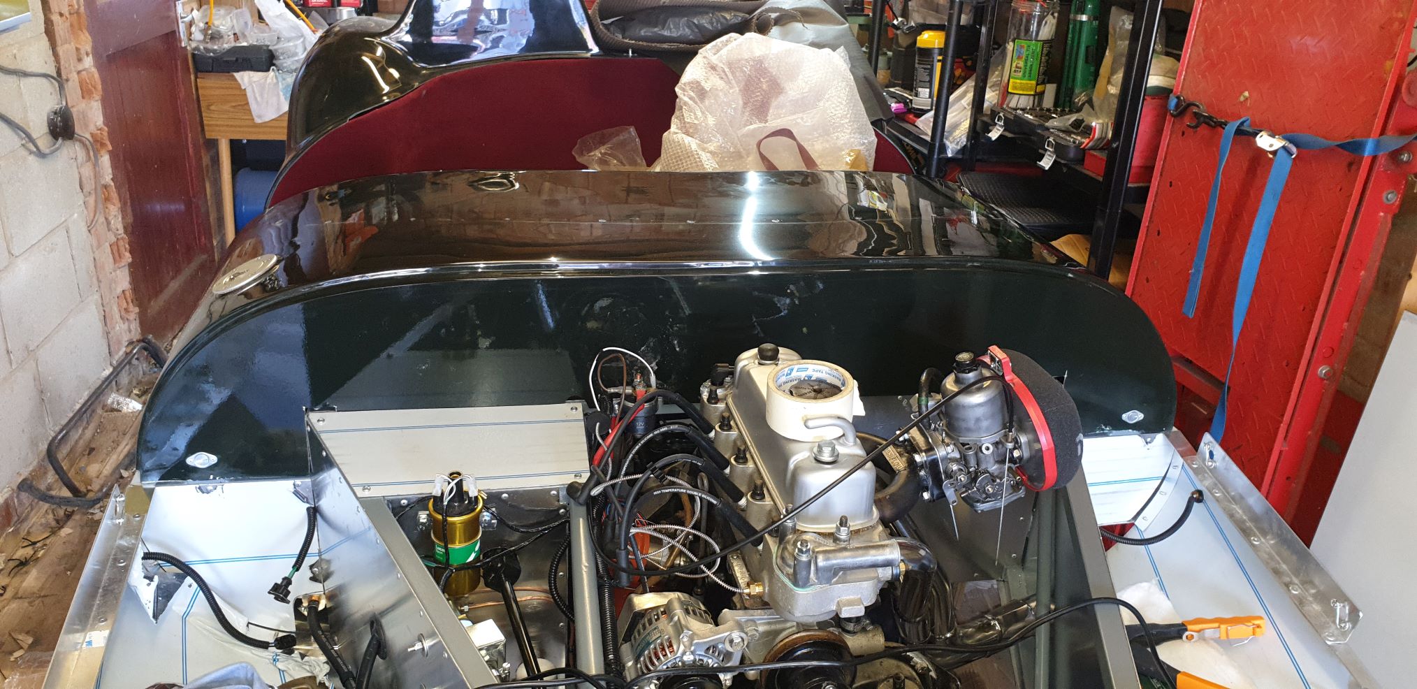

The wheels should be good to go as they are 22.5" dia.
The wiring under the scuttle is complete and scuttle trial fitted.
[attachment=0]scuttle.jpg[/attachment]

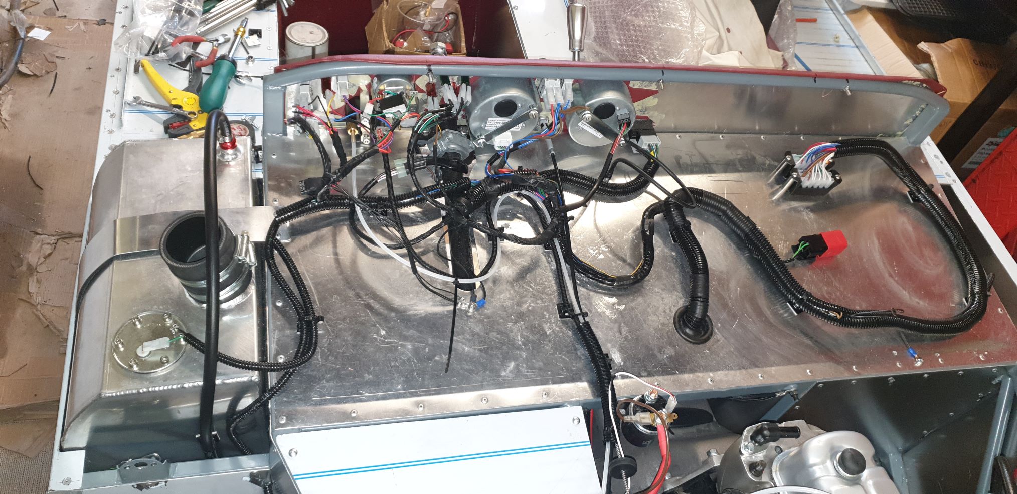

Dash wiring before the scuttle goes on ....
[attachment=0]dash-wiring.jpg[/attachment]
The battery should be fitted sometime this evening.

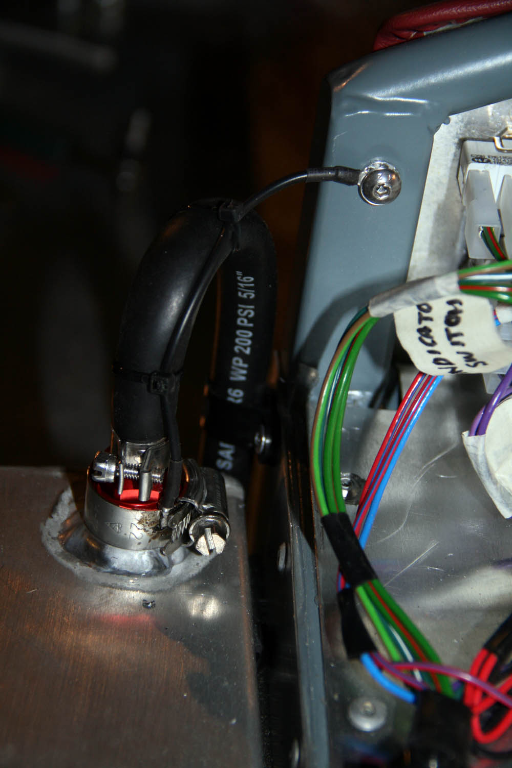

I can't see from the photo if you have a specific earth from the fuel tank to the chassis. When I presented my car for IVA, I was asked if I had and, as I had taken advice from one of the forums, I was not found wanting!
[attachment=0]Small IMG_5620.jpg[/attachment]
A wire soldered to a Jubilee Clip, clamped around the vent outlet and then run to a rivnut in the dash rail adjacent.

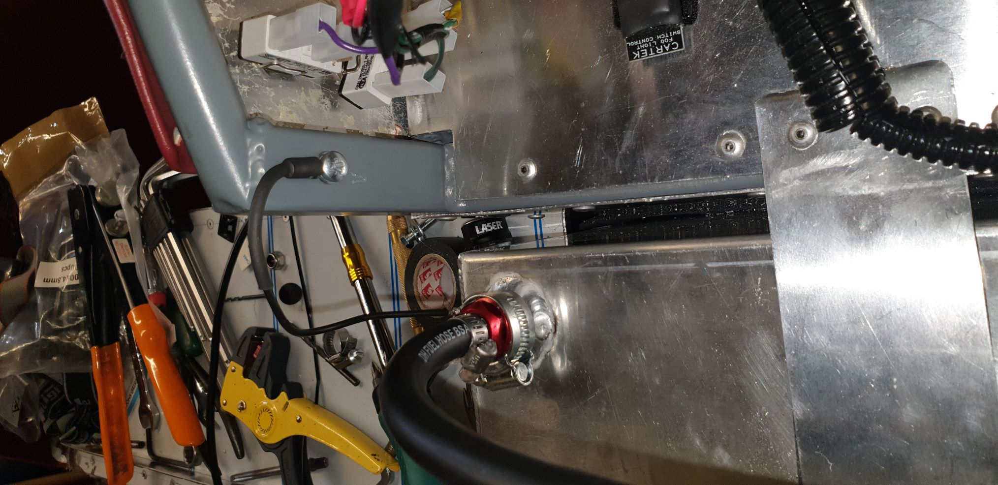

good point, sorted now. Thanks.
[attachment=0]tank earth.jpg[/attachment]

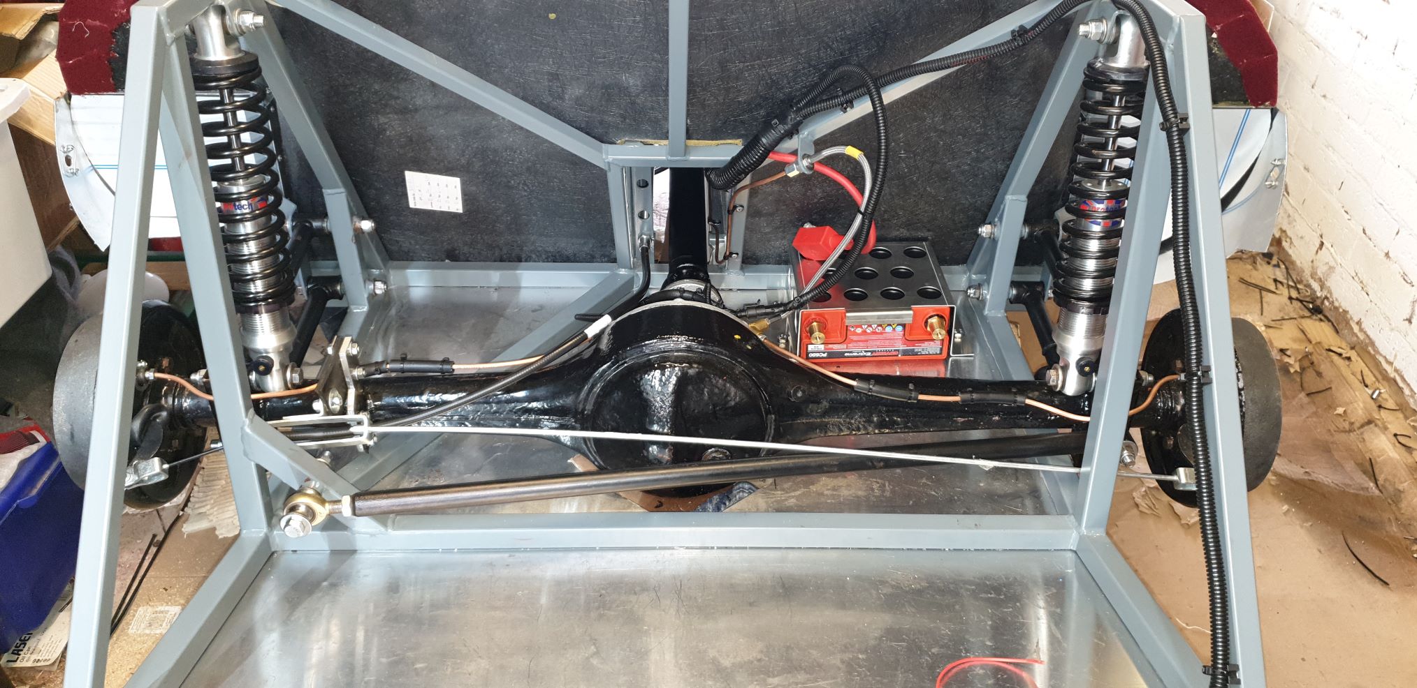

Just the battery earth to connect and the rear is complete.
[attachment=0]rearview.jpg[/attachment]

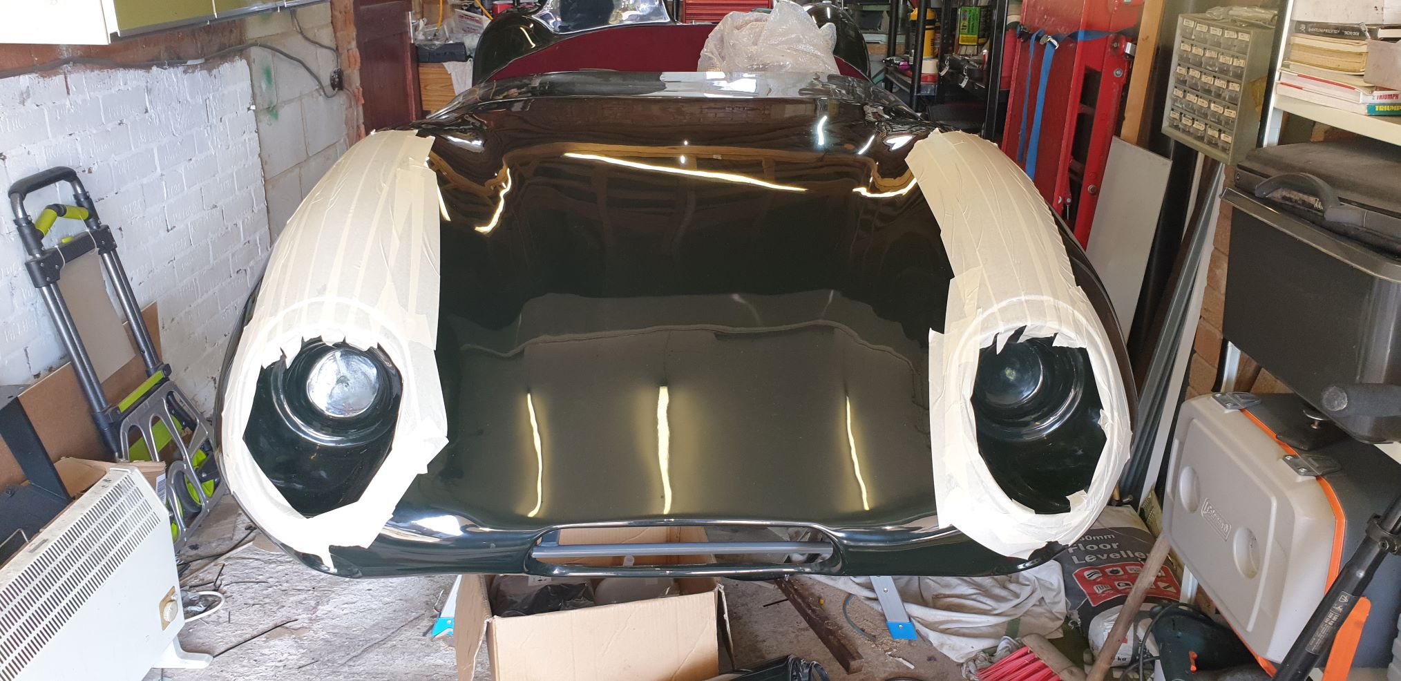

Put the bonnet back on and getting ready to fit the light-pods for the IVA.
[attachment=0]fitting lightpods.jpg[/attachment]
