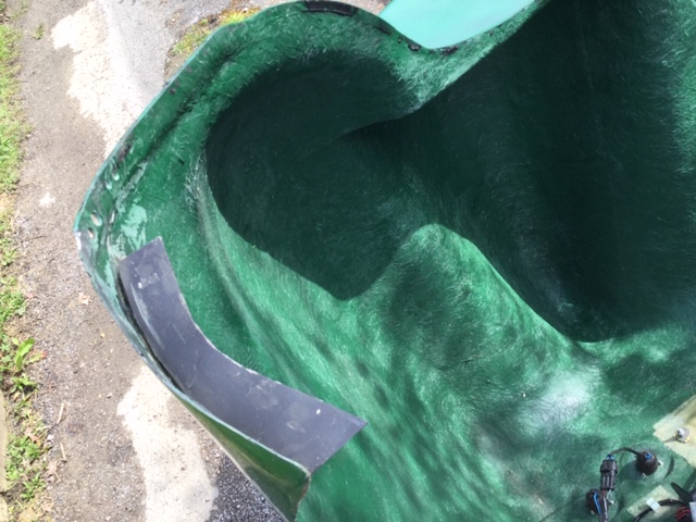

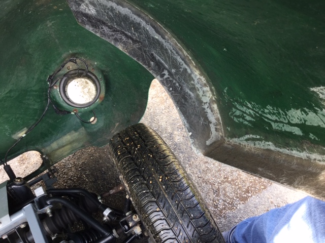

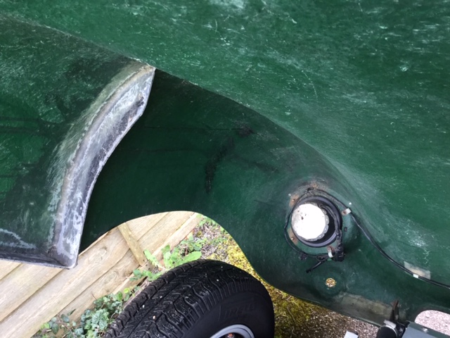

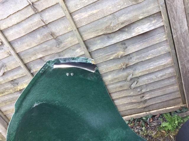

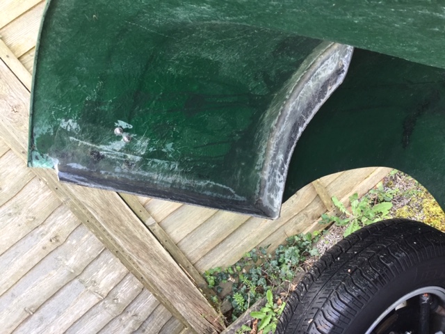

When I bought my car from Tony Lincoln (sadly now no longer with us), the bonnet and rear clam needed some work to fit correctly. Gary Gunn glassed in heavy duty formers, and this fixed the problem perfectly. Post+IVA, you can fit Terry springs and a Cam Lok fastener to each. Never had a problem at any speed the car is capable of...
I can post a pic if anyone would like to see one.
Cheers!
PS Car taxed. I am on a few days off. It’s raining heavily. Bah!

Photos, yes please.

Posts: 1020
Here you go!
Posts: 1020
Last couple

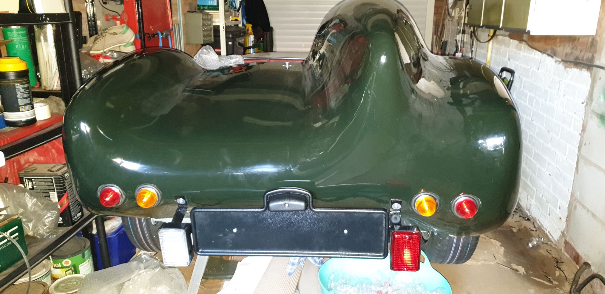

I feel its a bit of a milestone.... the rear light cluster and numberplate mount are finished tested and ready for IVA.
[attachment=0]rear iva.jpg[/attachment]
