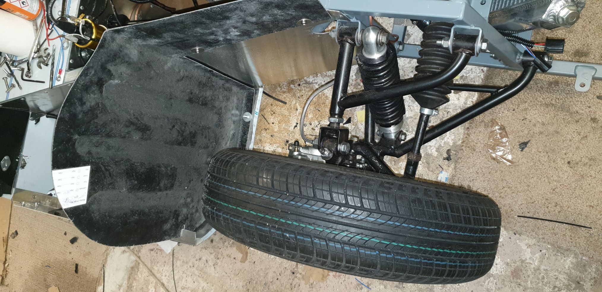

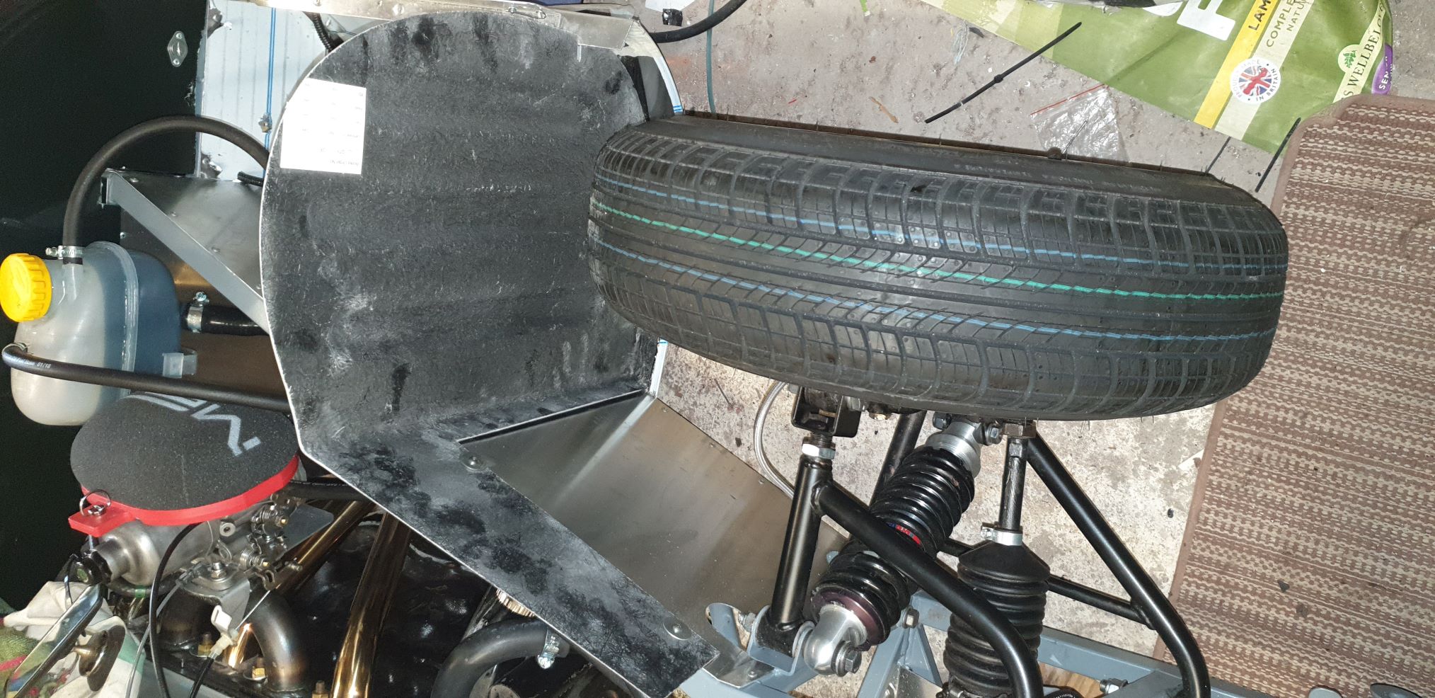

A little more progress today....
The car is now on its wheels and it seems so low after the chassis stands, should be easy to get in and out without opening the doors.
I've fitted the front mud guards.
[attachment=1]front mud guard1.jpg[/attachment]
[attachment=0]front mud guard2.jpg[/attachment]
And I've received acknowledgement from the DVLA they are processing my IVA application.

Congratulations getting the car on it's own wheels, it took me a week of playing around to get the engine started, after driving the car I now realise it was most probably down to not having connected/used the choke.
Posts: 147
Post by Morris »
It's looking very good - an exciting milestone.
I'm fitting the front hubs now to mine, so if I attached the front wheels I'd have a wheelbarrow!
