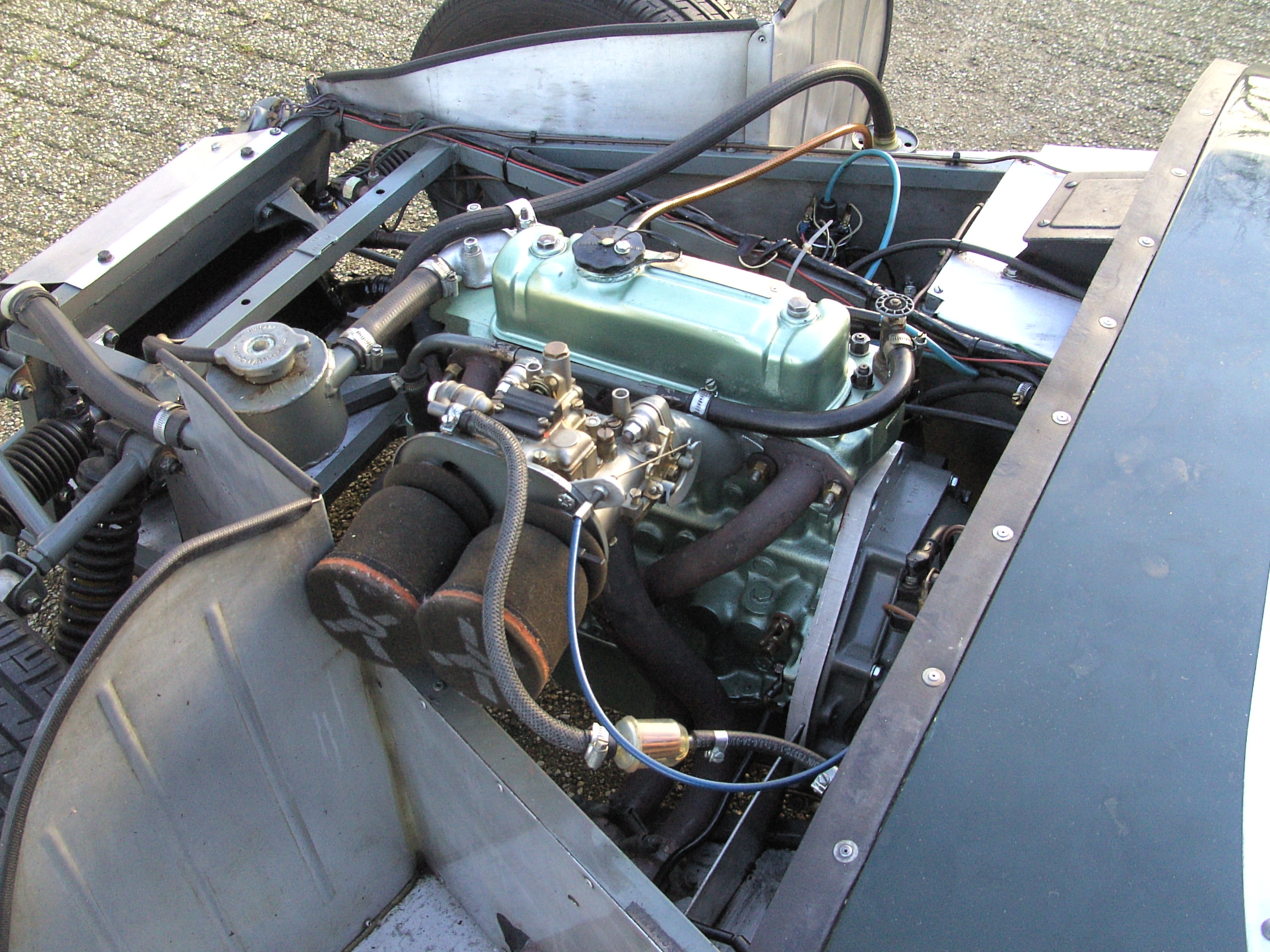

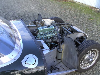

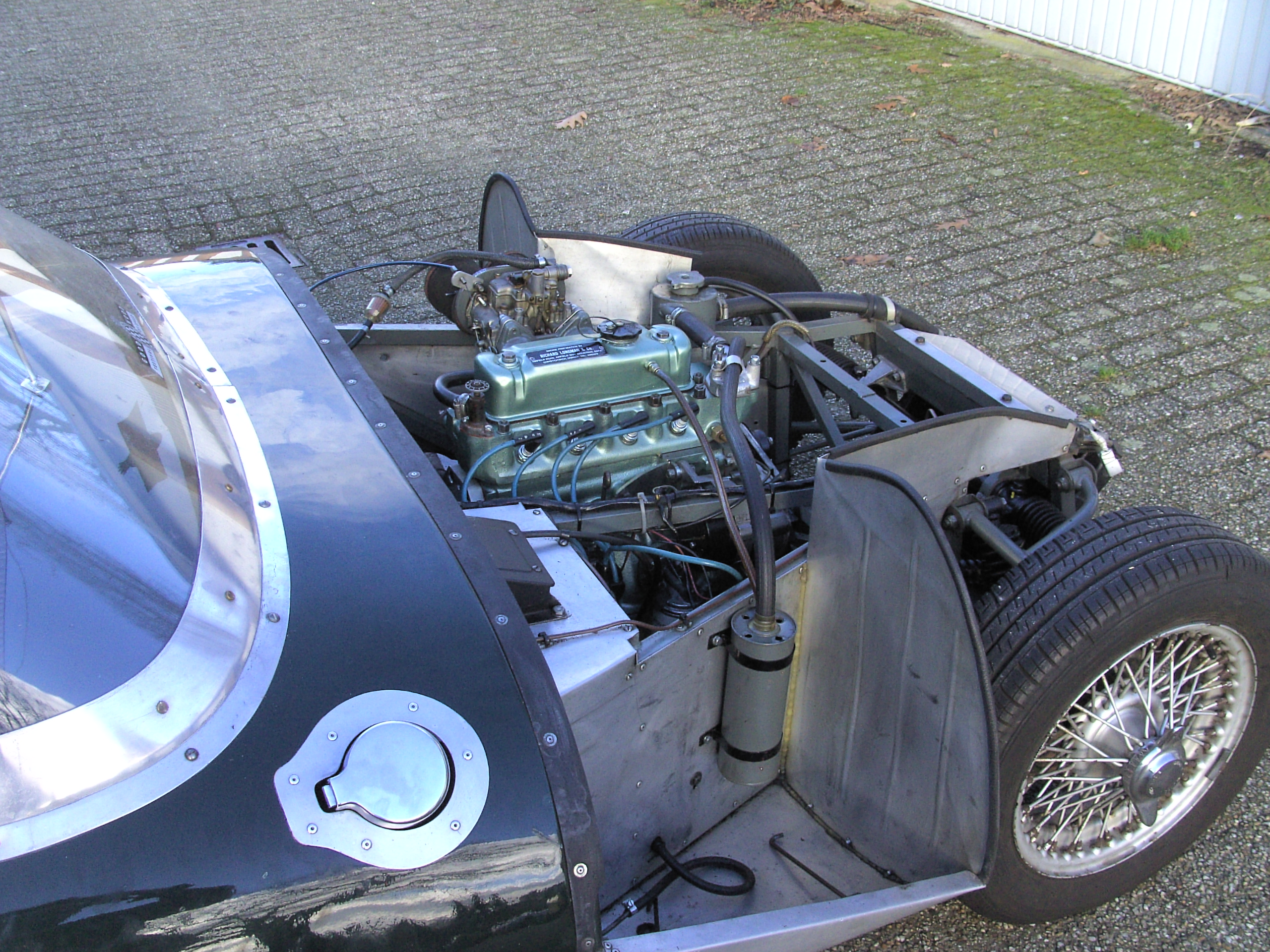

Time for an update on my progress.
Pictures say more than words.........
Charles, can you spot your sump?

" ER LÄUFT!!! " (it runs)
Started up the engine today. Had difficult time getting it started. ( Ig.-timing was way off )
Once it ran, it roard! Two ten minute runs at 1500-2000 rpm, to set the new cam.

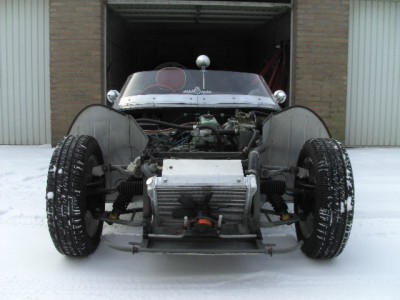

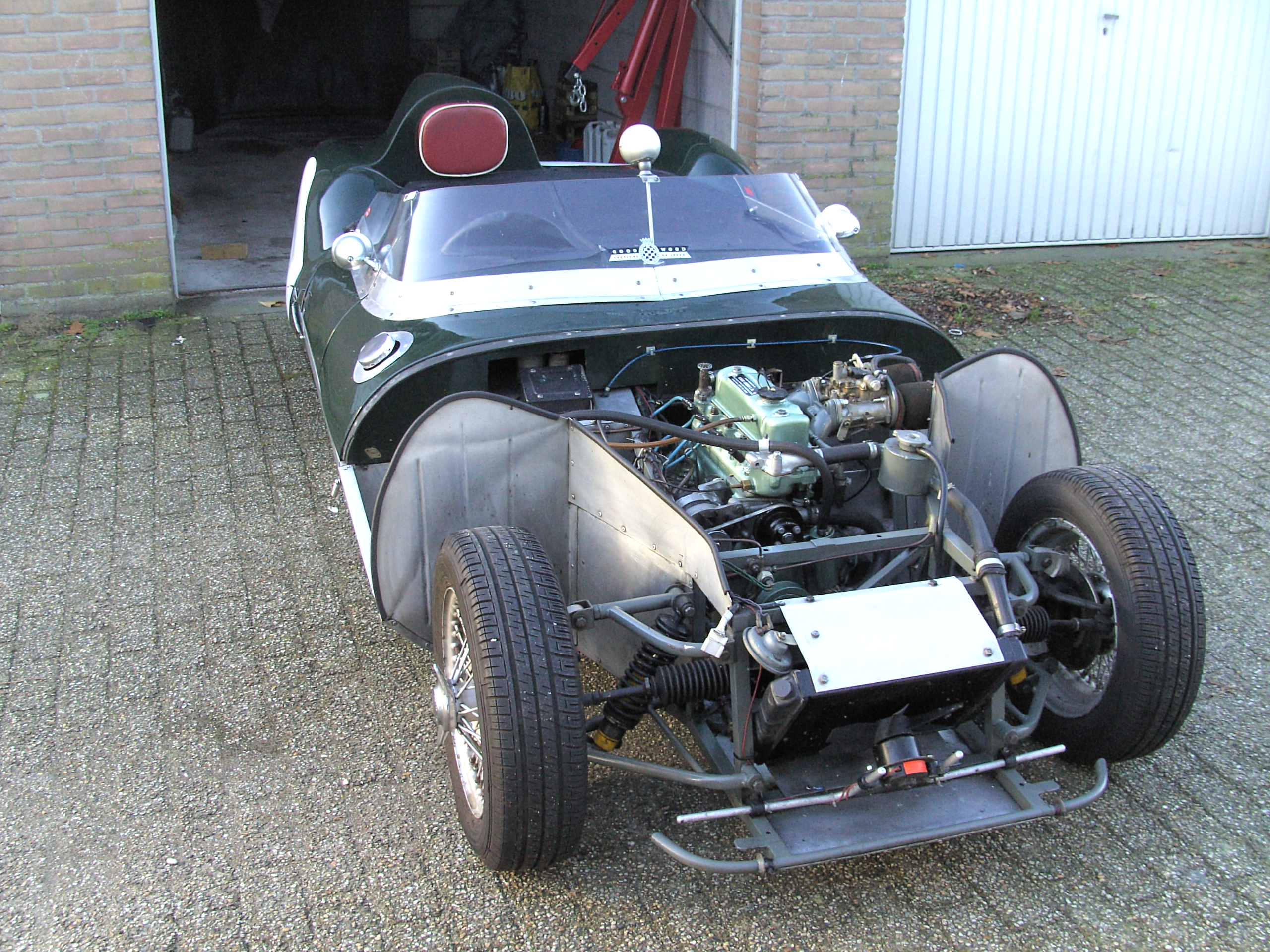

one question, is there scope in your front suspension setup to dial out the positive camber or is it intentional?
Pluscat
Posts: 72
Joined: Mon Jun 13, 2011 9:36 am
Location: Netherlands Oss
Re: Richard Longman A-series, problem
Post by Pluscat »
It is possible to change the camber on my car. The "positive camber" on the picture is due to the picture (wide-angle lens)
