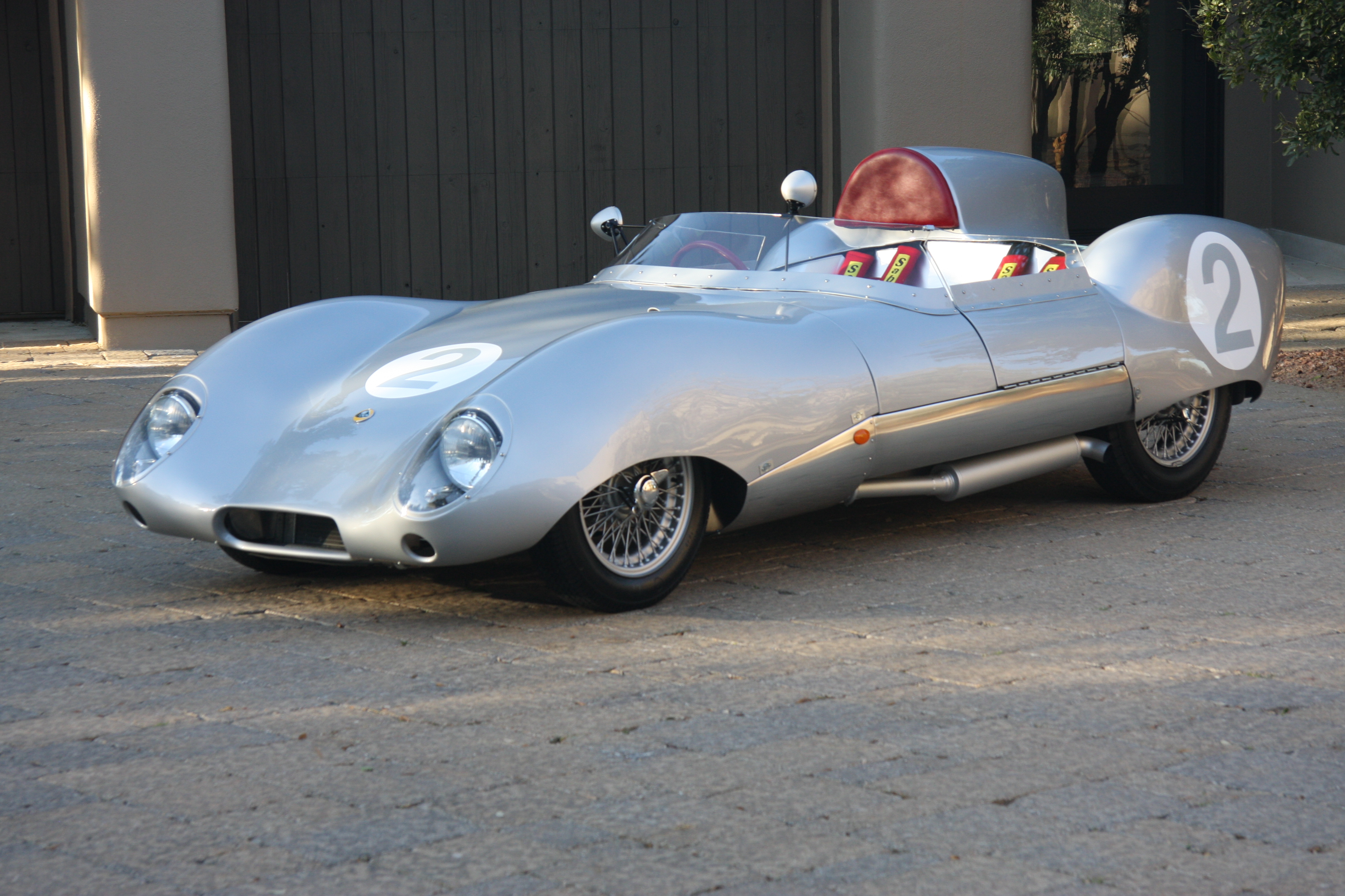

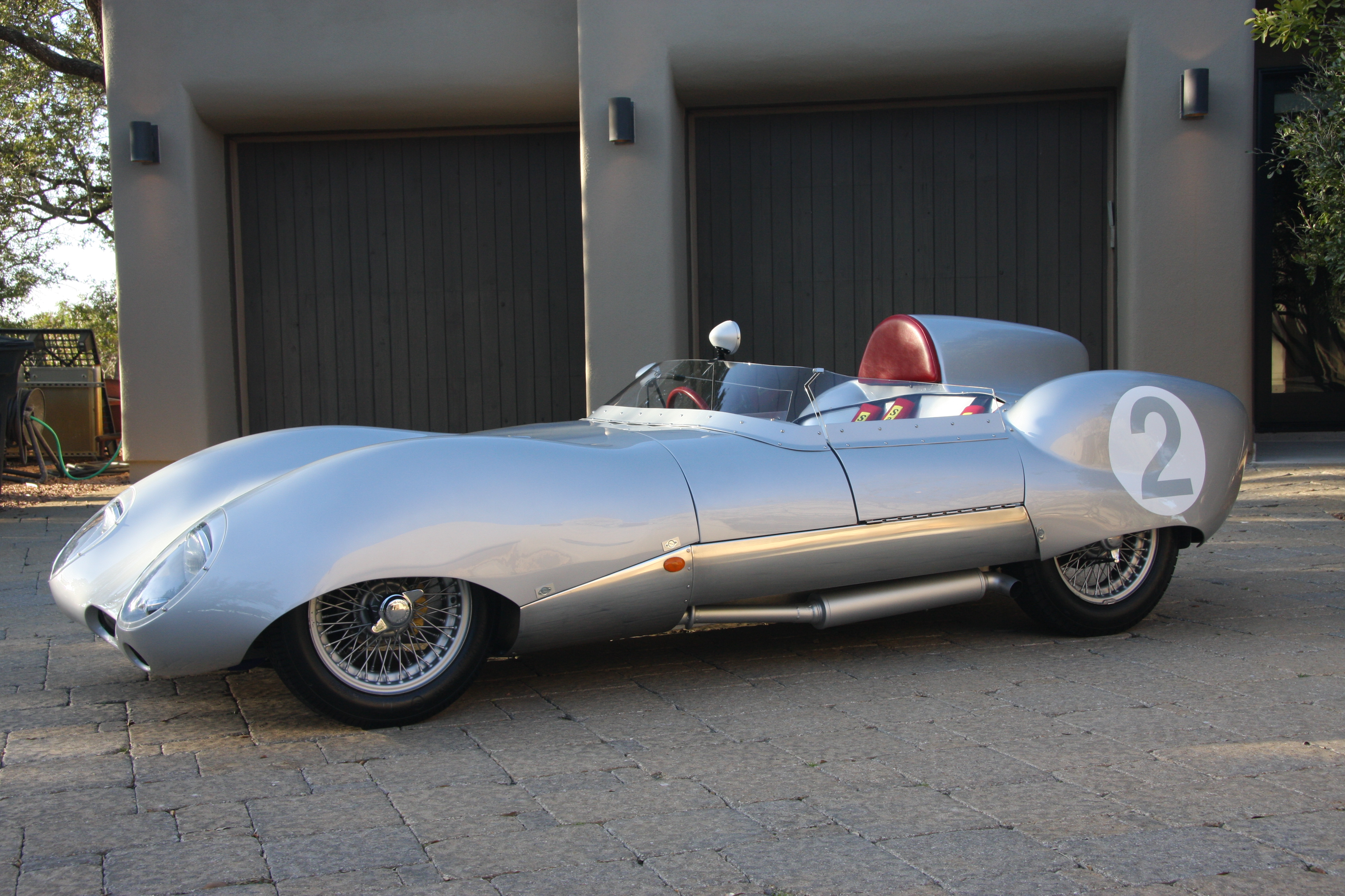

Well...she's finally finished and now can be called magnificent for those who are inclined to do so. Still awaiting the single cockpit bodywork, windscreen and hardware from the factory to complete that conversion. Attached are some shots I took today.

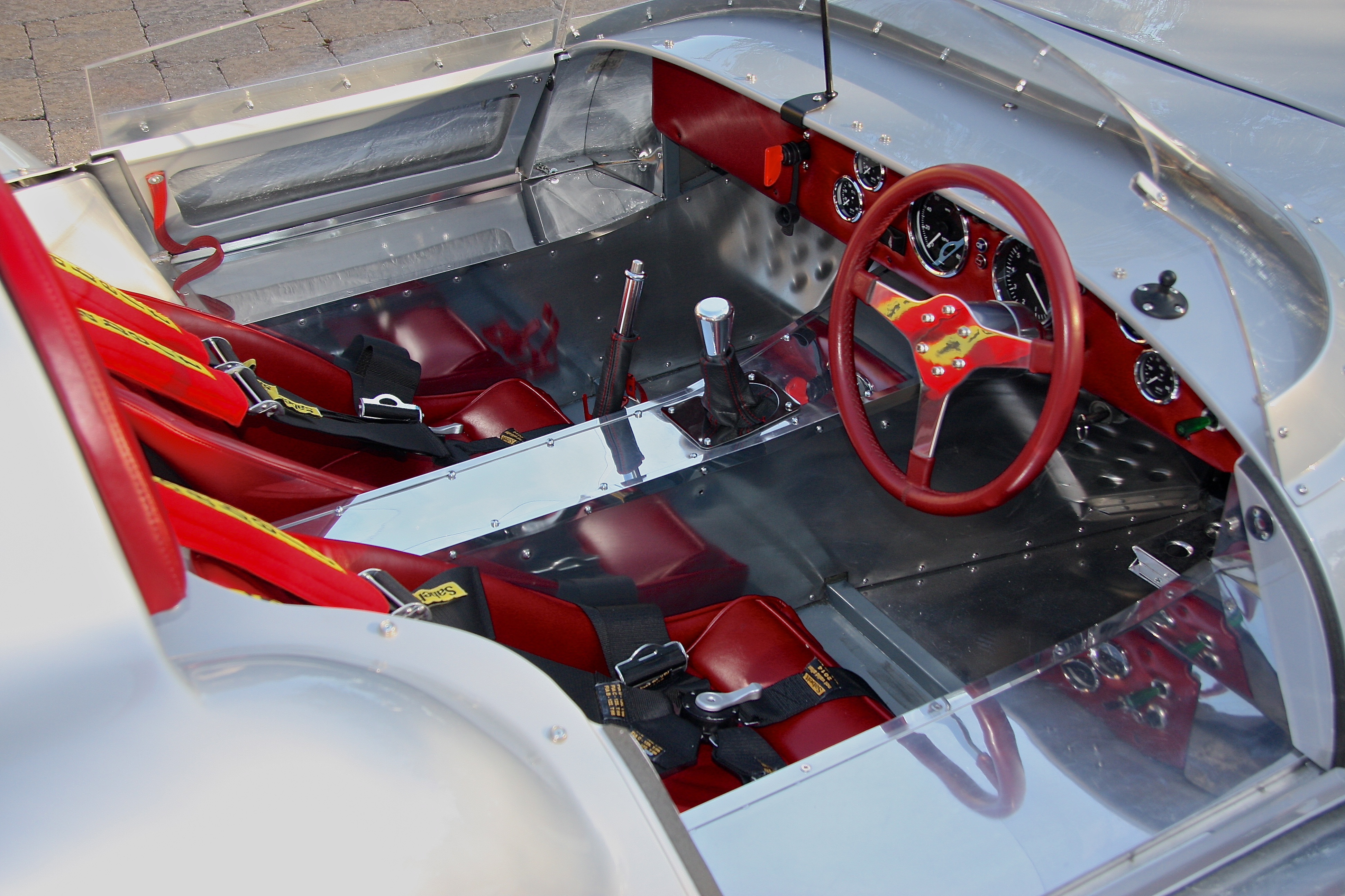

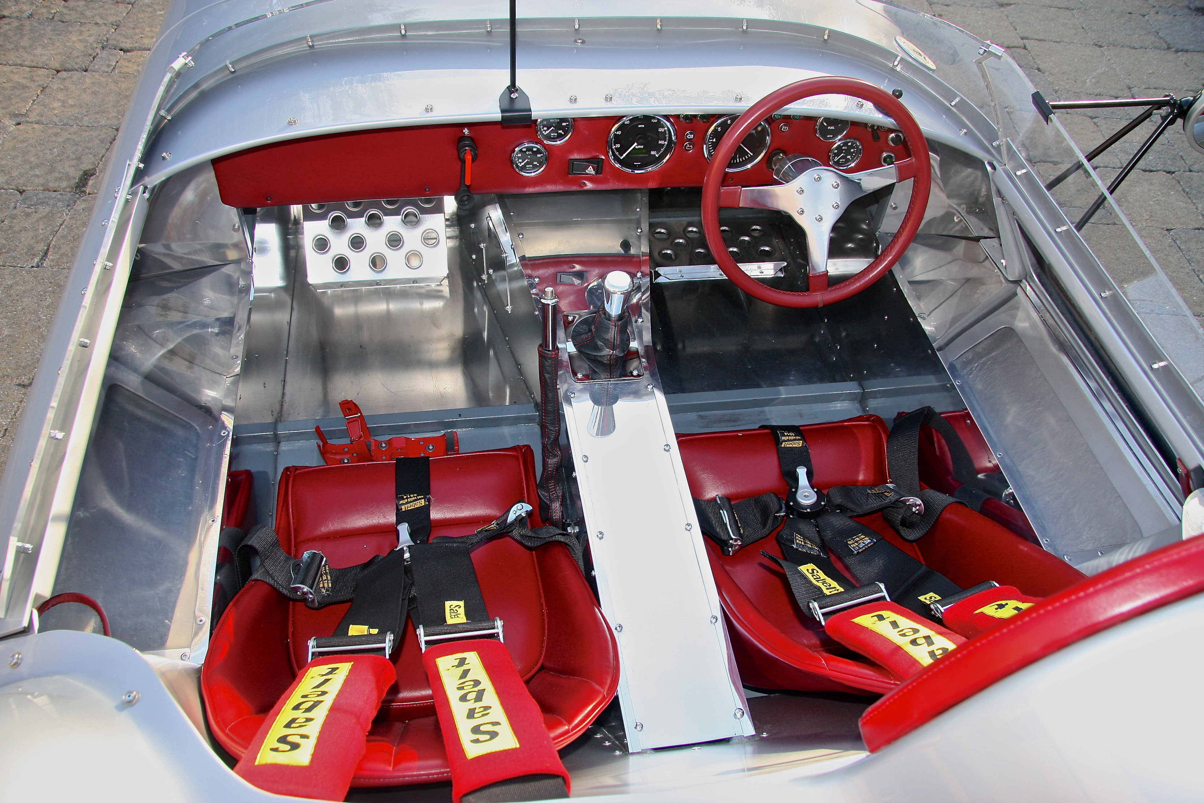

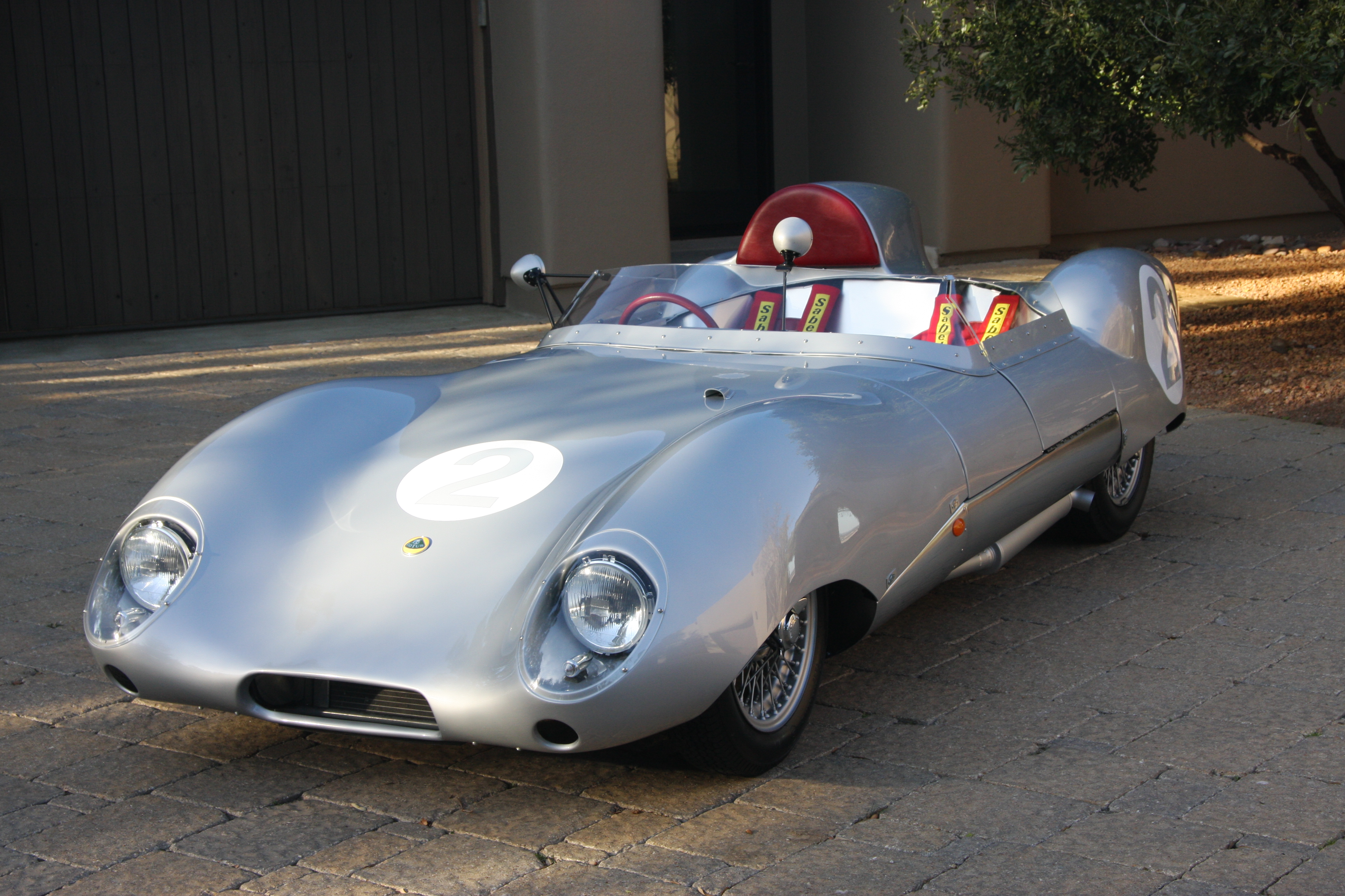

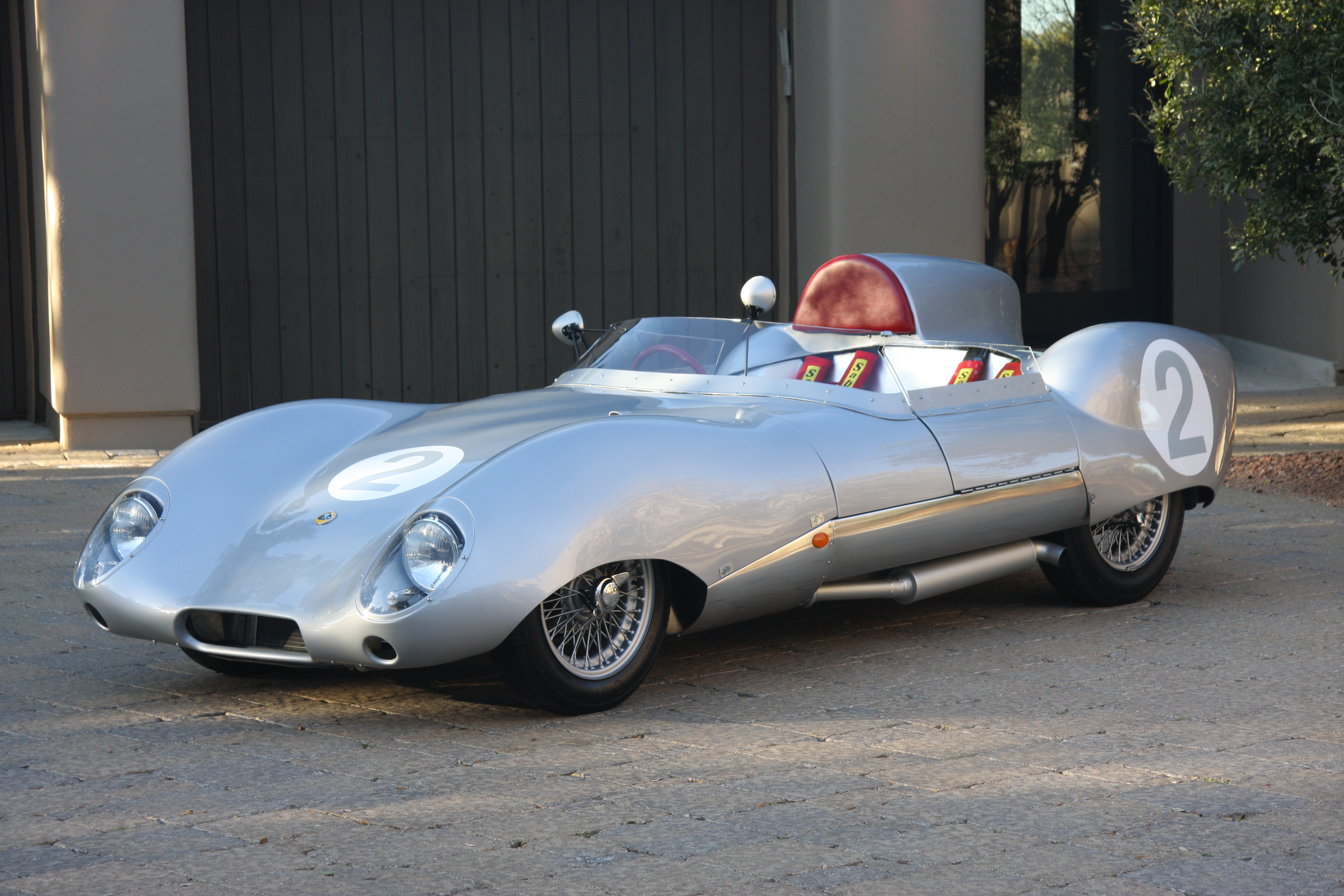

A few more shots...

That is a fantastic looking car! I wonder how the engine is looking. Did you get the fuel injection to work?
What is this black pod on the dash top behind the steering wheel?

We have made further gains on the fuel injection issues, but it is still not totally resolved to our satisfaction The car is going into a performance tuning center this week to iron out the final quirks. The small black pod on the dash is a camera mount that was installed by the prior owner. I forgot to tell the paint shop to close the holes and paint over it. I may use it again at some point, so no real harm done.
