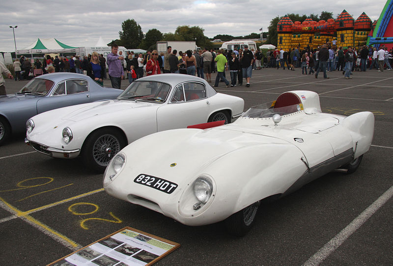

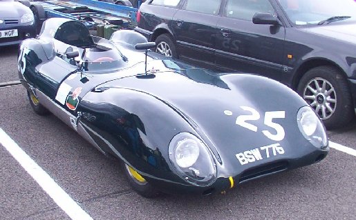

So remove perspex on nearside door, and then drop in a tonneau?
Here's a couple of examples:
