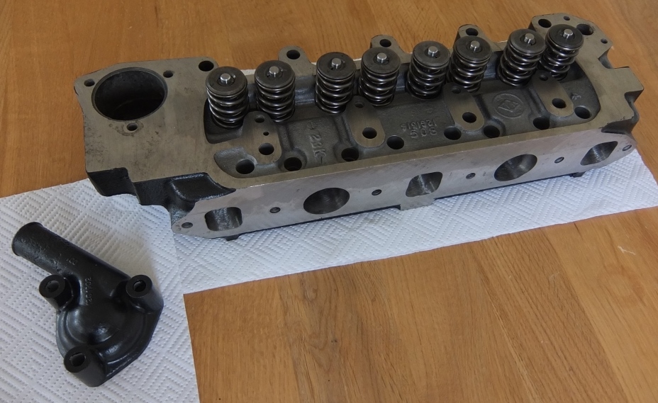

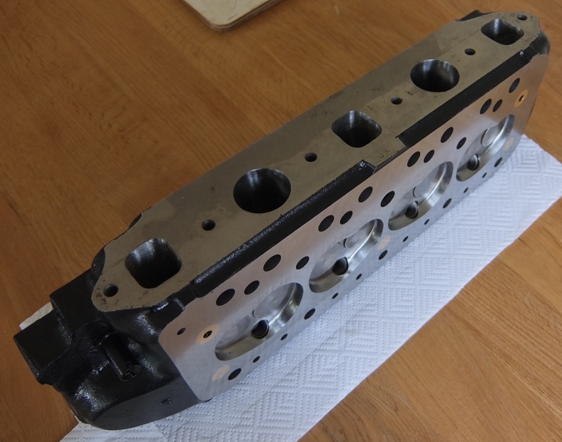

I've got around to painting my head. No, not that one... :D
This one:
Posts: 1023
Re: Bottom End Wear - Engine Out Job
I used Granville Engine Black (satin). Goes on really nicely in a single coat. Brush finish is pretty good and it cures on the car with running.

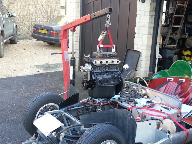

I can't actually believe that I had the head back and painted in July, but only put the engine back in yesterday! :o Not very impressive work at all!
On the upside, the install went well (Thanks to my mate Chris' help), I've learned loads during the process (and more to come, no doubt) and might actually get to drive my car again after such a long lay-off. Just thought I'd update - gives a bit of motivation! :D
