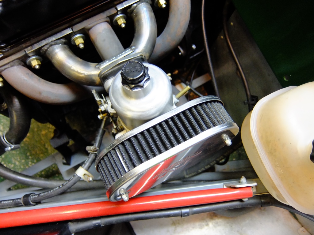

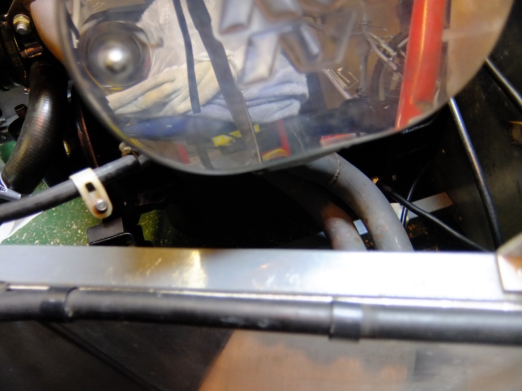

Hi Folks!
Here is a long overdue update...
I've dry fitted the inlet and exhaust manifolds. Many thanks to Ben for the maniflow exhaust manifold - much better than the WSC item!

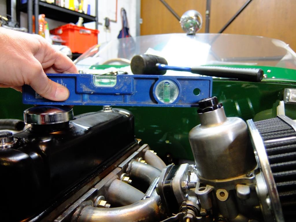

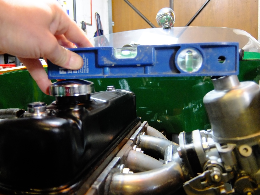

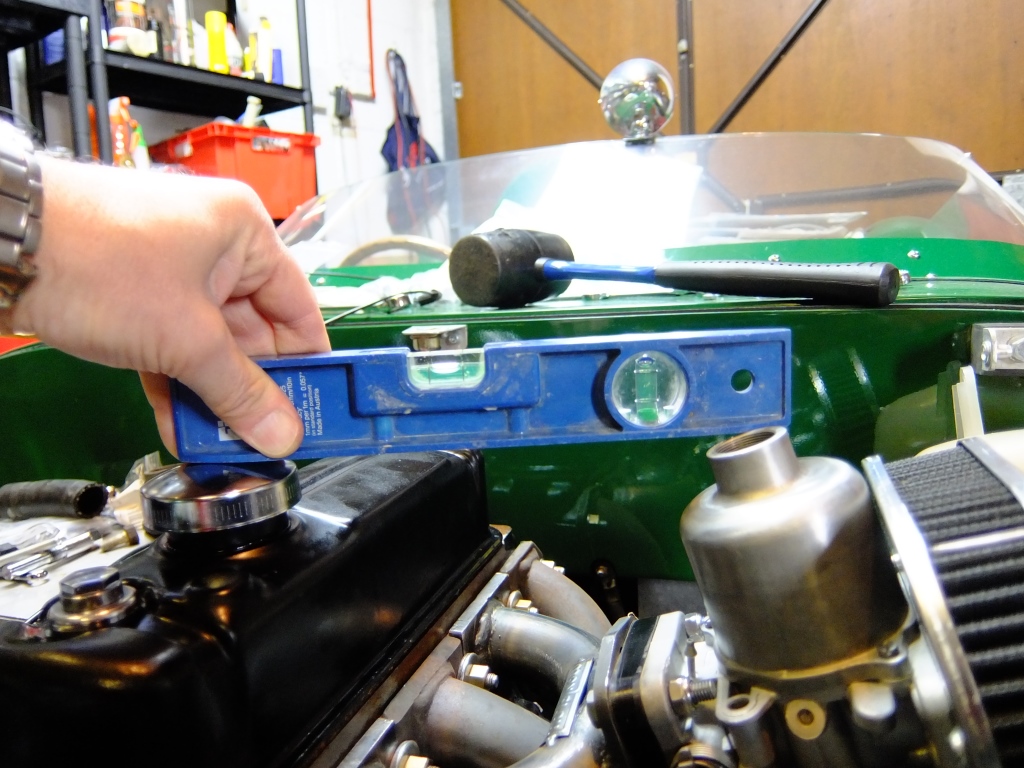

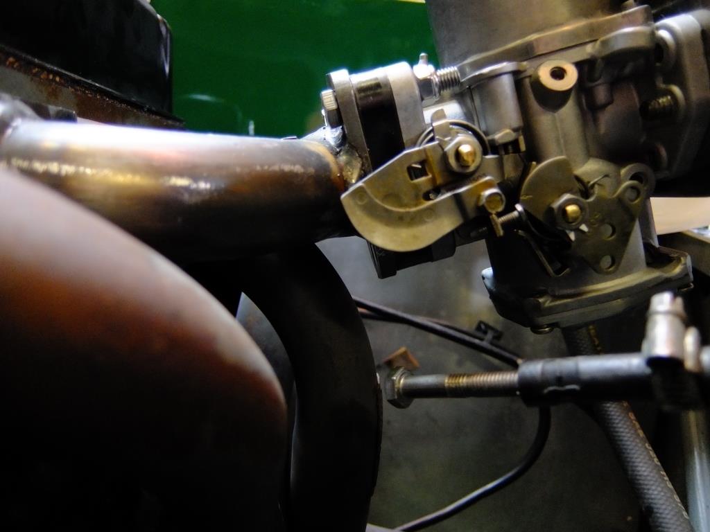

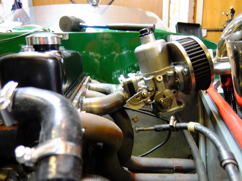

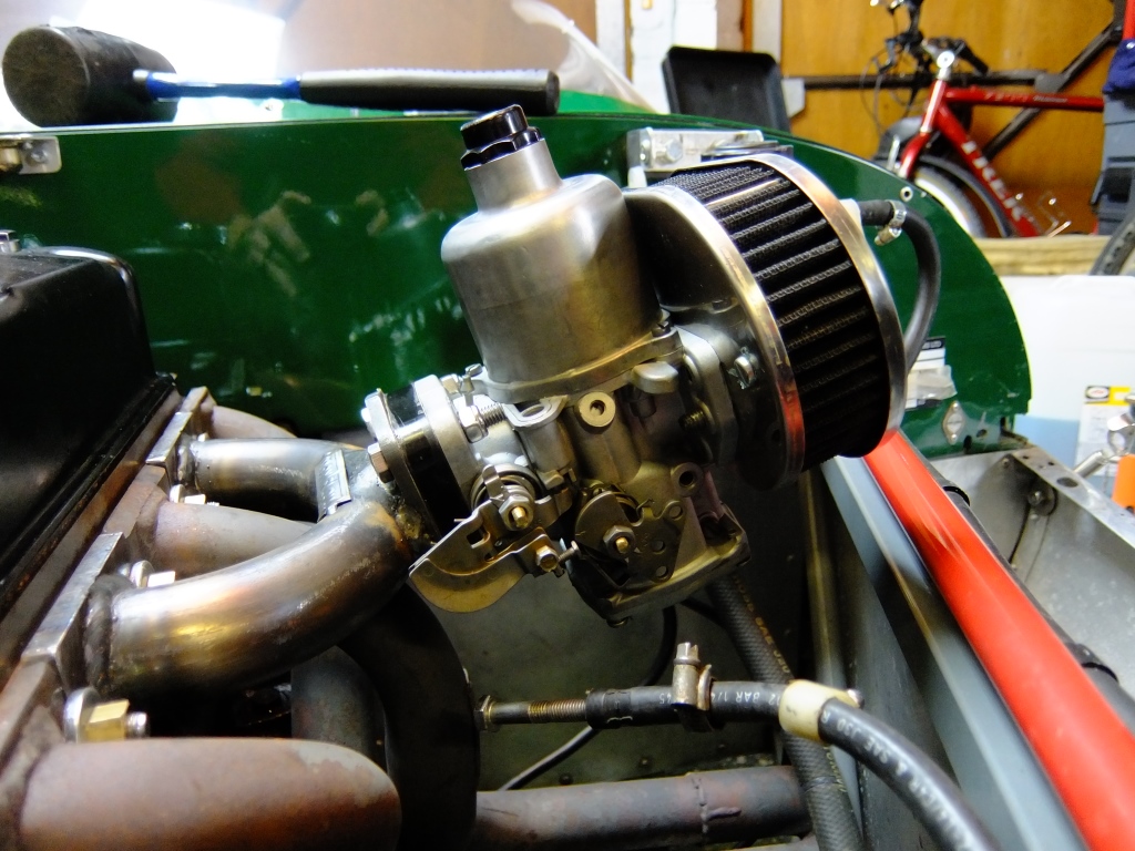

OK - pics tell a story better than words. The standard Maniflow midget inlet has some angle on it. I'll need to get my angle gauge on it, but it looks to be 30 deg or more.
There is around 2cm of damper above the level of the oil filler. As I mentioned earlier, the oil filler clears the bonnet on my car.
As I see it, I have two options:

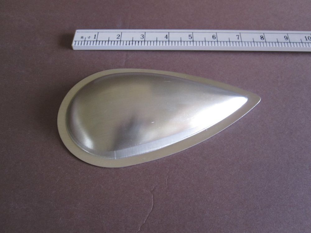

1. Leave the manifold as it is and fit a small, ally, blister that I have found on eBay. It looks high quality, and is affordable.
2. Have Maniflow make a Westfield XI spec inlet. It'll be better to swap the stock Midget manifold I purchased from them, rather than try to adjust the stock item.

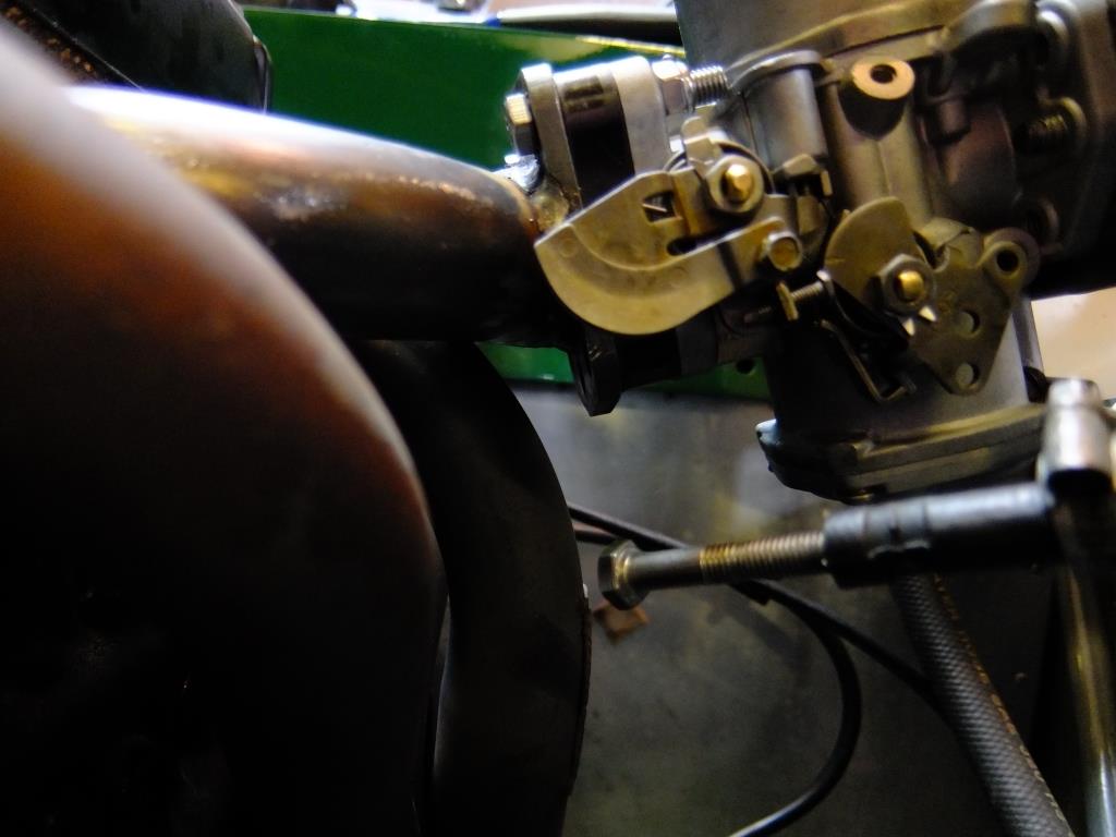

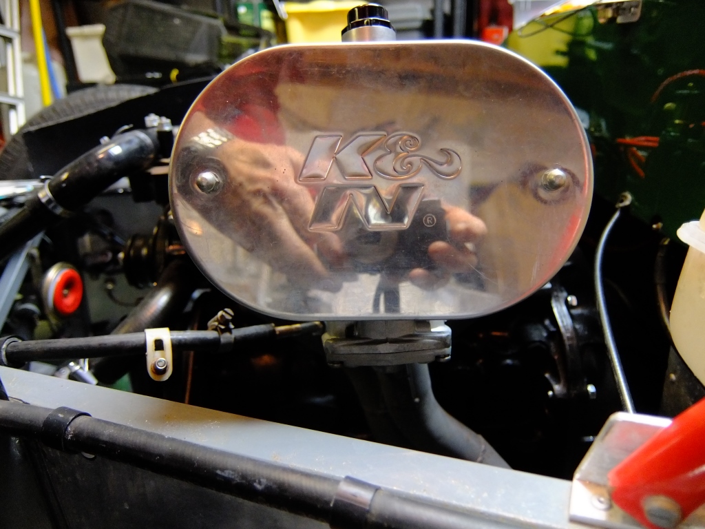

Issues identified are that while there is room for the K&N inside the chassis rails, once the carb is swung more horizontal, there is less clearance from the exhaust manifold. Not sure if there is even enough room there to add exhaust wrap at the moment!!
Thoughts and comments welcomed. I'll have my starter valve O-rings in a couple of days, so, bar this adjustment to the inlet/bonnet, and painting the manifolds, I'm not a million miles away from first start! Finally!
Here are the pics:
Here are the pics:

And here is a pic of the blister I was considering:
