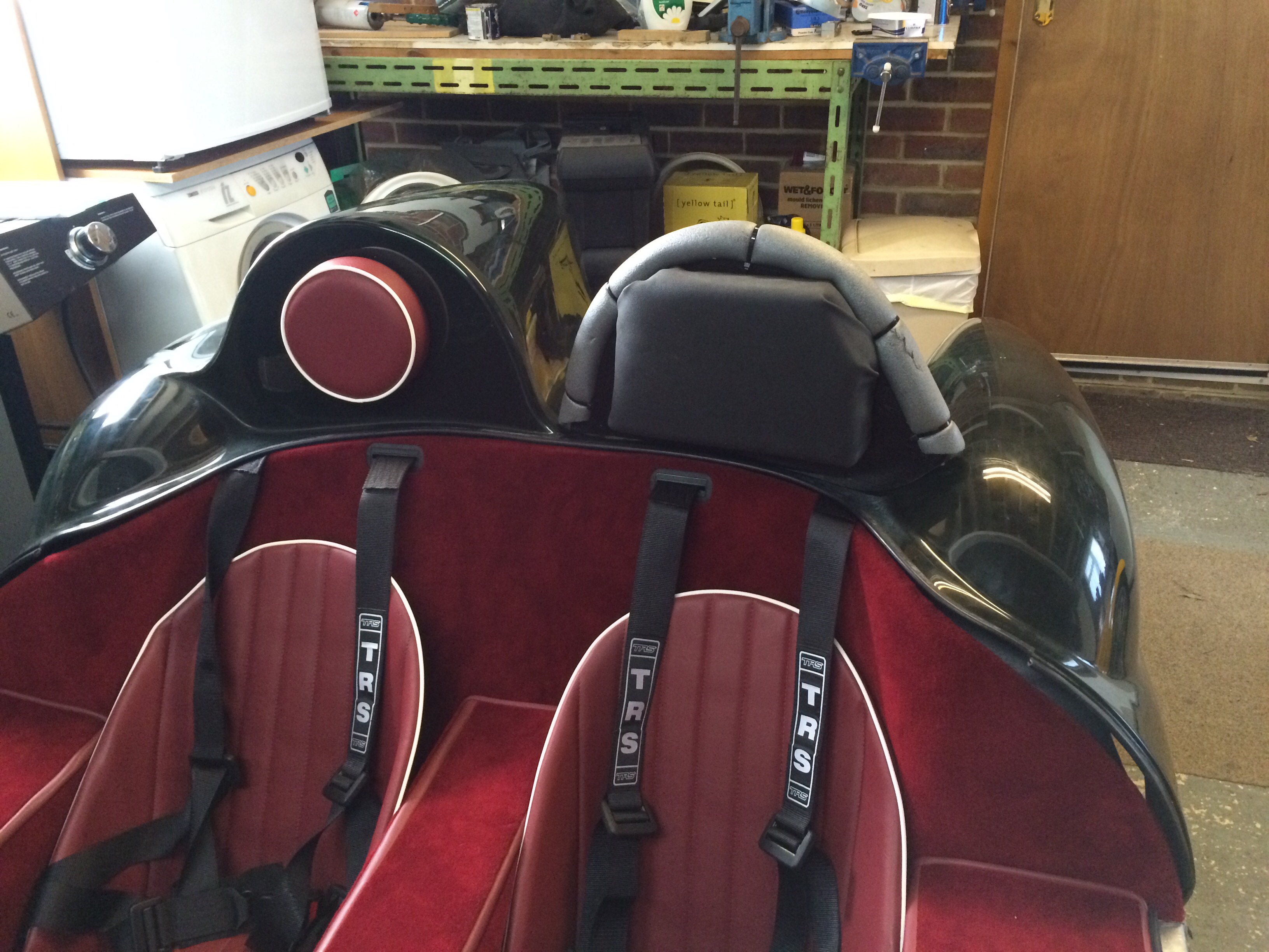

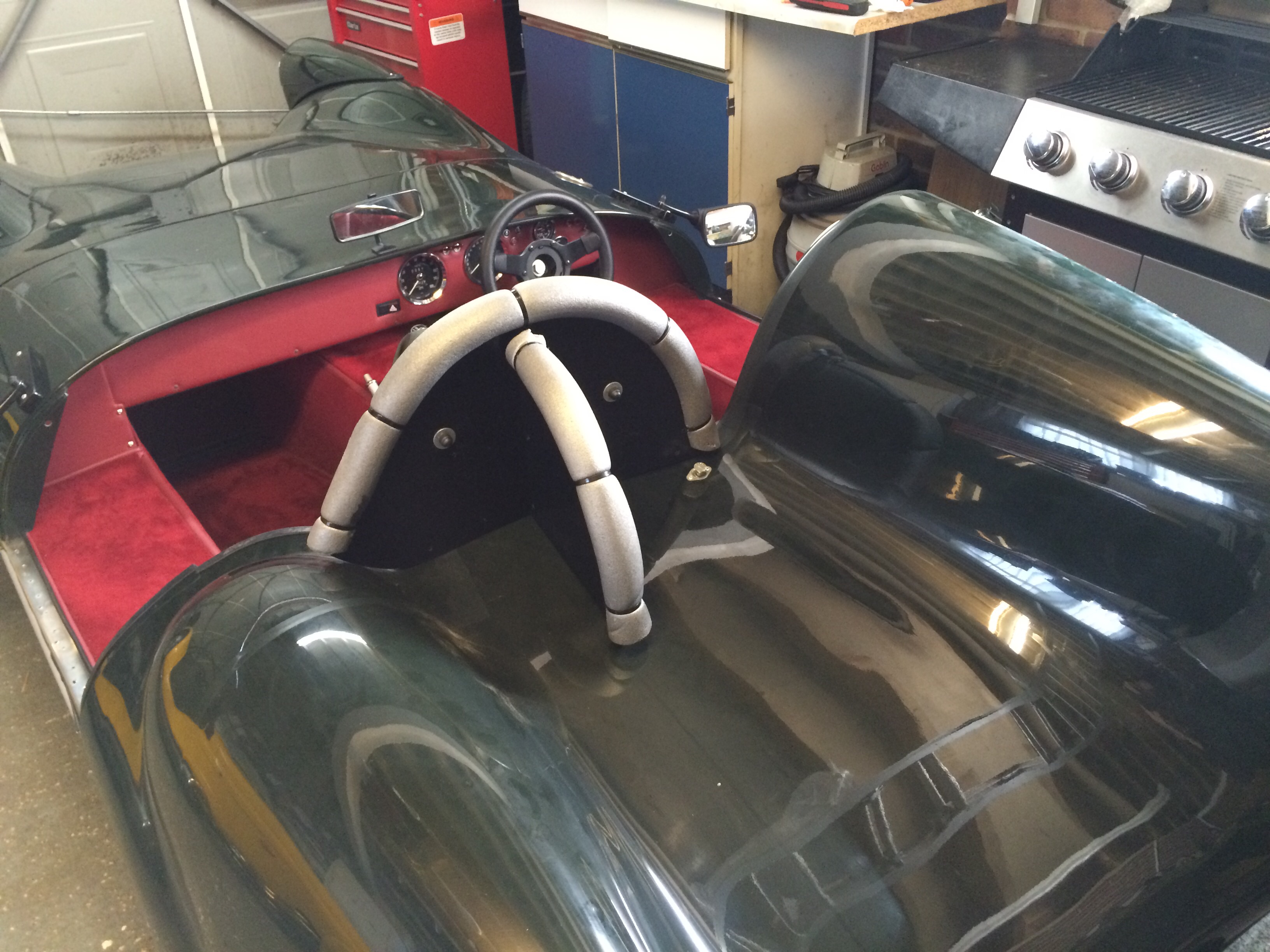

Pictures as promised:

Is it standard to mount the battery behind the driver, on the same side of the car that also has the fuel tank? That's a lot of weight all on one side of the car.
It puts a lot of weight on the right rear, which would be hard to balance when doing corner weighting, or trying to take the "wedge" (diagonal weight distribution) out of the chassis. Maybe it might help with traction in RH corners? Isn't that what the front anti sway bar is for? I have not had a car with an open diff for several years.

So now they make you put headrests for the passenger seat? How do you open the rear clam shell? I am thinking a single roll bar across the rear with a head rest for the passenger side might be easier, with a removable forward brace for racing. This would ensure roll over protection for both occupants, and would work on headrest and non headrest rear bodywork, and allow for an easy opening rear clamshell with only a couple of notches for the tubing.

Thanks for the photos and offer of the head rest, if all is ok when you ITV I would like to take you up on the offer.

I thought I saw something about the IVA that suggested that if you don't fit the passenger seat you don't have to sort out the head restraint/seatbelts etc for the passenger side and that the IVA doesn't prevent the passenger seat etc being fitted after the test (ie you don't get a single seater limited test result). I was hoping that this was the case as that was/is my plan!

Jan I think most passenger side headrests have a disturbing tendency to fall off once the car is in normal use!!!

I too thought of just using a drivers seat for IVA but I was concerned that if it was classified as a single seater the wife might be a put out!

I too had the no passenger seat thought but general consensus is that this may give it a single seat classification so I'm not going to take the chance and am going with the headrest.
