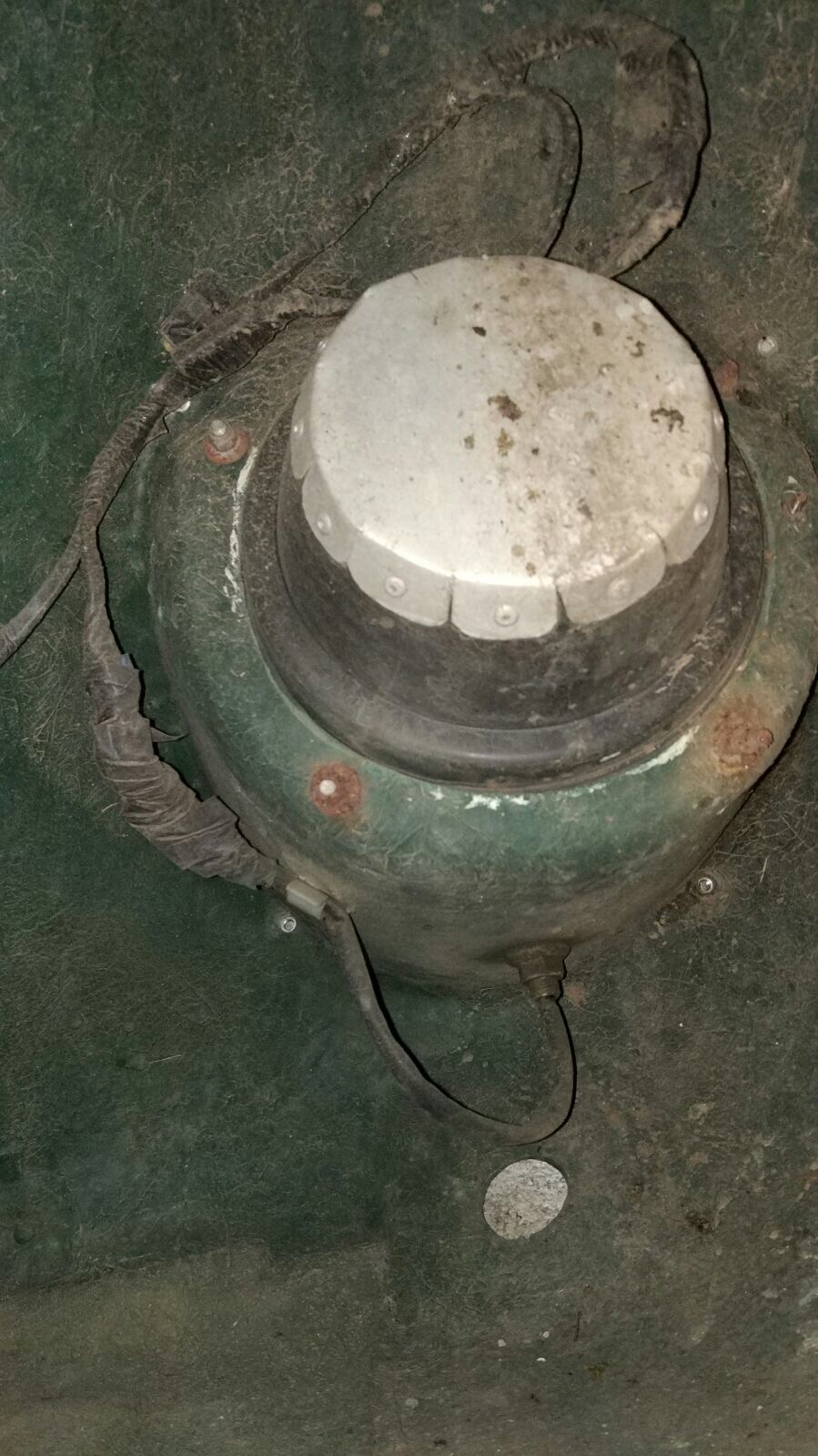

Thanks David! Just the info and photos I needed. I hadn't seen that black plastic bowl on the back of the headlamp before, so I looked at the photos on Jan's site and it's clearly visible on the Denver car, and just visible on Jan's customer build.
Instead, my car has an integral fibreglass moulding on the back of the main bowl. It's angled and the rubber dustcap on the back of the headlight pokes through. As such, I think that, short of moving the whole headlight forward a few mil (possible), the clearance in the wheel well is as great as it possibly can be already. Good news for me, but I'll know more when I can arrange a trial fitting.

The headlight bowls on the late chassis cars is a Wipac part that comes with the kit, along with the headlights. With the 4.50 tires, there is no clearance problem. With the XZX tires, there is. You cacn cut away the bowl if necessary to make more clearance. Just keep the wires out of the way.
You could also make a ring to move the bucket forward, and cut the aft secton of the bucket for more clearance.
The earlier cars have a bowl behind the headlight which is cut away for the wiring to pass through. The actual headlight mounting is a metal mount, likely from the donor car. With this setup, you can space the headlight buckets forward a little, making a little more tire clearance. Trim the bowl behind the headlights as much as necessary.

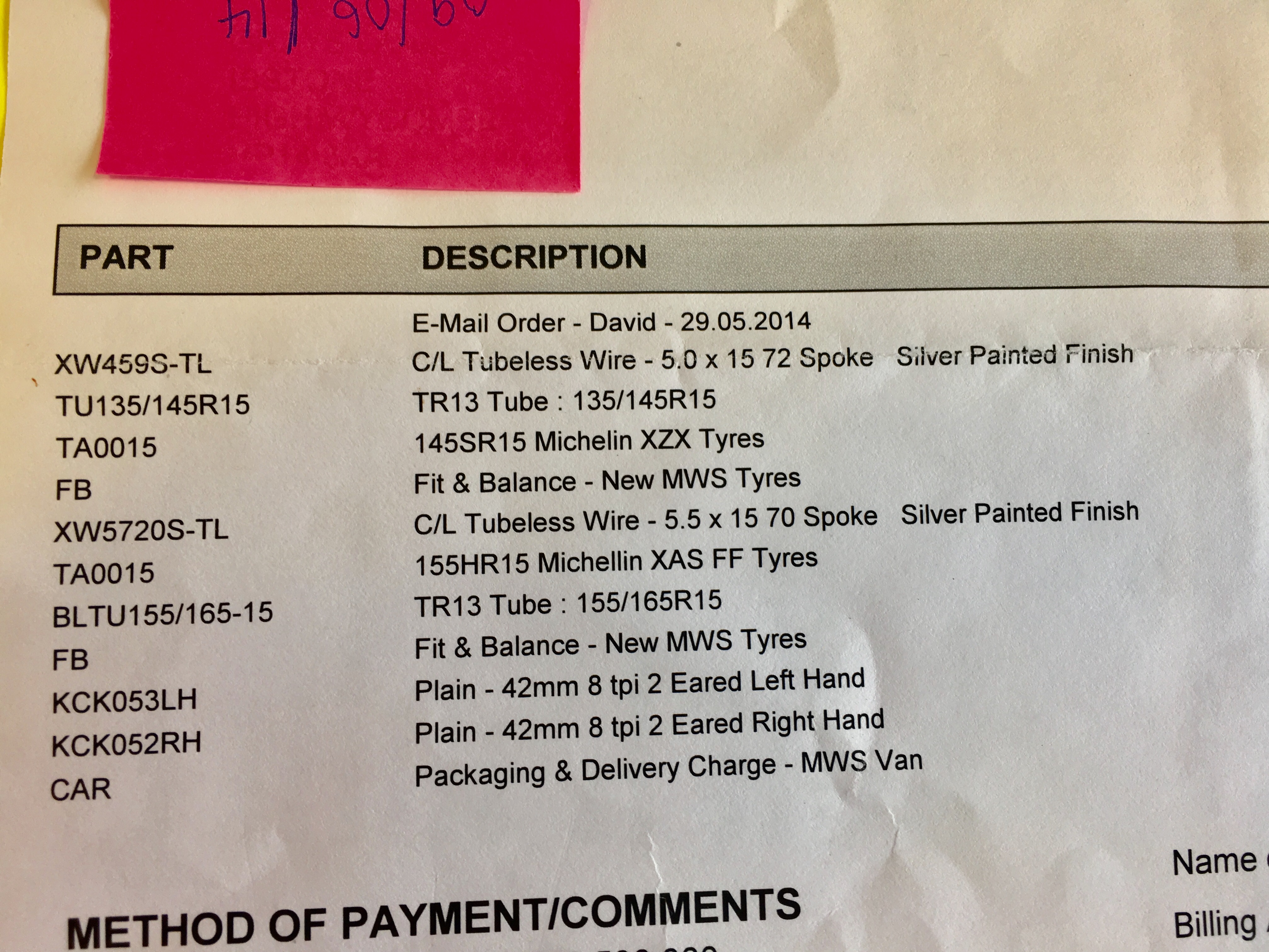

Gents here is a photo of my MWS invoice for details of the wheels and tyres I ordered

Just to confirm, it was IVA'd on the 15s? And you had Westfield put it through the IVA?

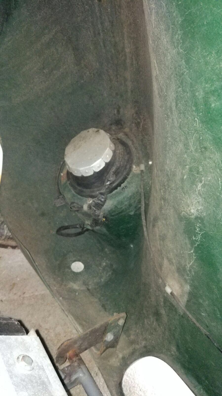

Jon sent me these (thanks, Jon!) and asked me to post them. Again, the Wipac plastic shrouds, but cut down and reclosed with ally sheet.

Hi Jason and thanks for your comments.
Yes it went through the IVA on 15s. Westfield did the IVA and associated paperwork for me for about £2k from memory. Felt expensive at the time but it took them a couple of attempts so probably worth it in the end.
They had to remove the spinners for the IVA and replace them with a set of the hexagonal type.

Thanks David. It's tempting to just hand the IVA problem to Westfield but I suspect I'm a few months away from that being a decision I need to make..!
Great to know it can be made legal on 15's too - presumably you had to have the speed recalibrated to suit what I assume is a larger rolling radius?
