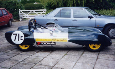

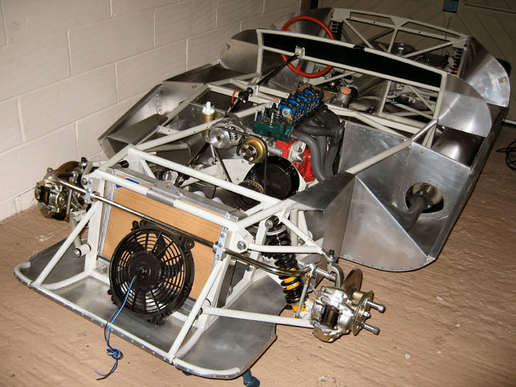

Biggles, more about my eleven. its based on a series two Lotus eleven chassis but has Lotus eleven series one body much sleeker, although you cant get 8inch rear wheels on my car like Adam! I will try to add two pictures, one body off, Not my car but a similar one. second the car I used to race.
if these work I may add more or you could email and I could sed direct.
All the very best Malc

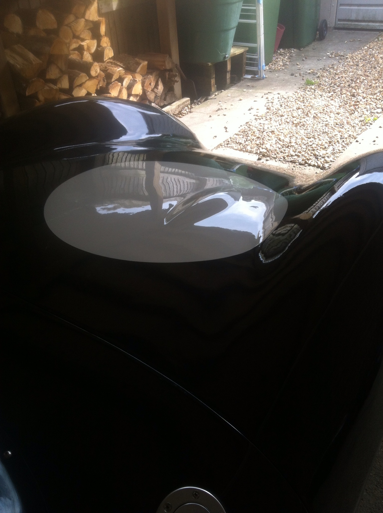

Post by Markwoodbridge »
All done..
151 bhp
Posts: 348
Re: K Series replacement
now that's what I call a teaser, not even letting us see what's under there!
Posts: 1045
Very subtle blister.
More pics! More pics! etc...

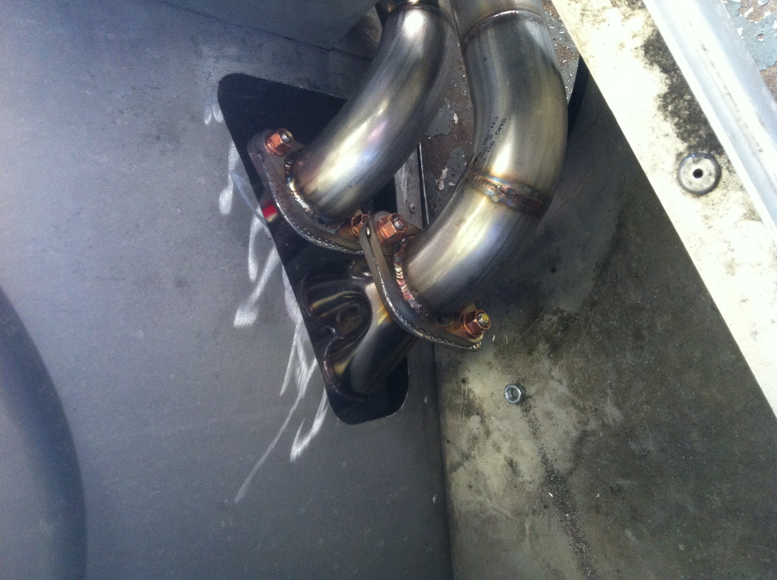

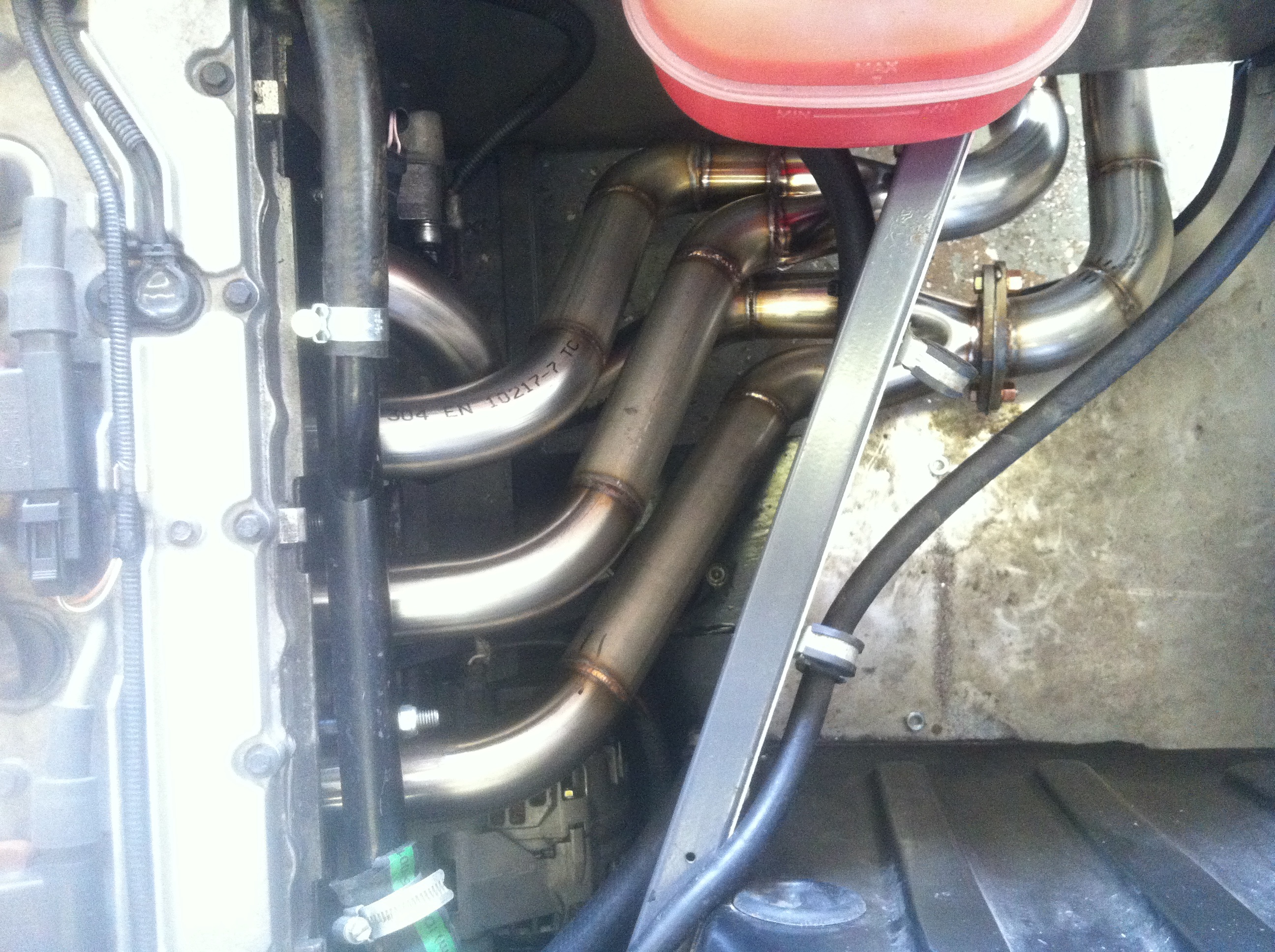

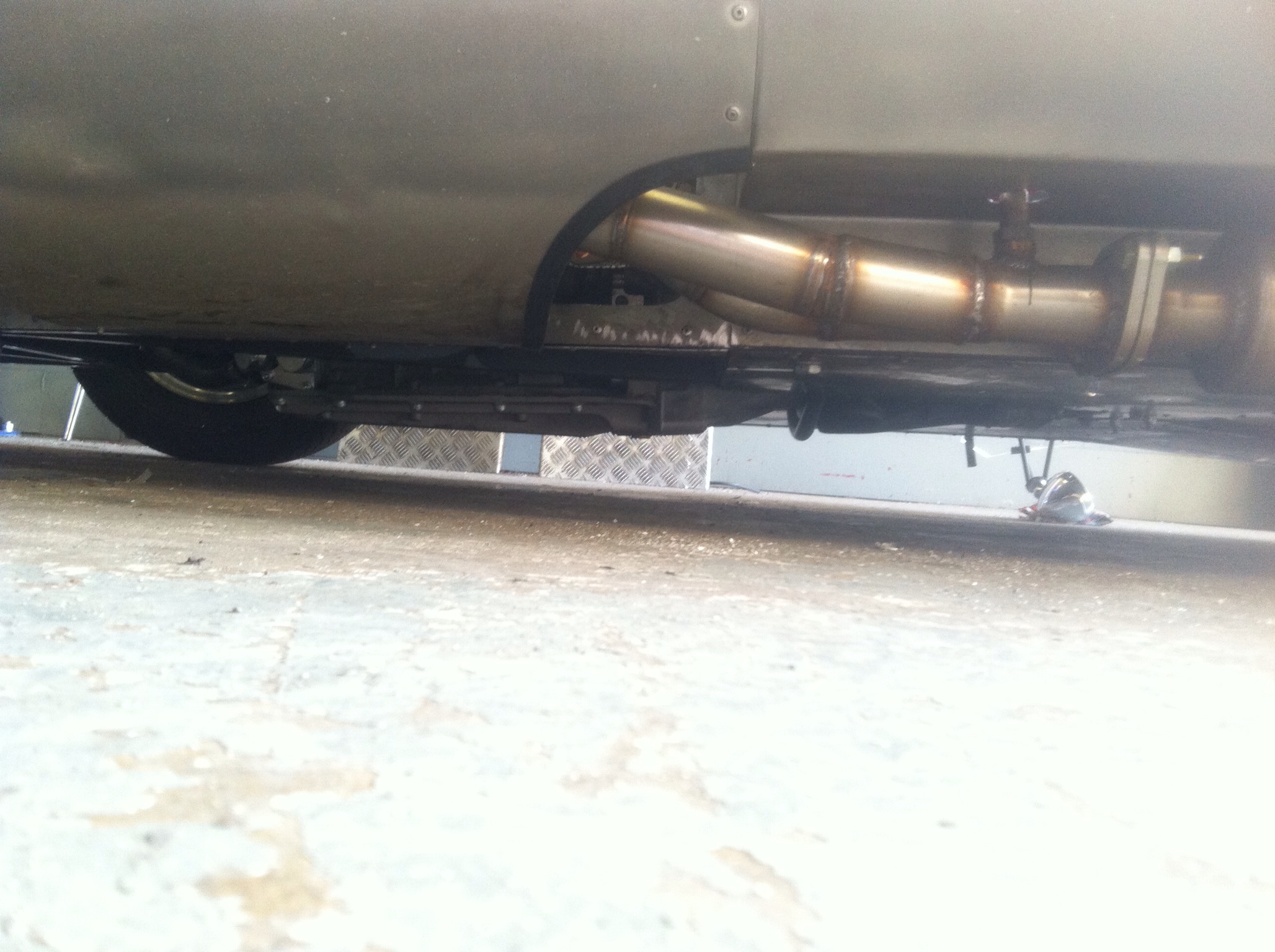

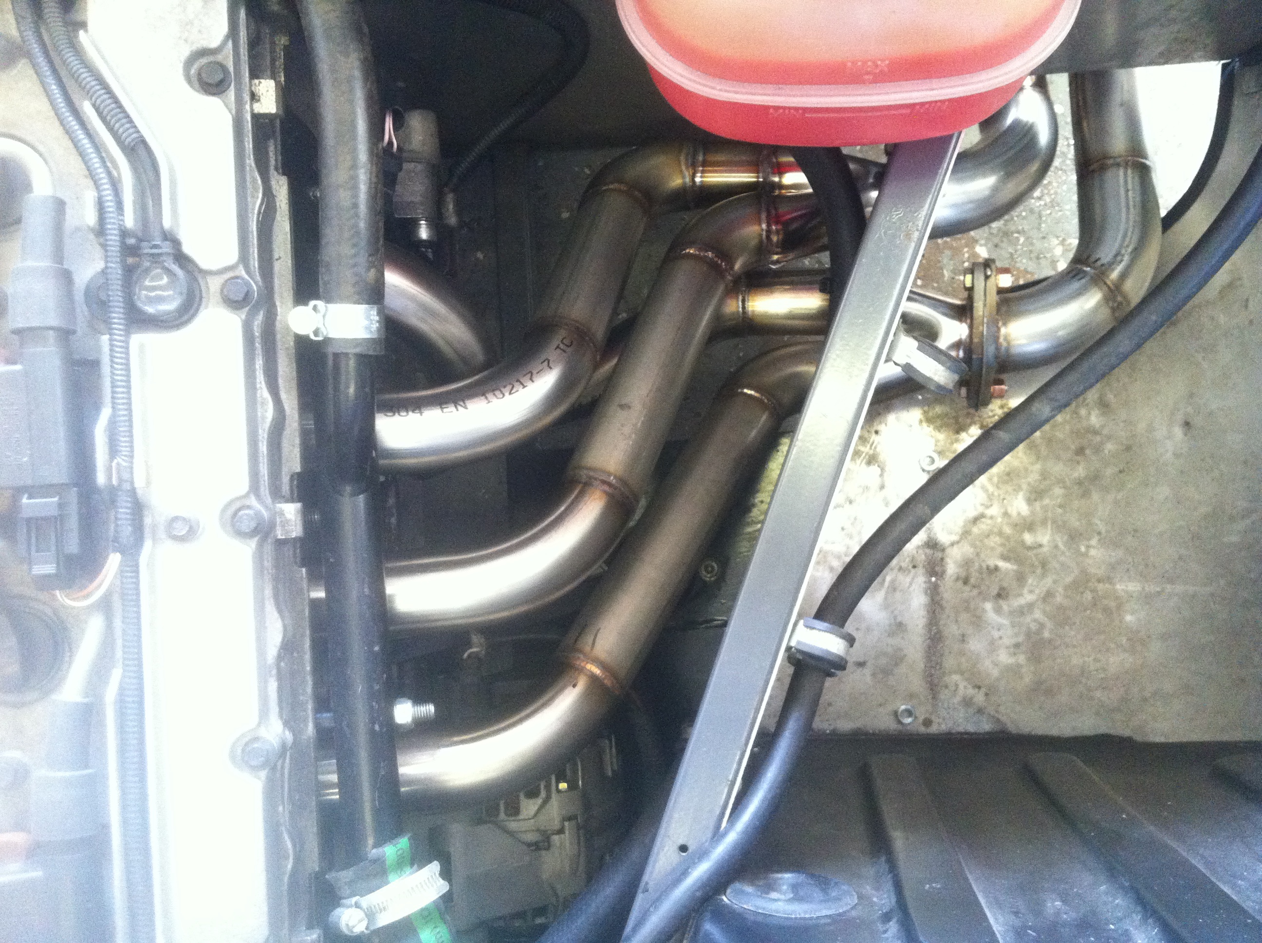

Exhausting.. Here's a few photos of the exhaust I took the other day before they were wrapped. Shame to cover up the tubes but it keeps things cooler under the fibreglass.

Hi Mark, well done with the conversion. how much hangs below the chasiss please?

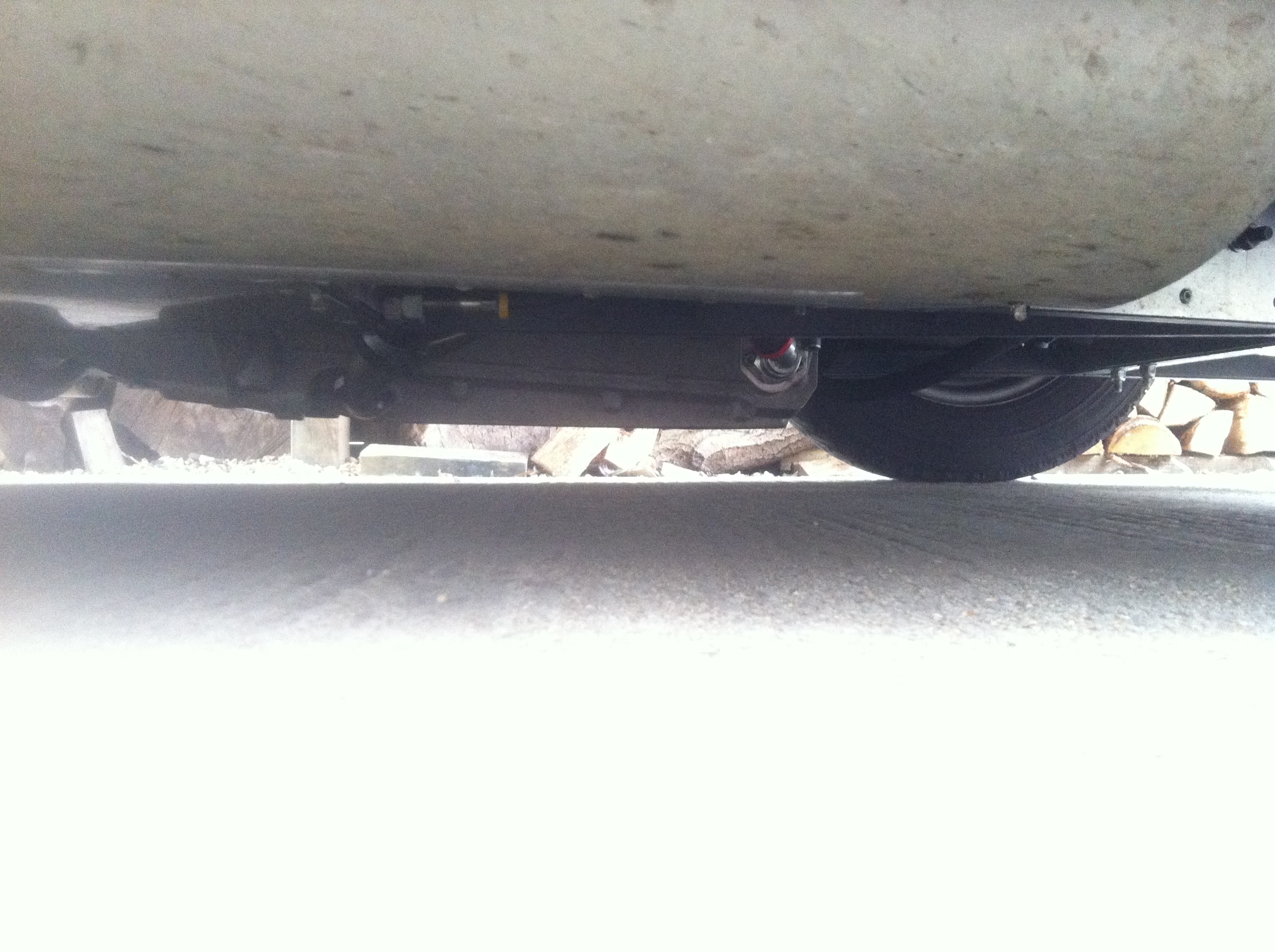

Hi Malc
This is a standard Caterham dry sump set up with the titan pump. Clearance on this is about the same as the A series was. There is absolutely no option to install a K series without a dry sump, you'd leave a trail of sparks behind you shortly followed by the sump contents.
I'm currently near Thame in Oxfordshire but shortly moving to Stratford upon Avon.
Very happy for you to come and have a look and I can share my mistakes with you.
Mark
