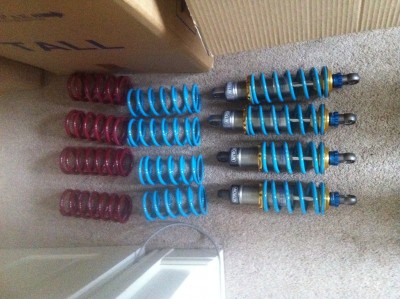

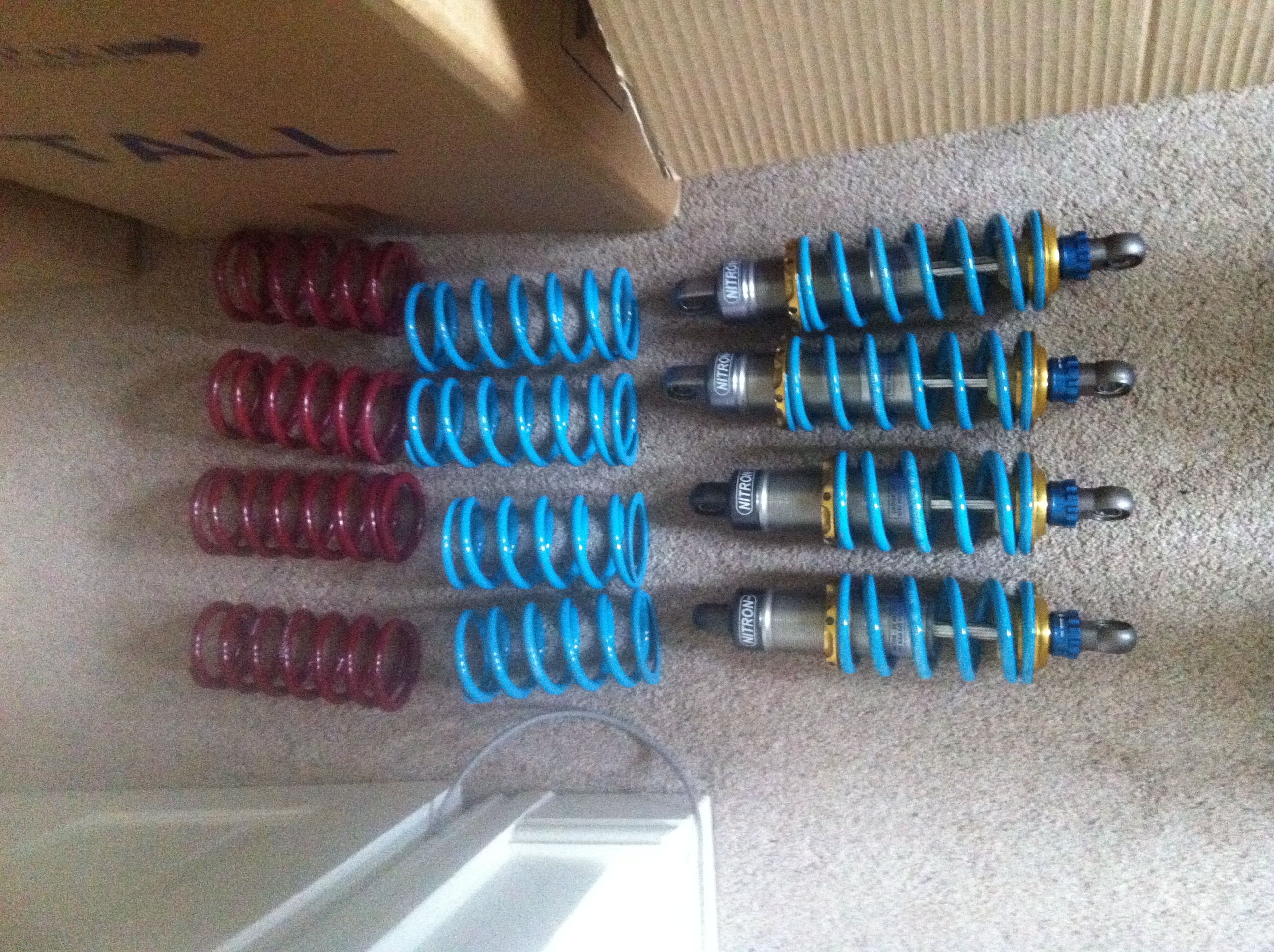

[attachment=0]photo (2).JPG[/attachment]
Brief update; Dampers now back from Nitron and ''softened by about 75%" The front springs fitted are 325 and the rears 150.
I'm borrowing a pair of 300 front and 175 rear to see which is "best".
Off to Westfield later to get new bushes fitted to my rear trailing arms as all mine were done for after about 3,000 miles.
Will let you know how it seems, softer probably.
Spring & Dampers
