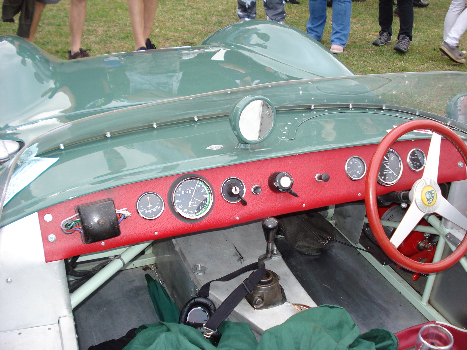

Ok here we go:
So this one has the return edge on the scuttle and presumably door too. Shouldn't be too hard to replicate this in GRP. It also has a curved bracket on the scuttletop for the single config deflector.
Single Cockpit Body Work
Re: Single Cockpit Body Work
A slightly different arrangement compared with the two pics I posted earlier.
Apart from the issue of passenger door and scuttle screen-holes to be plugged (you could use some nice, stainless button-head screws), you could have a solid tonneau set up (and new wraparound screen).
Option two might be to just go for a solid scuttle/pax door/tonneau one piece moulding, perhaps? Just have the driver's door as an opener and the wraparound screen is cut to incorporate the original driver's door perspex.
The first option would be radically cheaper to develop and produce. Option Two would probably need some rope glassed in for rigidity (or you could use carbon!!).
The screen would be the same for both options. This would be for a RHD, head-fairing car - naturally. Left-hookers won't be a player without a car to use for developing the mould (and almost doubling the dev costs - though some lessons could be carried over). I suppose it could be possible to use the single-cockpit mouding with a flat-backed car, but it might look a bit odd. I think the appeal of the single, faired, cockpit is that it looks like a fifties fighter!!
I'd go for option 2. It'd be more expensive, and require space to store, but would make swapping from one to other very simple. The single-seat looks cool, but isn't overly practical.........
off the wall suggestion - use sheet fibreglass which is bendy. gaffer tape over the scuttle edge/door/rear clam edge to get curve. glass in stiffening ribs from underneath. Once set draw around underside of edge so you know where to trim (add an inch all round for example). Basic tonneau done, then glass in return edges, make windshield fitting etc.
If only the tonneau was flat!
The real problem is the compound curves. There really is no easy way to do this. Bendy 'glass sheet wont work. The contours have to be held from the nose to the end of the tail. The doors, scuttle and likely the rear clam shell will have to be reshaped.
Find and original car, have it scanned and a mold cut.
