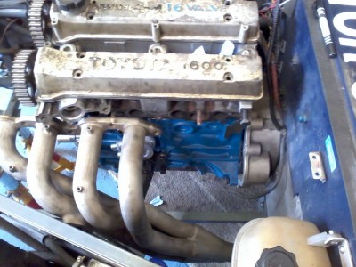

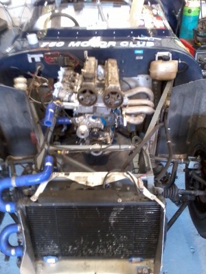

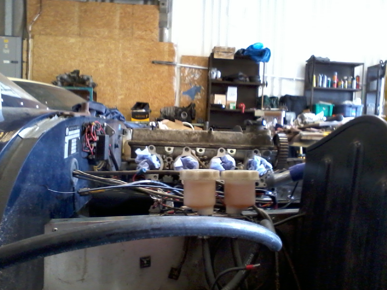

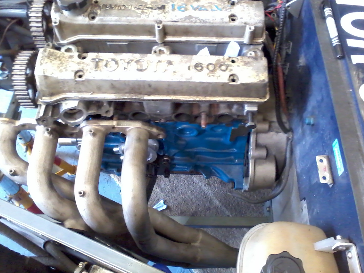

[attachment=2]Photo0056.jpg[/attachment]Getting there - slowly. Engine and box now in the car and no major fouls. With it canted over about 5 deg to the exhaust side the throttle bodies clear OK. Engine and g/box mounts all fabbed up and just about sorted out the coolant pipe runs. Still looking for a propshaft - either need a Ford Rocket splined front end to machine to fit my old Midget prop, or a complete Ford prop to shorten and then machine a PCD adaptor to connect it to the diff flange. Nothing cheap or local so far but there are plenty of new props available for the rally boys if need be. Exhaust will need a lot of cutting and shutting. Usually not a big deal but my fancy stainless TRD manifold to fit a Corolla needs TIG welding so I'll have to enlist outside help once I've worked out what is needed.
Engine is fitted with the spare cylinder head as it turns out the new oversize seats in my good head have not been cut to consistent depths to I can't get the valve clearances within tolerance. So it is off being re-machined whilst I figure out the installation.
The oil filler will have to be machined flush but I can use one of the handy screw in core plugs in the top of the head as a breather tower and oil filler. As with the Type 9 the Westy crossmember has had to go to clear the Rocket gearlever.
Time to order the ECU - Megasquirt planned. I think I can use the ignition trigger in the distributor both to trigger the spark and send engine speed to the ECU. Will be batch firing the injectors so sequencing not important. The throttle bodies already have the stock potentiometer fitted, and there are two possible locations for coolant temp sensor on the engine. Then just need an air temp sensor to complete the inputs. Tracking swirl pots on EBay, and also a high pressure pump.
Think I'm going to need a slight bonnet bump to clear the front of the cam covers but not much. Using the stock sump with 3" of clearance.
Feels as if it might actually one day run! Meanwhile race pass me by...
Apologies for the shit photos - that's what happens when you use a phone to take pictures. Especially when you are not used to doing so!
[attachment=0]Photo0058.jpg[/attachment][attachment=1]Photo0055.jpg[/attachment][attachment=2]Photo0056.jpg[/attachment]

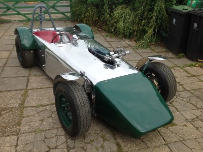

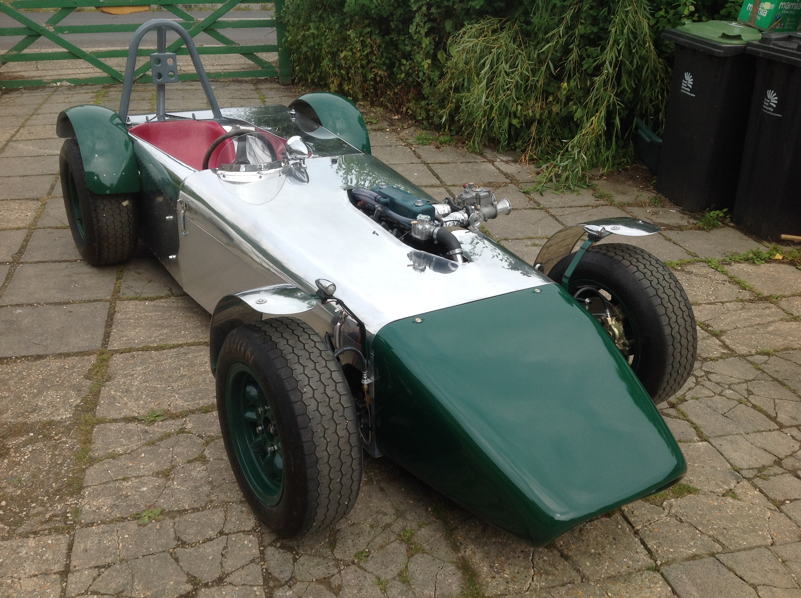

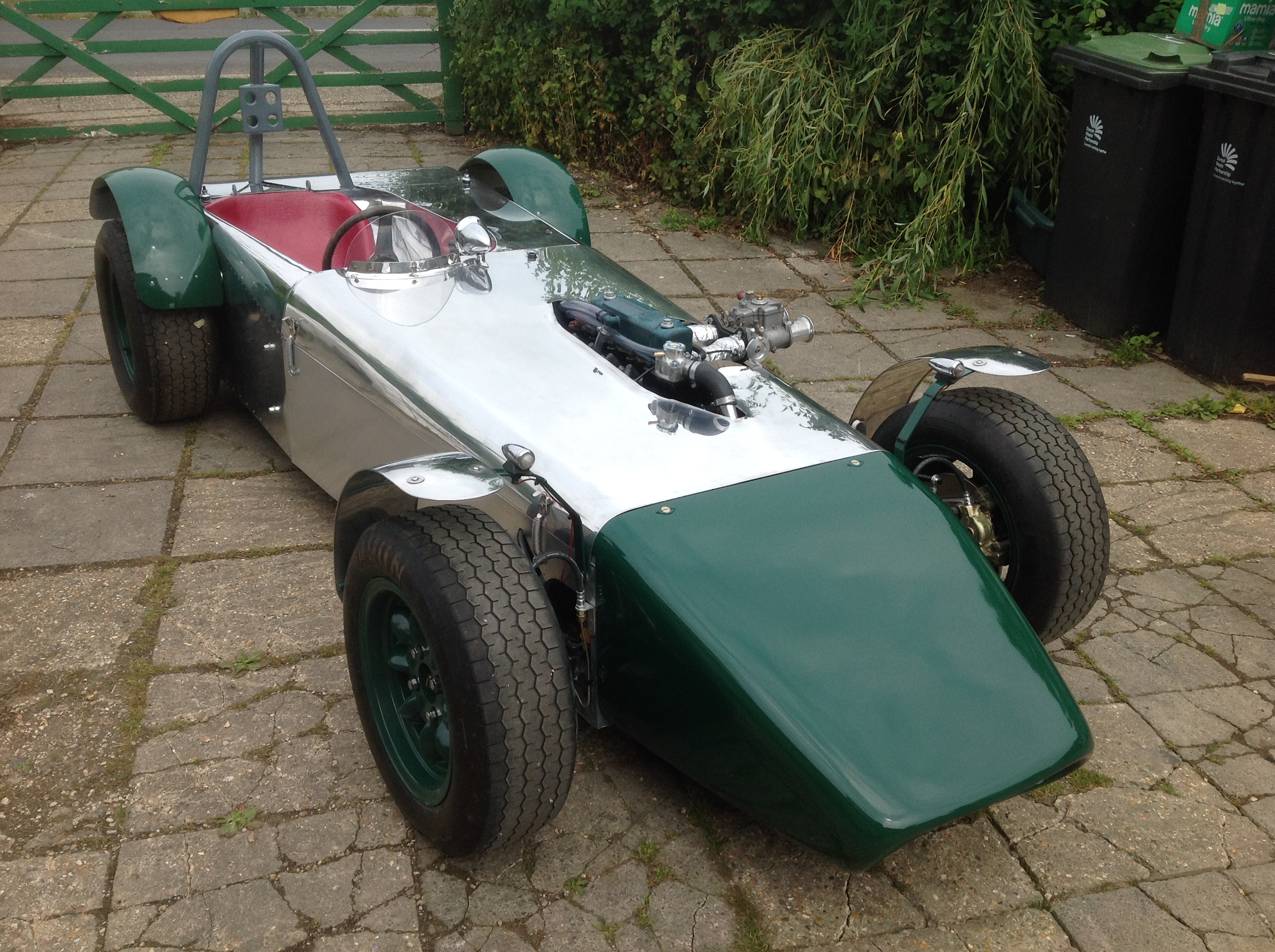

Just about finished my first project!
[attachment=0]2015-06-12_11_21_25 am.JPG[/attachment]
