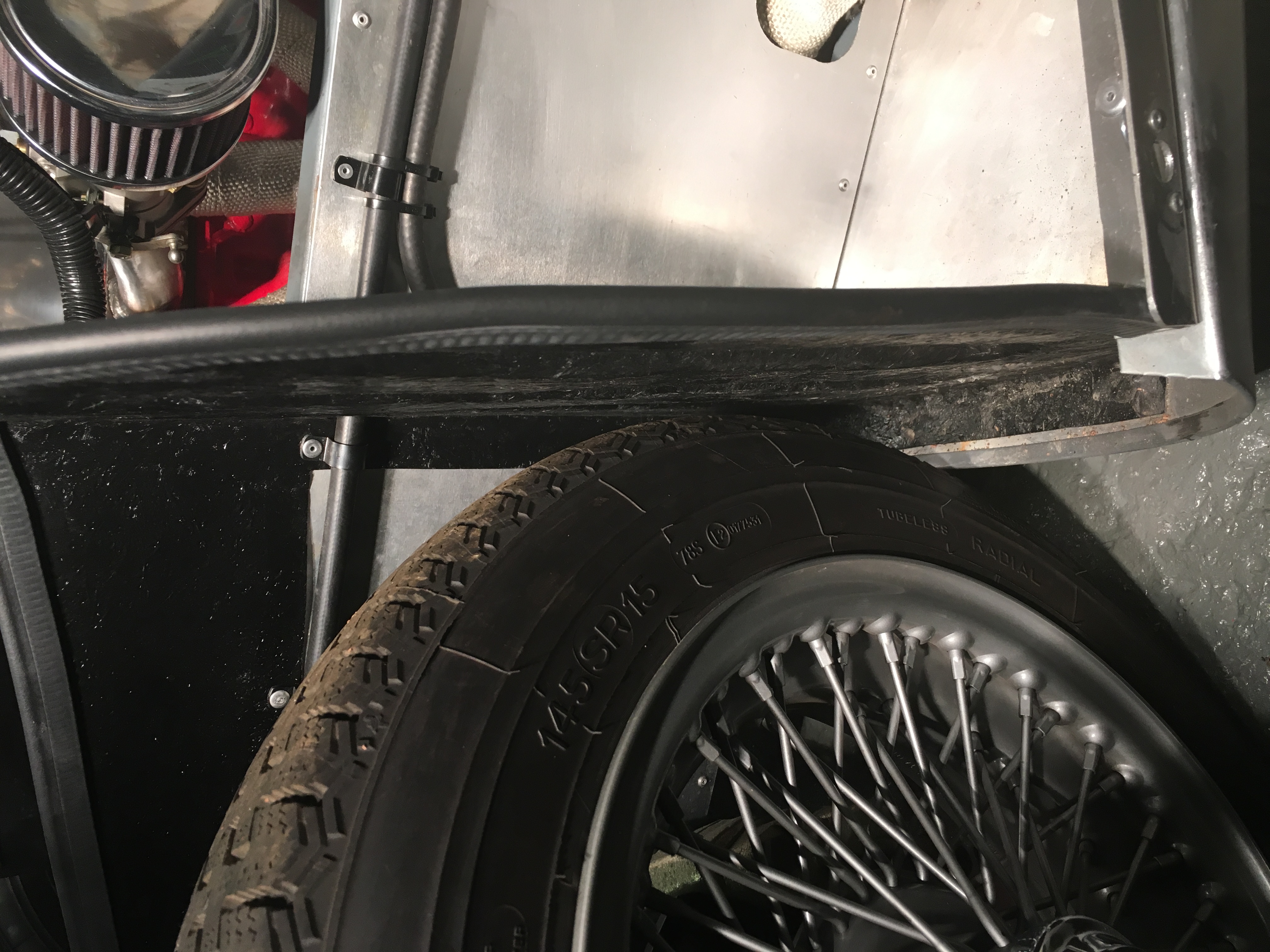

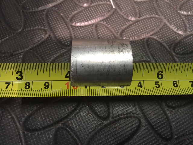

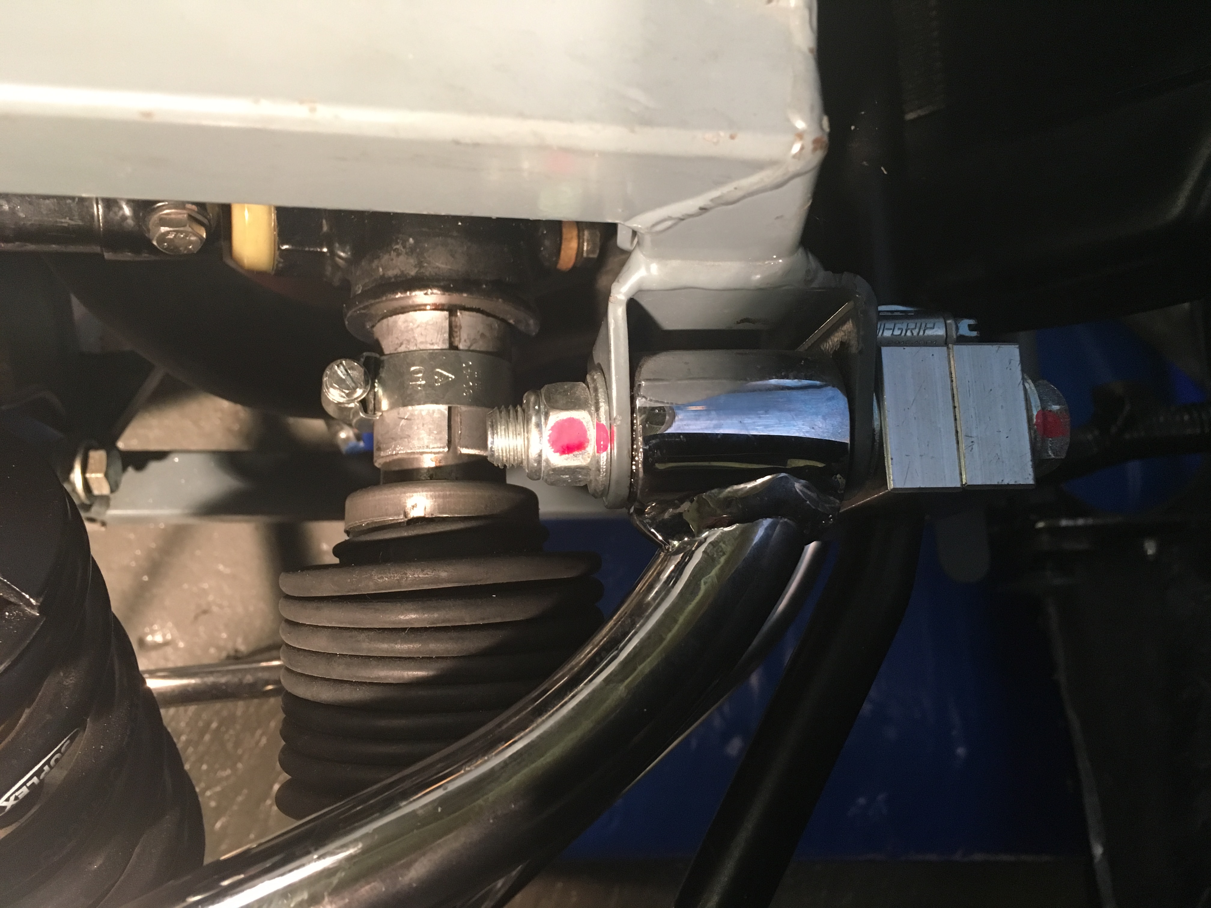

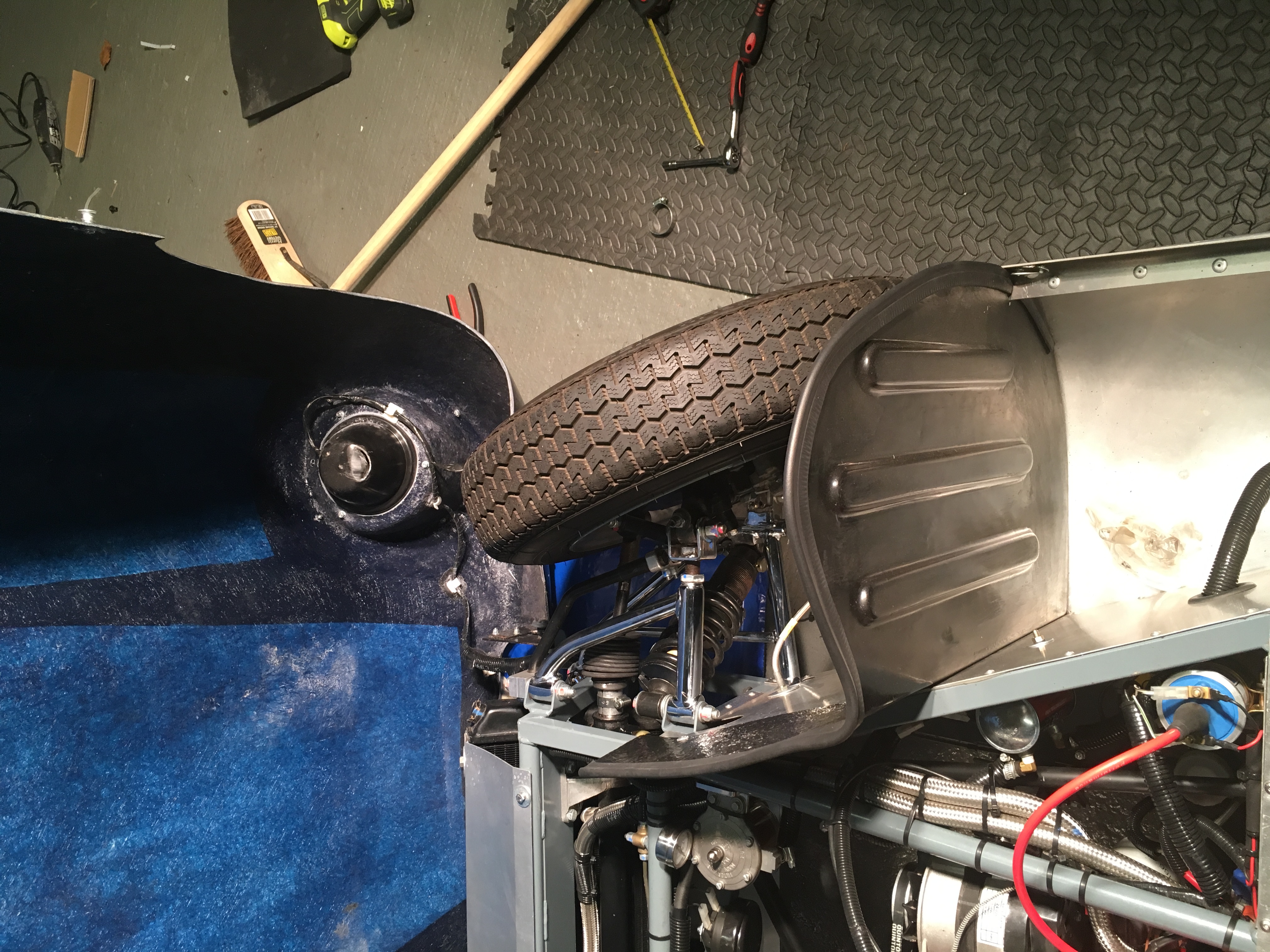

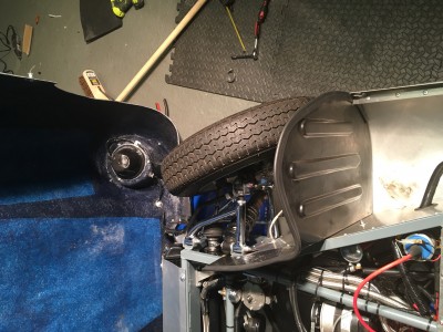

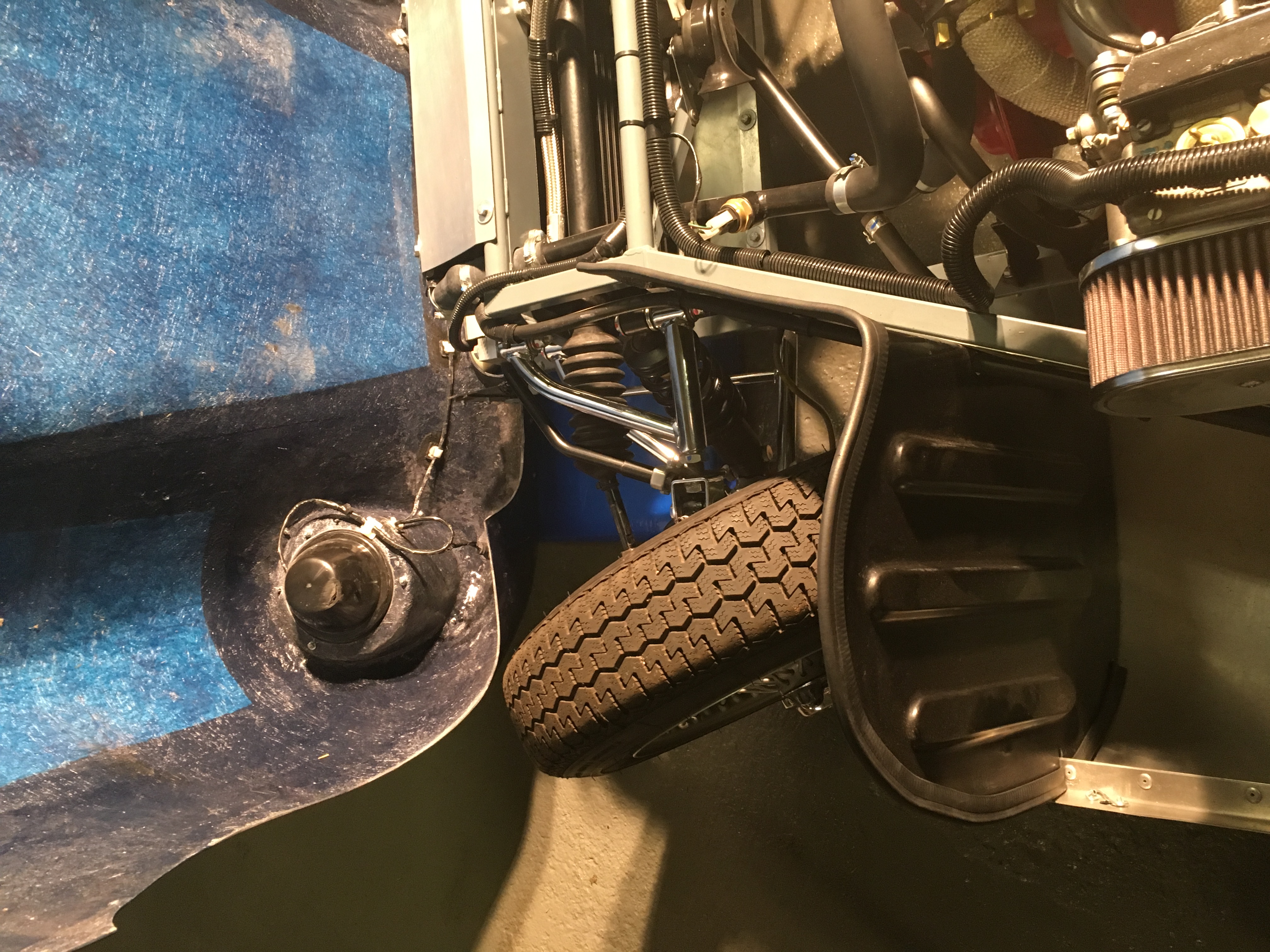

I spent a couple of hours in the barn last night playing with the steering rack and body clearance. Good news - the rack had indeed been fitted with restrictors by Westfield for the IVA and having removed / altered them, I now have much improved steering articulation with bodywork clearance. Phew.
I removed the near side restrictor altogether (passenger side for a UK RHD car) and cut the offside restrict or down to 32mm. Without the offside restrictor removed, the rack would have allowed the tyres to contact the bodywork before full lock.
Pictures of the steering articulation achieved and the body clearance below. As I say, it's tight but workable.

I've got Protech shocks to fit this evening so I'll see whether lifting the car onto jacks creates any contact between tyres and the bodywork.
- Posts: 469
More very useful photos, David. And my goodness, it's a tight fit at the front, isn't it? I'd be very surprised if you (and I, too) didn't have to trim the ally sills back to the mudguard. Although, that'll be an easy enough job.

Hi, David,
Seeing your reduced spacer reminds me that I had nylon spacer tubes (6mm thick) machined up to replace the thin steel tubes that Westfield supplied. I wasn't keen on a steel blade being bashed into the end of the rack housing every time the stop came into play. I told Mark Walker at the factory that I had done this and he has since advised at least one person that this is the way to go!

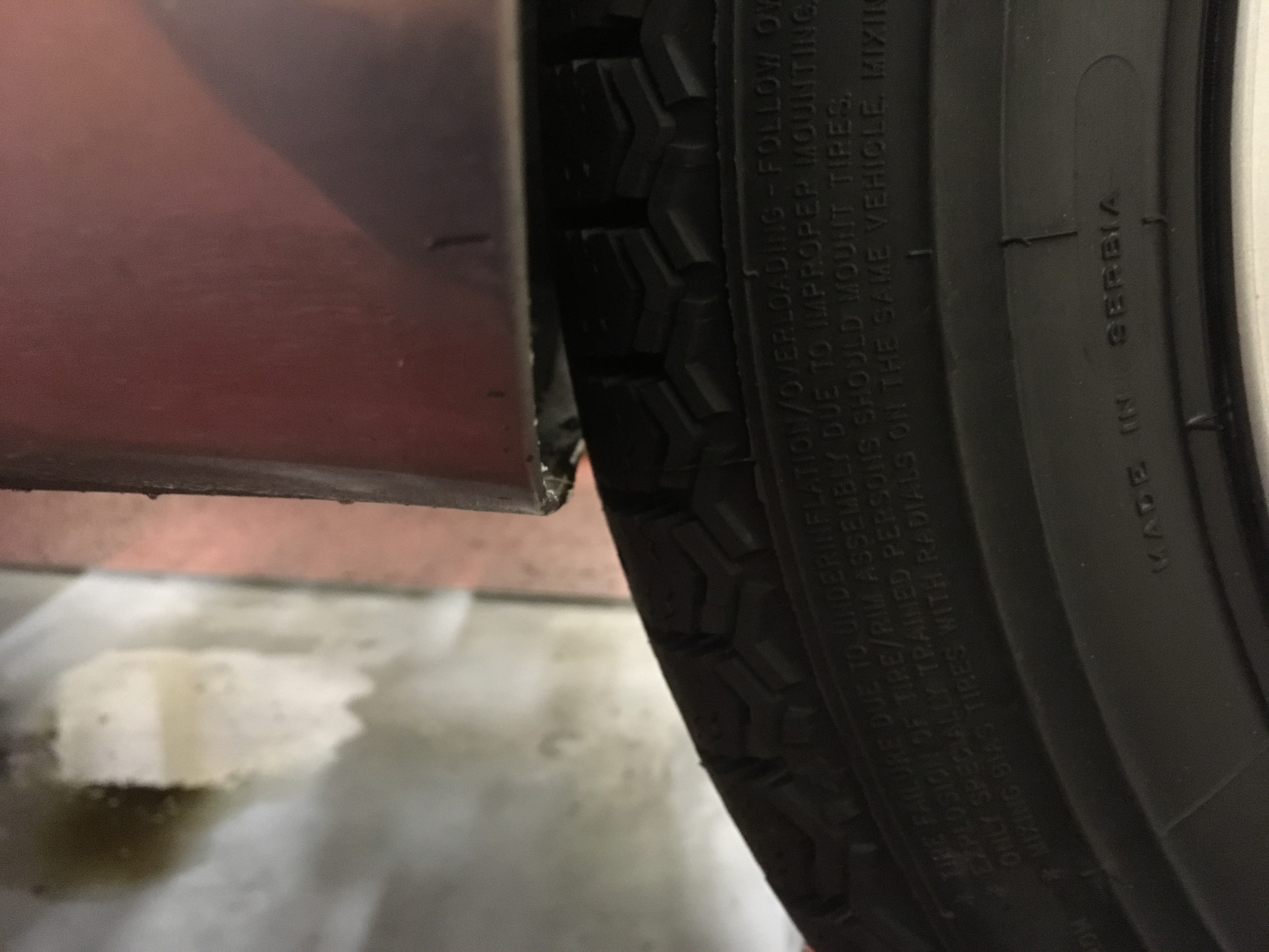

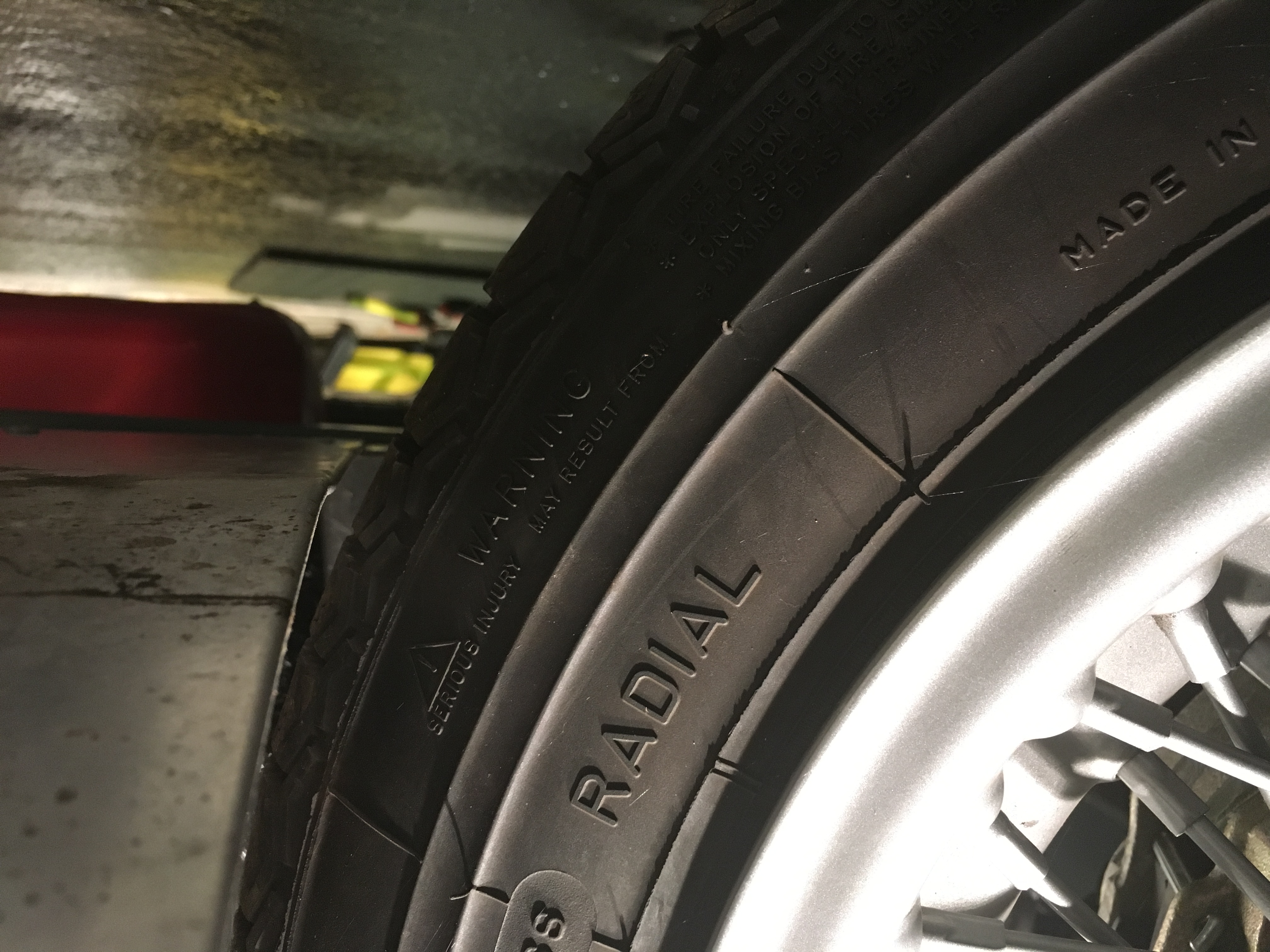

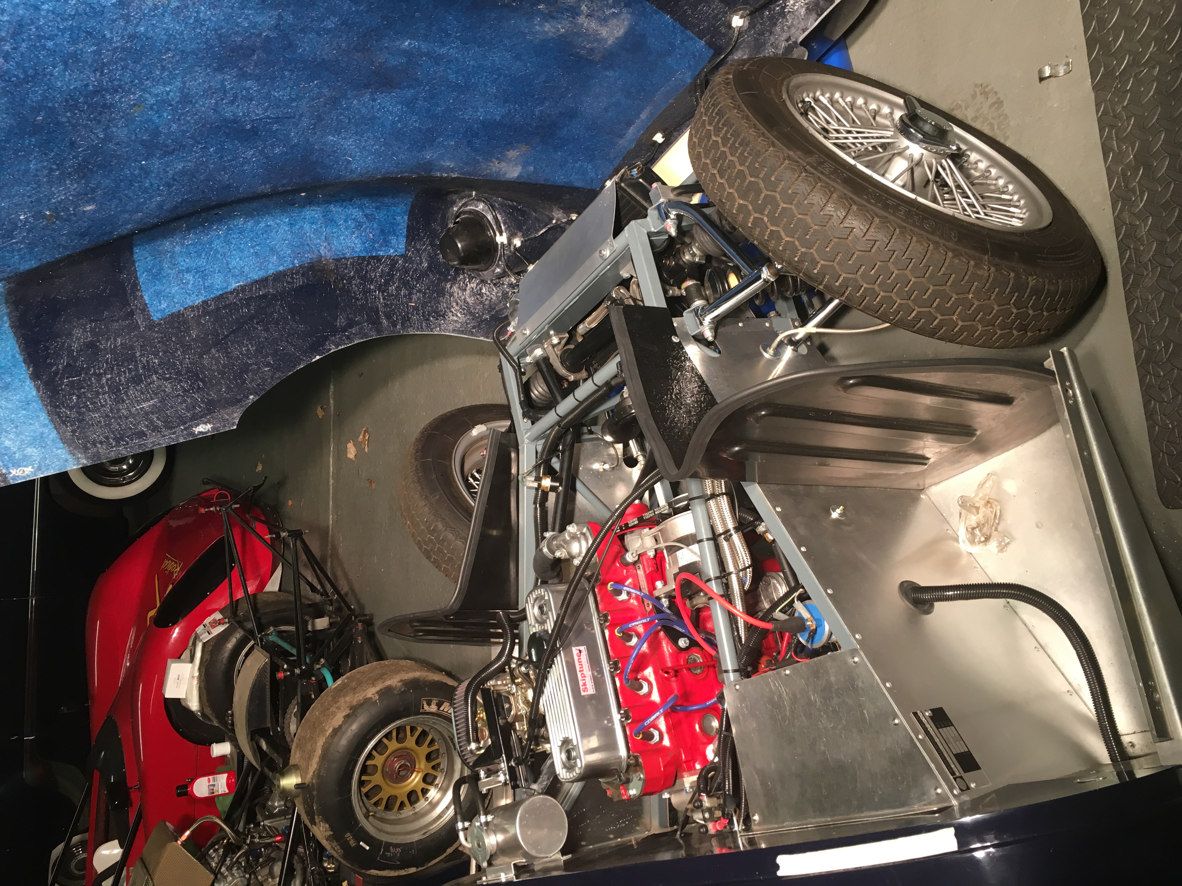

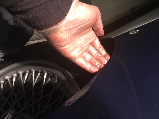

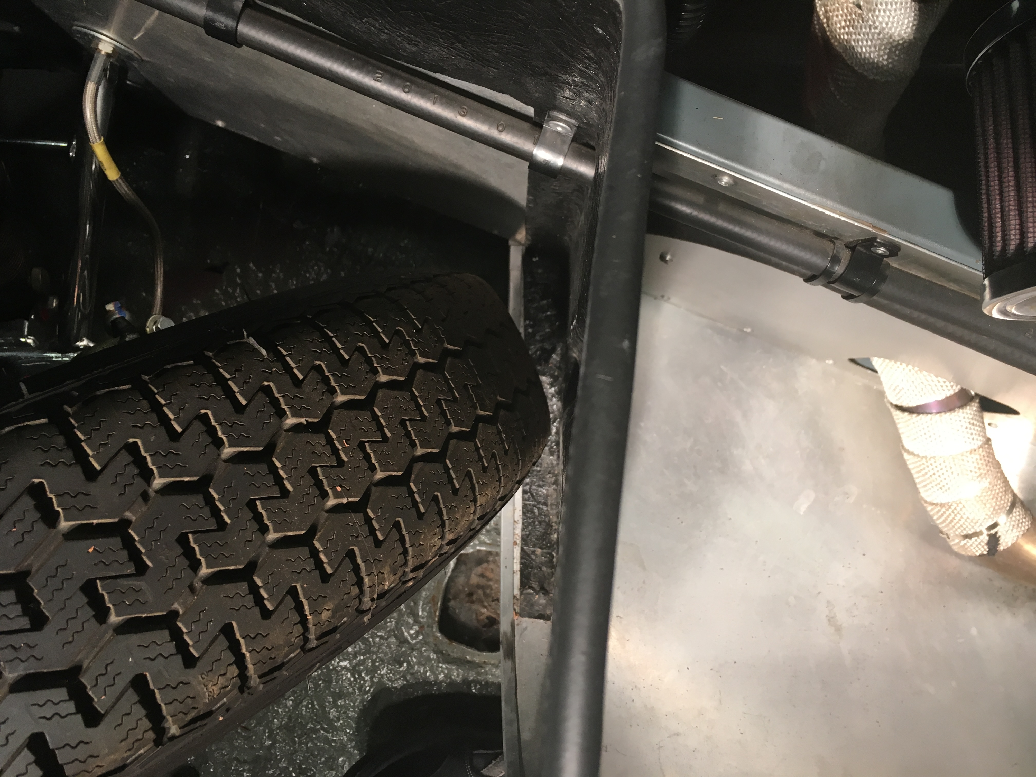

Two Michelin XZX 145SR15 tyres were delivered to me on Thursday. I was visiting friends in High Wycombe this weekend, so I dropped into MWS in Slough on my way there. Craig fitted my tyres to two of his "trial fitting" wheels; the 48-spoke, 4 inch-wide rim that was OEM for the MG TF and MGA (the XW450) and the 72-spoke, 5 inch-wide rim (XW459) and I was able to test fit them to the car this afternoon.
Firstly, the fit. Almost no issues whatsoever! There is LOADS of room between the front tyre and the back of my headlights. Remember, I have the old bonnet moulding with it's short, integral headlamp bowls, with LED bulbs, heat sinks and drivers fitted. (If that's news to anybody, there's a separate thread on it!) Great (so far)!
All good to the front of the front wheel. Not so perfect to the rear of the front wheel. With the car up on axle stands and the front suspension at full droop, clearance between the tyre and the aluminium sill is at its most limiting. With any steering lock applied, the wheel impinges on the metalwork. The photo below shows the gap with the steering at neutral. This is the front/right wheel; with the wheels steered to the left, the back of the tyre moves to the right (outboard) and the gap INCREASES significantly. But with the front wheels steered to the right, the back of the tyre moves inboard and jams on the sill. It's the INBOARD front of the sill that'll need cutting back a little, but not by much; probably about half-an-inch off the forward edge of the sill from the chassis rail, outboard for about six inches. (This will not be a visible alteration!)
At the rear axle, clearance should be OK. I'll be fitting 165-section tyres which are slightly taller, having an overall diameter 30mm greater than the 145-section tyres that I've offered up. I may well have to reposition the fibreglass inner wheel arches, but that's the work of only a few minutes per side!

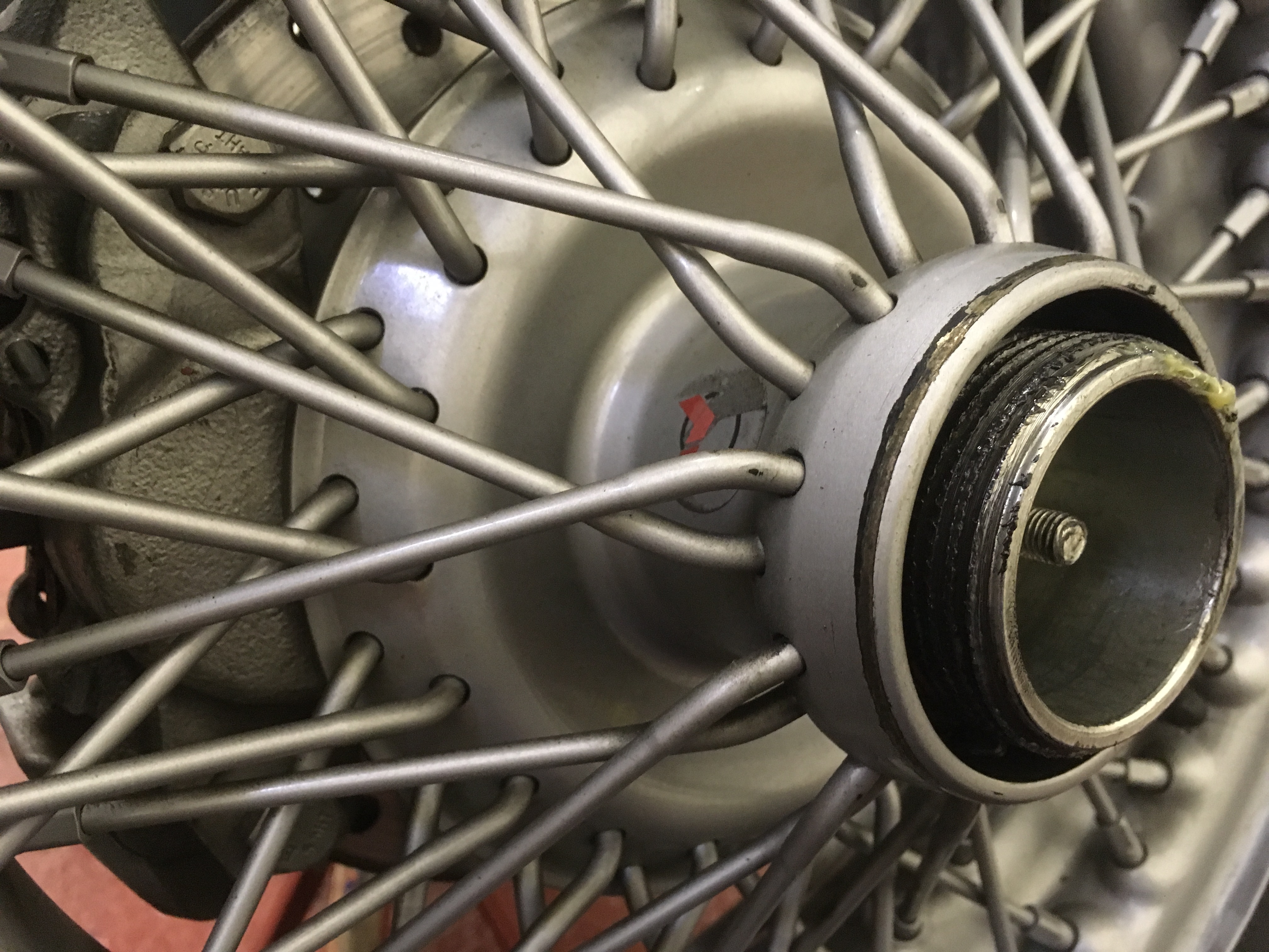

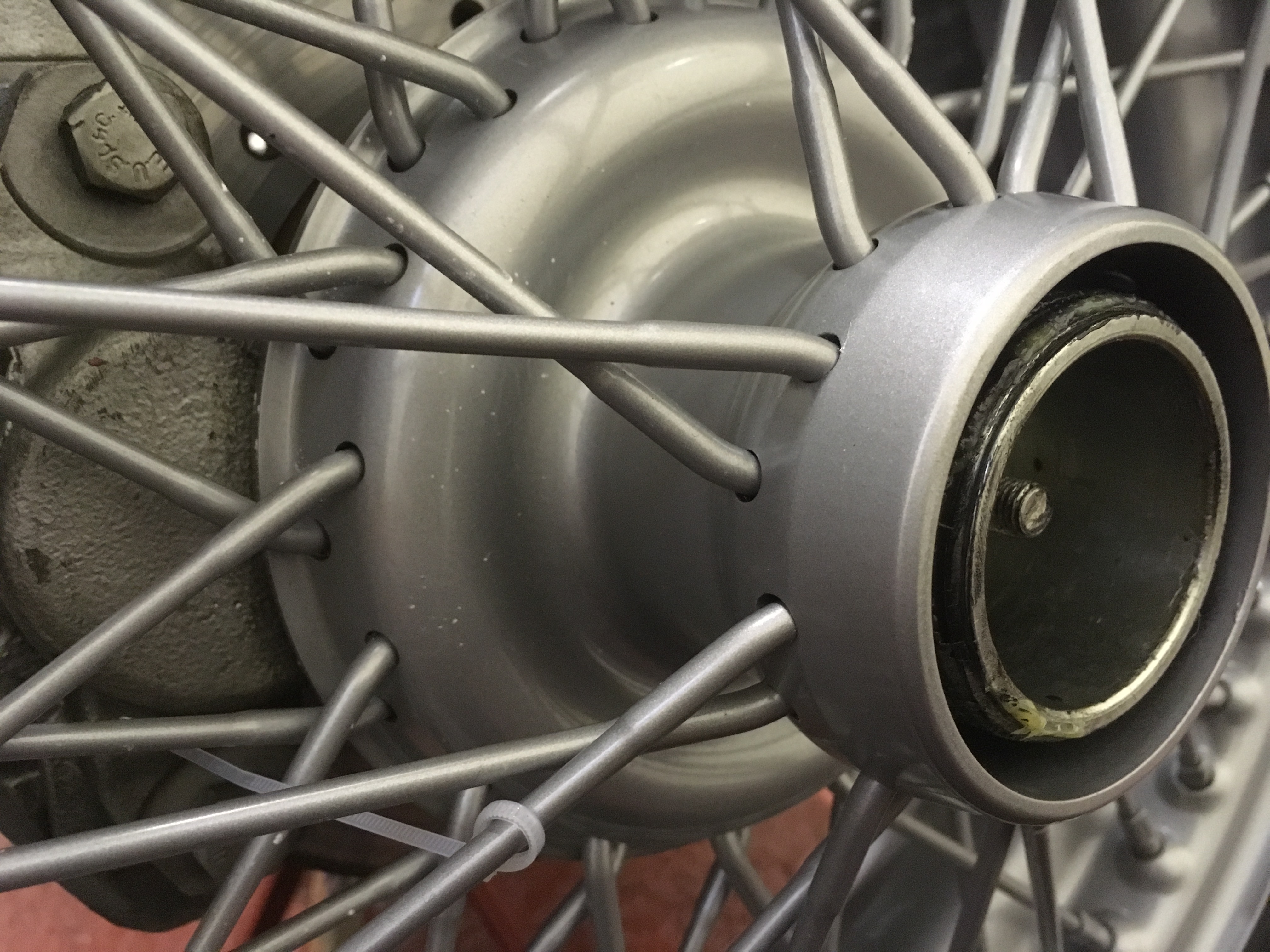

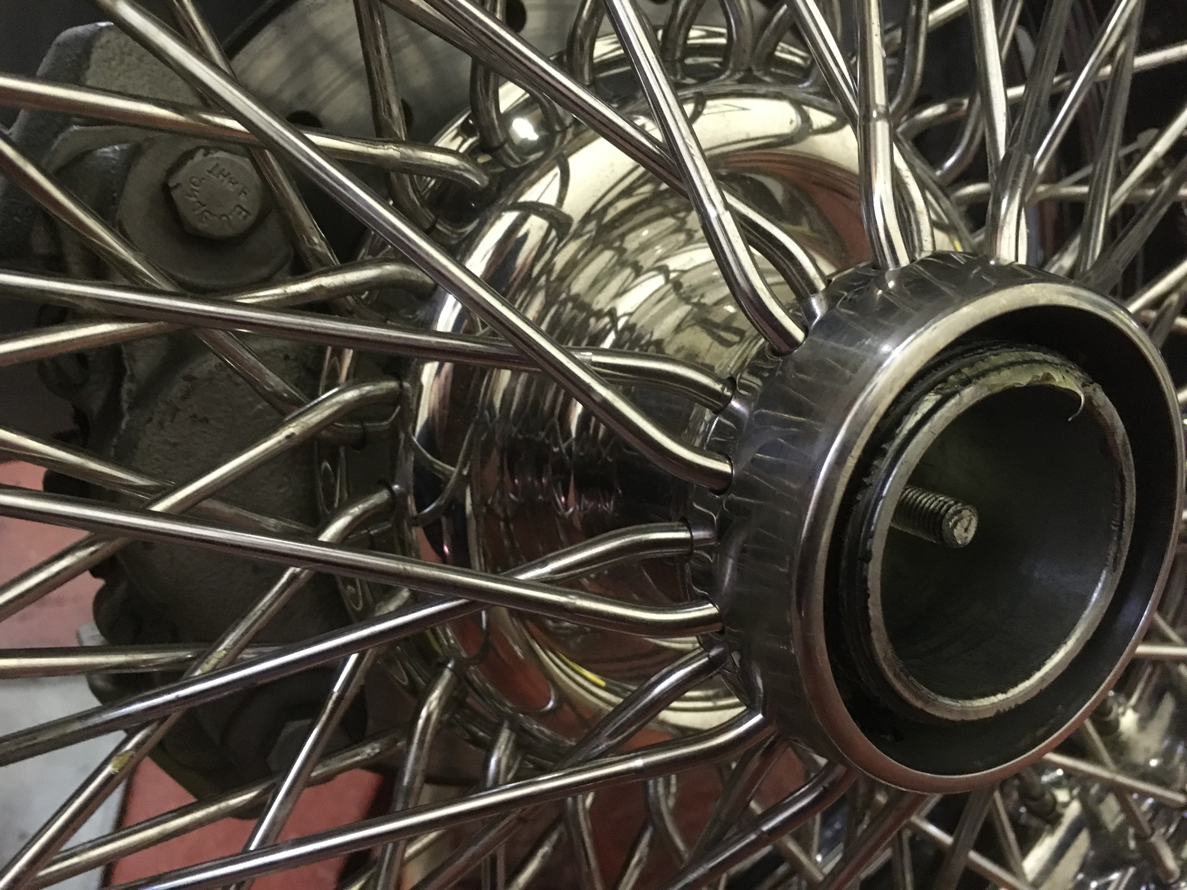

Well, the wheels don't actually fit! By which I mean that the Whubs are wrong for my Shubs! In the near future someone will be along to tell me that I need to fit MGA hubs and that to do so is easy. I'll explain why I can't do that, but I'll be advised to do so nonetheless.........
My 2006 car was originally built using a disc-wheeled donor car and fitted with the Westfield Minilite-alikes. To convert from disc-wheel hubs to wire-wheel hubs (Shubs) I had two options; "conversion" splined hubs, that bolt onto the cut-down studs of the existing disc-wheel hubs, or a full conversion to "proper" splined hubs.
I looked at the former and disliked the compromise, so I've converted to proper splined hubs. But the rear axle casing of a disc-wheeled car is an inch wider than that of a wire-wheeled car; so wire-wheel half-shafts are too short to fit into a disc-wheel axle casing. The only option is the hybrid shafts available from Peter May Engineering. They supply hardened half-shafts of the correct length for the wider, disc-wheel axle casing and come with the splined hubs permanently pressed onto them (as standard, the splined hubs of the rear axle are not permanently attached to the half-shafts). To fit MGA splined hubs at the rear would require a new, wire-wheel axle casing, restored and rebuilt with new, hardened half-shafts, with the required mounting modifications carried out by Westfield. Hundreds of pounds and weeks of work.
Likewise, at the front I've fitted proper, new MG Midget splined hubs. But I've also fitted the Peter May / Frontline Engineering 9" brake-rotor kit with MGB brake callipers. If I were to fit MGA splined hubs to the front of my car, I'd have to junk this kit and return to the inferior MG Midget brakes.
The Whubs of both of the 15" trial wheels are too deep. At the rear they do not have the back-side clearance to fit over the brake drum retaining nuts, so won't seat up against the brake drum. Therefore, none of the Shub's thread protrudes through the Whub for the spinner to engage on. (I didn't take a picture of this, but it's the same at the front, and that photo's coming up!)
At the front, the back of the Whub hits the brake calliper before the wheel is fully seated on the Shub. And again, none of the thread of the Shub protrudes through the Whub.
Here are both of the test wheels fitted to the front/right Shub. Note the back of the Whub is fully against the brake calliper. The third photograph shows a 13" Spridget wire wheel in place. It's fully seated on the Shub, the back of the Whub doesn't touch the brake calliper and the threads of the Shub protrude through the Whub, for the spinner to engage with.
