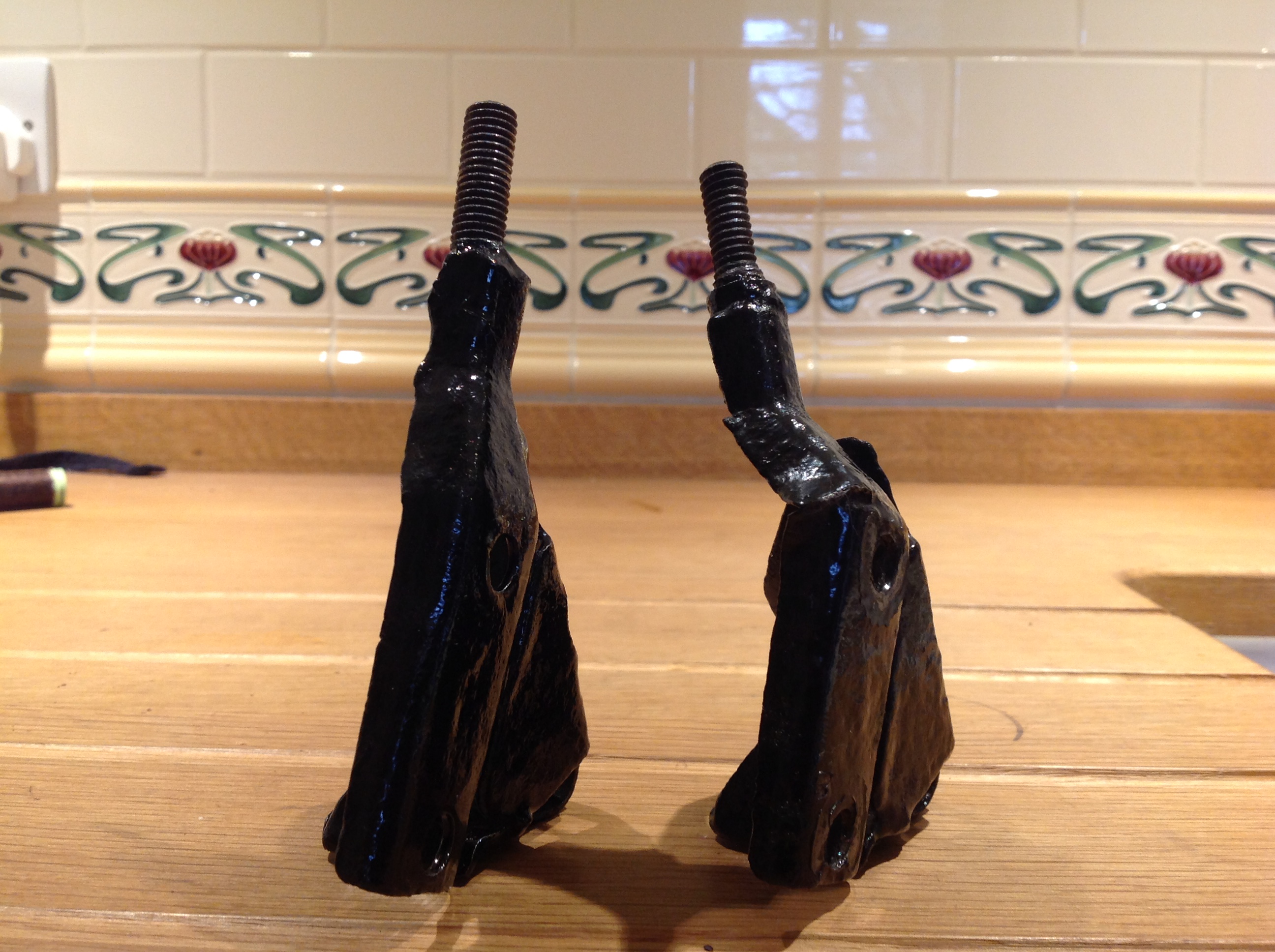

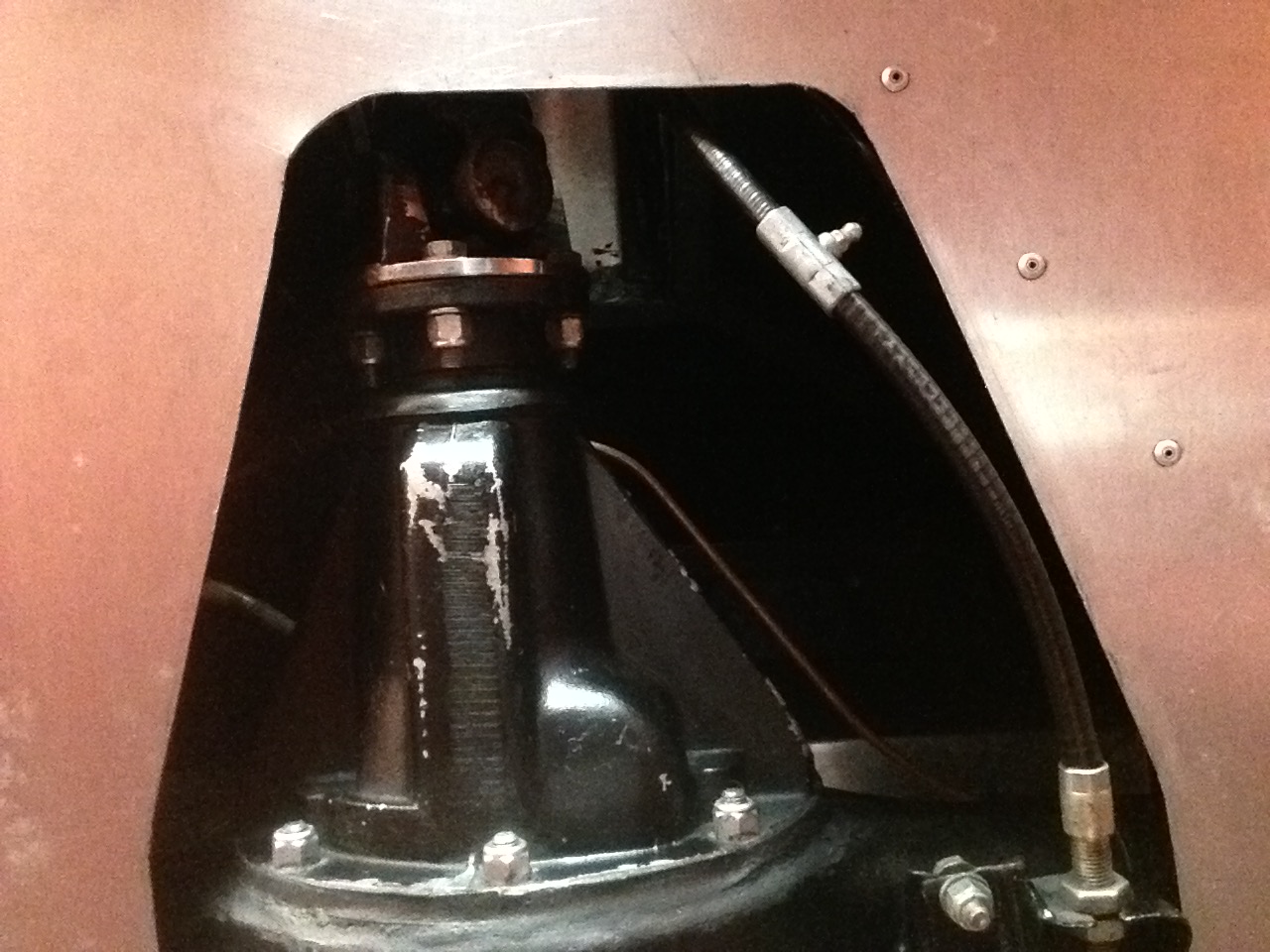

With longer shocks fitted, the rear floor needs cutting to accommodate the differential housing and handbrake mechanism. Here's my take on the required hole.

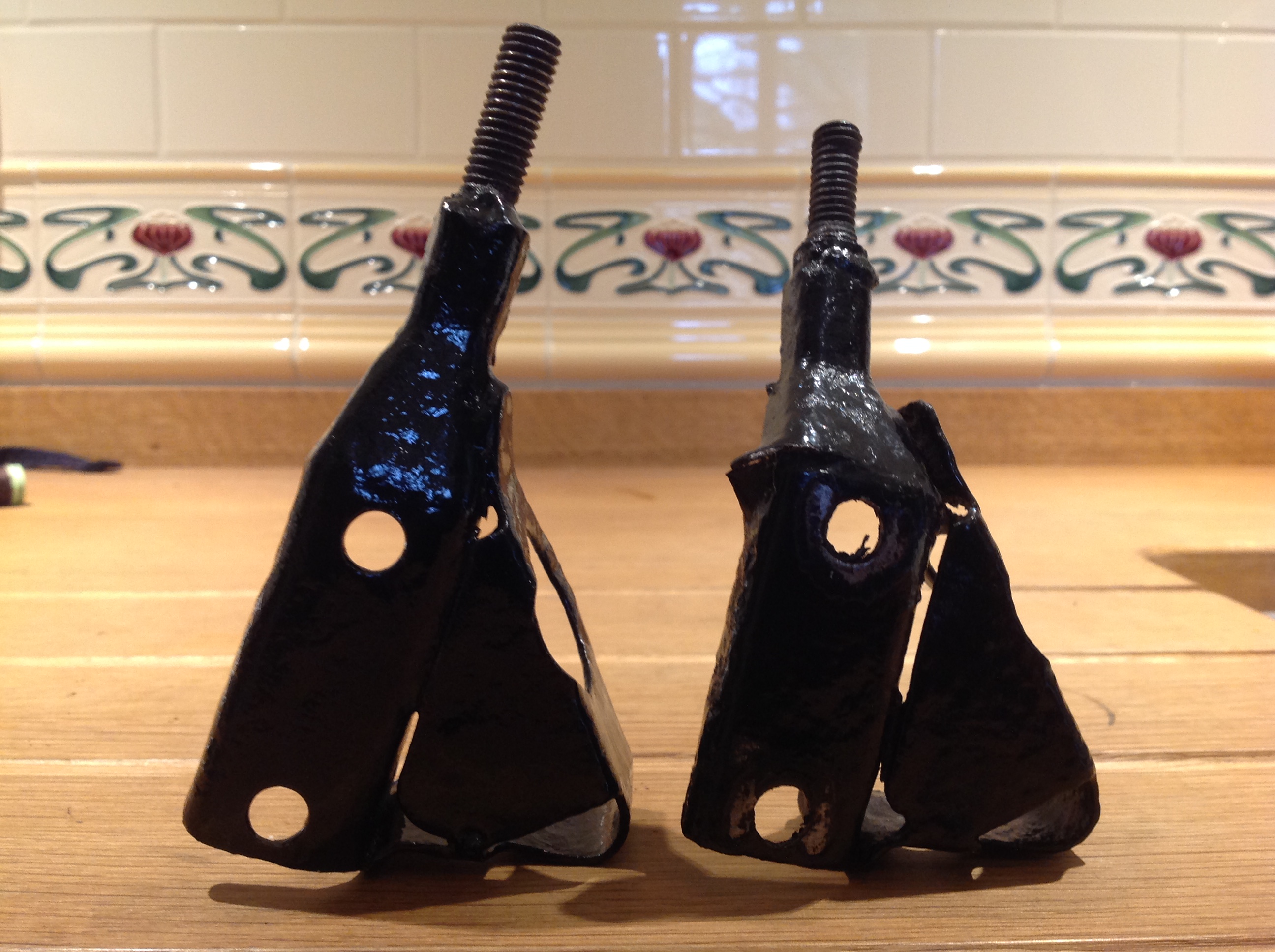

(The absolutely eagle-eyed may think that the handbrake balance-mechanism bracket looks a little short? It's actually bent! Fifty-year-old bent sheet-metal, with a pre-introduced crease (have a look at yours to see what I mean) constantly being pulled on by the handbrake cable. I noticed it a couple of days ago when I put the car up on stands to start playing around with 15" wheels. My spare bracket is painted up, ready to fit!)

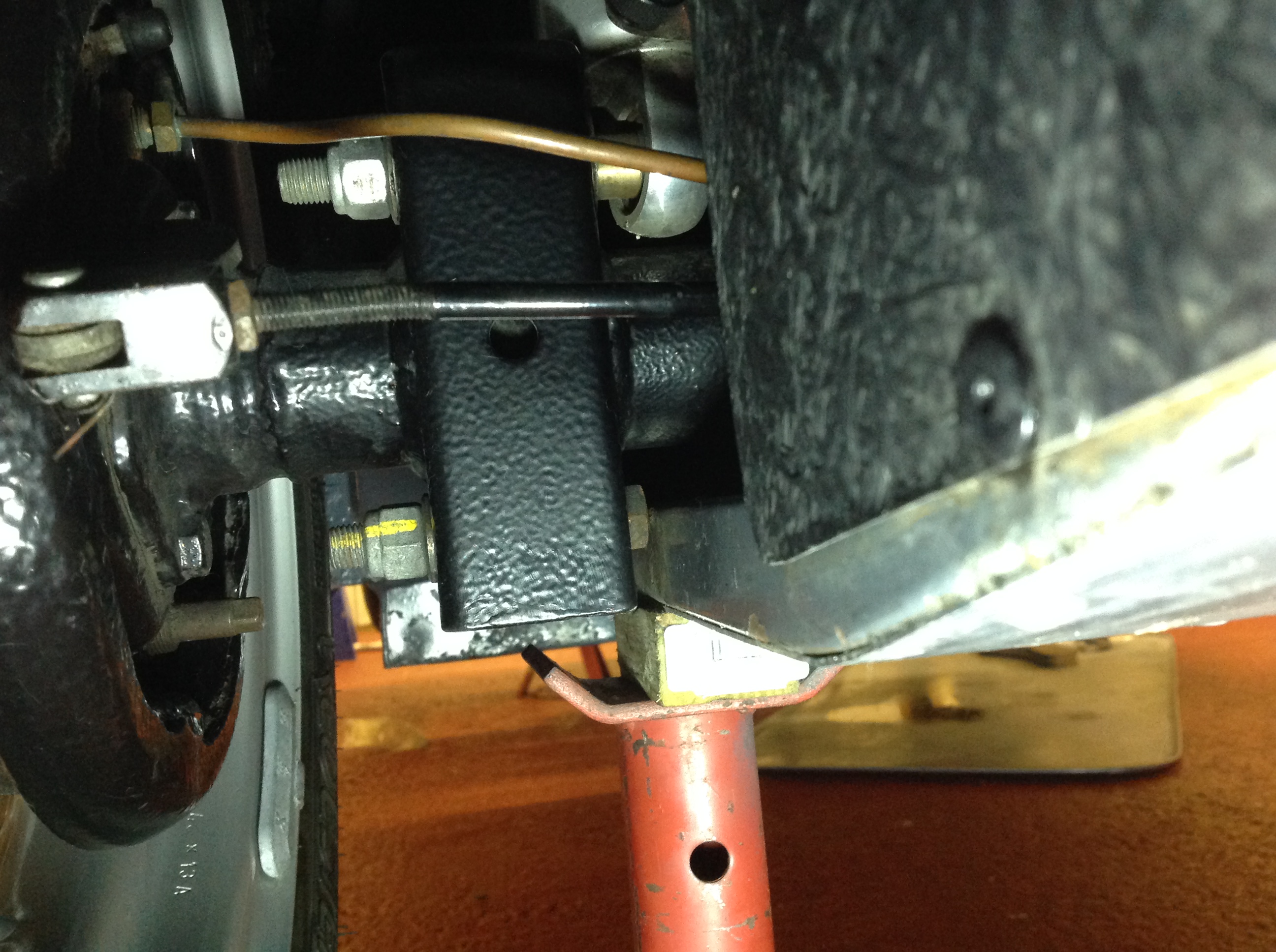

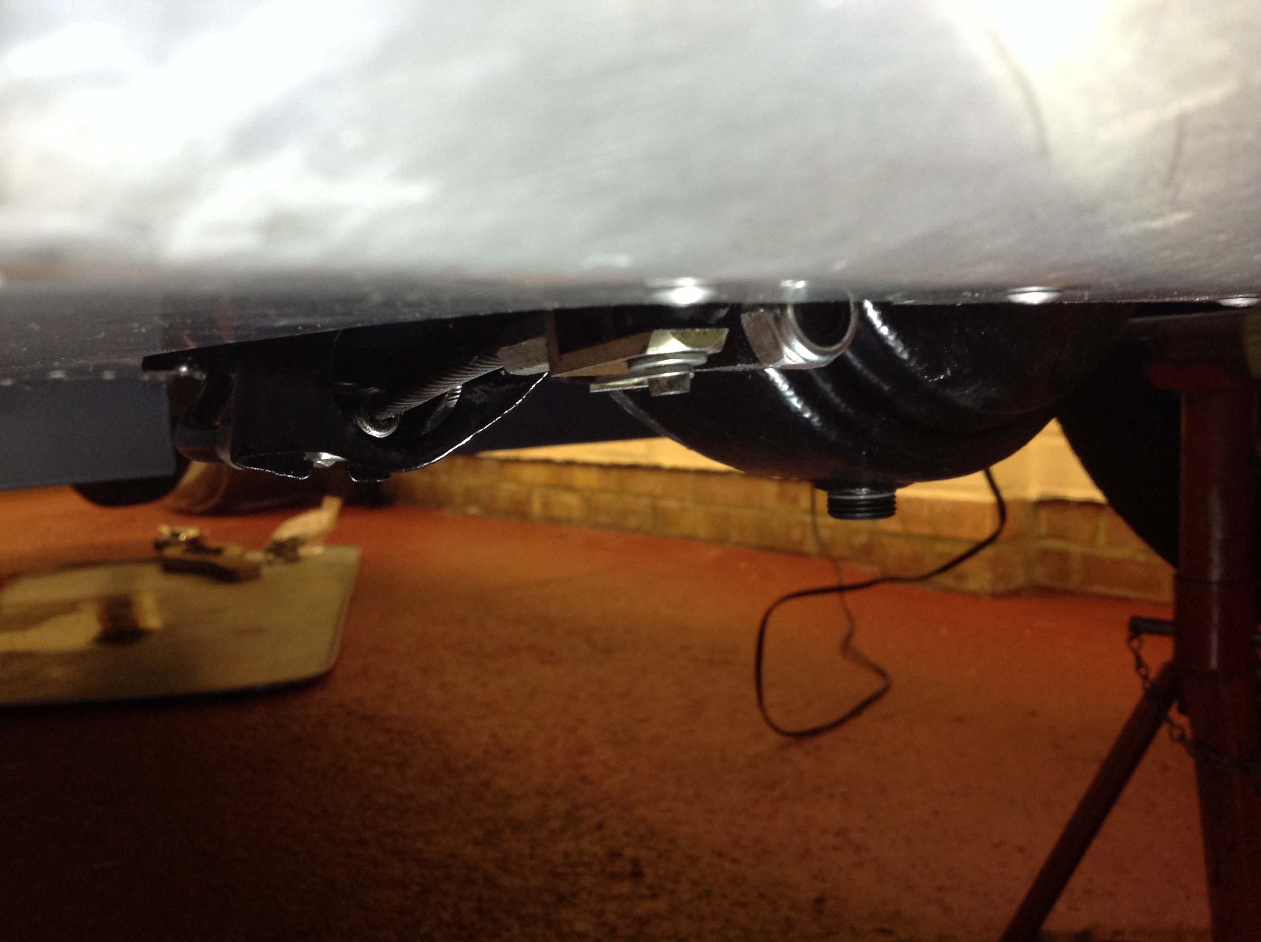

A couple of photographs pertinent to the fitting of 14" rear shocks. At full droop, the rear axle will be a little over 1/2" above the chassis rails and the bolt for the lower trailing arm, at the axle end has to be inserted "backwards" (with the head inboard). Clearance oof this bolt head to the chassis rails is only a millimetre or so each side! But in 3000 miles with this set up, the bolts are yet to foul the chassis. (Admittedly, the rear axle is rarely at full droop on the road!)
The second photo shows how much of the drive-train and handbrake mechanism protroods through the chassis floor at full droop.

As for the failed handbrake balance-mechanism bracket.....

I turn the bolt heads down to clear the chassis at full droop. A few mm does it.
Make sure that you center the axle with the panhard rod length adjustment with the chassis at the correct ride height with the car laden (driver installed).
