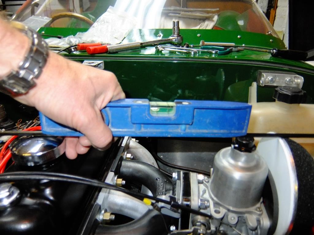

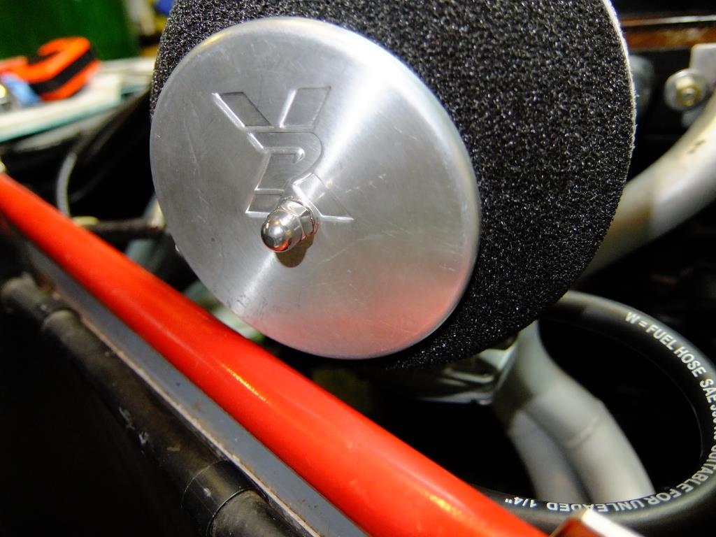

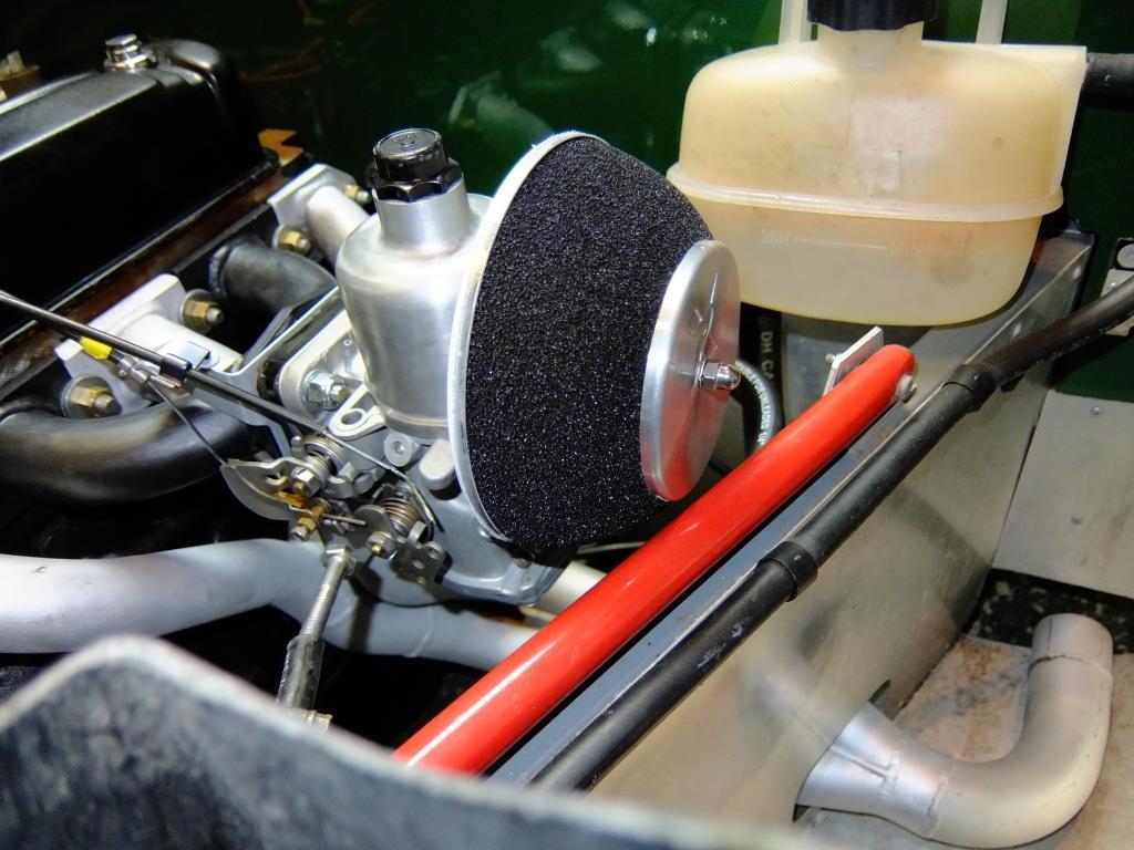

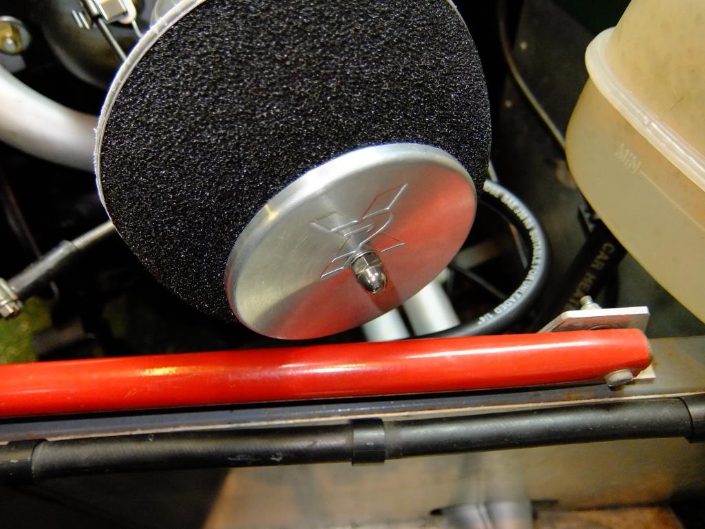

I've been tied up, what with an impending house move and conversion course. However, I have persevered and I present to you the Maniflow Westfield XI custom manifold with Pipercross filter. A K&N cone should also fit, but I haven't tried it.
Pics tell the story. Exhaust will be bolted on tomorrow. Bloody hell, it's getting close and I hope it works!!

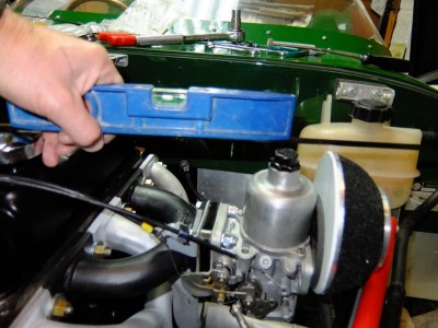

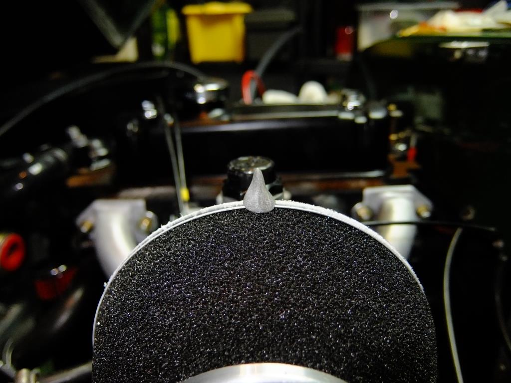

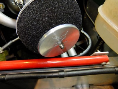

The filter foam needs to come of if I'm to use the extending bonnet stay. It's a minor detail...
I think I have around 15mm clearance. My blu-tac telltale certainly didn't get squished!
There is also sufficient clearance from the abutment place and manifold.
Top tip - assemble the carb to the inlet manifold first, then install. Saves a lot of fiddly work. I also used a 10mm heatshrink on the bolts to make then snug with some compliance through the inlet and carb mounting holes.
