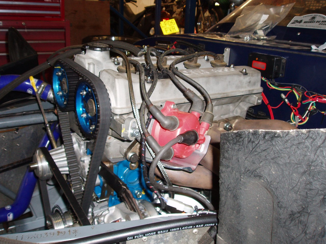

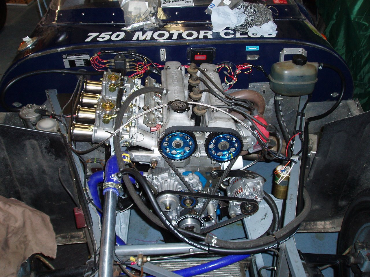

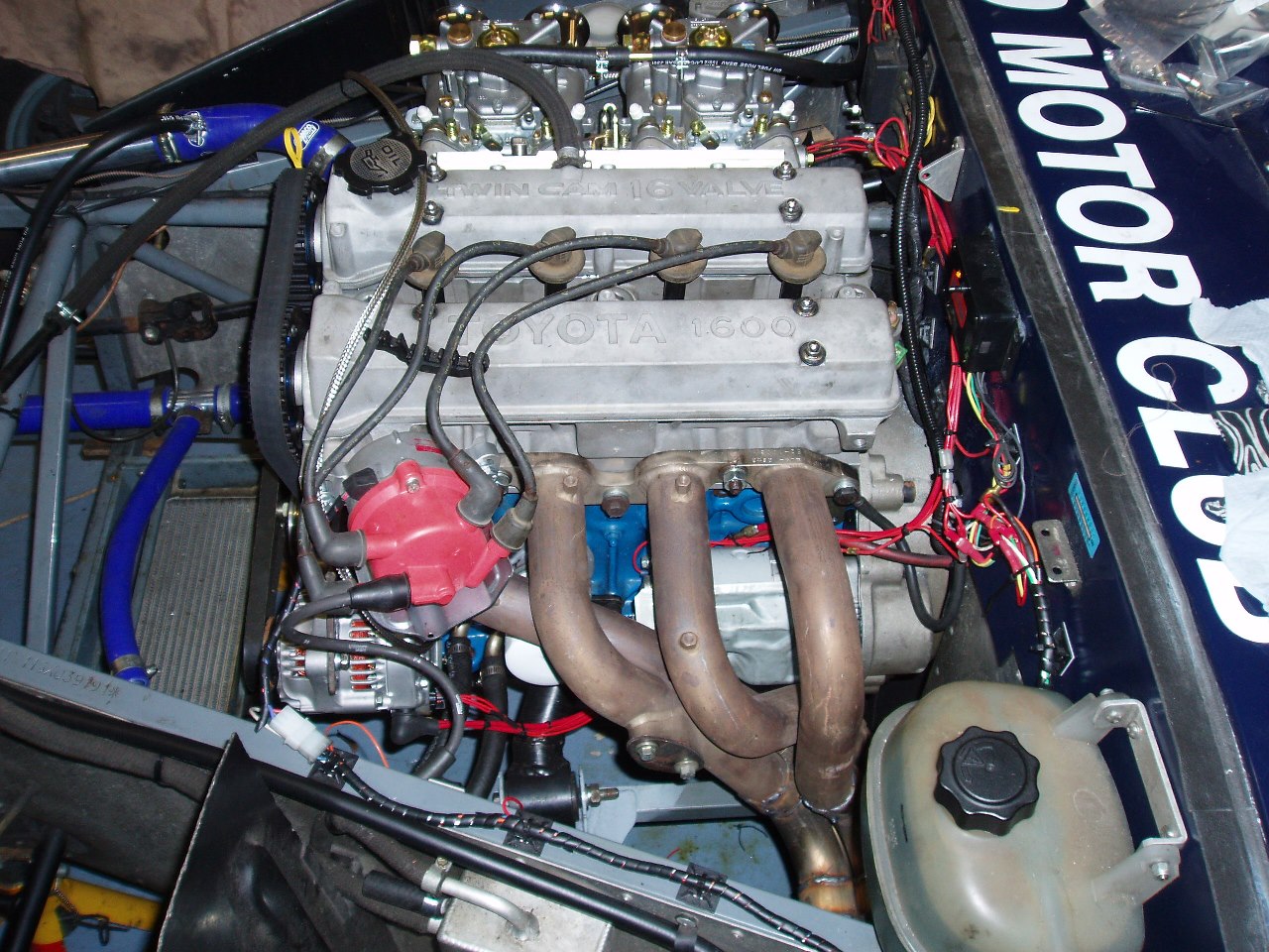

[attachment=0]P1010088.JPG[/attachment][attachment=0]P1010088.JPG[/attachment][attachment=1]P1010087.JPG[/attachment][attachment=2]P1010086.JPG[/attachment]
Latest pics of the installation. Sorry Jack - didn't get one with the bonnet on. Will try to do so. Highest point is the oil filler but I plan to use a spare cam cover without the oil filler on the engine and then utilise one of the cylinder head screw in core plugs (that goes through to oil gallery) the as an oil filler / extra breather. That should ensure the XV bulge clears OK. MoT booked for Thursday first thing.

That looks really neat!!

Excellent work, Charles!
Good luck with the MOT.

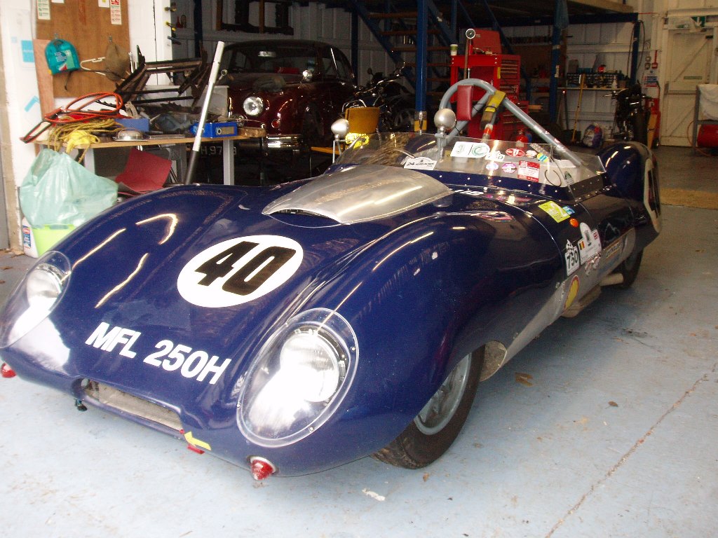

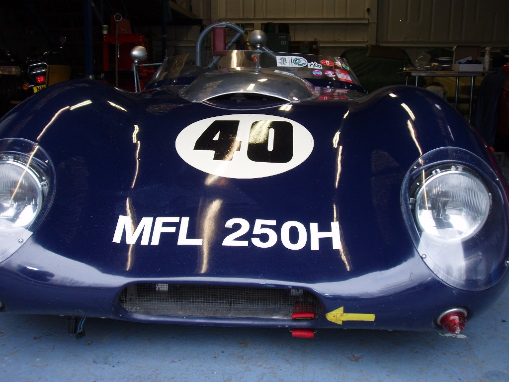

[attachment=0]P1010093.JPG[/attachment][attachment=1]P1010091.JPG[/attachment]
Another 40 mins of road work completed without incident. Should be ready now for being ragged on the rolling road! Also fitted the Malc made XV type bulge sourced via Ben. Apologies for lopping off the front three inches Malc but figured I need the airflow, as per later XV's. Wiring the edge was beyond me but at least it ifs folded over! Having cut out the bonnet beneath the ally bulge I also needed to stiffen the trailing edge of the bonnet so a nice piece of high tech cellulose composite (birch ply!) epoxied in place about 70 mm forward from the scuttle. Really needed that before I modified it as the the rear edge always lifted at speed.
