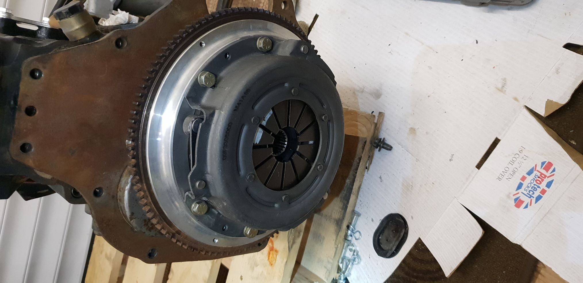

Its been a few days since a posted a photo so....
Clutch and flywheel before the gearbox goes on.
[attachment=0]clutch.jpg[/attachment]

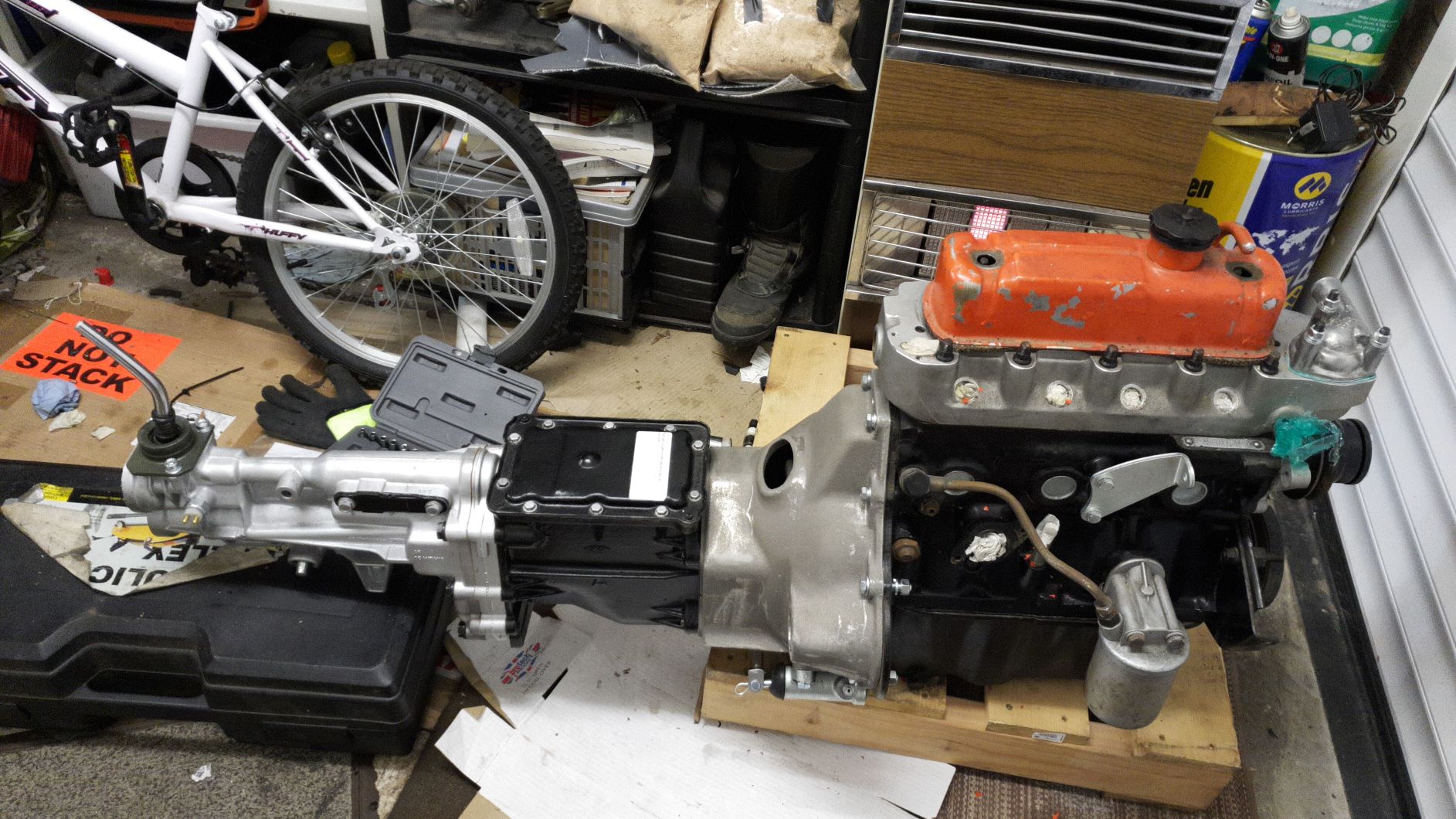

Post by zei220 »
and the completed unit.... just need to finish the wiring and then it can go in.
[attachment=0]engine and box.jpeg[/attachment]
