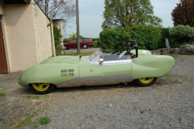

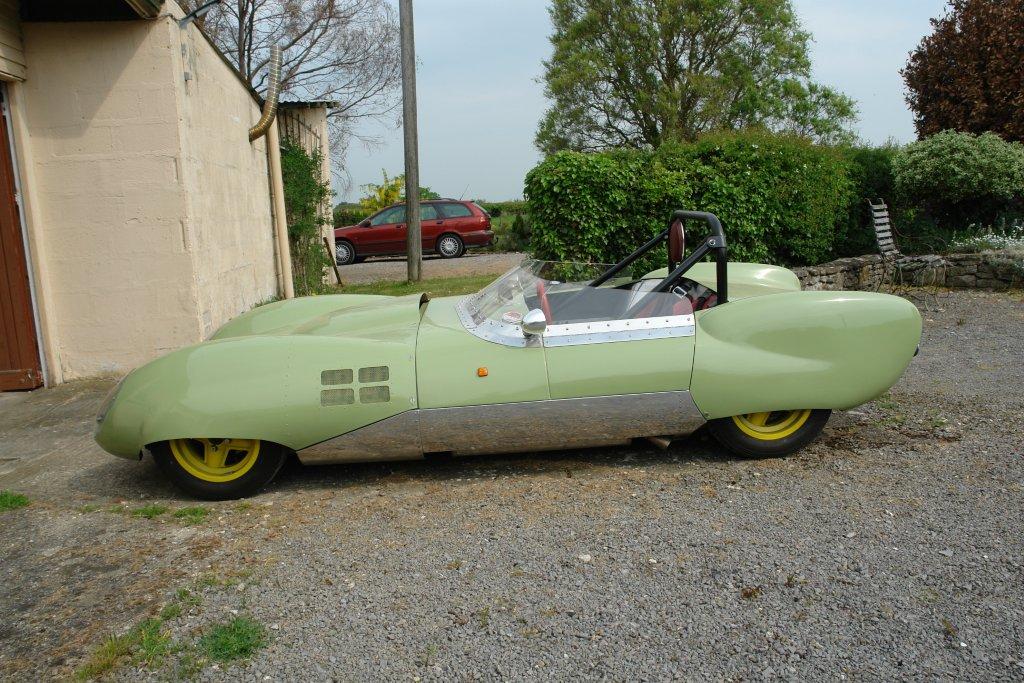

I have an eleven which is not a westfield, its a lot nearer to a Lotus Eleven, it has a bonnet bulge similar to the eleven which ran a twincam FPF Climax. I did the bulge to get a CVH engine in, with nothing below the chassis a clean sheeted in underside. The bonnet bulge may not look quite as neat, but it has some advantages, It lets the heat out of the engine bay very well, adds strenght to an otherwise floppy bonnet. I have an A series in my eleven at the moment.

Is that you Malc (allymally)?
- Posts: 317
Re: K Series replacement
Allymally, very interesting car that! Quite different shape to the westy body with longer rear wing sections and it looks like some difference around the headlamp fairing too? I see from the tax disc, it's not just a track weapon. Yes v interesting! Any more pics (inc under the skin, unless you don't want your racing competitiors seeing under there ) to share?
