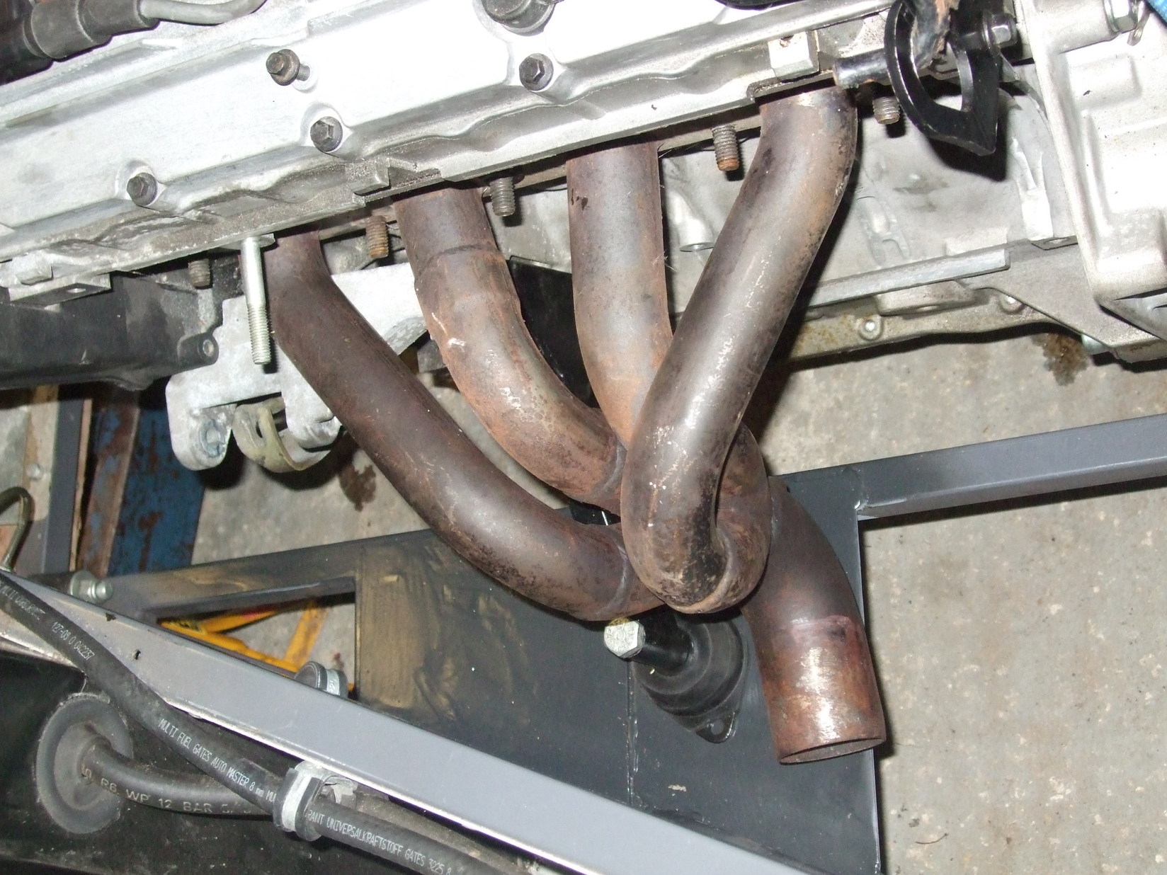

Photos of sawn-off original engine mounts. The ali cage thing on the RHS of the engine is to house the Titan dry sump pump which I've sent off to be serviced as all I know about it was that it came from an ex-race Caterham, or at least that's what the chap I bought it from said
[attachment=0]DSCF4035.jpg[/attachment]

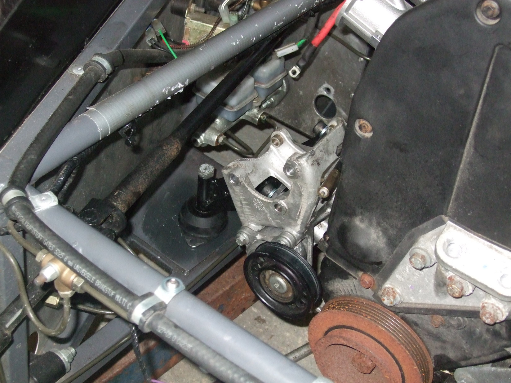

LHS engine mount with engine using Caterham K Series brackets and standard Caterham K series exhaust manifold which isn't a million miles away from where it needs to be. I reckon if I get the hacksaw on the Westfield A series manifold then I may be able to make a thing of functional beauty.
[attachment=2]DSCF4037.jpg[/attachment]

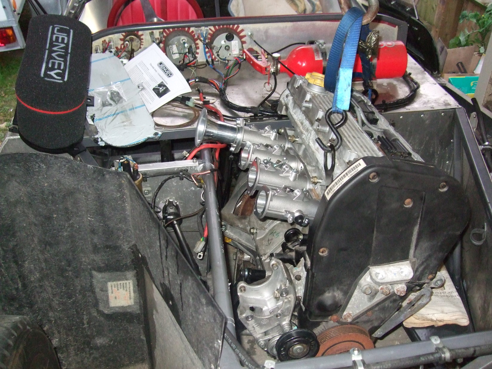

Engine is in place but nothing is fixed
[attachment=1]DSCF4033.jpg[/attachment]

Here with brief update following recent motivation to attend Le Man Classic this year with some friends..
I've realised I'm going to have to bolt all the ancillaries on to work out the exact best position for the engine so next job is .. get all the ancillaries bolted on including;
water circuit
alternator
fueling circuit
remote oil filter
Throttle bodies
I've got my reconditioned dry sump pump back from titian motorsport plus a massive dry sump oil tank (it's huge and will have to live behind the driver's side front splash guard).
Emarald seems to have extended the parts they now supply so am going to them for fueling circuit parts (HP pump, filter, swirl pot) as well as the ECU.
Re power output, I'll be happy with a strong 160 hp. As many of you I'm know the emerald ecu has a function to switch the ecu map to one of three settings so I'm going to have something like, standard 1275 A series, tuned A series and full bore K series. Basically like a slow, medium fast spin speed on a new washing machine which is probably what it will feel like.
water circuit
alternator
fueling circuit
remote oil filter
Throttle bodies
