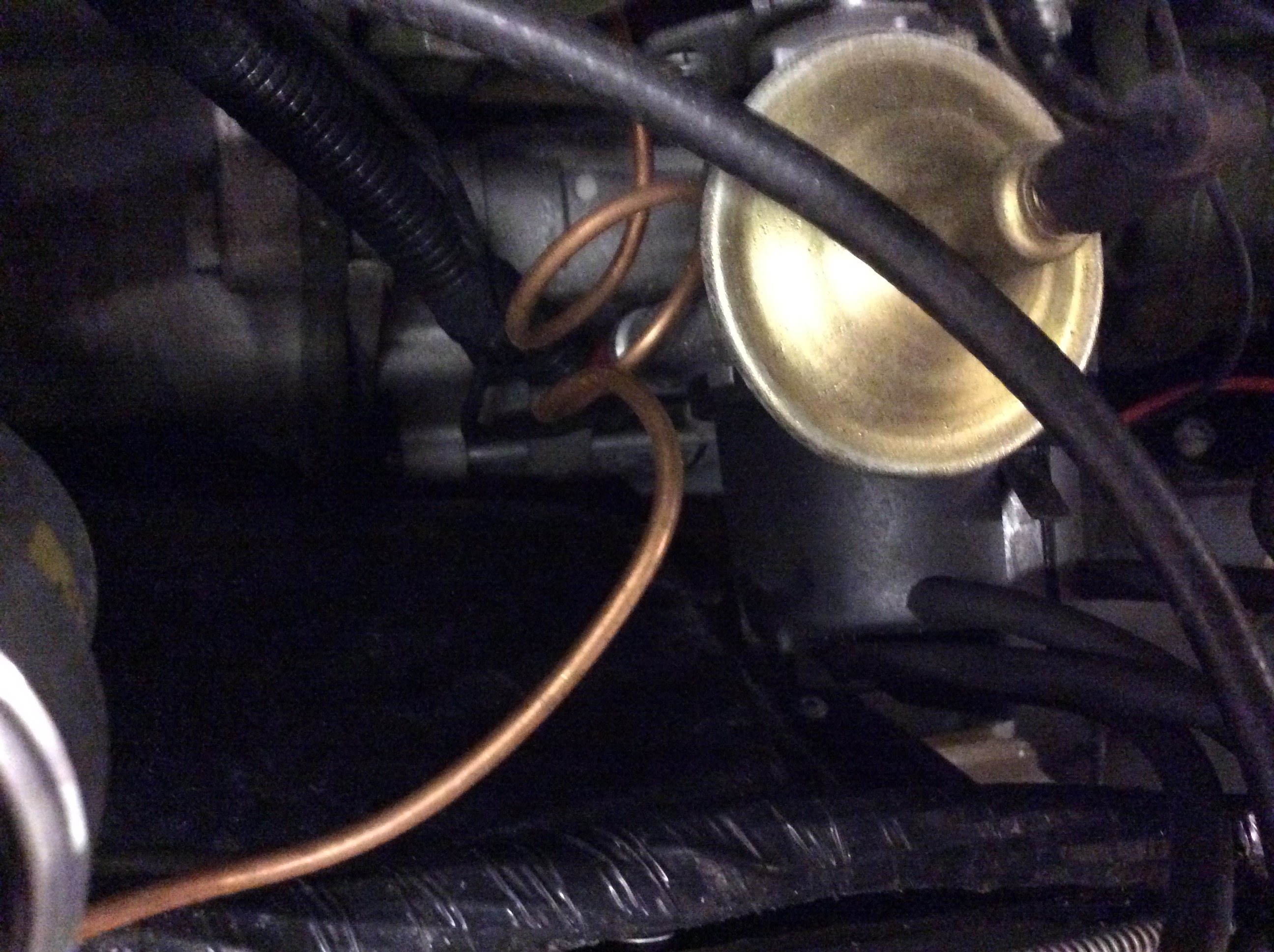

I have been drooping the engine in and out of my build trying to work out what needed grinding on the bellhouse, engine back plate finally sorted that out but discovered that I had to install the distributor on the block before fitting the engine so I did that but now it seems like there is no room for the dizzy cap to fit and I am going to have to hack into the plastic footwell panel to give me half a chance ( still not convinced there will be enough space even after cutting). I have a low level side entrance cap but I reckon I need at least another half inch even get the engine in with the cap and dizzy in place. I am planning to cut away the plastic where it bulges out under the cable tie in the picture and then put a remodelled cover patch back. How have others managed during their builds? ( I have seen Jon had troubles in the past with a close fit)

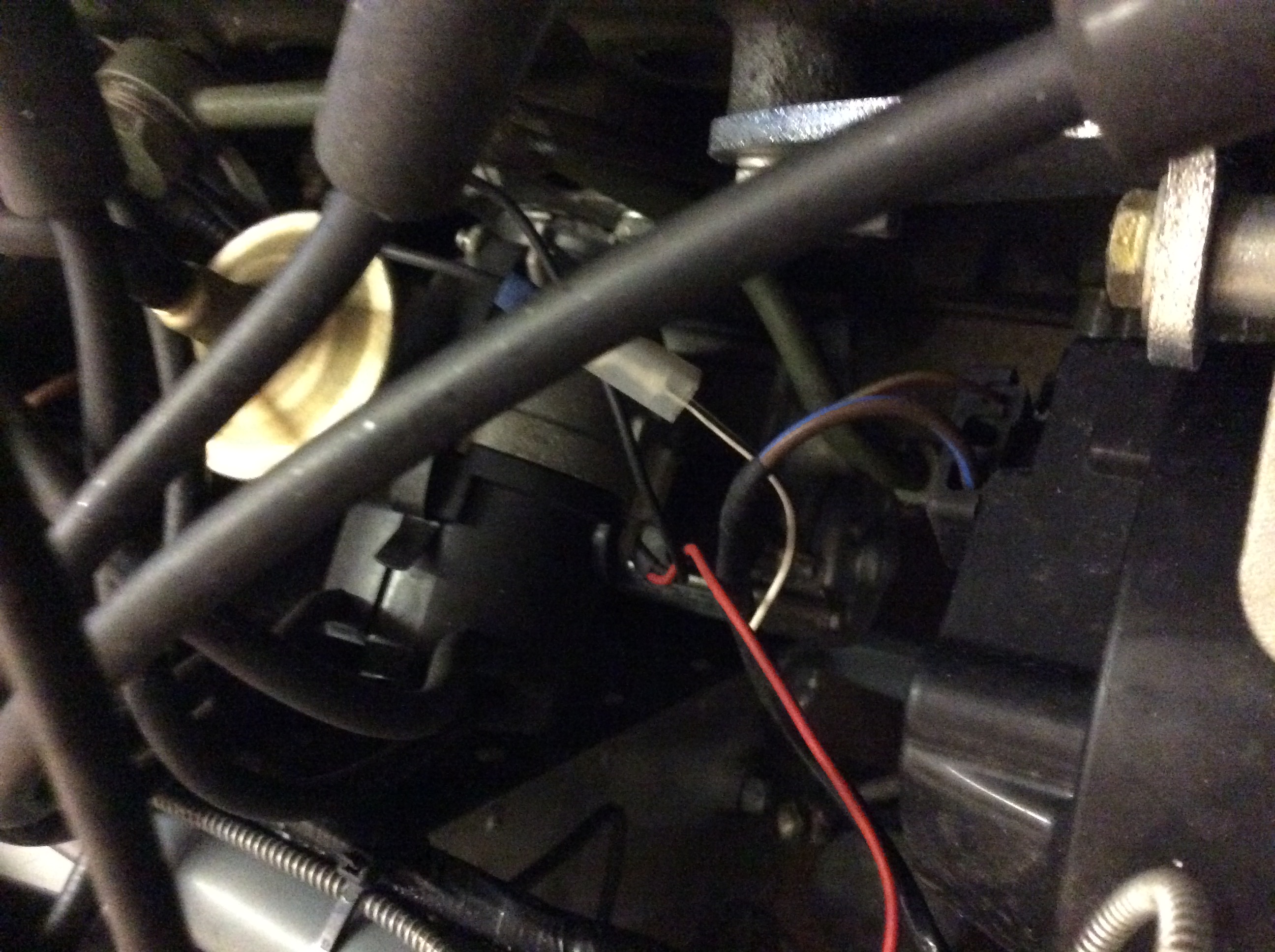

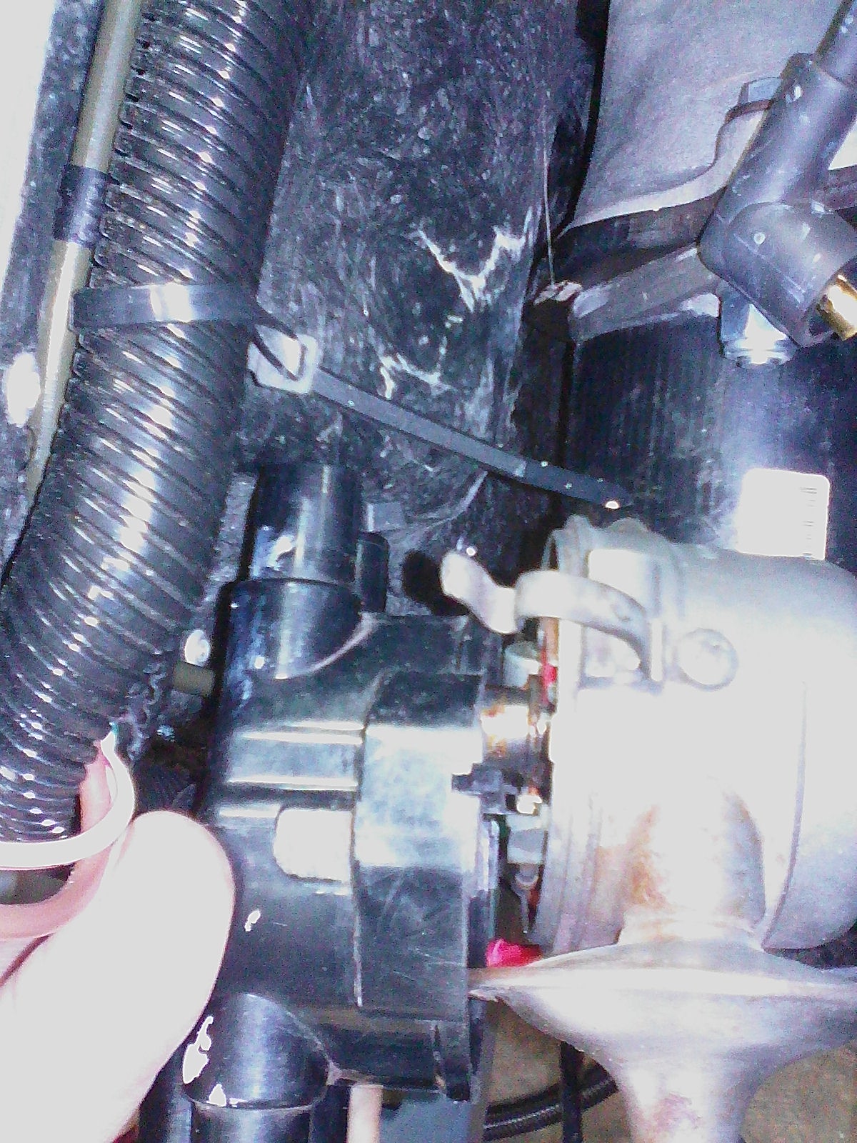

Do you want a pic of mine we moved engine forward slightly

This is mine but as I said my engine has been moved forward a smidge

looks like you managed without cutting the footwell but your cap is different with the leads out one side where as I have leads out both sides ( looks like mine is from a montego or something ). how tall is your cap ? If yours is taller than mine I don't think I have the space but if it is the same or lower than you have found the solution and I won't have to start cutting again.

looking at it again it might be better to re-order the leads on the cap shifting them one place so the body of the dizzy is 90deg different and my leads come out top/bottom not side/side as current. It looks like the "one side" entry caps are taller and I don't think I have the space I certainly can't get the dizzy out with the engine in place (my brake pipe routing turns out to be "unfortunate" and takes up space that it turns out you need) and i can't yet work out how to put the cap on with the rotor on and i can't get the rotor on with the cap on so it will be cap in place and dizzy in before the install and engine out for any ignition work.

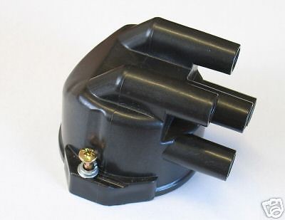

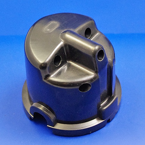

That's the wrong dizzy cap! The distributor body should drop into its hole when the engine is in place, but not with it's cap on. The cap then clips into place with no modification of the footwell side wall, albeit with only about 10mm clearance and can then be rotated to the correct orientation. The correct Midget cap has all five leads exiting on one side only. Looking at your first post, it appears that you have a 45D distributor (the later type) and need one of these:
http://www.ebay.co.uk/itm/Classic-Mini- ... SwLN5Wl5Zp
As the seller states, you discard the securing screws and use the original spring-clips to secure it. It'll fit straight on instead of what you have and should cure your woes with no further work required.........
Depending on the model of dizzy you have, you need a cap like either of these two:
[attachment=1]image.jpg[/attachment]
[attachment=0]image.jpg[/attachment]
Early dizzy, screw-fit leads
Later dizzy, push-fit leads
