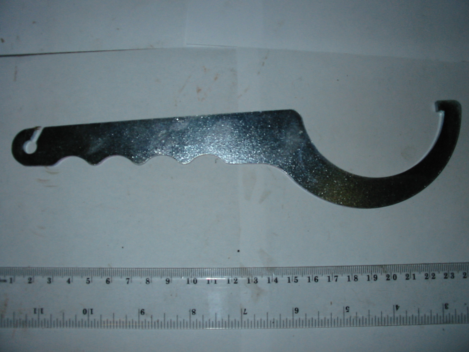

What size C spanner do I need to borrow/buy from eBay to fit the standard factory Spax dampers, please?

Which damper diameter? SPAX will have the information on their site. If you order SPAX or AVO, you can have the wrench sent along with the order.

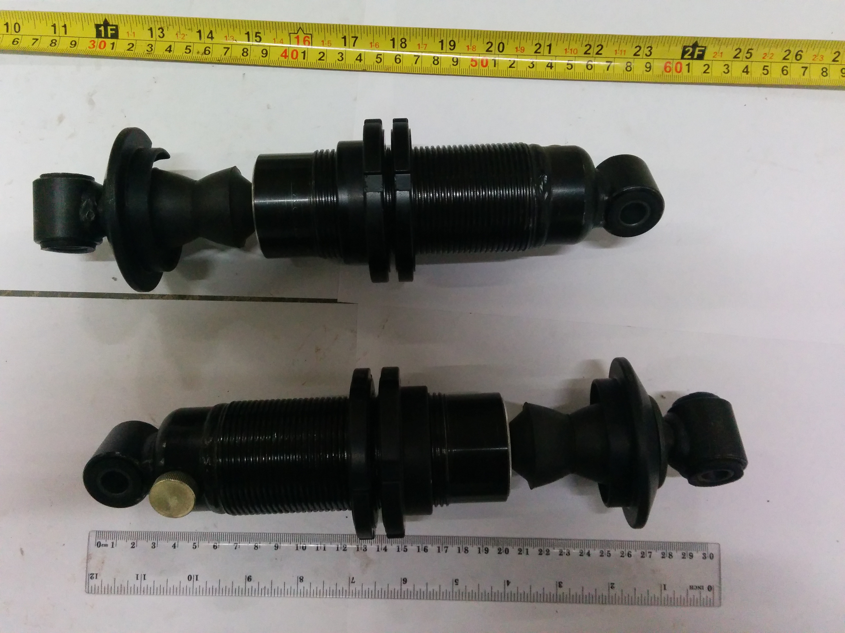

Yes, the knob adjusts the stiffness, and the twin rings the height.

The 2007 I had here had GAZ dampers. 2.25" spring front, 1.9" rear. There are only two diameters of dampers that would fit.
The same wrench fits both. Order the wrench by spring diameter. OK, no two word answer, but... You need a wrench for a damper that takes a 1.9" to 2.25" spring collar. Should be the same size. It is with my SPAX and the GAZ. I use the same C wrench for both. One is a full "C", the other is a half moon. Both fit.
ORDER YOUR WRENCH BY SPRING DIAMETER. The hats and the collars are all standard. Any damper supplier can supply you with what you need if you tell then what damper you are using. SPAX, AVO, Protech, GAZ, Carrera, Koni, Bilstein, all the same.
One thing to think about. If you raise the ride height more than 5" up front, and 6.5" in the rear, the dampers will "top", hitting the top, fully extended stops This will make a nice "clunk, clunk" as you go down the road, and make the ride absolutely horrible.
"Been there done that". Go with the longer dampers from the early car, and you can get a useful ride height, better ride, and mpre predictable handling. AND, you probably only need two dampers, and maybe one set of springs... maybe not. The hats for a 2.25 spring will fit a 1.9" spring damper.
