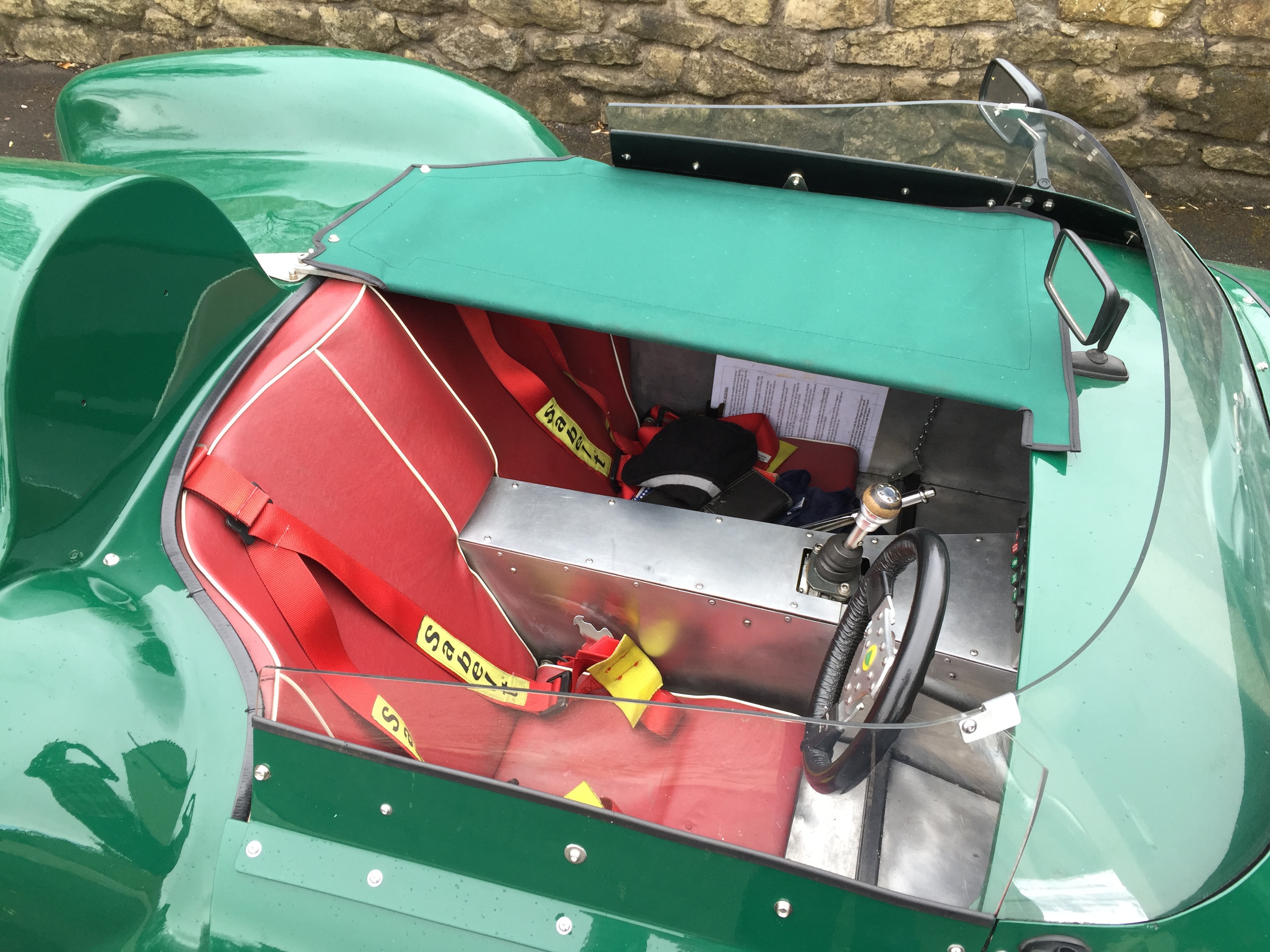

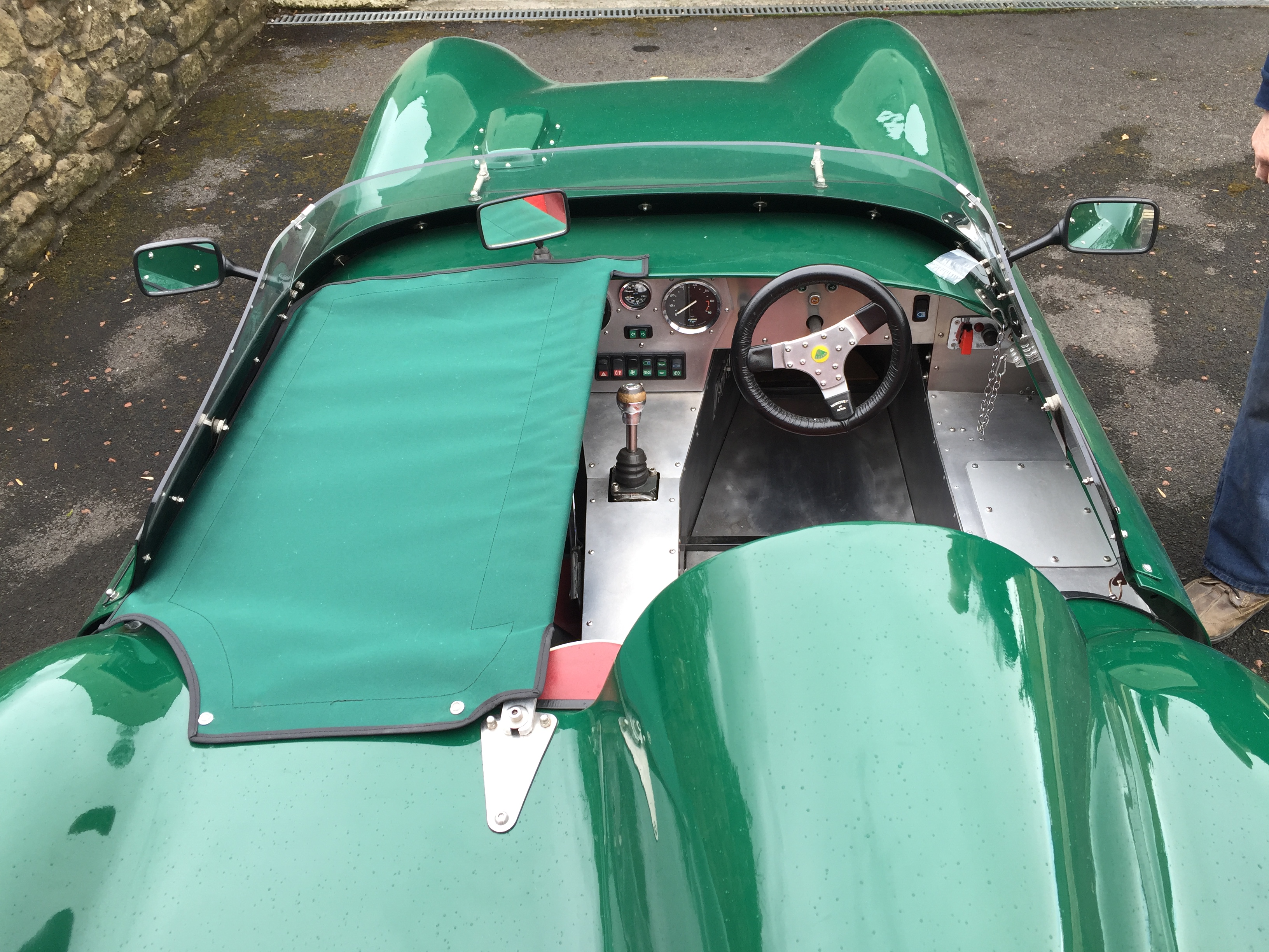

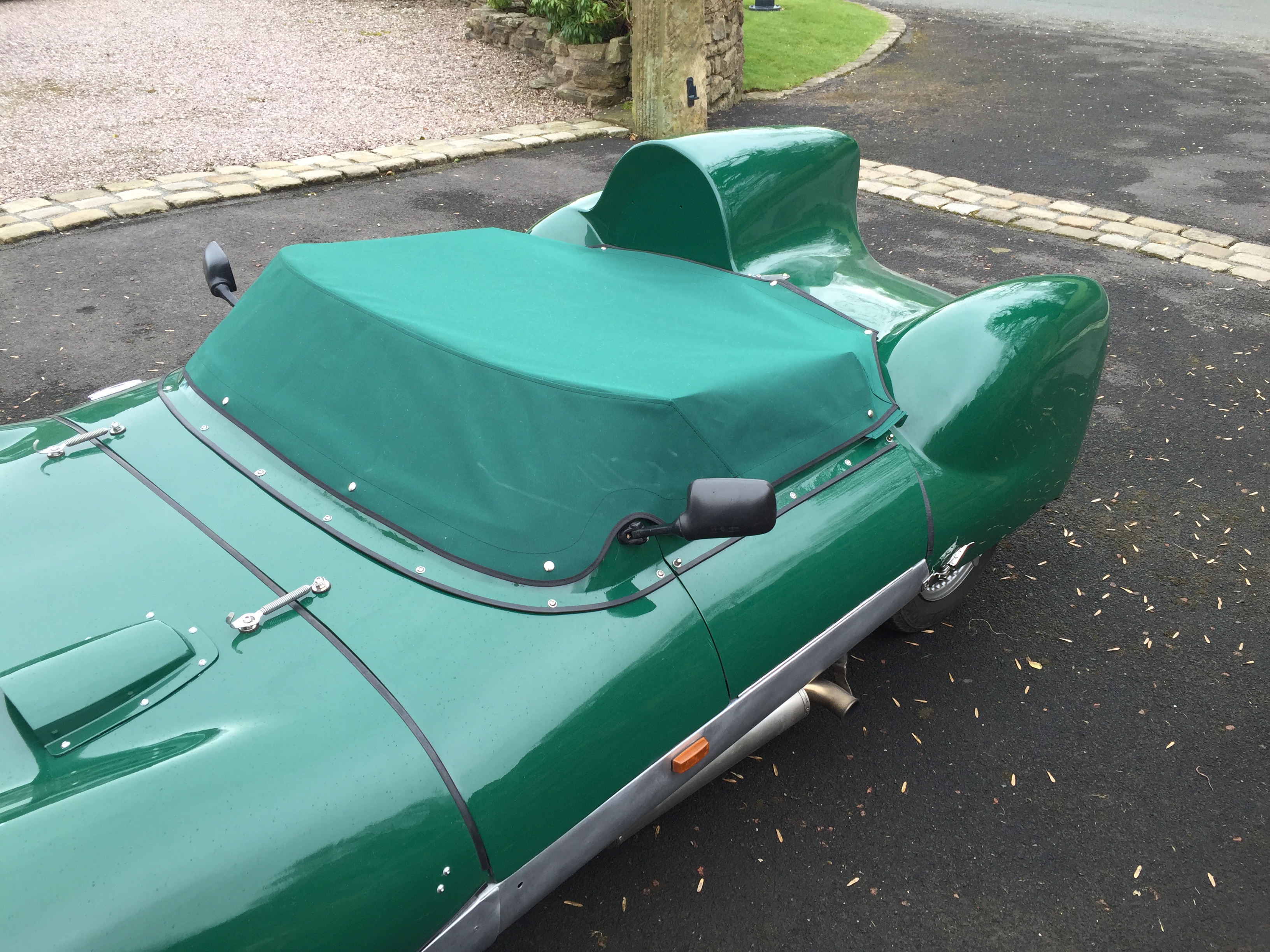

[attachment=0]IMG_2740.JPG[/attachment][attachment=1]IMG_2739.JPG[/attachment][attachment=2]IMG_2734.JPG[/attachment]Here are some photos of the cockpit cover and half tanneau I have had made by a local marine trimmer.
The half tanneua insupported on the inside edge by an aluminium flat bar and will be used most of the time.
The cockpit cover takes no more than a minute to fit and press stud in to place.
The material is a synthetic canvas which has the weave and appearance of a double duck canvas and is used in the making of covers for speed boats and other marine vessels, so is water proof, very durable and suitable for all seasons.
I'm very pleased with all aspects, the apperance, workmanship and price.

very nice. the rear bracket for the mid bar looks especially neat.
