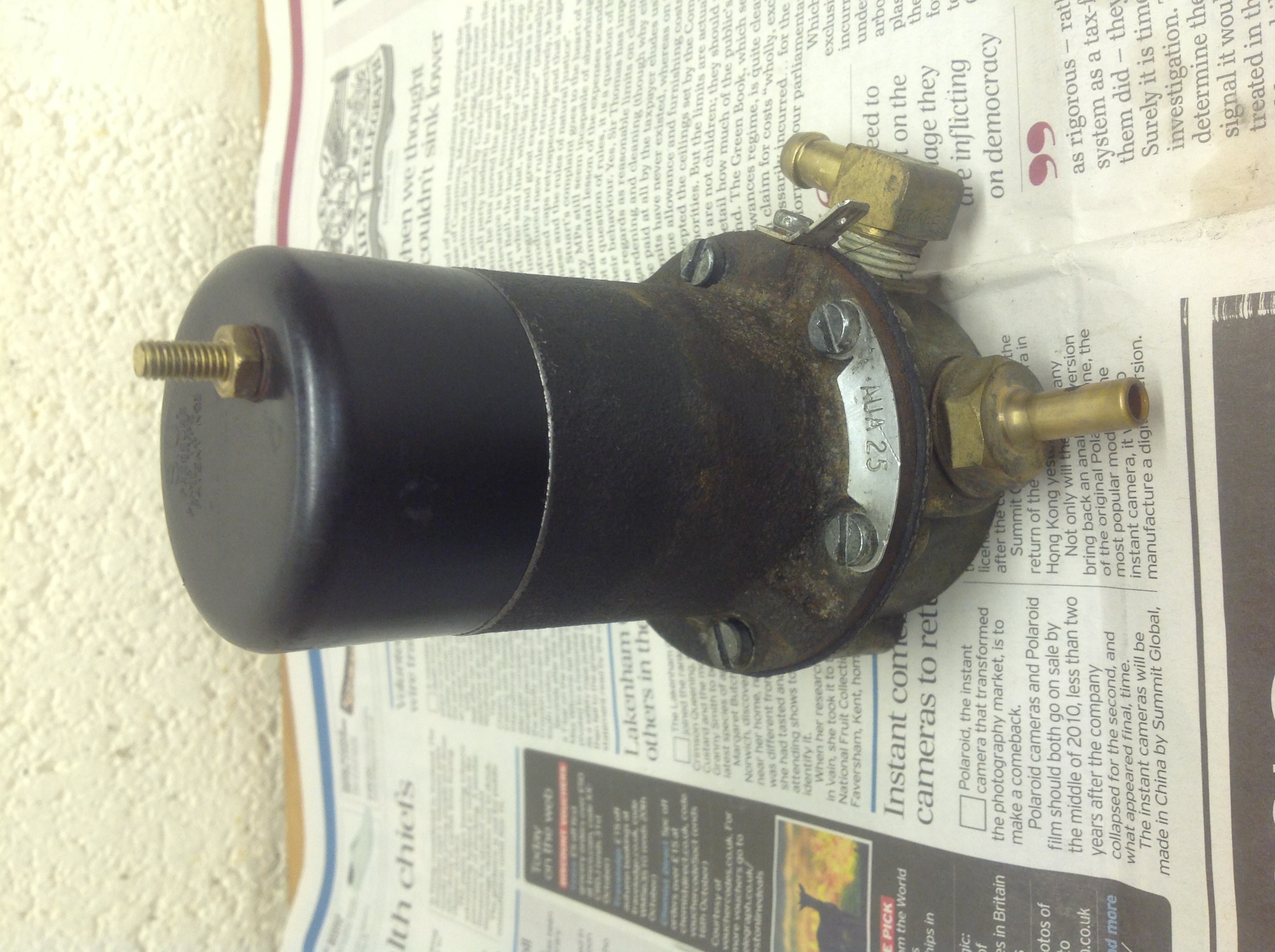

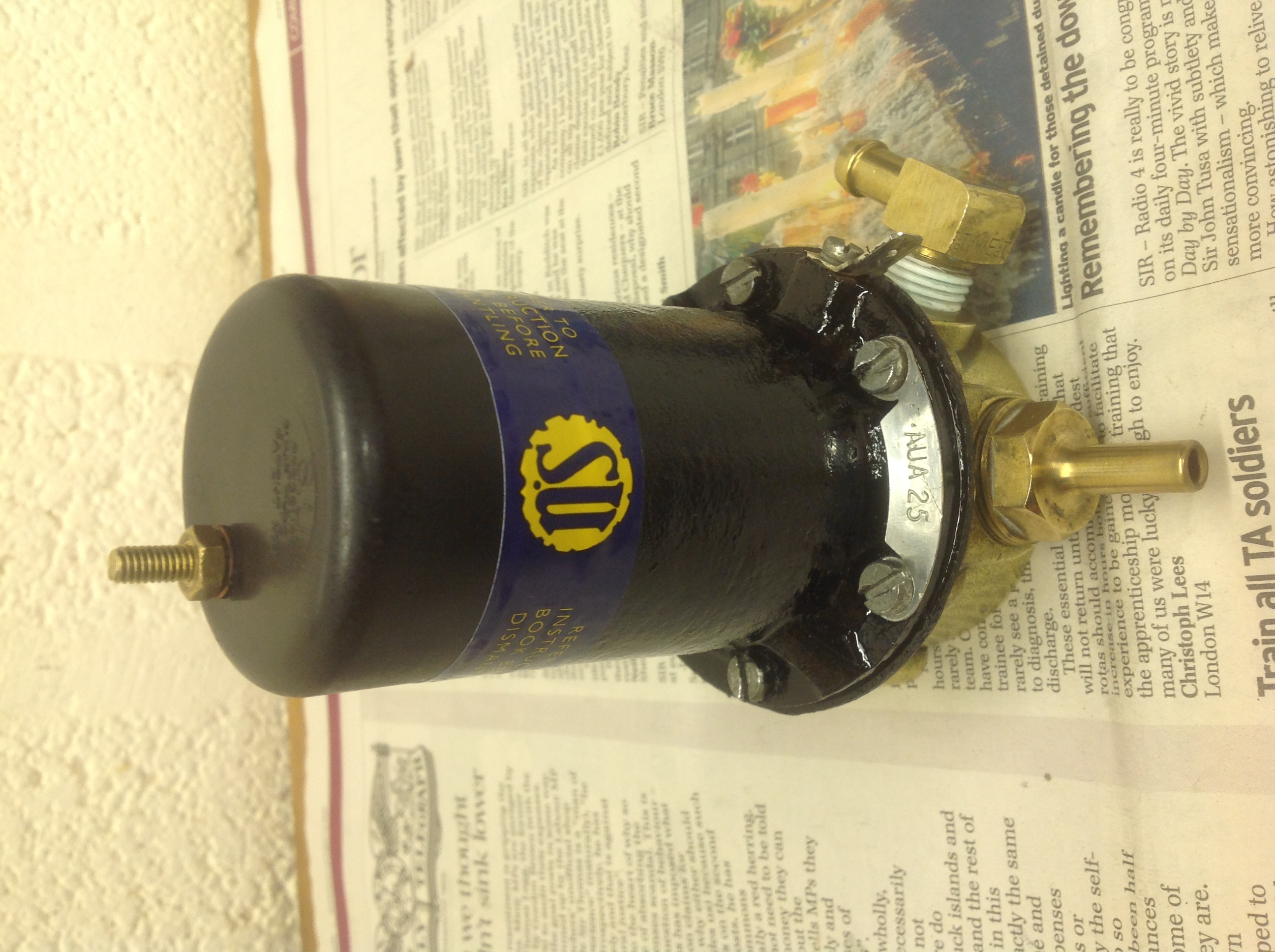

OK! So what's the major difference between the before and after shots of my fuel pump?
- Posts: 462
Re: Misfiring. Suggestions please.....
Yup! It's the +ive terminal.
Notice the chewed screw-heads? Notice the missing SU seal, which serves to waterproof the end cap? Someone's been in here before me.
Notice how, post-rebuild, the terminal is now 180° around? It's attached to the PCB, onto which is also mounted the small coil which, together with the offset magnet on the end of the diaphragm input shaft, forms the electronic "points". Mis-mounted, it would never have worked properly, if at all!
With the PCB correctly mounted, and the Hall shield adjusted, the pump now buzzes like an enraged hornet. I wonder if that's "problem solved" ?
