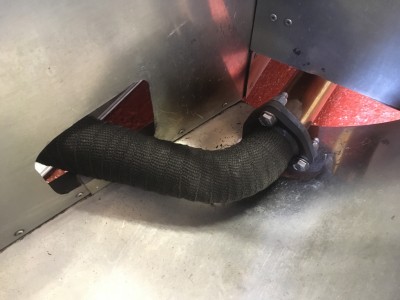

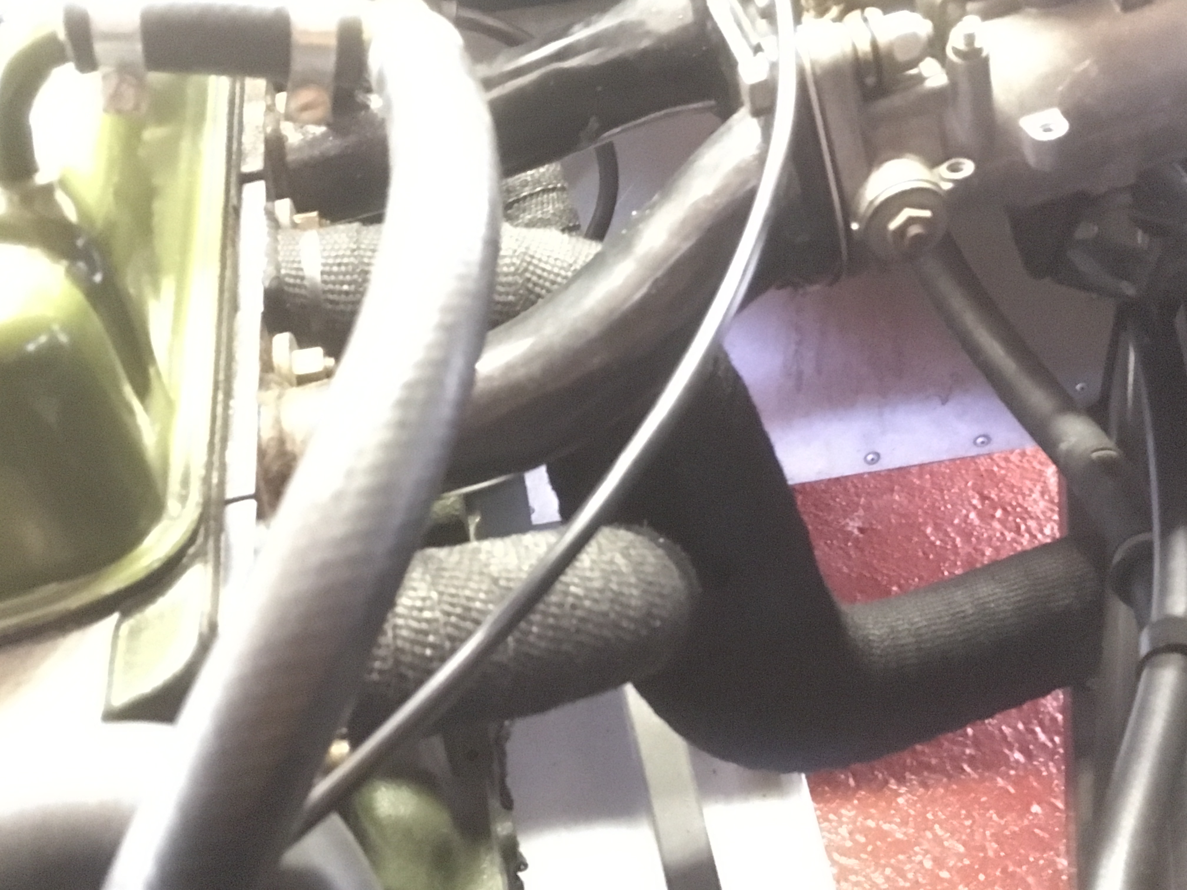

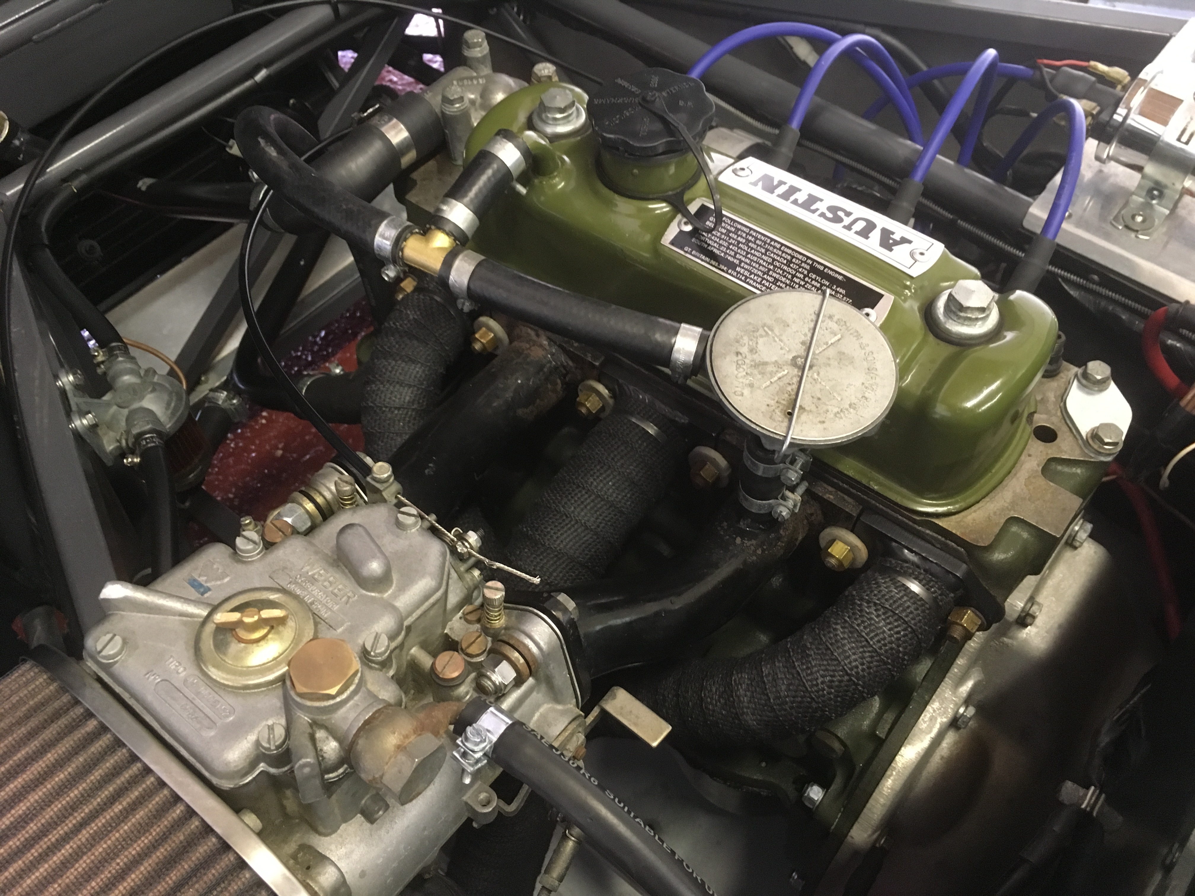

My exhaust manifold is wrapped in Thermotec tape. This is an insulating material made from woven glass fibres (I think). It degrades over time and needs replacing. I first rewrapped the headers when the car was about five years old, noting that the mild steel pipes were gently corroding. When I pulled the engine in August, I noted that the tape needed renewing once again. But on unwrapping the pipes I found that they were now, at ten years old, heavily corroded. They weren't holed and would see out the summer, but would need replacing.

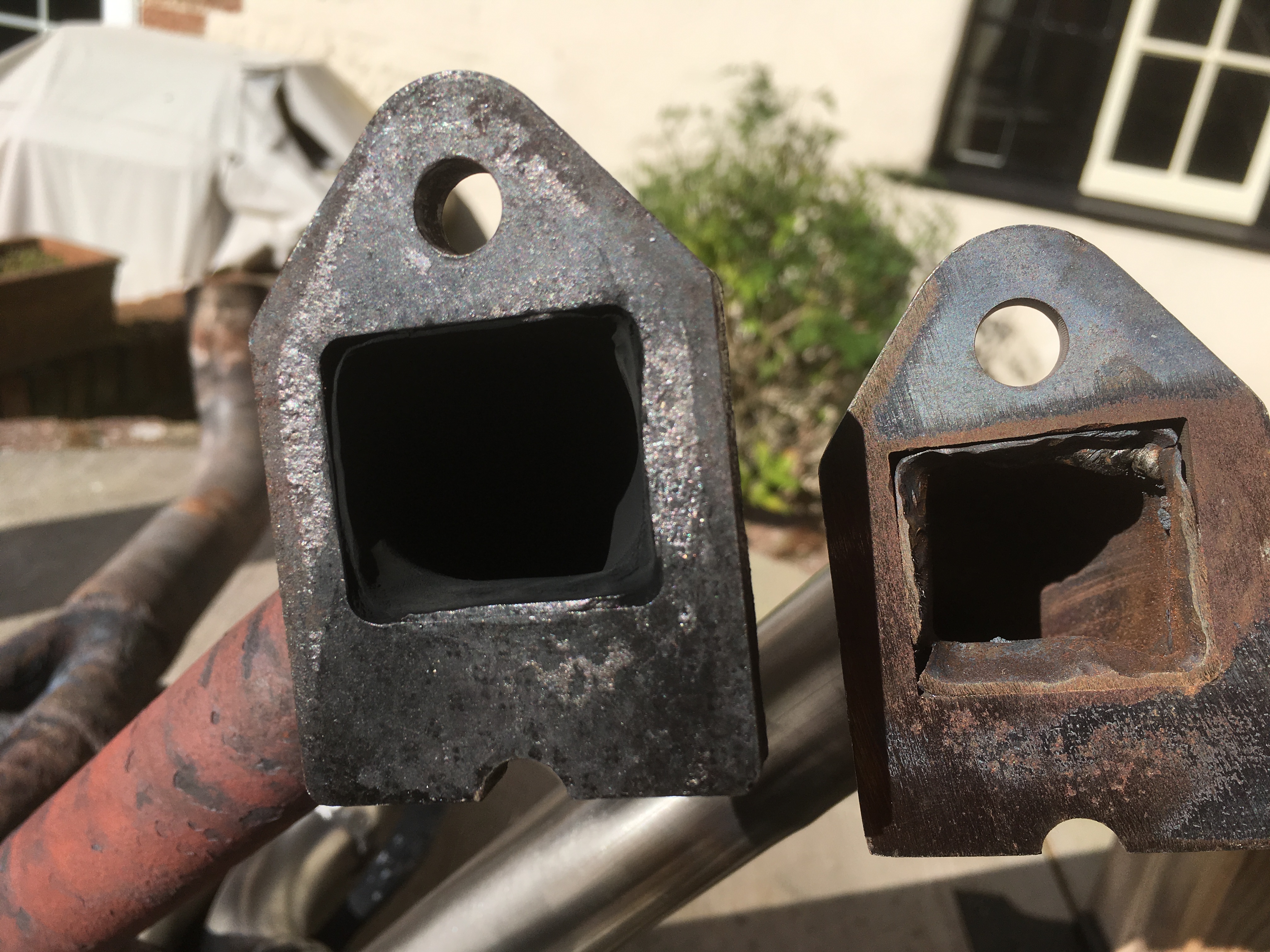

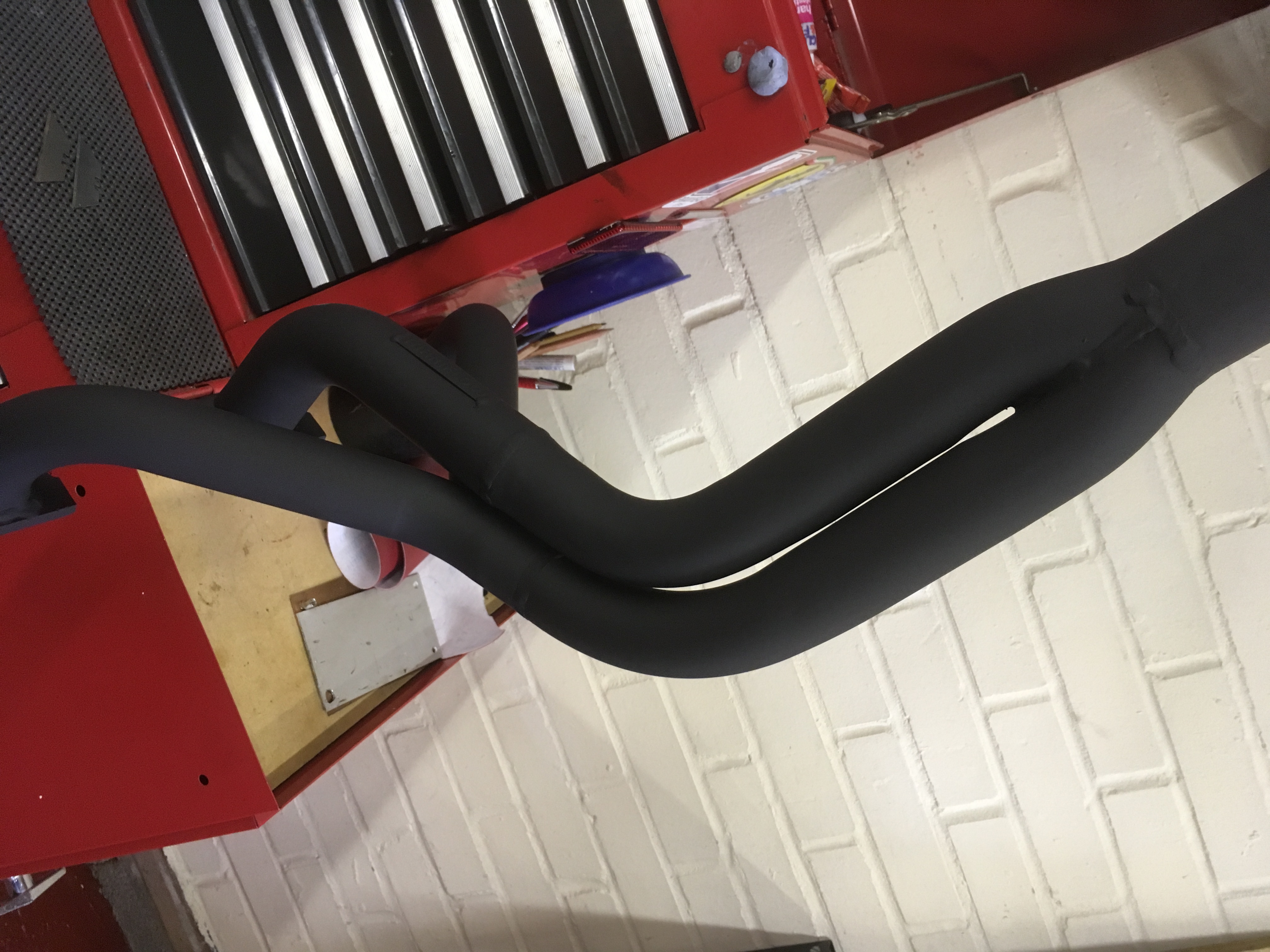

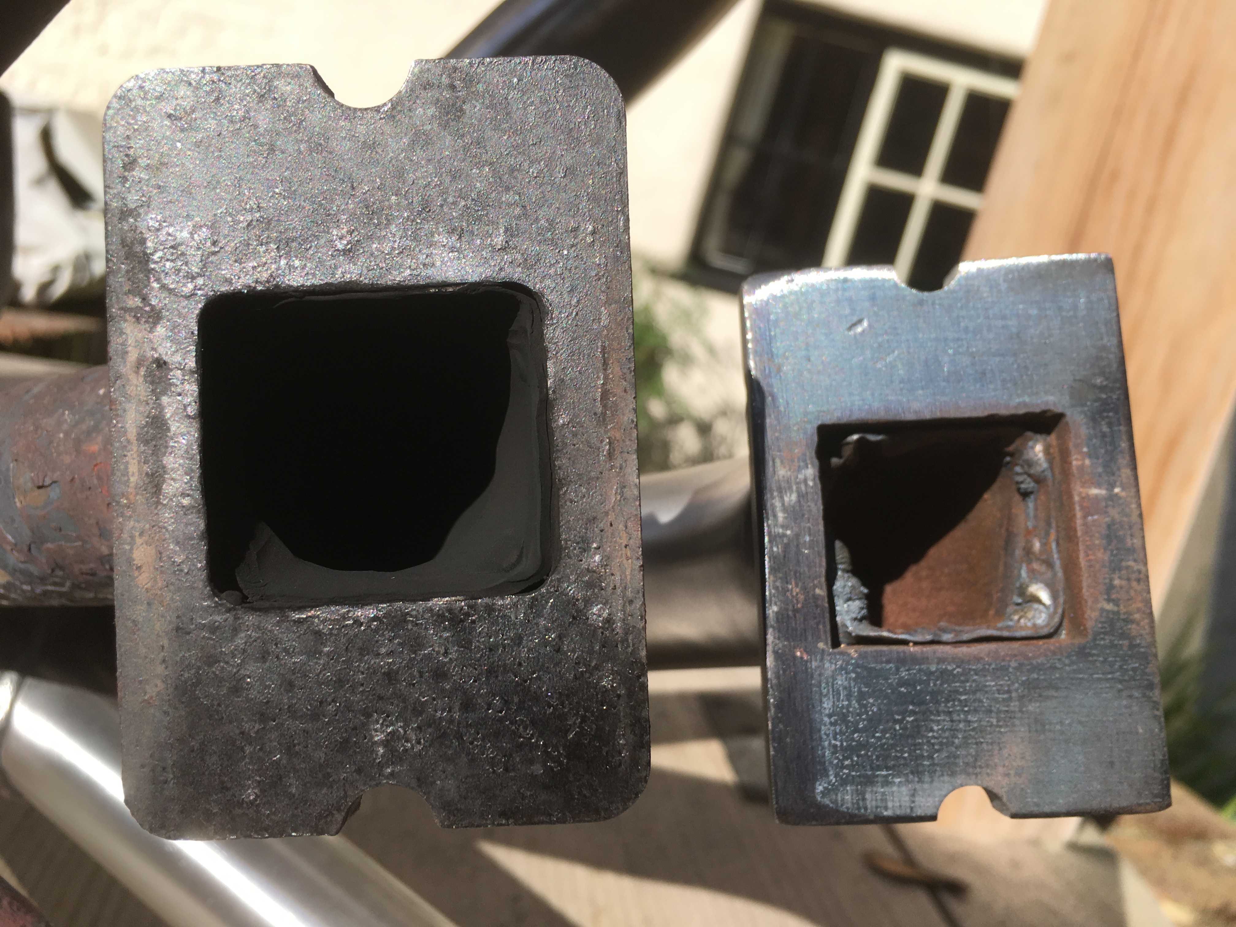

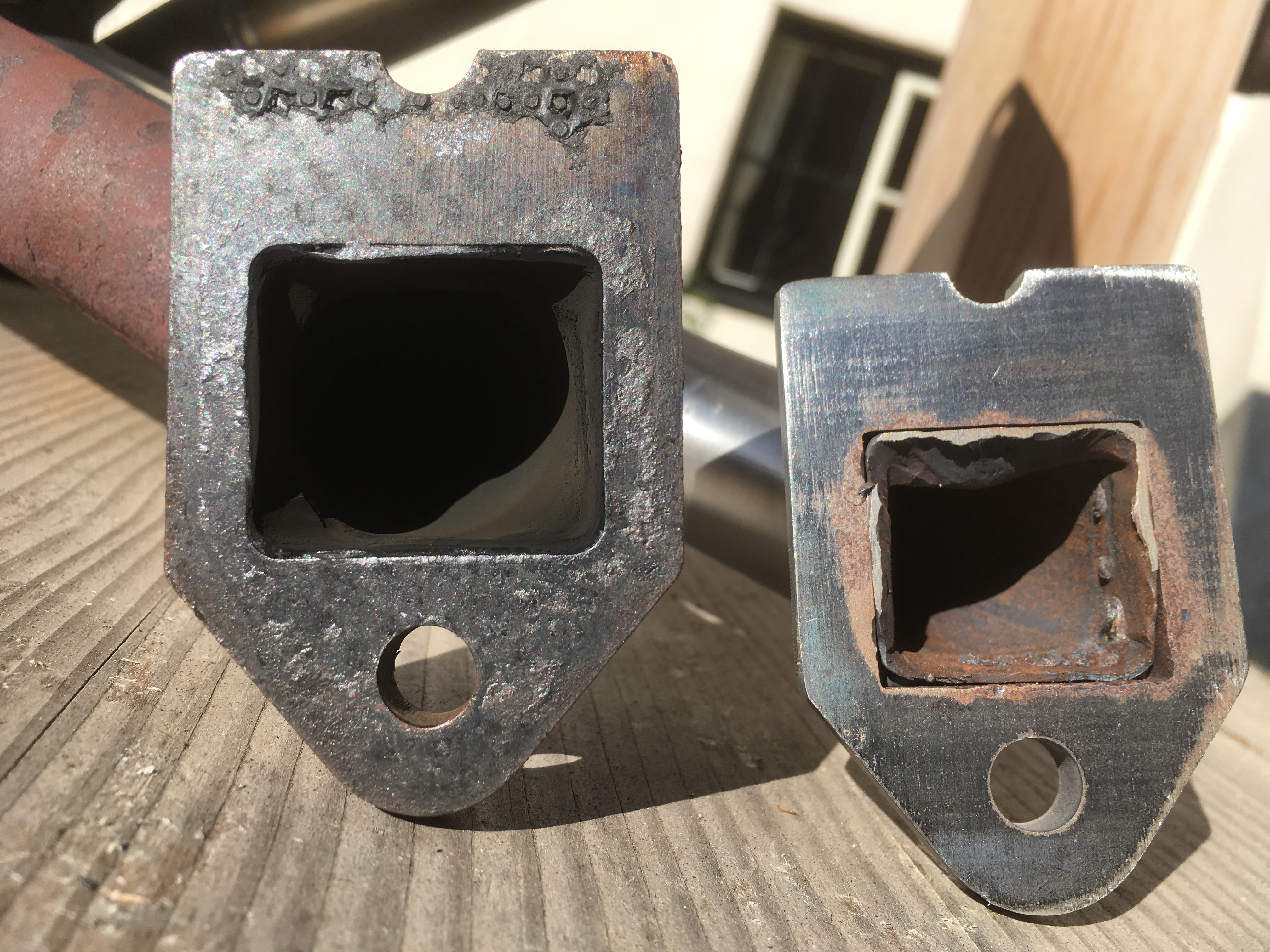

The first thing that I noticed was how light the new manifold was. Sadly I failed to weigh either my old pipes or the new ones, but I'd say that the new pipes were between 25-30% lighter than the old ones. I admit that my first thought was, "Oh good! A useful weight saving." However, it soon dawned on me that the weight reduction could only be the result of a significant reduction of tube-wall thickness and a similar reduction in life span.
I then looked down the pipes.........

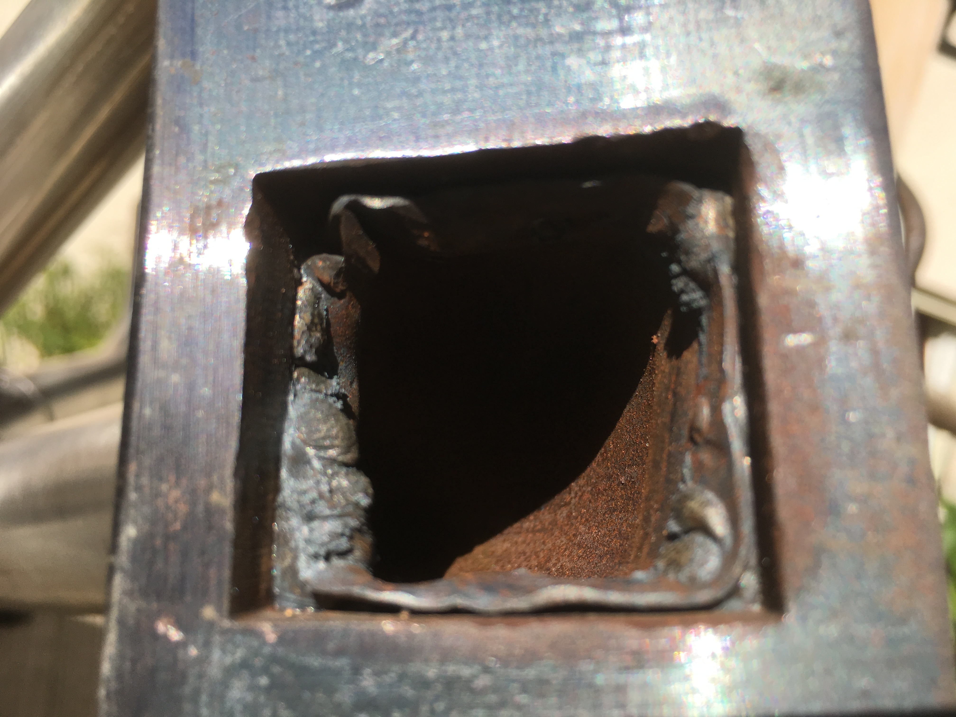

I've written before of the difference in quality between the factory-fabricated parts of my 2006 kit and those parts that I've received since all fabrication was outsourced. The front wishbone that I ordered a couple of years ago was shockingly badly welded. But the new manifold was an absolute joke. I didn't take any photos of the exterior of the system, which I must admit looked good. But here are the bores, alongside my old, corroded pipes (I should point out that my iPhone was held very close to the pipes, with my old system a couple of inches closer to the lens than the new pipes, hence the apparent difference in size!). Tap/click on any photo to see it full size:

Just to be quite clear on this, tap on the following photo to enlarge it to fully appreciate the true horror of this fabrication:

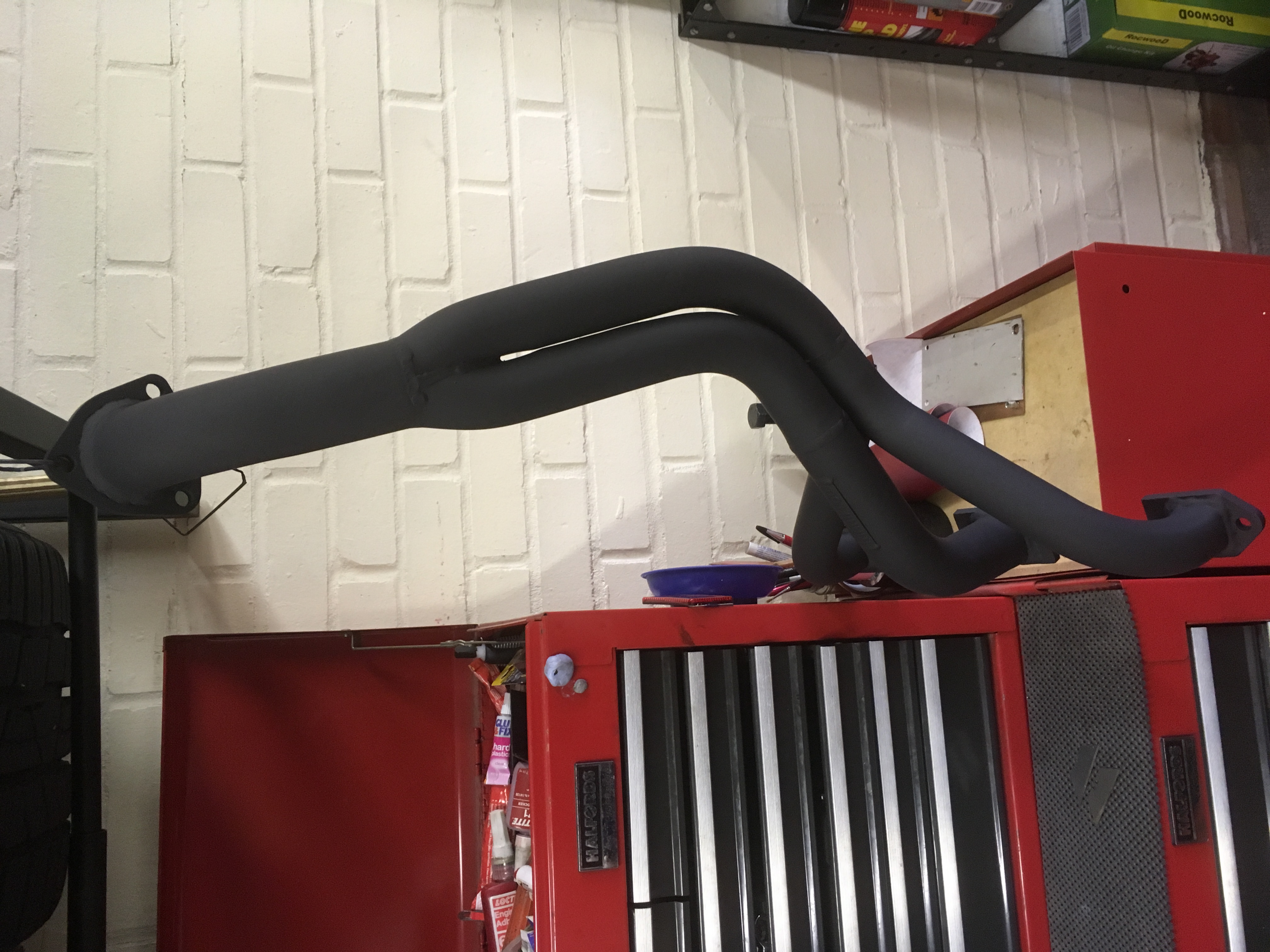

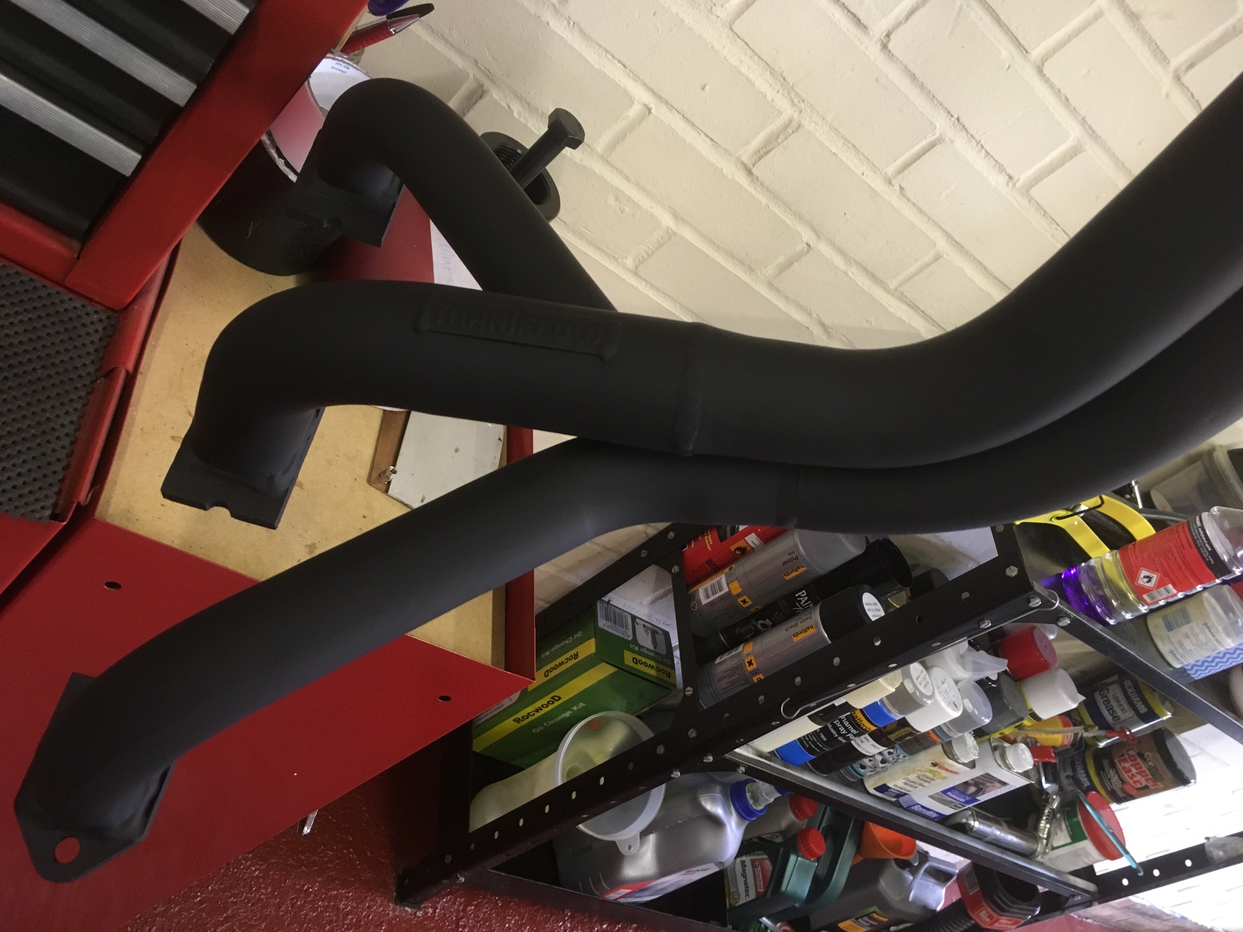

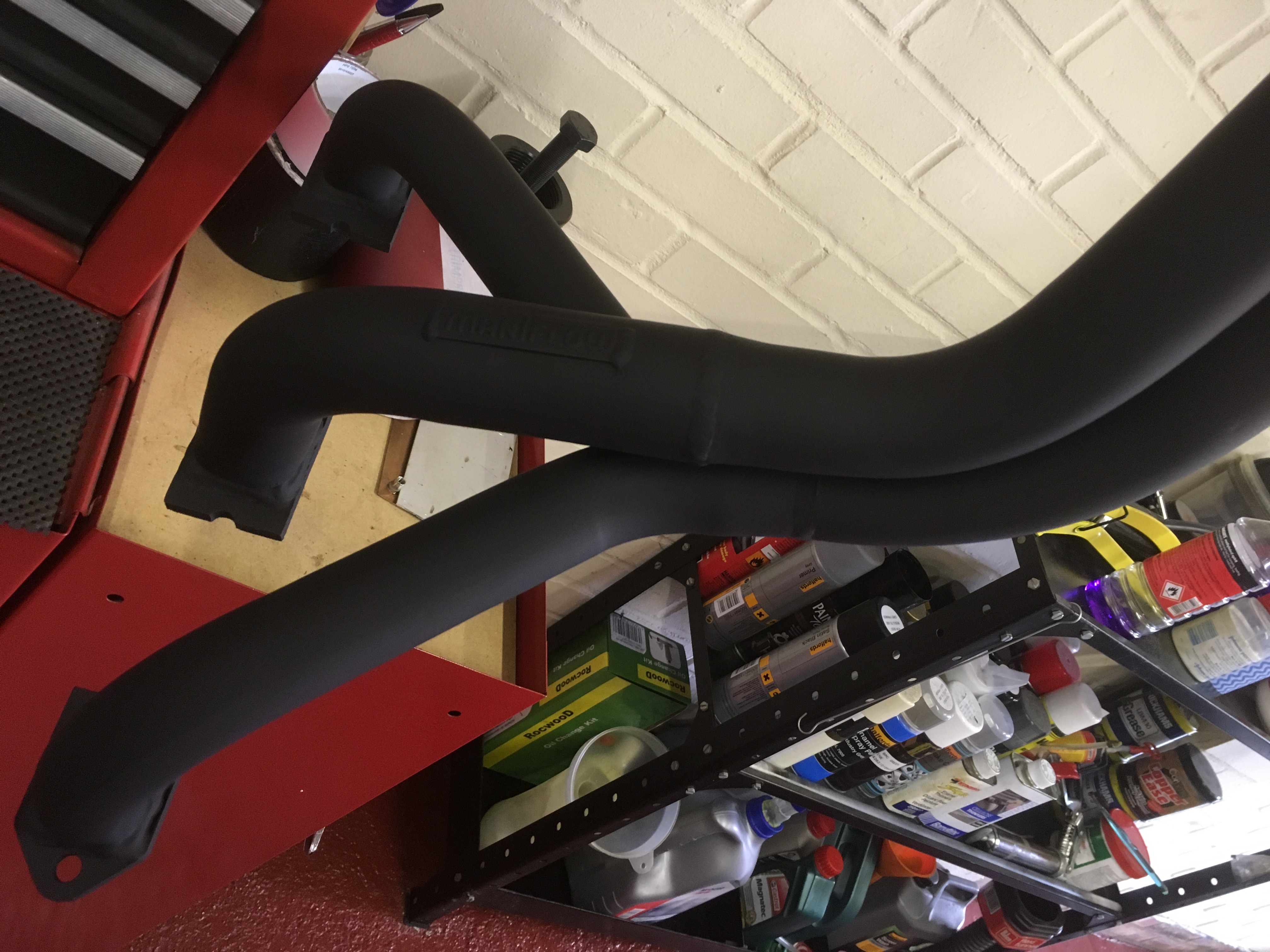

Salisbury is a fun, thirty-minute drive away from me and also home to Maniflo! So it was straight off to them with my old headers. I've dealt with them over the counter before, so I knew what to expect. It's old-school fabrication! complete with the topless girly calendars that you all thought had ceased to be printed a decade ago. It's an H&S nightmare and long may it remain so! It's also very much "wet finger in the air" when it comes to quotes.
Dave quoted VERY SIGNIFICANTLY less than Westfield for a mild steel direct copy, but then we started discussing what could be done instead. They've been producing manifolds, both intake and exhaust, for A-series installations for decades, so know their stuff. Dave pronounced that the standard bore would be adequate for a mildly-tuned 1275 engine, but no more. For my 105bhp, 1320 engine it would be holding back further tuning. We eventually settled on a big-bore system, with much longer primary pipes than the stock Westfield system, in stainless steel, for £480 inc. I also stipulated a bolted flange joint for the inter pipe.
Sadly, although I discussed the minutiae with Steve (the fabricator) alongside Dave (the boss), Dave returned from a week away to find that it had been fabricated in mild steel (with a stainless intermediary pipe and flanges). But then again, I had a beautifully made system fabricated in a week and offered to me for £275.

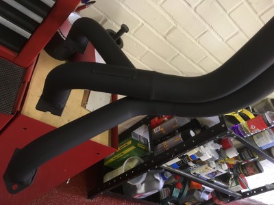

Once again, I failed to take some crucial photos for you, but here are some of the system painted in VHT Flameproof paint, prior to curing on the car:

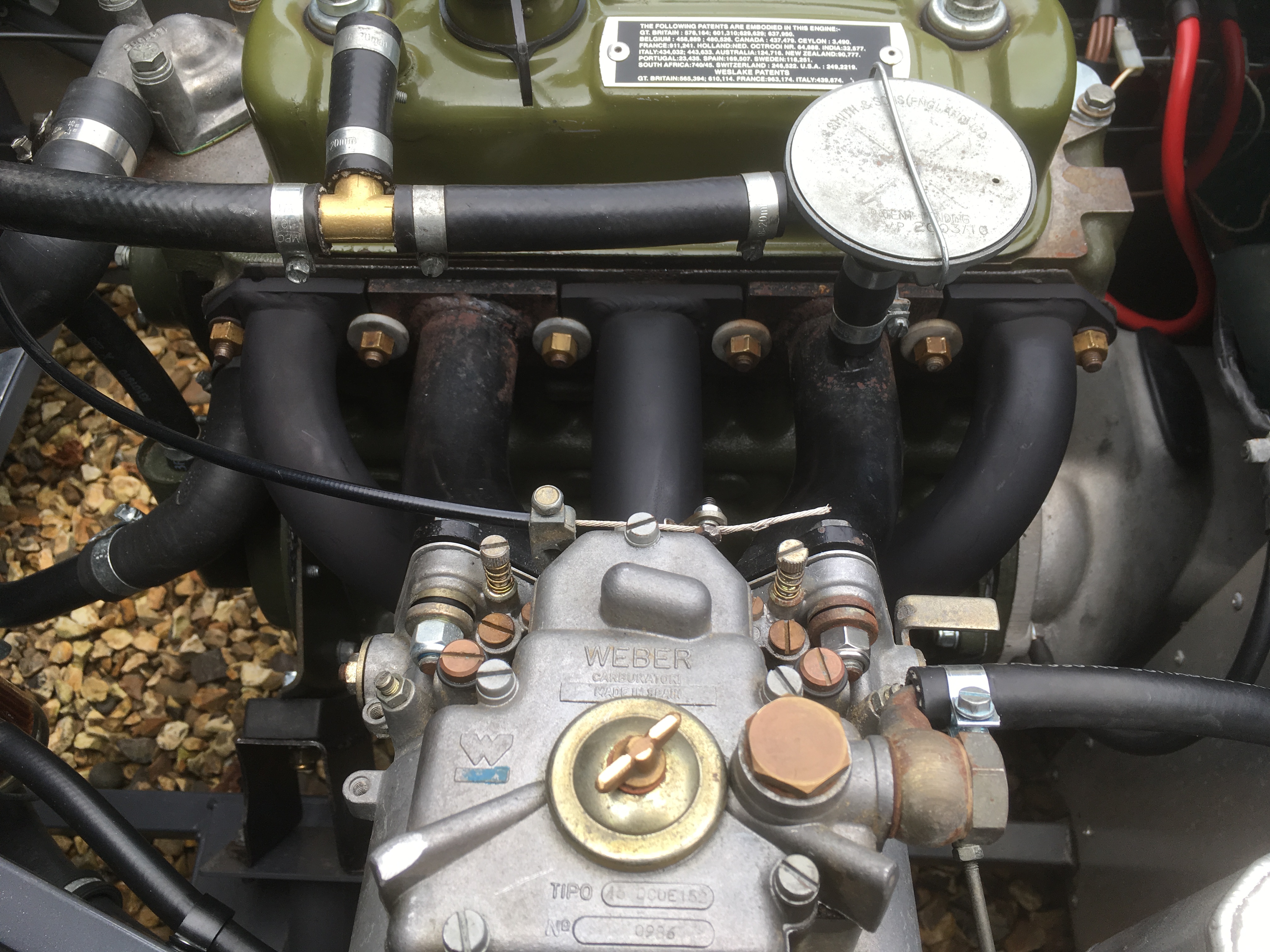

- Posts: 461
Re: Exhausting!

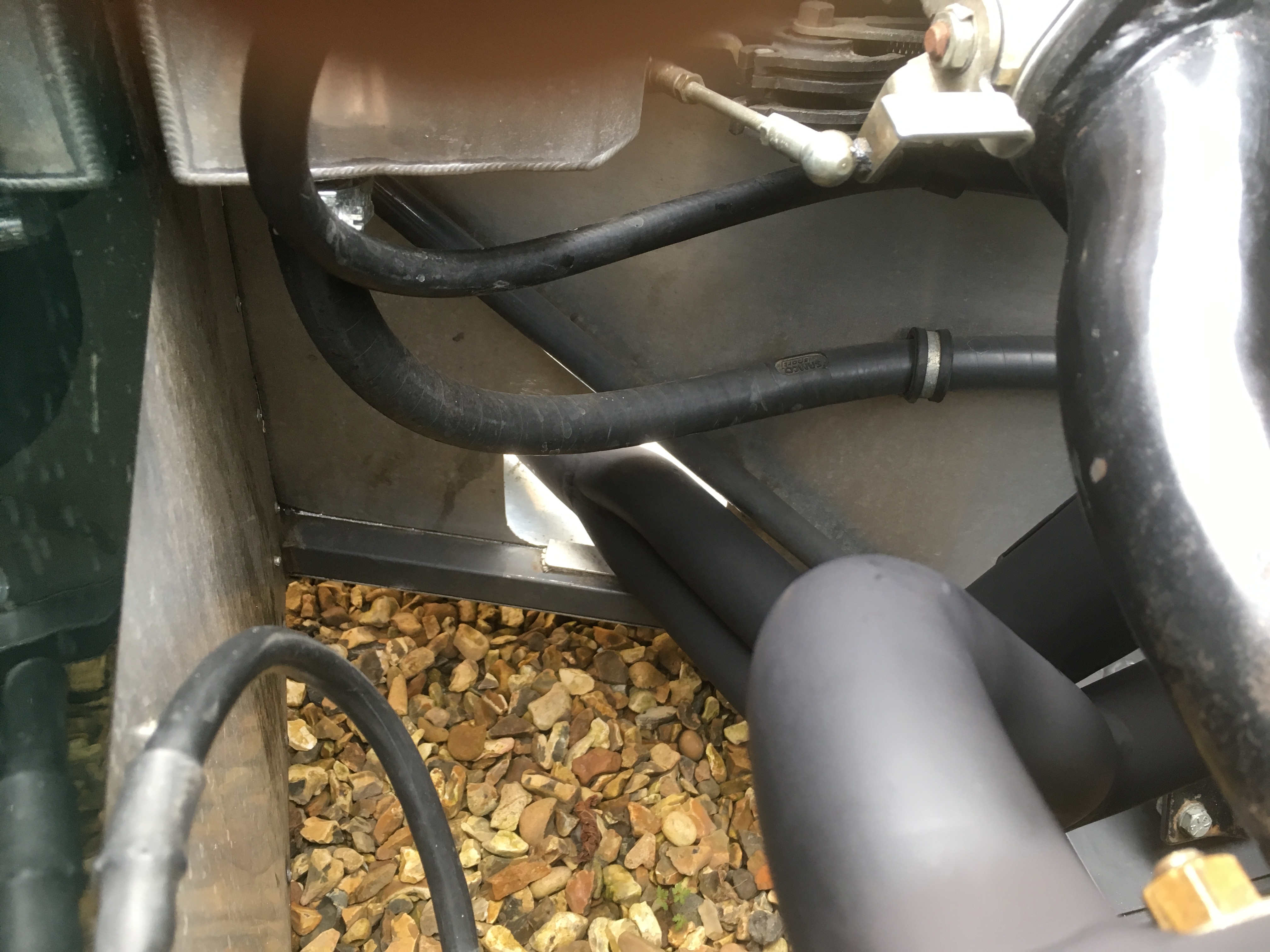

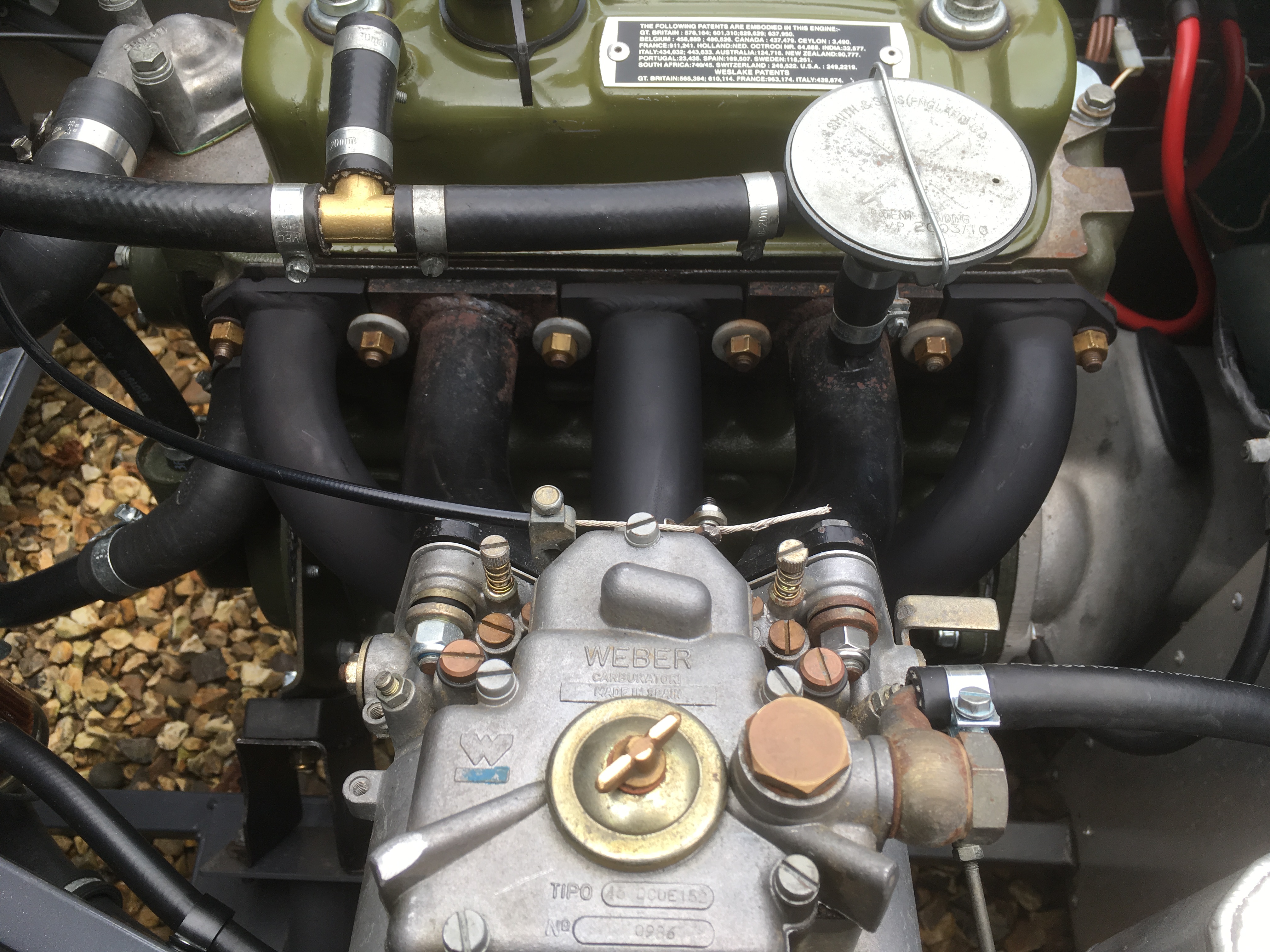

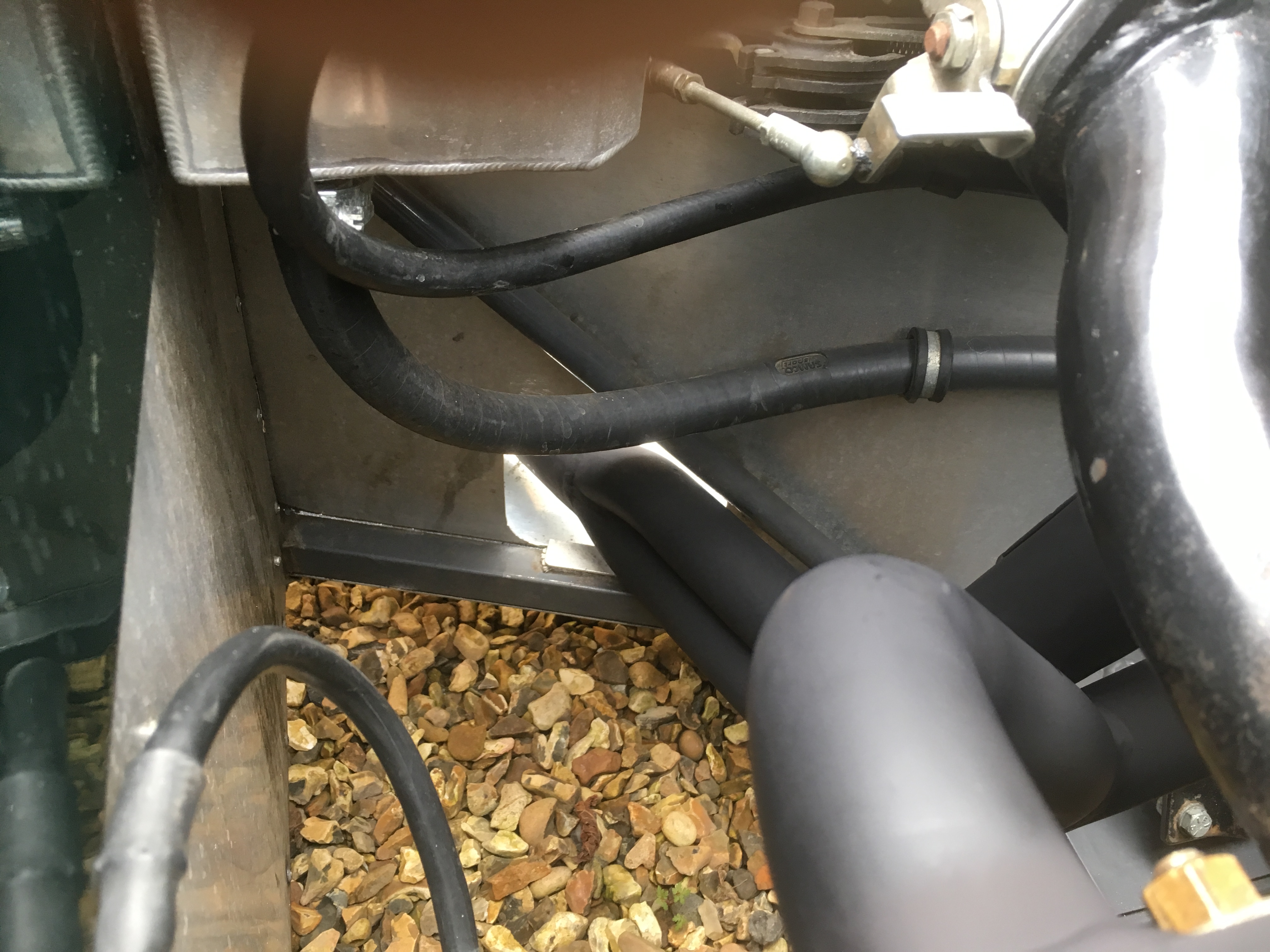

Here it is on the car for paint-curing. Note the length of the primary pipes. Also note that it's a tight fit where they come together between the chassis rails. Maniflo only had my old pipes for reference and were under instruction not to go any lower, due to the chassis rail running beneath. I'd quite forgotten about the diagonal tube above! If anybody orders a similar system, I'd recommend that they direct Maniflo to this thread and these photos and have the primaries come together horizontally rather than vertically. Still, I got lucky. It fits (just!) with no interference when the engine's running.

So, I've only covered about thirty miles, curing the VHT paint. I can't comment on power or torque; that'll have to wait until it's next on the Slark dyno. But the exhaust note is less rasping. Deeper and smoother, much as you'd expect from the increased bore. It's certainly beautifully made, with nice, clean transitions from square ports to tubular pipes.

Now, for the warning about your current header:
I dont want to alarm you, but...
DONT WRAP THE HEADER!!! It will crack at the "Y" junction in short order (the Maniflow fabricated part of the pipe). You will notice some more crackle and pop in the exhaust when it cracks.
I will skip over the usual problems that exist with header wrap, especially when oil soaked or fuel soaked from carburetors that may be mounted directly above the wrapped pipes...
I mention this as I have had the problem in 100% of the Maniflow big bore exhaust headers that I have had, on several different W11s. When wrapped, they crack within a thousand miles or so. Then, I have to TIG weld them up, and... They will crack again. They crack when wrapped, and have cracked when coated, or painted, or coated inside and out... Always just above the Y, at or near the Maniflow welds. In one case, on a ceramic coated header, it cracked beneath the pipe, prior to the center weld.
Not wrapping the Maniflow header will give it longer life. Make a heat shield to keep the heat off of the carburetor(s). Aluminum or Stainless Steel, your choice. There is also a bolt on heat shield that can go below the Weber, but it blocks the ventury location screws, and you might want to be able to inspect these from time to time, even if you have tab locks or safety wire.
When the header is not wrapped, the cracks can be seen as they occur, and you can do the welding before they get too big. TIG welding is the best way to fix the cracks, and if you can get the pipe pressure tested, even better. Often. there are more cracks than you might see. Once, I found 3 additonal cracks during the pressure test.

I'm aware of both your modification of the Maniflo Mini big-bore headers and the problems with cracking. Having both the VHT paint and the wrap and sealant spray to hand, I thought I'd give it a go and see how I fare. If it subsequently cracks, then Maniflo are only just down the road to effect repairs. The original welds appear to be very good though.
A trip to Slark Race Engineering's dyno is in order to ensure that I'm not running too rich. It's too much unburnt fuel igniting in the wrapped manifold that caused the excessive degradation of the original pipework. So I'll admit that wrapping is very much a double edged sword. It has upsides in heat control and improved gas flow.
