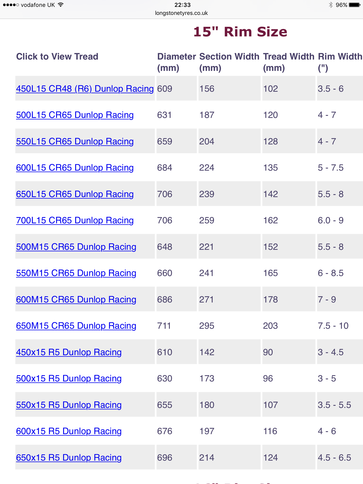

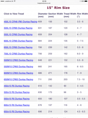

The following table shows the dimensions of all of the 15" Dunlop Historic Racing tyres and the permissible rim widths. As ever, tapping on it will expand it to a legible size!! Notice that the L-section tyres permit much wider rims. I've also included a diagram that explains what dimension is what! The section width is only correct when the tyre is mounted on one particular rim width. Mount the tyre on a wider rim and for every .5" increase in rim width, the section width increases by .2" (and vice-versa for a narrower rim).
So Jan has successfully equipped a number of W Elevens with L-section tyres front and rear. The dimensions of the front tyre seem critical and the 450L15 has an overall diameter of 609mm and a section width of 156mm. I've found a road-legal, radial-tyre alternative with the corresponding dimensions of 616mm and 147mm.
At the rear, the dimensions of the 500L15 are 631mm and 187mm. My alternative is 646mm and 167mm.
The front tyre has a greater overall diameter than the Dunlop, but it's only by 7mm. Or, looked at another way, the sidewall is 3.5mm taller! At the rear, the sidewall of my alternative is 7.5mm taller than the Dunlop, but clearance isn't so much of an issue here (I think??).
My alternative tyres appear to be much less wide than the Dunlops, but don't forget that they are of radial construction rather than crossply. The actual tread width of the Dunlops is much less than their section width. The tread width of the radial tyres is much closer to their section width.
So, the overall diameter of my radial alternatives seems to be very similar to the L-section Dunlop crossplys and their section width is less, even if you allow for growth if fitted to a wider rim.

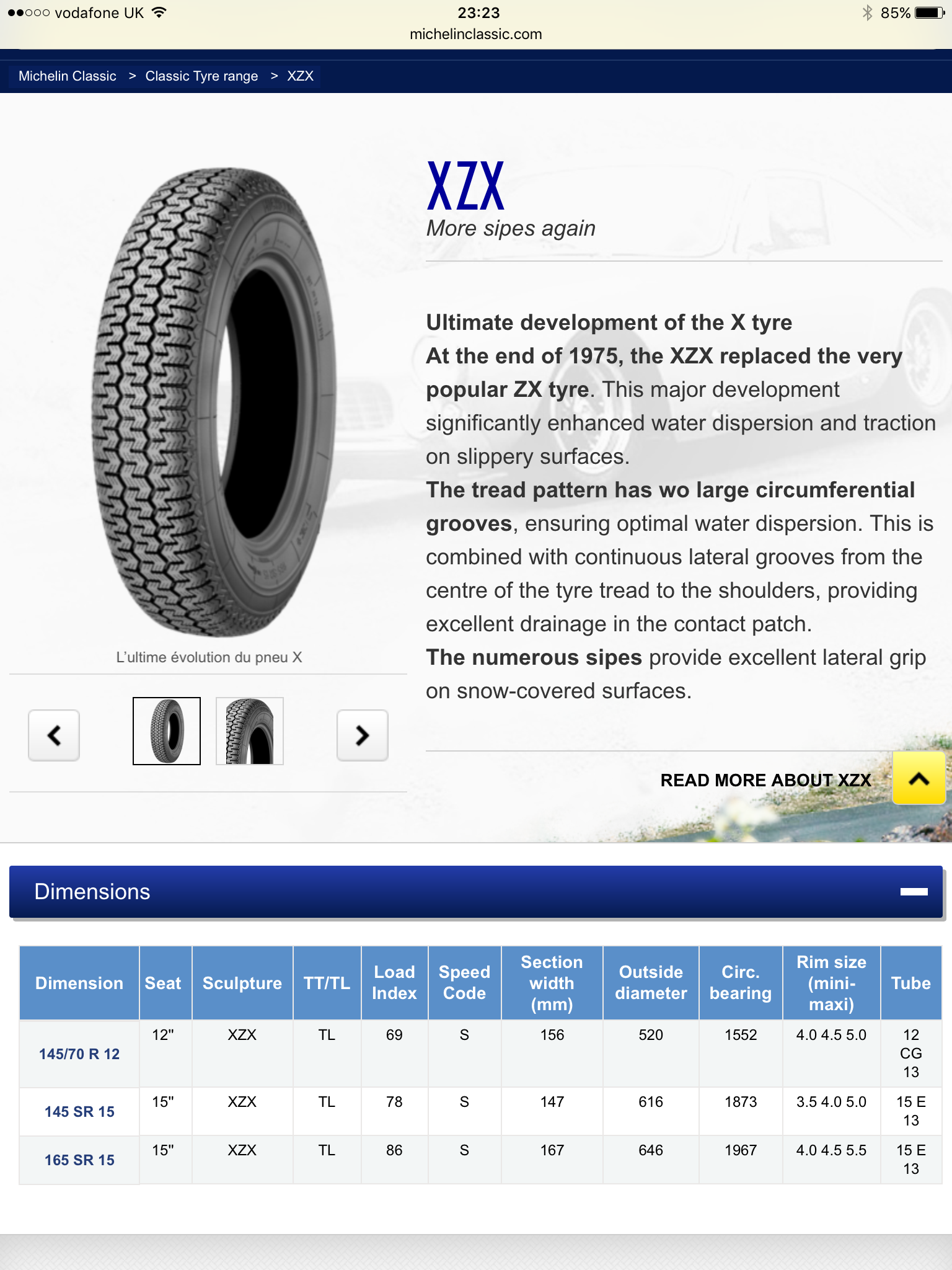

Here is the spec. sheet for the Michelin XZX radial tyres (obviously the bottom two of the three sizes available!).

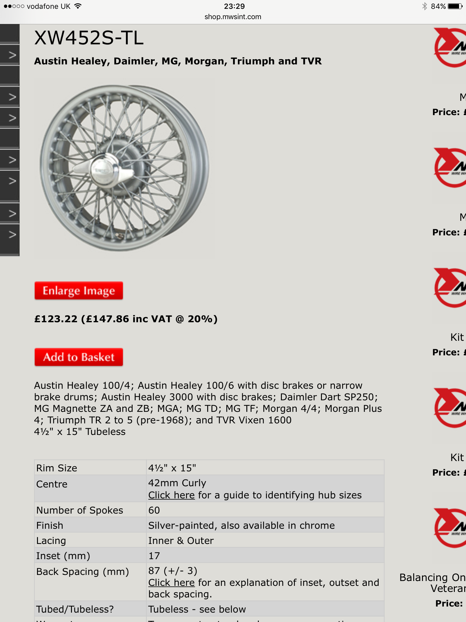

So, if the XZX is a comparable size to the Dunlop, what wheels to mount them on? The front is suited to a 4"-wide rim, with a maximum permitted width of 5". The rear is 4.5", maximum 5.5"
I run Spridget splined hubs with 9" discs and MGB callipes at the front and the 1"-wider-than-ideal disc-wheel rear axle with hybrid disc-wheel half-shafts/Spridget splined hubs at the rear (how many hyphens in one sentence?) So, proper splined hubs front and rear, not bolt-on converters.
I presume that the more spokes a wheel has, the greater the loads it can bear and the longer it'll stay in true for? But the Eleven doesn't exactly overload it's wheels, I don't do that many miles per annum (almost 3000 last year was exceptional!) and...... I prefer the cosmetic look of the lower spoke-count! And for that same reason, I'd like to keep the same spoke-count and lacing front and rear, which probably means picking one wheel to serve at both ends.
I think that the two most likely candidates for off-the-peg wheels from MWS are these two. I suspect that the one to go for is the 4.5" width, given that both inset and backspacing are so similar and the tyre will end up in a very similar place. But, as I said at the start, I'd really appreciate the thoughts and observations of others!

The Michelin XZX is interesting because it's available as a 145R15 for the front, rather than the problematic 155 or greater. The 145 has a diameter only 7mm greater than the 450L15s that you use successfully. That's 3.5mm of extra tyre fore and aft. Will that impinge on the sill to the rear or the headlight to the fore when the 450L15 doesn't? I don't know.

450L15 is identical to a 450X15 in diameter (24", 609~610mm). No difference. The additional rim width is not a factor at all. It is still narrower than the 165/13 or the 185/70/13. The diameter is the real problem, and the L fits without fouling the headlights, provided you use side wire plugs (I believe that the factory harness has them).
I have installed the 450L on all the cars, as they are tubeless. Rim width chosen was 5.0", which is the measuring rim width used for the L tire and recommended. 5" rims fit the W11 front and rear (any rear axle combination, even with bolt on adapters), if you want only one rim size. Of course, you can use 4.5" rim width if you want to stick to a smaller spoke count.
If you stick with the MWS 5" wide rims, you get tubeless mounting, and some additonal strength in the wheels, which is advantageous with the limited suspension travel.
