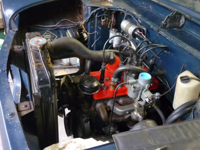

Mine will have an 1172 cc Ford sidevalve. You can’t come closer to the original Eleven concept except with a Climax engine. Attached photo is the actual engine still in its donor car. Power isn’t very spectacular in standard guise, so I am already contemplating a compressor.
[attachment=0]IMG_0650.JPG[/attachment]
